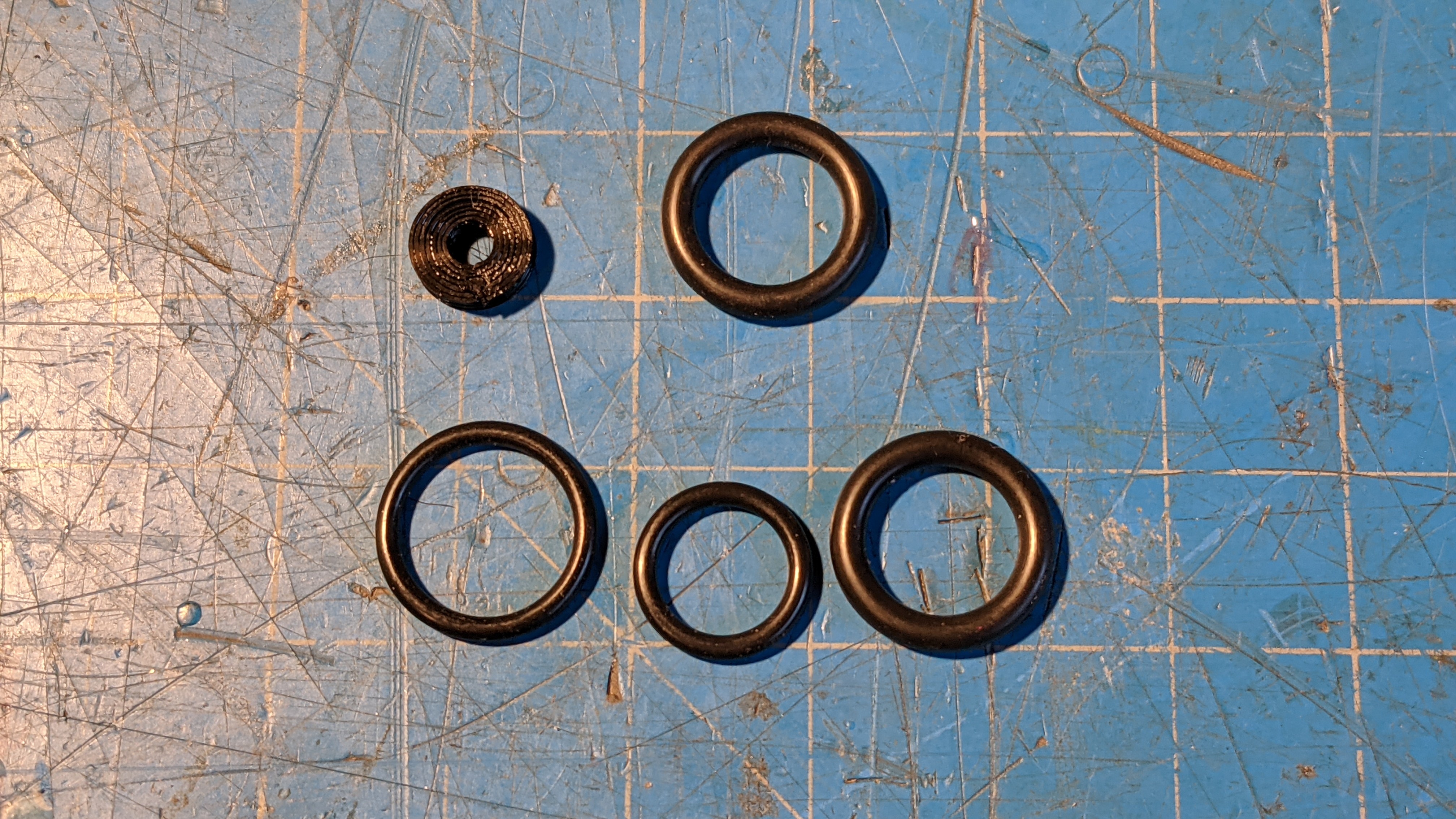

    There is 2 “version” of the kit, the PGP (short bolt, 1 o-ring bolt) and the PMI (long bolt, 3 o-rings bolt). If you are not sure which kit to get, let me know, I can help you figure it out.
    Here is the content of the PGP (short bolt, 1 o-ring bolt) kit:
    - 3D printed 12g seal (install with shiny side toward the 12g)
    - Valve front o-ring (1 piece)
    - Valve rear o-ring (1 piece)
    - Bolt o-ring (1 piece)

    Price: $7.00 for the first set, $5.00 for each additional shipped and PP in an envelope.
    So, 1 set is $7; 2 sets are $12.00; 3 sets are $17 and so on ...

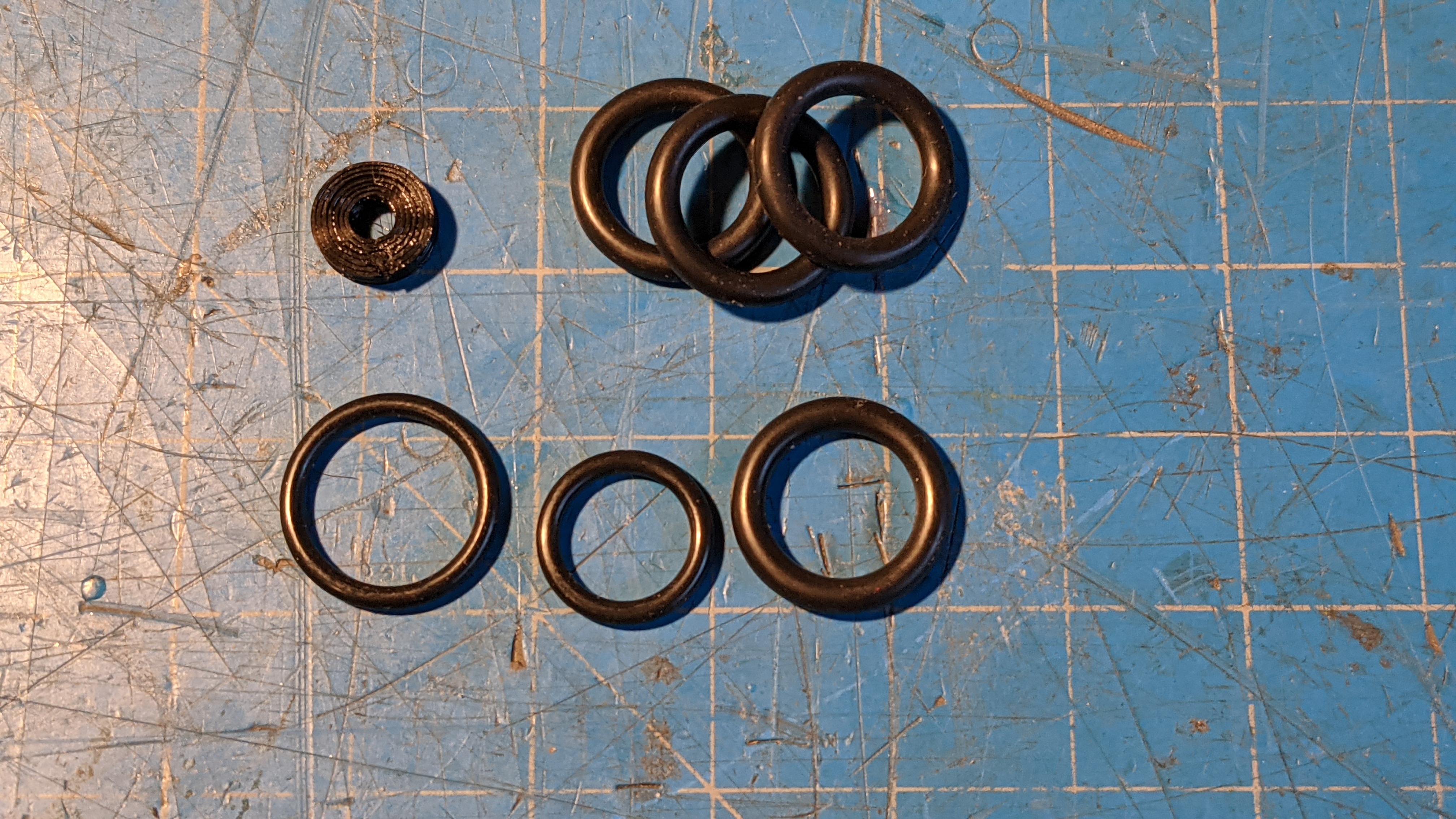

    Here is the content of the PMI (long bolt, 3 o-rings bolt) kit:
    - Bolt o-ring (3 pieces)
    - Feed tube plug o-ring (same as bolt)
    Click image for larger version  Name:	PMI Kit.jpg Views:	0 Size:	2.37 MB ID:	99867
    Price: $7.50 for the first set, $5.50 for each additional shipped and PP in an envelope.
    So, 1 set is $7.50; 2 sets are $13.00; 3 sets are $18.50 and so on ...

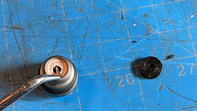

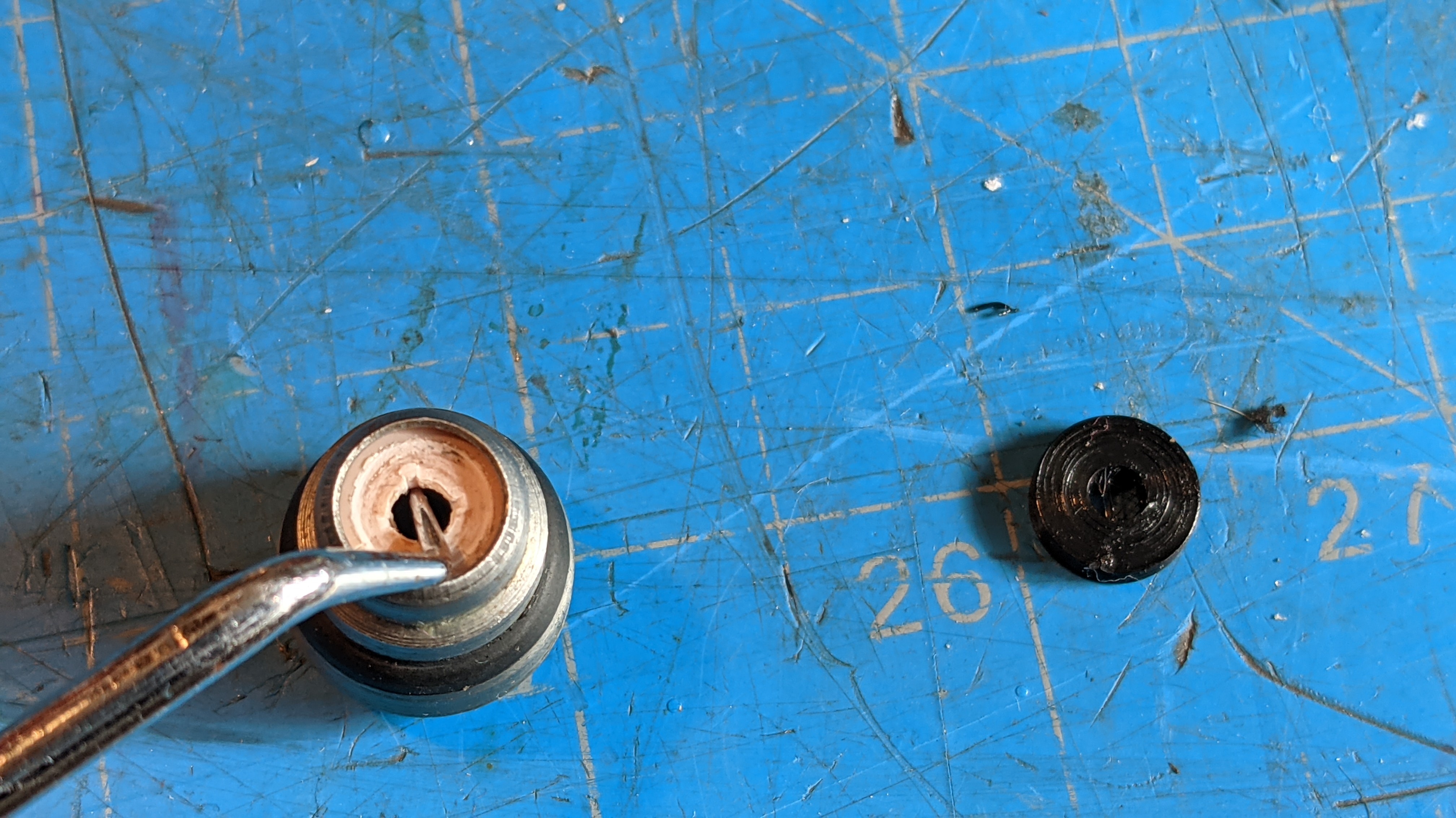

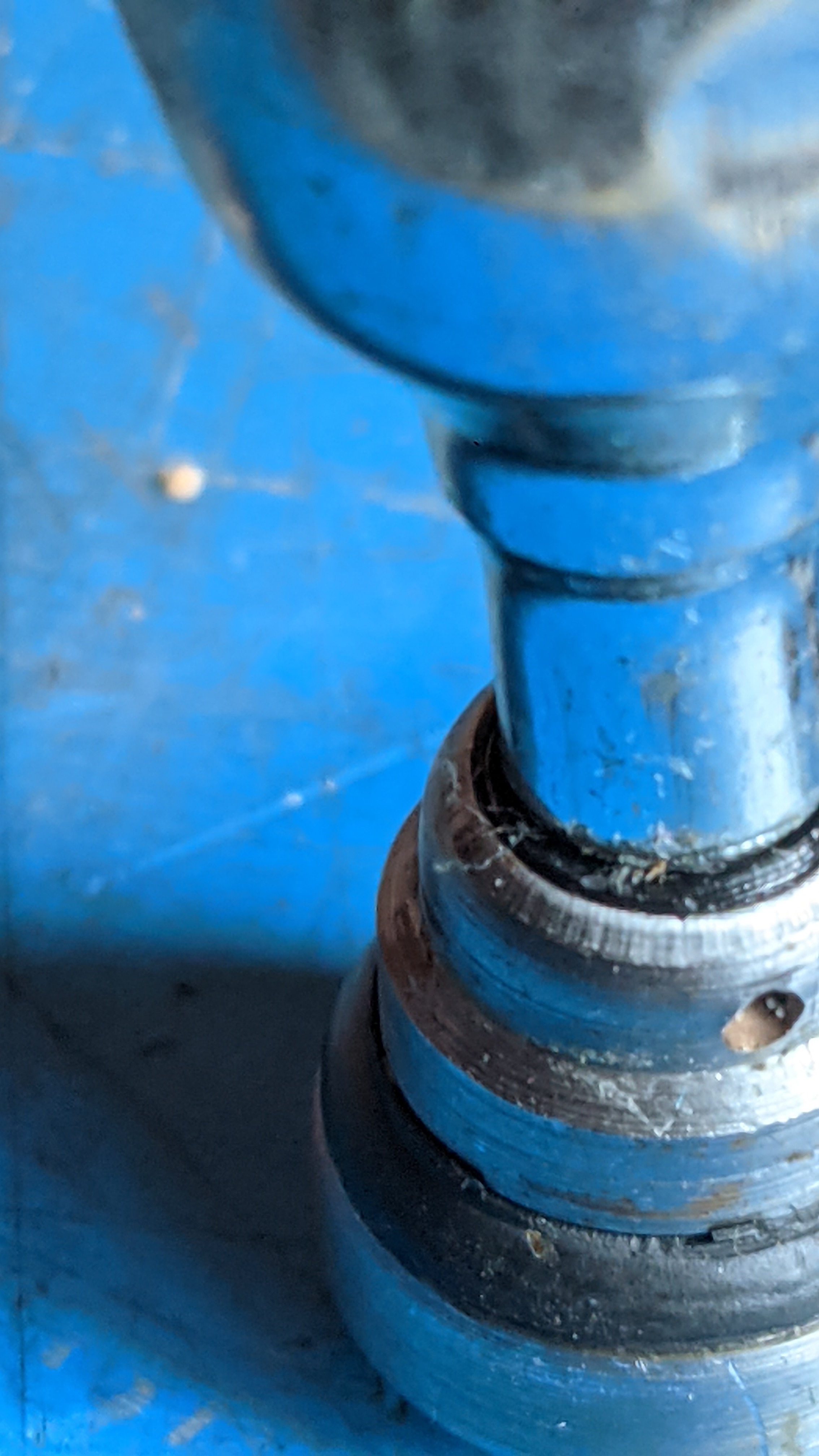

    Here is a little "How-To" on installing the face seal:
    1 - Remove the old seal.
    I like to use a pick for this, get all the old stuff out, and clean it. Be carful not to damage the front metal part, it is shaped to hold the seal in place.

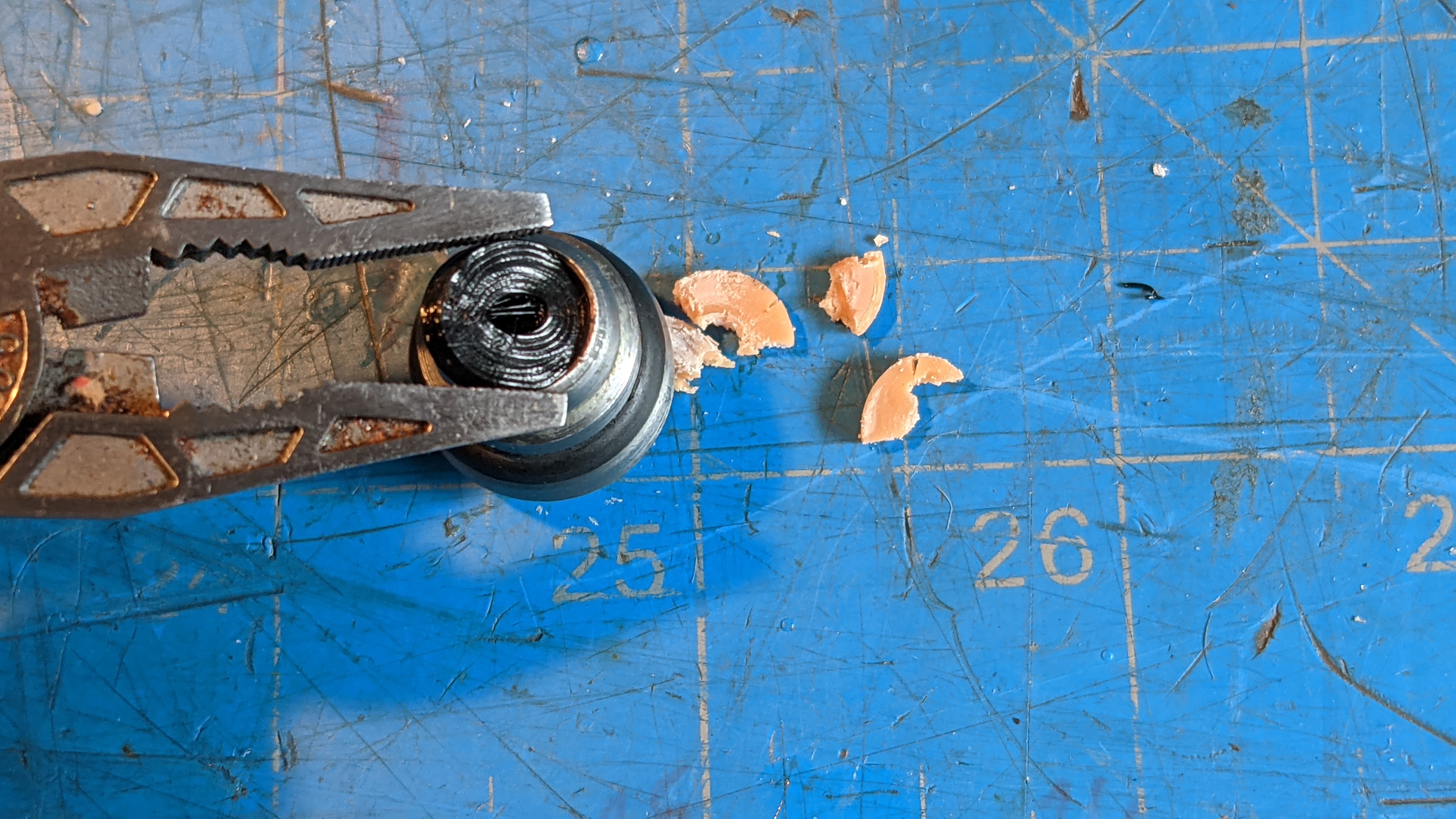

    2- Start putting the new seal in. Shiny side toward the 12g.
    The seal is larger than the front of the opening, it will need to be squized in. A small needle noise plier works great for this.
    Make sure not to scratch or cut the seal.
    ​ Click image for larger version
    3 - This is not in all the way.
    You can see part of the seal protruding from the side and the top is not flat.

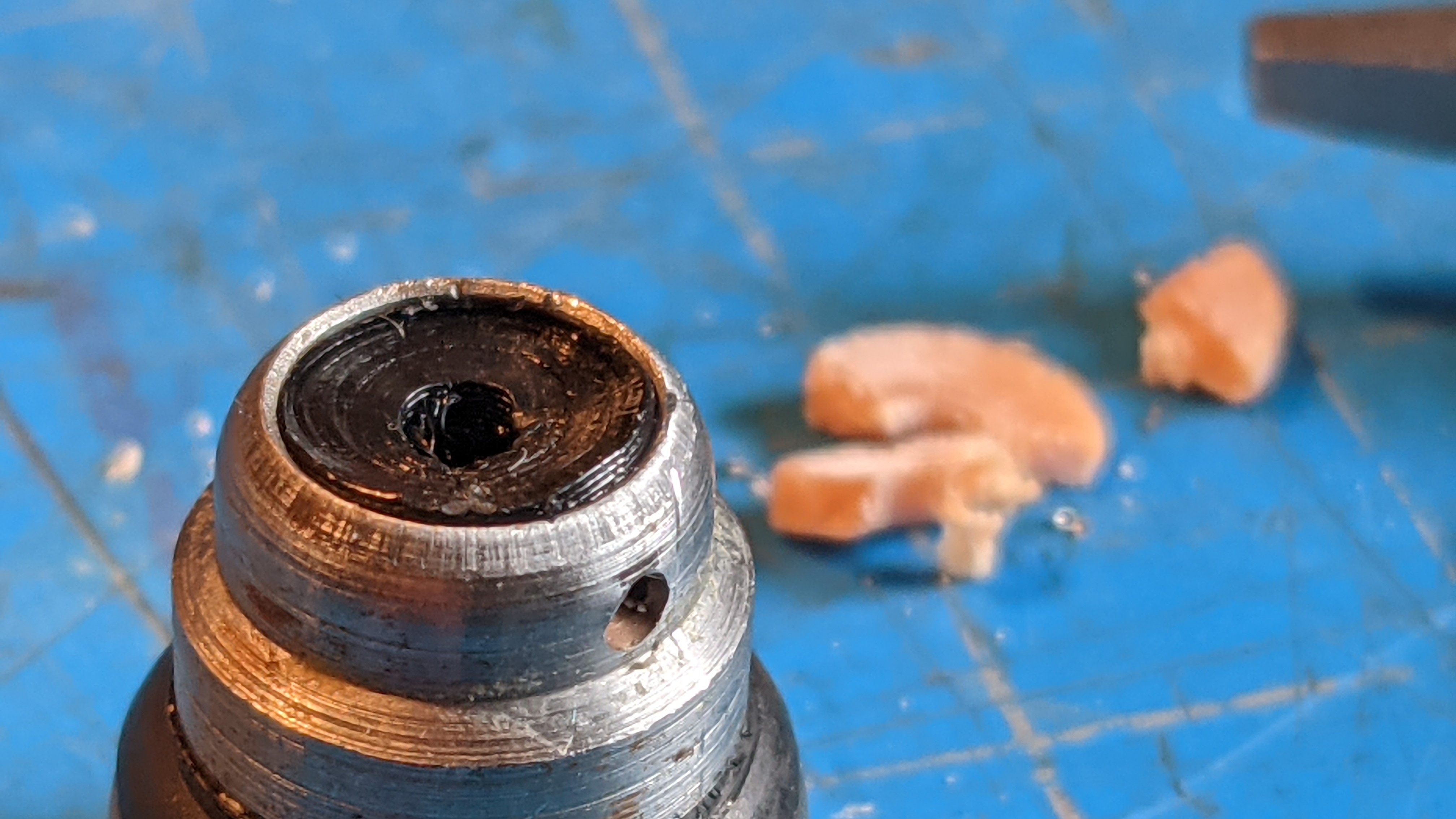

    4 - press the seal all the way in.
    a 12g is great for this step (sorry for the wired crop)
    5- This is how it looks properly installed:
    (My picture is all blurry, ill put a proper picture up when i get a minute)
    As always, feel free to reach out if you have any questions or encounter any issues.
