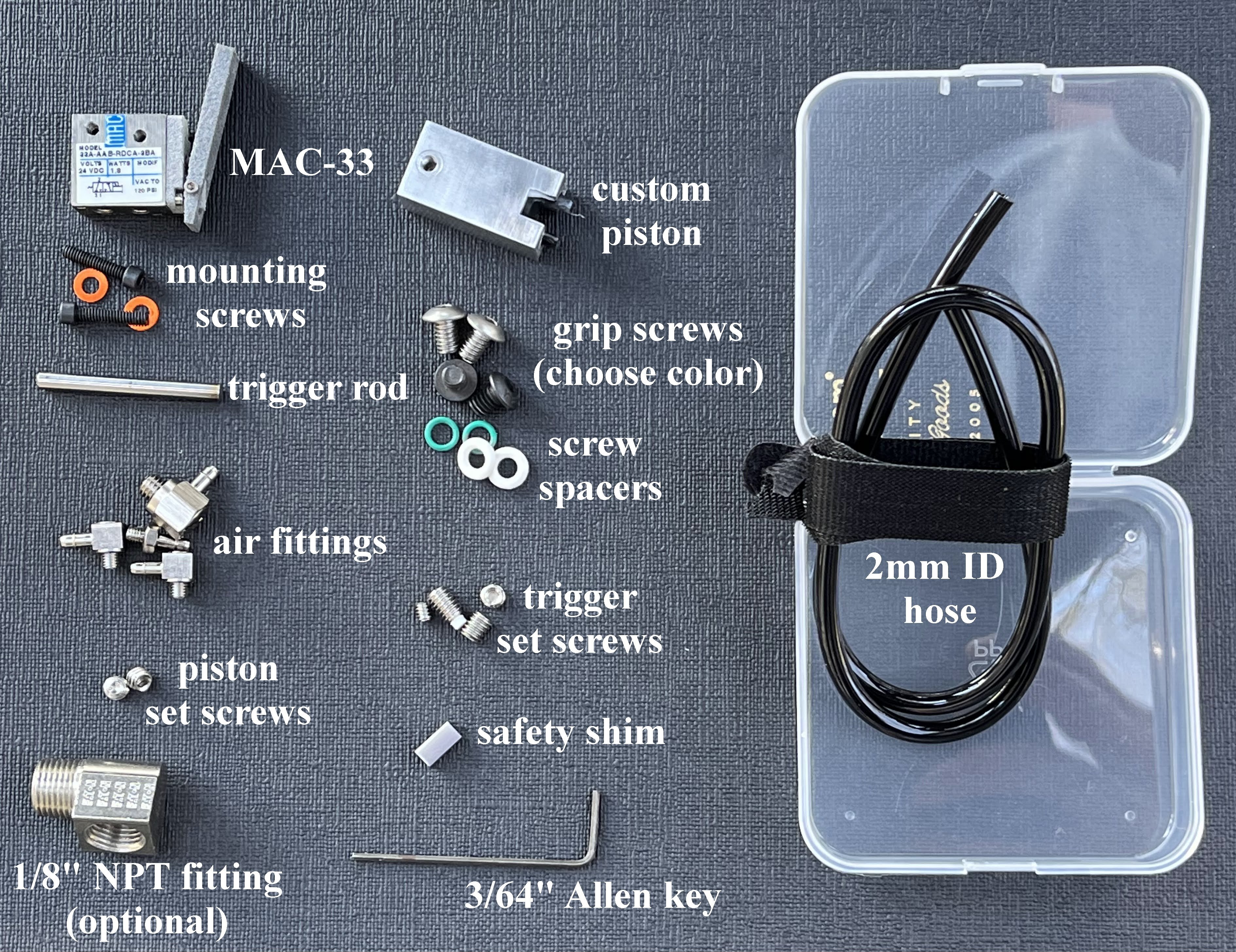

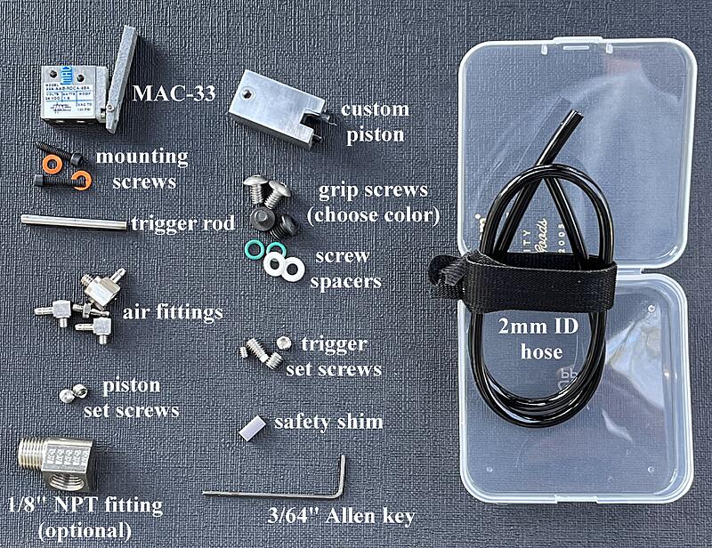

    It's been a long time coming, but I'm finally ready to release my MAC-33 pneumag kits into the wild. There are 3 different versions for this kit. Hopefully everyone who wants one will find something that works for them. All these kits include a piston, a MAC-33 solenoid valve, and an assortment of other small parts you will need to install everything.
    To do this mod, you will need an Automag, a valve with an RT on/off assembly, and an LPR (such as a Jackhammer or Resurrection). These kits will only work with AGD-spec frames. If you want me to make you a pneumag from a non-AGD frame, then go here.

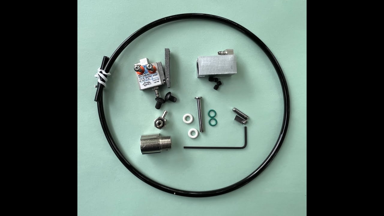

      The X-Frame Kit
      This kit is $175. It has some different pieces made specifically for AGD's X-Frame. The only special tools you need are needle files and a mini flathead screwdriver.
      Here's the manual with full parts list and quick install guide:
      https://docs.google.com/document/d/1...it?usp=sharing
      Here's the full installation video:
