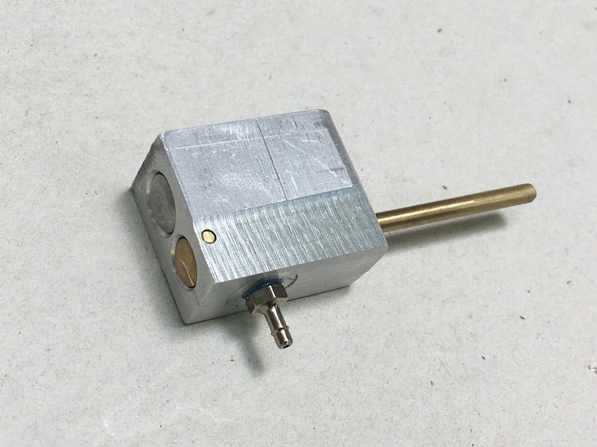

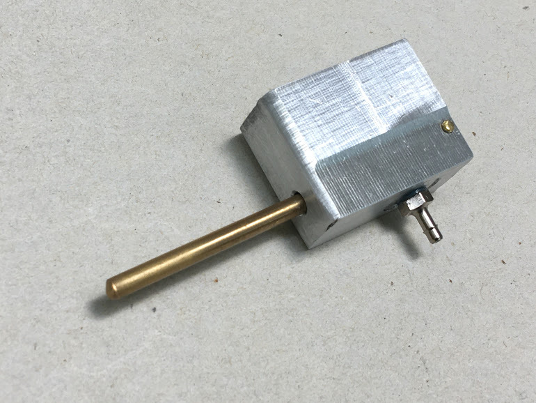

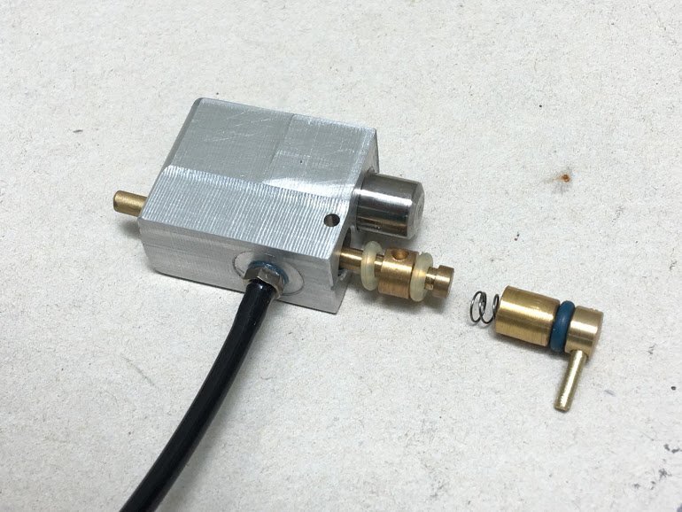

    This is the SPAR valve. It’s a select-fire, pneumatic, auto-response trigger valve for the Automag Intelliframe that costs about $150.

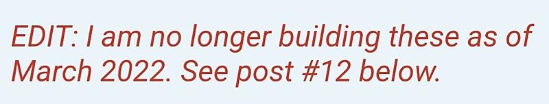

    EDIT: I am no longer building these as of March 2022. See post #12 below.
    Click image for larger version  Name:	valve front.JPG Views:	5 Size:	132.6 KB ID:	8387 Click image for larger version  Name:	valve back.JPG Views:	5 Size:	116.6 KB ID:	8386 Click image for larger version  Name:	image_1555.jpg Views:	6 Size:	90.6 KB ID:	8388 Click image for larger version  Name:	disassembled.JPG Views:	5 Size:	99.2 KB ID:	8385
    The valve is mounted inside the frame like a pneumag set-up, but it can fire the marker on both the pull and release of the trigger. It also has a rotating selector-switch safety with three positions: safe, single fire, and auto-response. This is a significant improvement over previous mechanical auto-response frames, which always fired twice with each trigger pull (even if you only wanted to take a single shot),
    The base cost for this mod is $150. That covers the valve, the safety, the milling, some new grip screws (the stock screws are too long), and the return shipping in a small flat-rate box. (I can also ship to Canada and overseas if you cover the extra cost.) You must also provide a frame and an LPR. (The price was originally $100, but it was increased on 6/17/2020.)

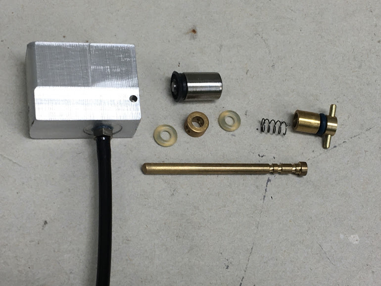

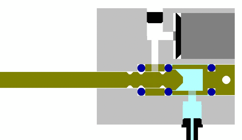

    The valve itself is simple. There are only two moving parts (the trigger pin and the piston). The internal assembly is held in place with a single 5/64 pin, so it's easy to take it apart and replace the o-rings when needed (probably once a year or so). It will also work on pretty much any Automag with any valve. X-valve, classic valve....whatever. You will need an RT on/off, however. A classic on/off won't cut it.
    The piston is made from polished 5/16 steel rod. The back end has a nubbin that fits a u-sup seal. This is also easily rebuilt. (Later model pistons are made from black 3/8" delrin.)
    There are two safety styles: the servo arm and the 3D printed switch. (Big thanks to ArmageddonSportz for designing the 3D switch!) Both are included with your order, and they're held in place with the same ball-and-spring assembly used in standard AGD frames. The aluminum servo arm comes with two 1/8" 4-40 socket screws installed. You can easily remove these screws if you want, but I find that they make the switch wider and easier to move.
    Your frame will have to be milled to make room for the SPAR valve. I will also drill a 1/8" hole in the back of the frame near the hole for the field-strip screw. This is for resetting the sear. (It's a common mod for all pneumag frames.)
    By the way, this modification will permanently alter your trigger. Besides milling the frame, I will also have to grind down the back part of the trigger to fit the safety. So, if you’re thinking of just trying this out and then going back to normal if you don’t like the valve, that won't work. You will have to (A) buy a new trigger or (B) keep using the safety switch.

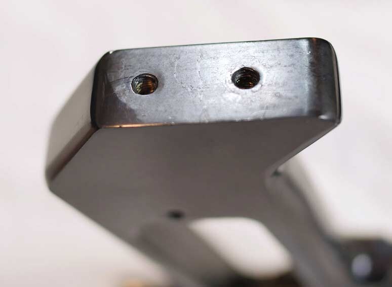

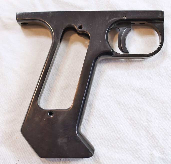

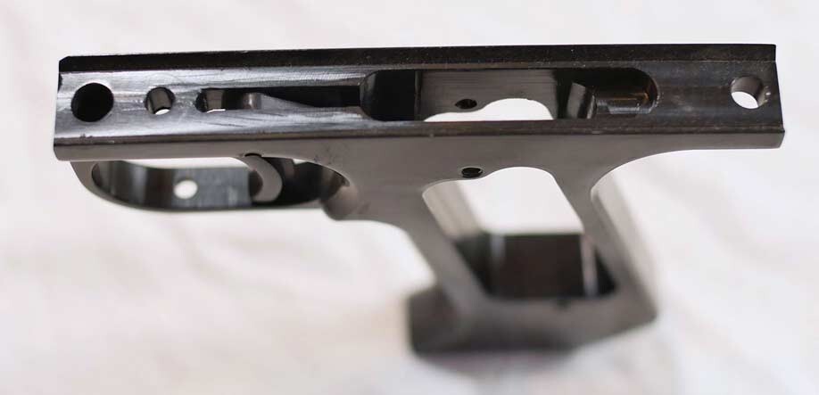

                      Diamond labs frames are similar to but not the same dimensions and safety configuration as my GripStyx frame. I'm pretty sure they are closer to a standard Mag Intelli Frame here are some pictures from Bacci's website:
                      Click image for larger version  Name:	agd0635.jpg Views:	0 Size:	57.6 KB ID:	10831
                      Click image for larger version  Name:	agd0635c.jpg Views:	0 Size:	29.5 KB ID:	10832
                      Click image for larger version  Name:	agd0635d.jpg Views:	0 Size:	26.4 KB ID:	10833
                      I would take some measurements of the cavities in the frame and send them to Rawbutter. He'll need those to determine if the valve will fit in the frame. I would expect it would be easier, then my GripStyx or Benchmark frames, given how much meat is there and the fact there is no pre-drilled holes for the safety, but I'm not doing the work
