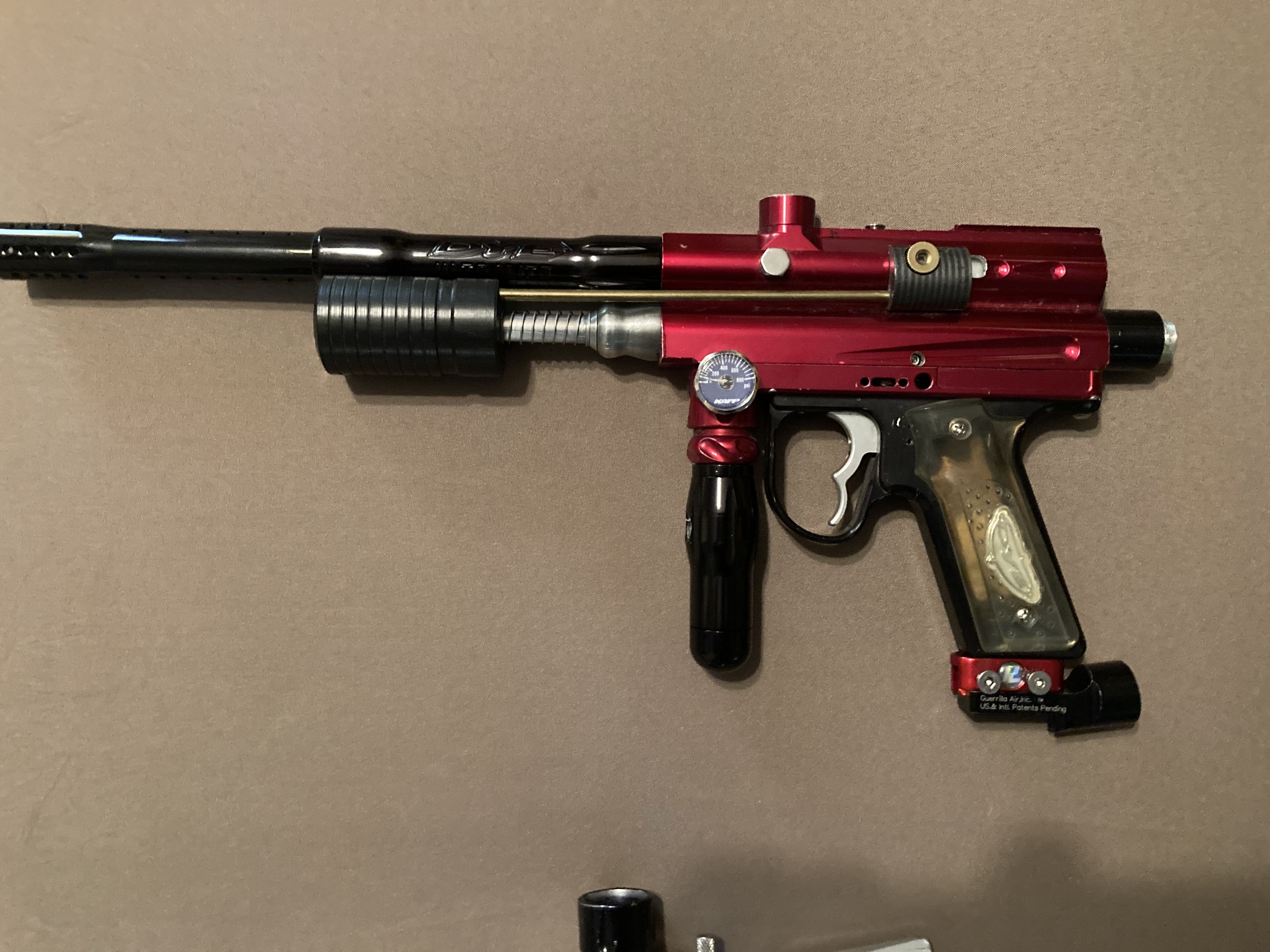

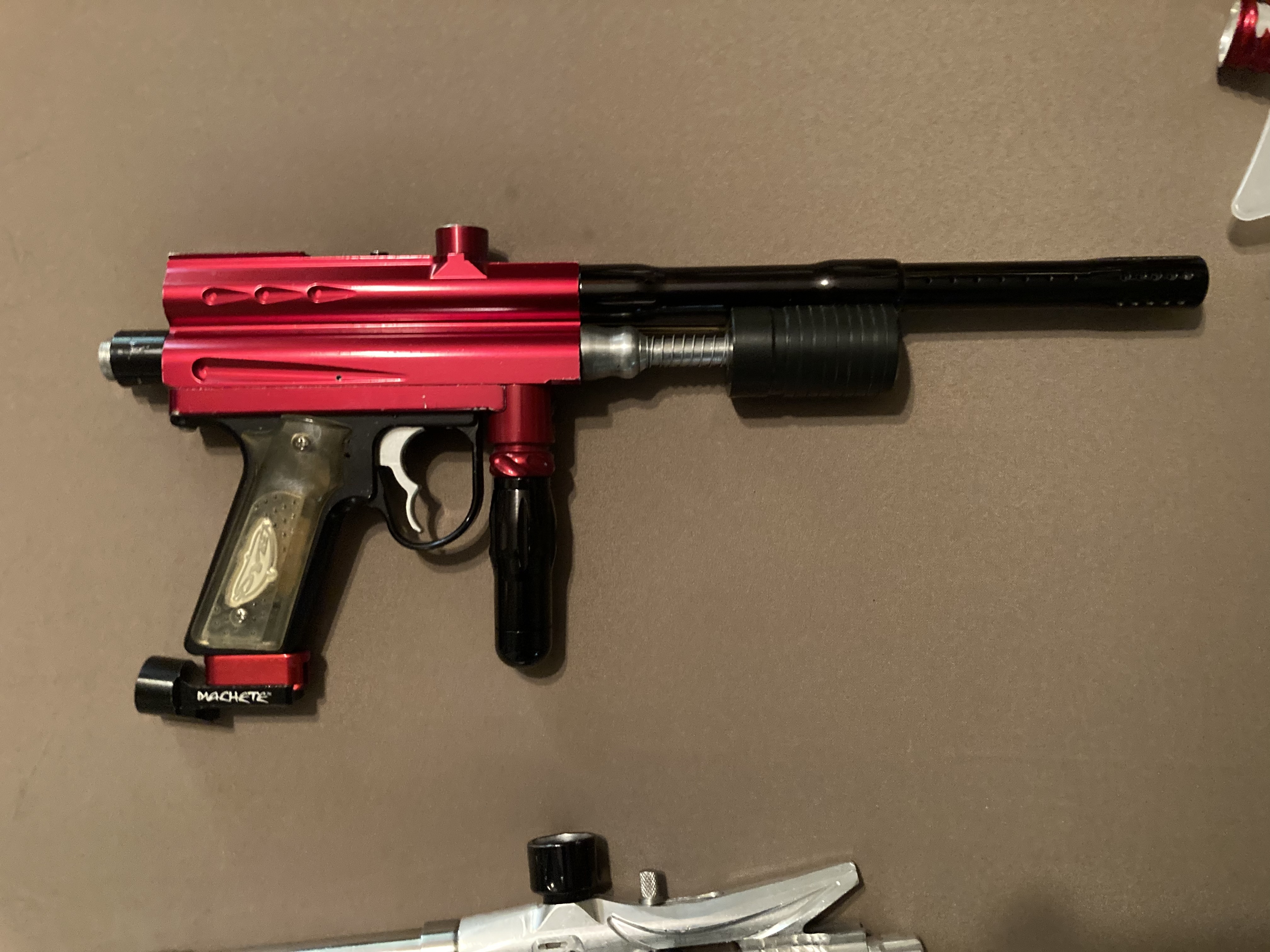

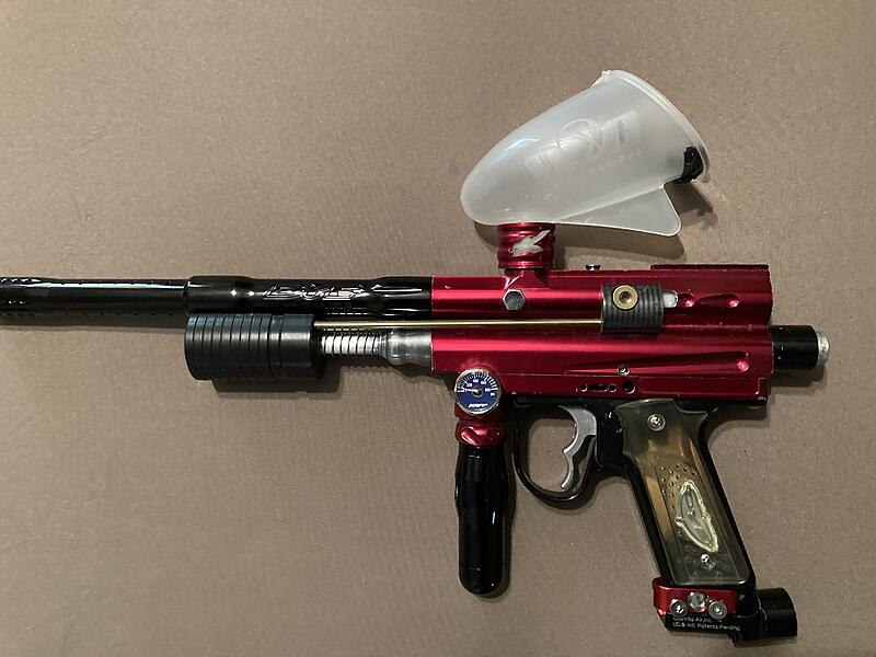

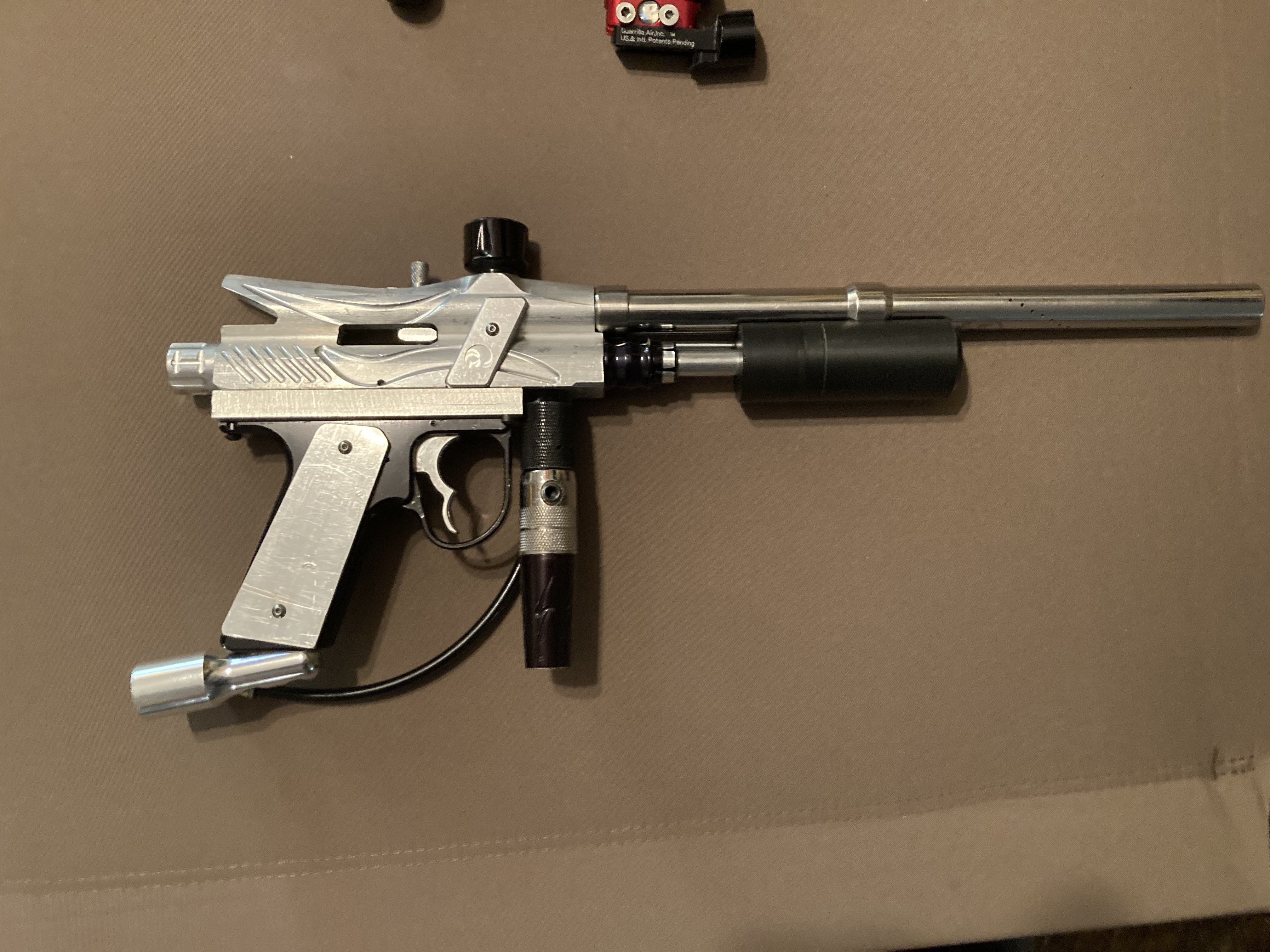

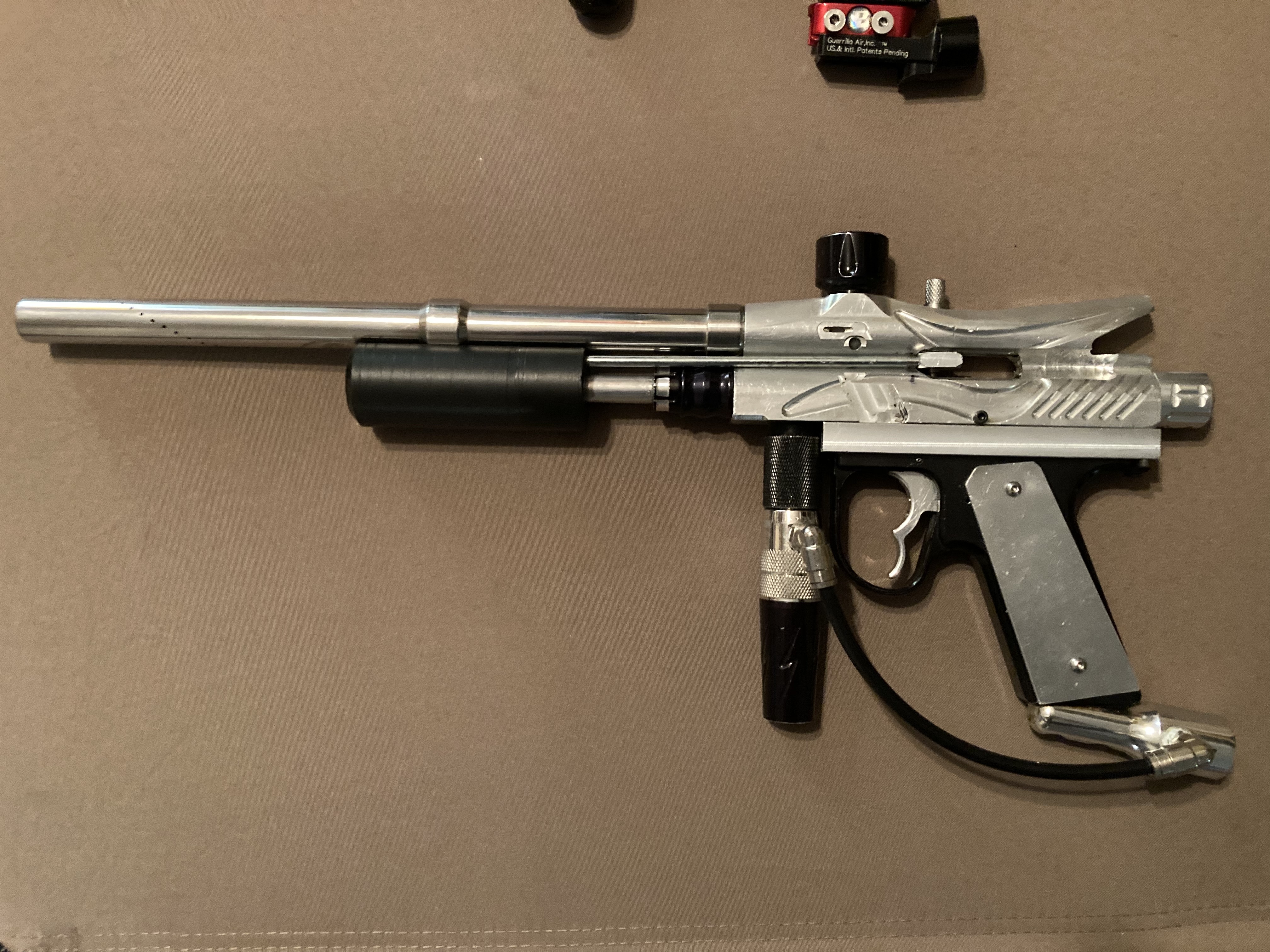

    They are both purely mechanical. The red one has functioned perfectly fine in the past though I have changed the air setup since then and cannot even verify the reg that is on there now. The other one, I am out of ICD valves and have nothing that doesn't leak. Physically, the hammer cocks and releases. The machining is rough but I'm not willing to put anymore time into this.
    $100 for both shipped and pp'd, no barrel on the unannoed gun. Clear hopper included

        Now this is something else. O.O Never seen this done with a Bushmaster before. I'm curious as to how one would do this.
        New Feedback
        • k_obeastly
          k_obeastly commented
          It's simple.
          Clog the air to the solenoid, you can jam the LPR with epoxy, epoxy the air passage, or some of the front caps from BKOs will work as well to cut off the air.
          Come up with a hammer, mine slide in delrin sleeves and use cocker springs.
          Make a slot and sear, You can see the screw in the lower half of the body that holds the sear. A screw in the top of the trigger is enough to connect the trigger and sear
          After that, you just need a pump handle and you have an ICD sheridan.

          Curious as to how these operate. I assume they have a sear now?
