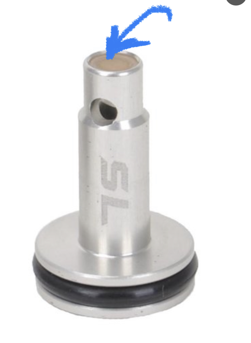

    Have you checked the QEV diagram? Also make sure you LPR piston isn't missing it’s lil bumper.
    If the noid clicks it’s often good. They rarely go bad unless you put a screw threw them by over torqueing the upper grip screws.
