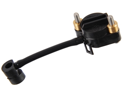

    Need a SP-1 solenoid cap (PICTURE
    Cracked and leaking air like crazy!!! Absolutely nobody stocks these anymore and I would be grateful if someone had a spare cap/solenoid/board assembly with solenoid laying around. Fits smart parts SP1, GOG G1 electronic, As well as the GOG envy/Smart parts VIBE.

    Pic shows the old unit. The new unit is part # ENV058 and has brass nuts to hold the halves together instead of the screws.
    I have JB Welded mine with mixed results . One worked ok, the other I could not get to stop leaking.
    I may get a mech kit for it.

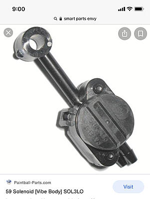

      Yeah I saw that one too that would be pretty easy to make work but doesn’t look like I can’t even find the new one in stock either. Craig The service manager at GOG said they only carry the eNMEy solenoid anymore and it’s not compatible. Said my SP-1 was like a “classic car“ and I’m gonna have to start scrounging! (((

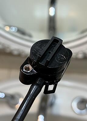

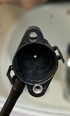

              Well gang I ended up MacGyver-ing it, or should I say M. Carter Browning it. Bought some aluminum wire crimp connectors (rated at 14/16 gauge) at the local hardware store in the fastener section. Reamed out the cracked section of the noid with a 5/32 drill bit. Put the crimp connector in the vise and ever so carefully ran a 4-40 steel screw through it and tapped some threads. Buttoned it all up with some Loctite 401. We’ll see if it holds!

                Pics enclosed

                  Accidentally got some CA glue down in the threads and ended up spinning the bushing in it’s mount! Round two with JB Weld this time. Wish me luck. Still looking for a spare cap or solenoid unit, If anyone has one old stock, would be greatly appreciated!

                    Well after all that its still leaking air like crazy. Not around the cracked area but around the O-ring seal or where the Electric leads pierce through the housing. Looks like the old glue is no longer airtight. Basically the entire Solenoid seems shot.
