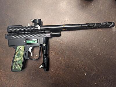

    Looking for a feedneck nub that will allow me to use a PE clamping feedneck on my ICD eclipse bushmaster. Super Staunchy has a CCM to PE, which is perfect except for the CCM part of it. Inception offered a ICD to Empire, but they seem sold out of a lot.
    Any help appreciated.

    Inception just restocked their ICD to Empire nub. Ordered. We’ll see.
    If it comes down to it, I’ll try and source a stock neck and circle back to Superman.
    The gun is shooting extremely well, just trying to update as the A+ style feedneck I have is a pain in the ass.

        Well hell… ok, I’ll take your word for it. The A+ neck I have on there now doesn’t have enough meat to mill. I’ll have to dig around for the original eclipse neck to see if that’s a donor. Chances of coming across an original B2K feedneck is likely… unlikely.

          Got the inception stub and clamping feedneck today. It threads in as I would expect. Not too loose, and not too tight. I feel pretty good about the attachment and will add a drop of loctite when I make a final aesthetics decision.
          Now to find some black hardware.
