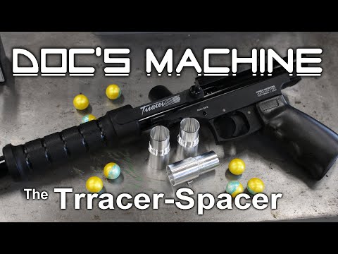

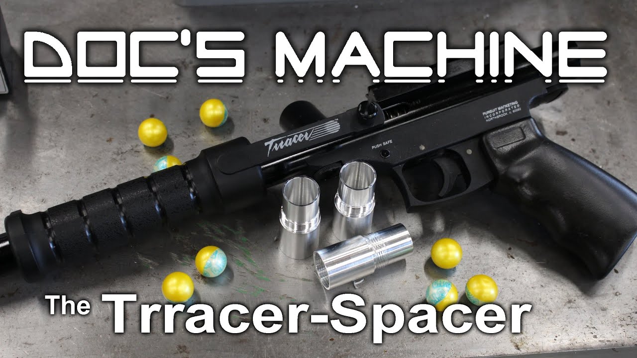

      And they're off! The anno package, with parts for ant least three of you-lot's projects, is finally boxed and ready to ship out in the morning.
      I have to sincerely apologize to those of you I've kept waiting, and thank you heavily for your patience. As per tradition- and I've actually managed it a few times - I plan to have my benches completely cleared off by the end of the year. If for any reason you think I may have overlooked you- it's all too possible- by all means feel free to send me another PM or email or smoke signal, or personal, heartfelt message hand-delivered by a large Italian gentleman with a bad suit and a facial scar, with a kneebreaking hammer in his back pocket.
      Along with your parts, I also have a just-completed batch of the above-mentioned Trracer-Spacers. Those, with any luck, should be back in time for Black Friday, and of course since you nutballs inspired it, you all get first crack at them.
      And, we even have video!

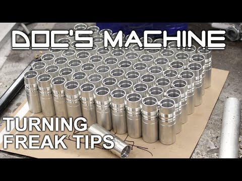

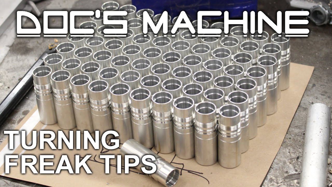

        Mister Video! No, not Captain Video, this was before he became a commissioned officer. :green:
        There were complaints about my videos, that due to the gushing oil, you really couldn't see the actual cutting action. So, I picked up a lightly-used KoolMist sprayer assembly off eBay last week, which sprays a thin mist rather than a stream of liquid, and finally had a chance to try it out.
        I was already in the middle of making a run of tips for the next batch of my "Bull" barrels, so here was an ideal time to try it. (Although I did use some scrap material in the video, as I didn't know how well it'd work or if the surface finish would change. The cutting action is the same, though.)
        The base just clips to the headstock magnetically...
        And the air line just needed a QD and an adapter. I couldn't find my inline regulator, but the mister can take anything from 60 to 120 PSI, and my air system is regulated to 90, so I just ran it straight for now.
        The lightly-used kit I got came without the tank, so I needed a way to hold a little clean oil- I didn't want some of the smut in the main sump to clog the sprayer nozzle. Just as a trial unit, I took an old door-catch magnet and a soup can I usually used to sprinkle floor dry (washed out of course) and made a quickie little container.
        That rests on the inner frame, and the magnet keeps it from tipping or spilling. At some point I'll come up with a proper tank, but this got me going for the moment- and, the mister will pretty much only be used for video demos rather than day-to-day production, so capacity isn't a real issue.
        In this shot, you can just barely see the mist coming out the end of the nozzle.
        I haven't played much with the various mixture settings, to start with I was just happy to see that it did, in fact, work with the cutting oil. I'd worried that it might be too thick for the venturi/siphon effect to be able to pull it up the hose.
        Also for video clarity, I popped the regular oil lines off, and closed the valves- as well as deleting the pump-on command from the program.
        So, without further ado, here's the result!
        And while we're at it, I needed a new tool to be able to do that groove. Previously I'd used the parting tool, but that's a big, beefy assembly that takes up a lot of space on the tool slide. I needed something smaller just to groove, rather than part.
        Luckily I had a chunk of 5/8" cold-rolled in the bins, and a slotting saw of just the right width:
        I tried a much thinner saw to slot it deeper, but it really didn't like that, So I went ahead and drilled and tapped it for the clamping screw...
        Cross-drilled it, finished the slot with a hacksaw, fitted it with one of the leftover MGMN200 inserts, and finished it off with a clamping screw out of the bins.
        And that, to my entirely feigned surprise, worked perfectly.
        That piece, by the way, was simply an accidental test part, as I did a couple cut-and-try cycles to get the tool zero just right. But, that test part kind of actually works.
        That is, it lets you screw two classic Freak tips together, nose to nose. Which, of course, serves absolutely no purpose whatsoever- it's like screwing a pistol to both ends of a silencer. But hey, I don't call myself a mad scientist for nothing!
        That tomfoolery aside- hey, I gotta be allowed my fun- after several days of run time, I had a nice batch of the "Bull" tips in two different lengths, as well as a nice small run of what will become more of my Flashpoint tips.
        Most of the 'Bull' stuff is already off to the anodizer, and with a little luck, and possibly a hefty bribe, I should be able to get those, above, parts and a few other things sent out by early next week.
        Which damn near catches me up to where I was hoping to be... about last June.
        Stand by, more in the way.
        Doc.​
