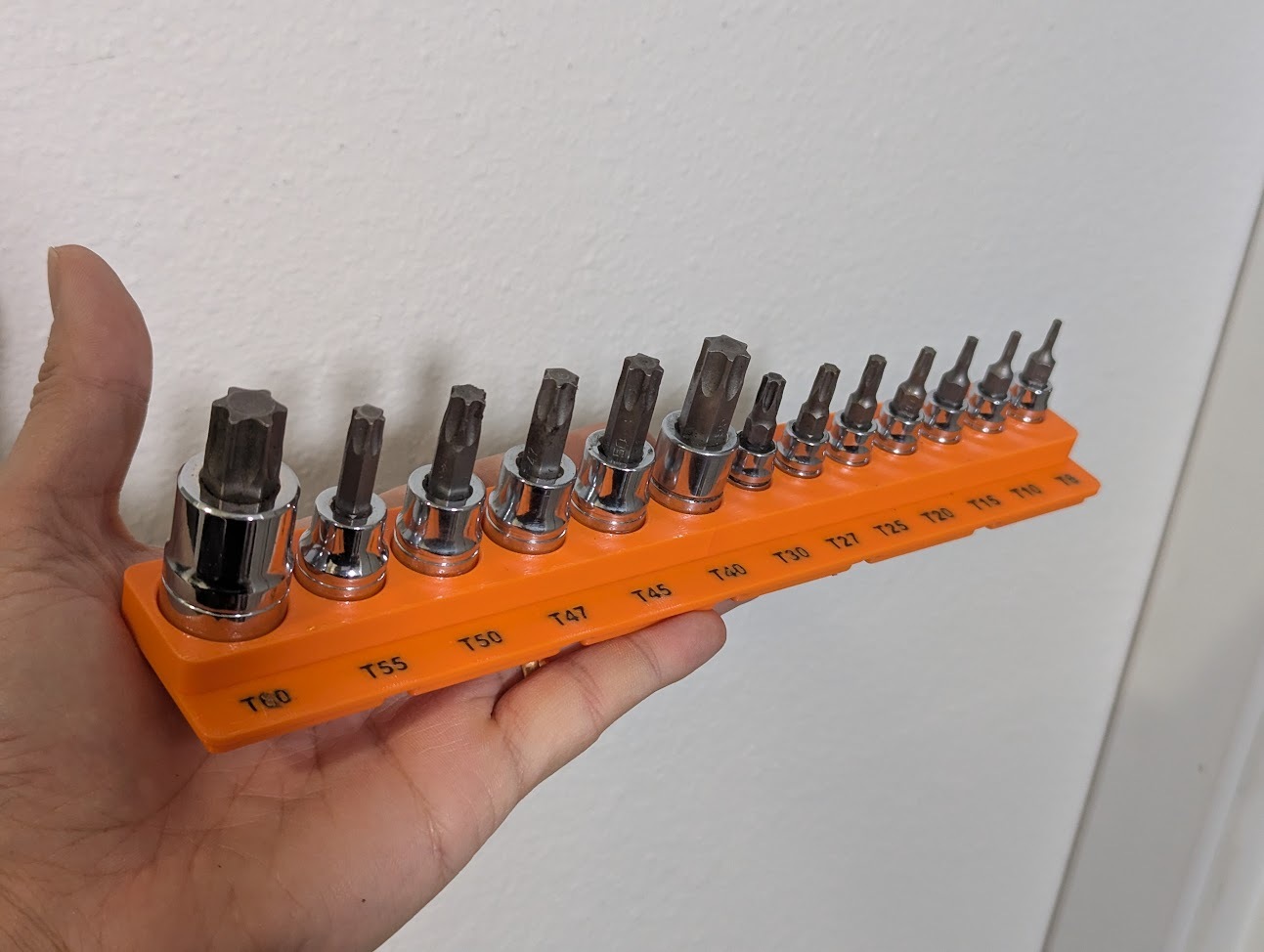

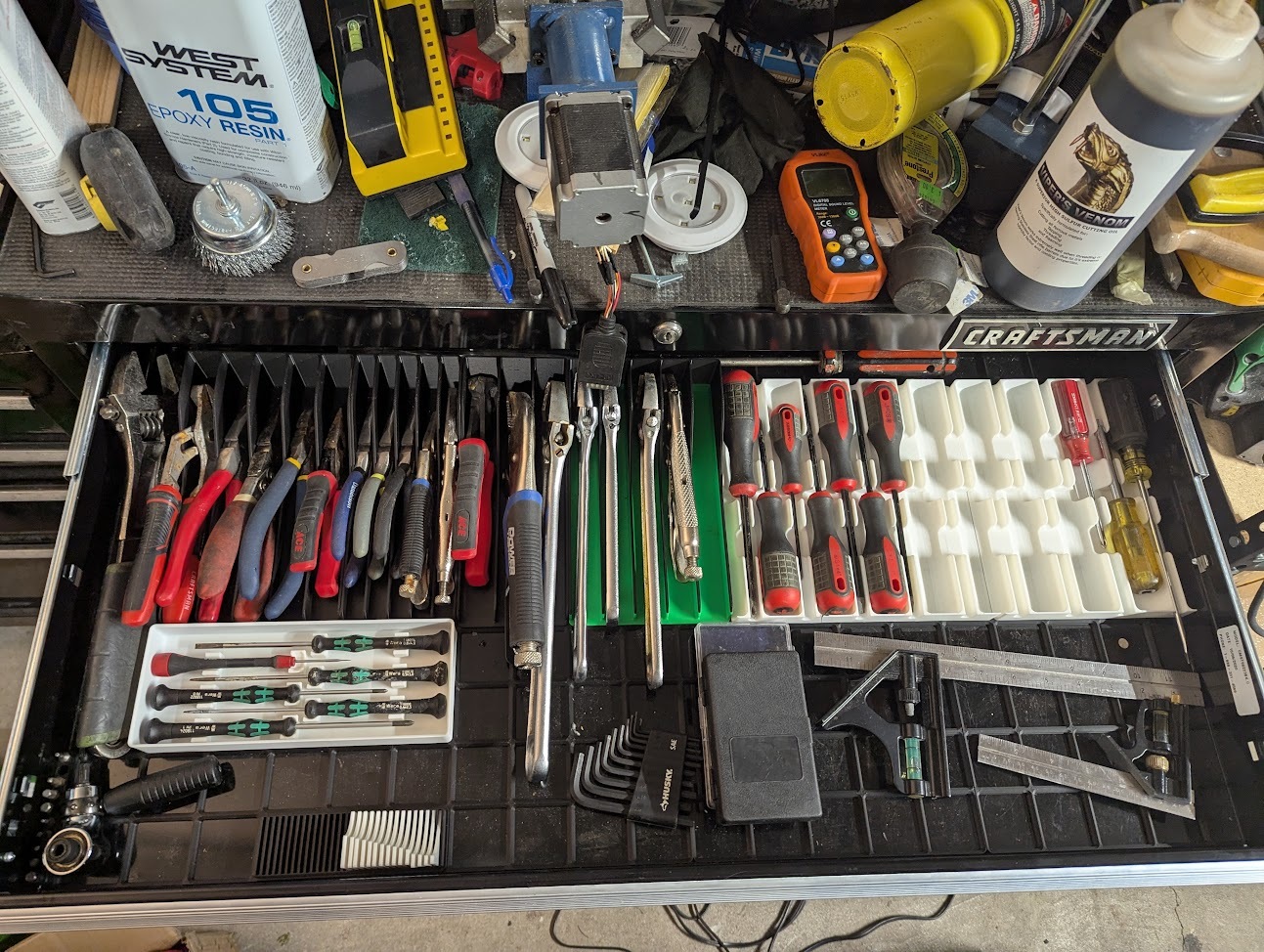

                        #208
                        I started using the gridfinity system for organizing my tools. It's fairly popular in the 3D printing hobby space. There are some things I don't like about it, like the 42mm spacing being chosen as a Hitchhiker's Guide joke (but it's not a natural fit for anything, metric or imperial), and I don't bother putting magnets into it (cool points wankery). Overall though, it's a neat system that is easily customizable. There's a guy who made a Fusion 360 plugin that creates the bases for you, so I just use that to make a blank canvas and build my custom storage on top of it. Plenty of other stuff like hand tool dividers and assorted bins can be found ready to print online.Click image for larger version
Name:	Torx Bit Storage.jpg
                        Click image for larger version  Name:	gridfinity organization.jpg Views:	0 Size:	477.2 KB ID:	644500

                          The Hobbit commented
                          Now I feel like I need a 3d printer to organize my toolbox.
                        • superman
                          superman commented
                          This is something i have been meaning to try and figure out, but the last thing i need is another project. lol
                        • DocsMachine
                          DocsMachine commented
                          Yep, been following the Gridfinity stuff for a while. It has it's pluses, definitely, but I'm hobbled a bit by not having my own 3D printer...
                          Doc.
