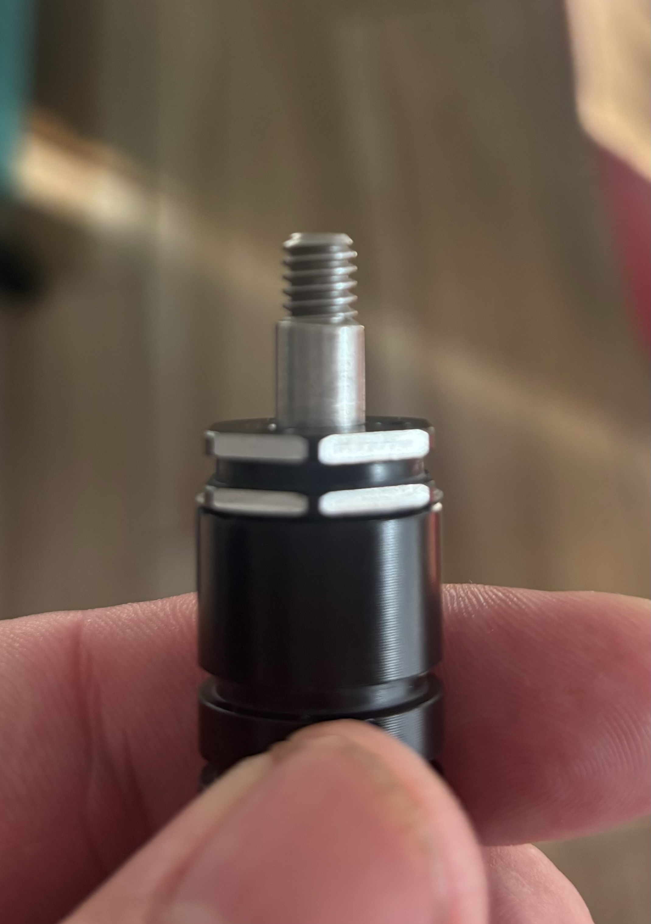

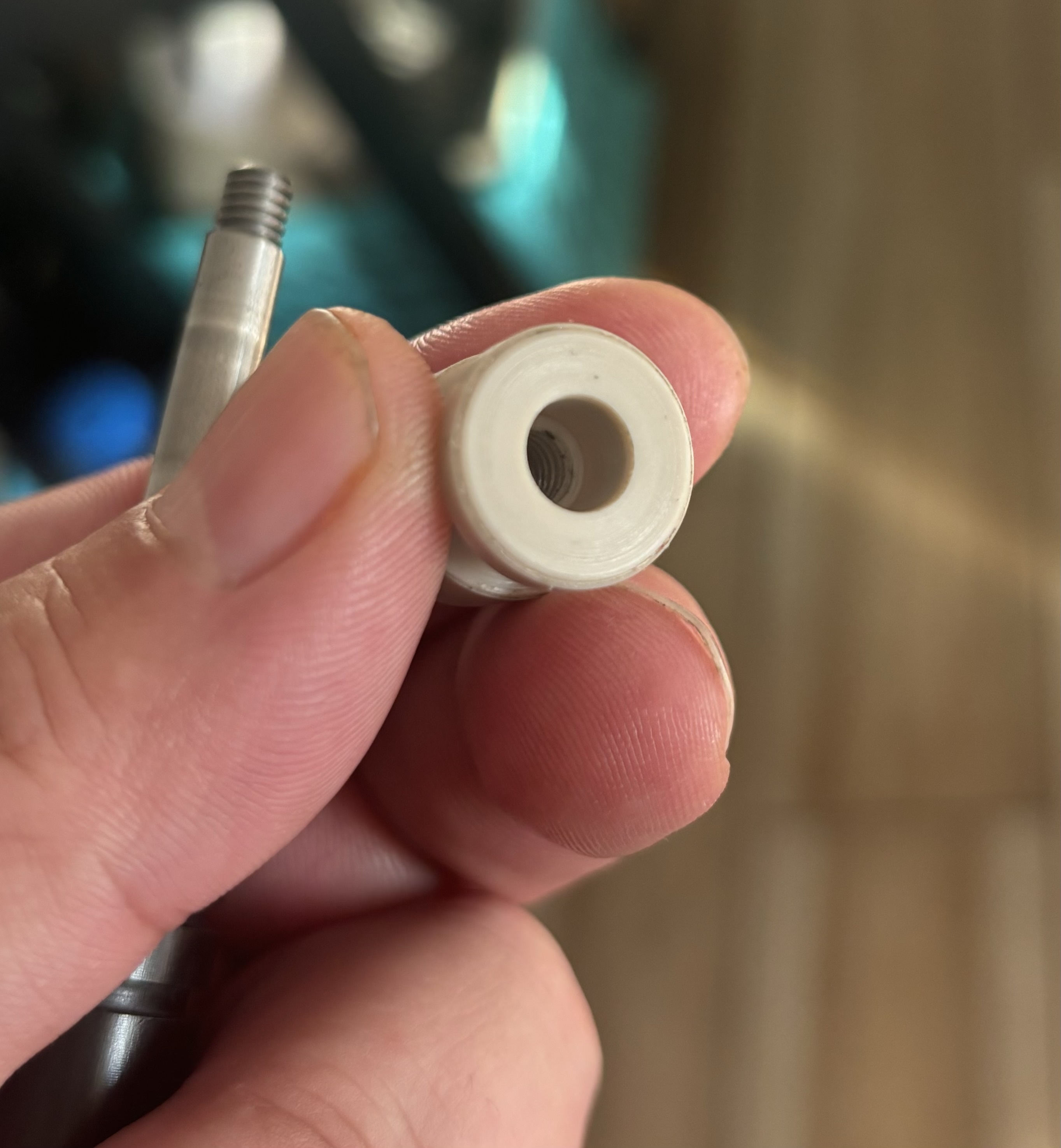

                  The first picture is how much of the stock shaft protrudes even when in the rear most position, the second picture shows the shoulder within the hammer that the shaft seats against when fully screwed together.. you have two design options to make, you can run the rearward bumper exactly like stock, but it puts a ton of pressure on the hammer and will quickly break the hammer, or you can rig up some kind of rearward bumper inside the ram… this can be tricky depending on how you do it.

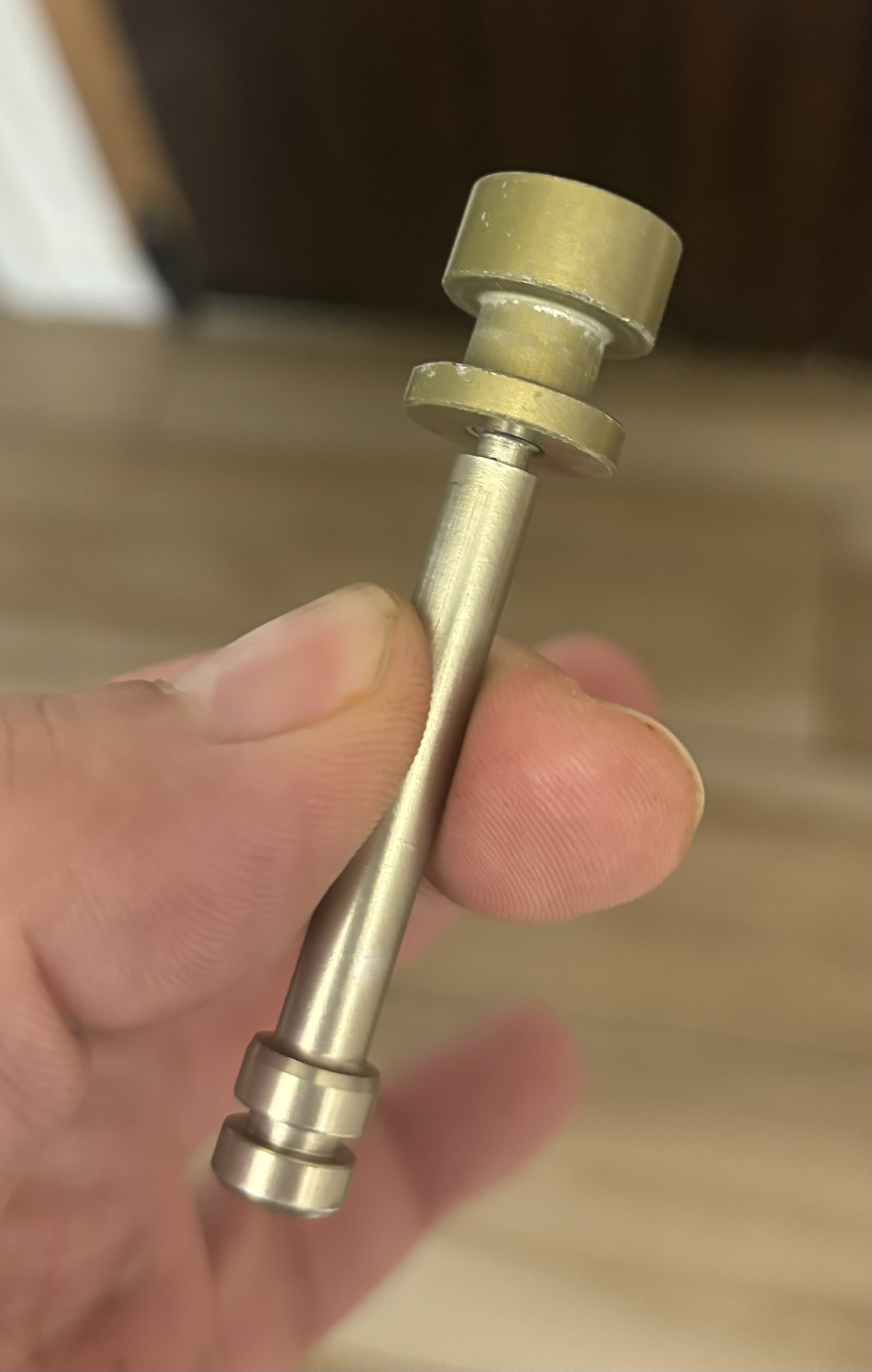

                    Here is the hammer and Ram shaft of the destructive customs Robtown valve, these are most like 7000 series aluminum but notice how the shaft seats against the face of the hammer, not within it. I had luck with hammers that seat against the face BUT had a much longer threaded section inside the ram shaft (more surface area to absorb the load of absorbing the rearward travel)..

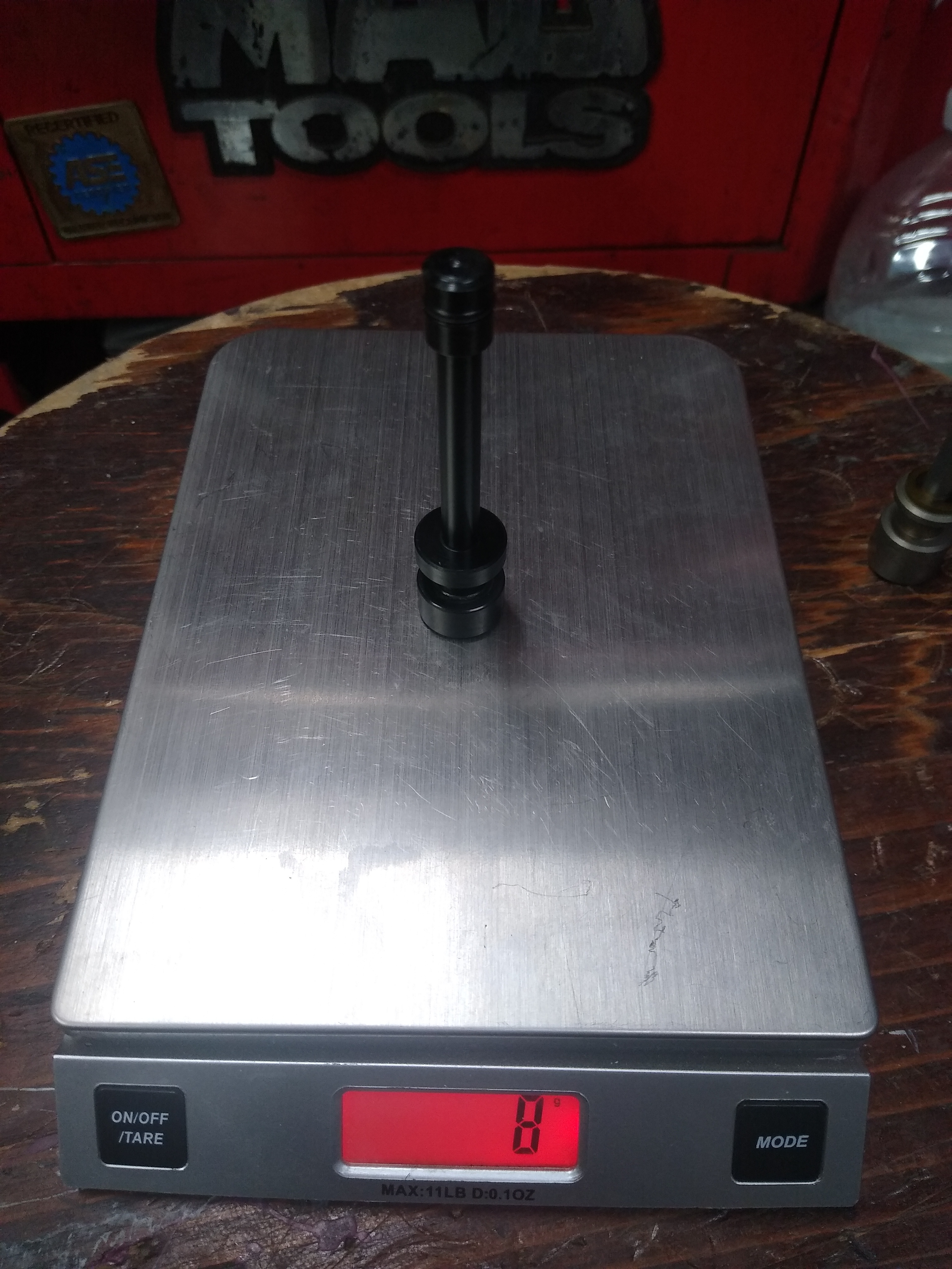

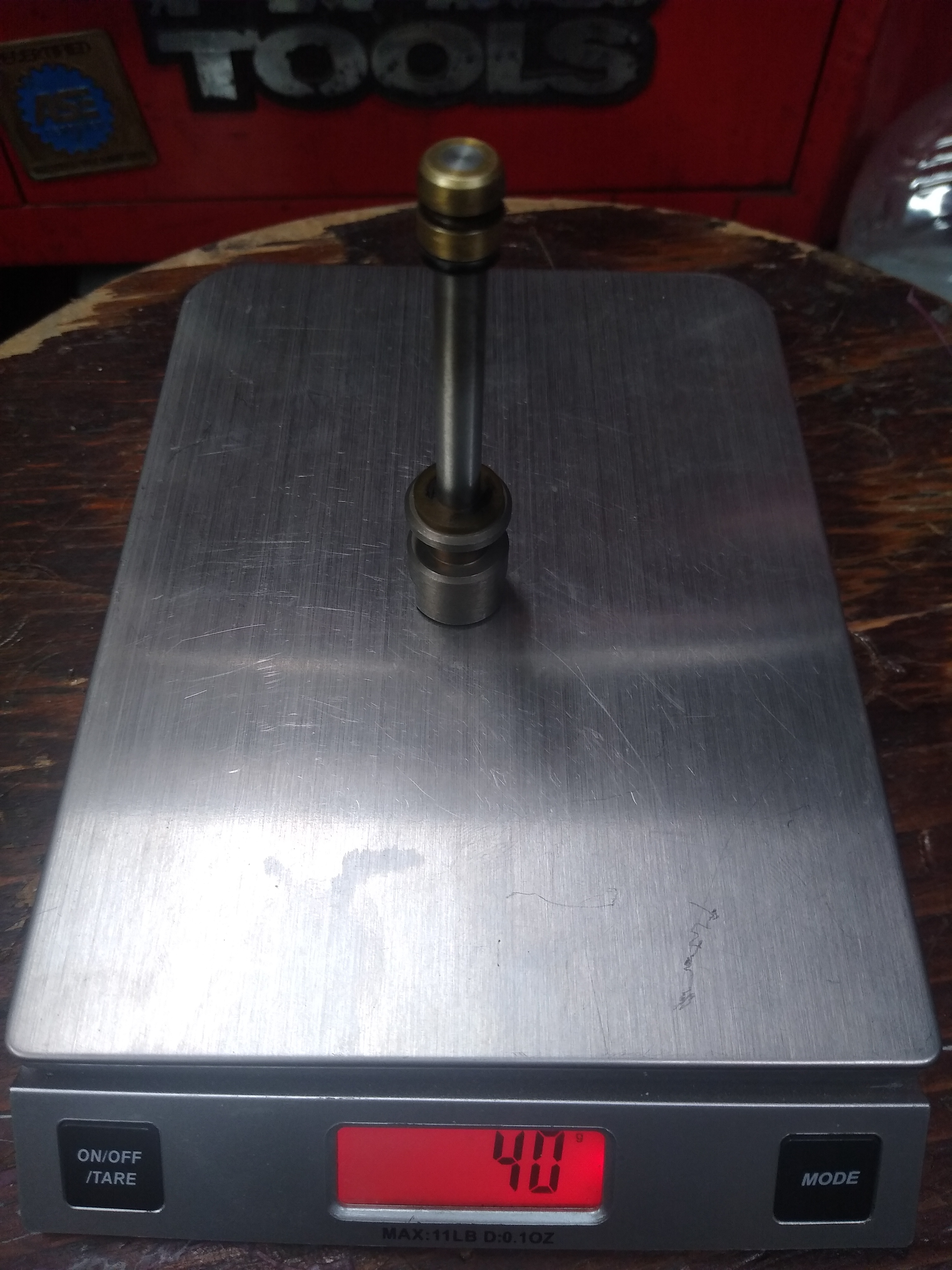

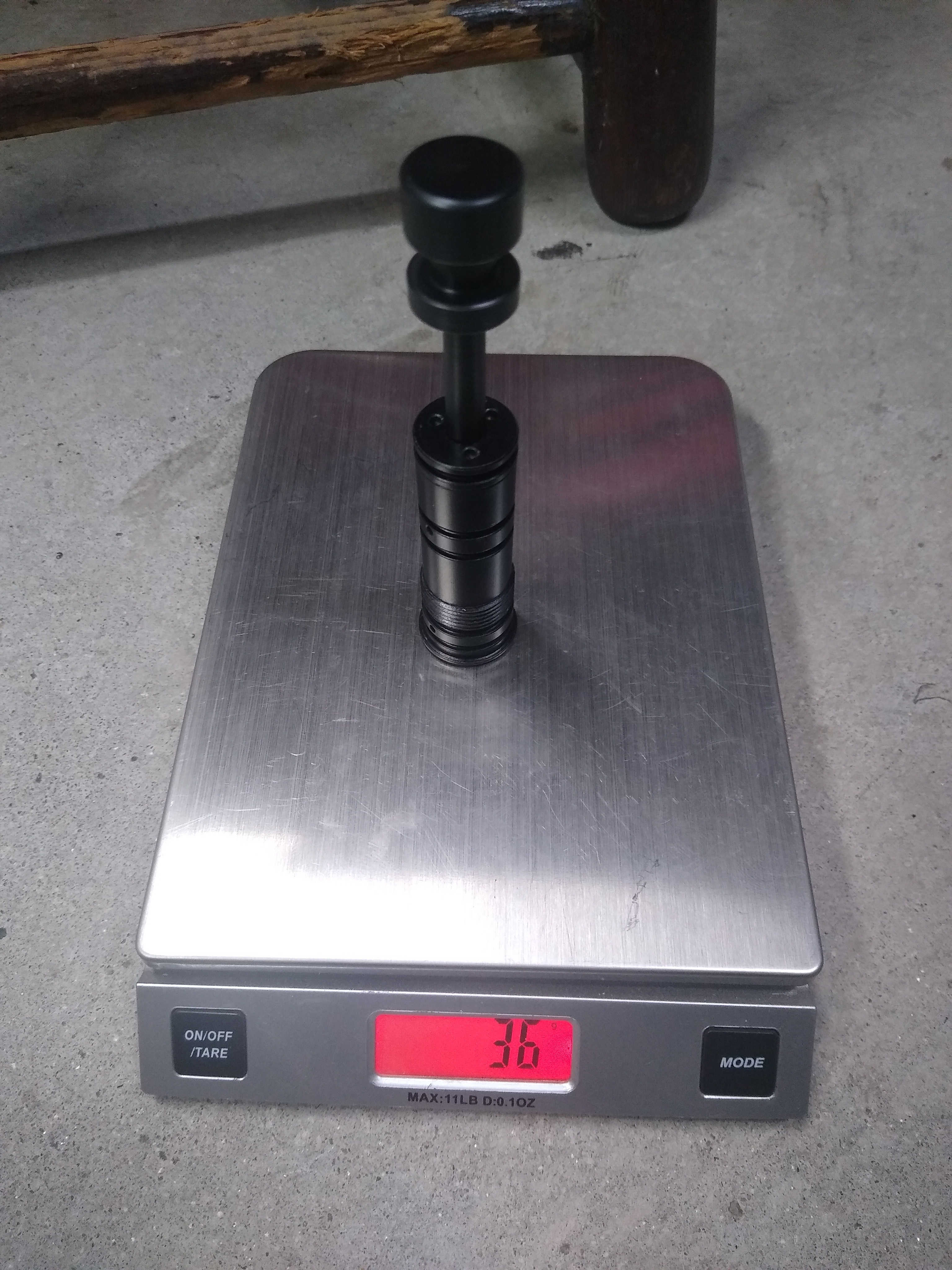

                      A steel ram shaft and composite hammer is a nice balance point for me.. aluminum shaft and composite hammer (annd cut down bolt) ended up being too light and needed a higher LPR. I prefer slightly heavier ram assembly and lower LPR. Plus the hardened, ground polished rod I used made it buttery smooth

                          two problems, a shorter hammer means the back ledge that supports the bolt pin would be thinner and more likely to break. Also means the ram would be stopped by slamming into the ram housing... thats why I talked about the internal bumper.
