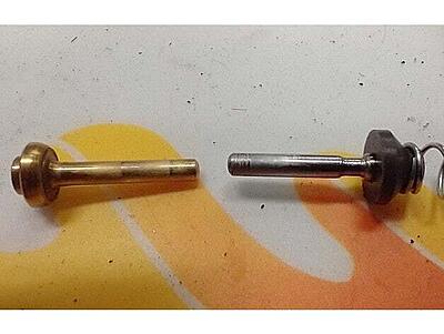

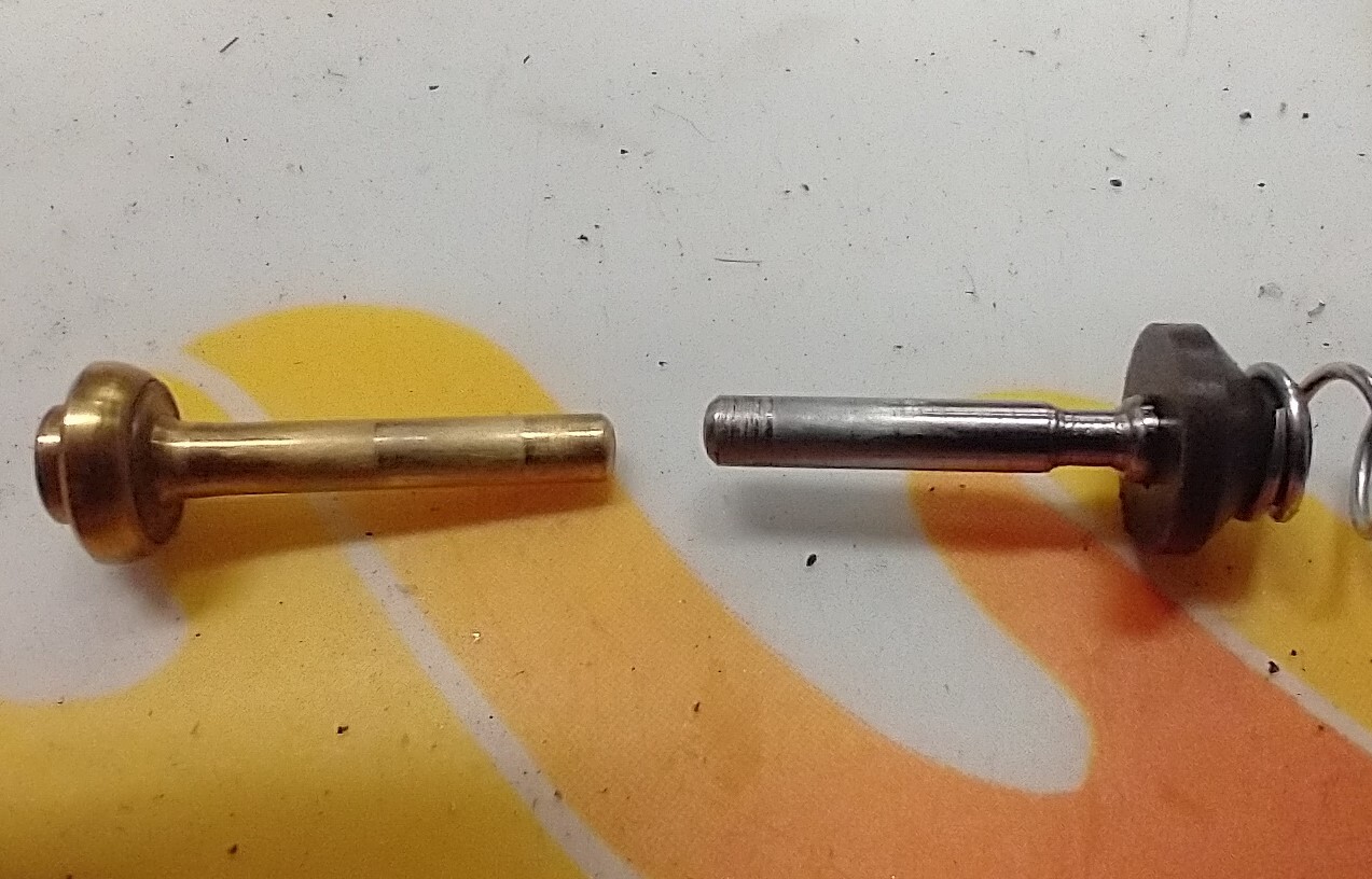

During the damndemic, I picked up a Piranha long barrel for a project. It already had a light hammer and Cooper-T adjuster. After setting up some detents and fixing other fiddly items, I set about trying to play with it. I found the velocity with 12 grams just as ugly and varied as I had in the 90s with my first one. Hot first shots, large multi-shot drop-off, slowly drooping velocity in the last half of the cartridge, etc. Thinking back to Project Leprechaun and the JT ER2, I decided to replace the poppet. Looking at the original, the rounded edge on the face side is actually defeating turbulence, making the poppet almost immune to changes in flow. I designed a fat, square-edged face seal, the first iteration was 0.484" in diameter which was very tight for flow. The print has 6-32 threads to fit on the stainless stem I made for it (not my prettiest work). This was apparently too tight, as I could only get between 140 and 180 fps with my adjuster. My second seal is 0.440" in diameter. It is shooting 260 fps with the adjuster backed all the way off. Consistency has been very good on the first 12g, +/-3. The only thing changed was the poppet seal diameter.
When I installed the seals, I used a little bit of blue loctite. When I changed the seals, I put the stem in a vise and used a pair of vice grips to twist the seal off. Afterward, I'm not seeing any marks on the old seat; that TPU is tough. The seat is Prusaflex 98A (98A being the approximate durometer). I narrowed the waist of the valve stem to increase the flow area and hopefully the drag forces. I still have to check the efficiency numbers in play, but I expect they will be slightly better once I learn to count off the right number. I've always changed early when it started to droop.
