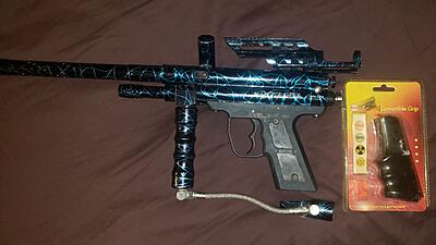

      Awesome! Thanks for the reply, this is my tribute I'm hoping to keep the pump kit and milling minimal so you can see the anodizing I got some jb weld on the valve stem, another question spyder parts are fairly interchangeable with a pmi piranha right?
        Generally, no... They are just a smidge out of spec from each other to make it more work to get stuff to work properly (especially when modding a Spyder is already the focus of your project.) If the fishy is your platform, just Spump the fish, especially since the grip frame will be your biggest point of contention.

          This is where my lack of other marker knowledge shows, the spump mod should work the same correct? Also anyone know where to get an oring rebuild for it or spare parts?
            Yeah, the conversion will be 100% exactly the same. Before the 2.0 death, Skipdogg was trying to get rid of a bunch of fish parts. Hit him up.
