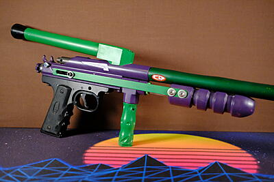

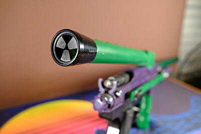

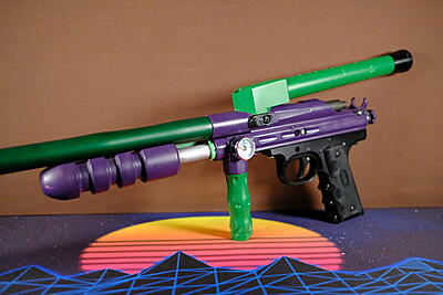

    I used to have a build thread on this Spyder pump a decade ago, but seeing as how that's lost and I take better photographs now, I figured I'd throw it back up here.
    This thing started life as Spyder Electra DX from roughly 2002. The electronic sear tripper frame was swapped out for an aftermarket single trigger mechanical frame. The valve was "modified" to make it not blow back by adding JB weld to the flat side of the valve stem and was then turned back to round on the lathe, this mostly worked.

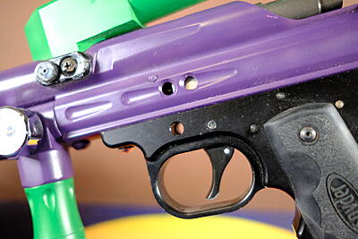

    There's still a decent amount of gas that escapes around the valve stem so I milled flats in the side of the hammer to reduce blowback, and then eventually I drilled two vent holes on each side of the body just to the rear of the valve body. It's functional but makes quite the fart sound.

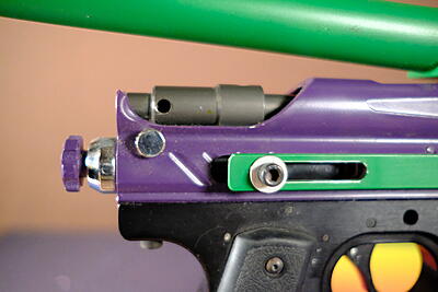

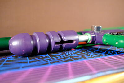

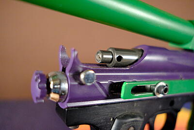

    The gun actually fires from an open bolt as I left the bolt and hammer connected together, and the decoupling happens via a big slot in the pump rod. The pump rod is attached to the old cocking handle hole in the hammer via a bolt, washer, and a little turned spacer with a shoulder on it. This cocking bolt coming loose is probably the least reliable part of the whole gun.

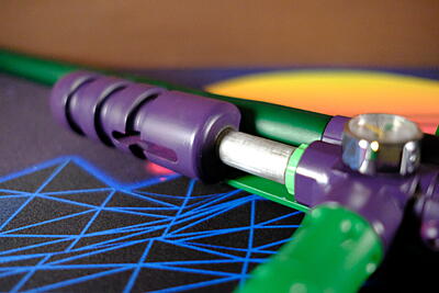

    The pump handle is a gigantic piece of solid aluminum, with bronze bushings pressed into it. It rides on the stock expansion chamber that was turned down to make it smooth, And there's a plug pressed into the front end of the expansion chamber with a bolt coming out the bottom. That bolt slides in slot in the bottom of the pump handle and that's what keeps the pump handle from sliding off.

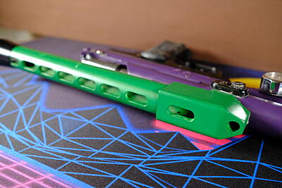

      The stick feed is a 1" aluminum tube with an .125" wall pressed into a big block that bolts onto the stock feed-neck tapped holes. It does only use the front bolt, but it hasn't broken yet. The feed gate is a purchased delrin piece that's just pressed onto the tube. I think it holds about 15 balls.
        Do you run it on 12g's or bottle? Really cool either way!
          I used to run it on a 9oz CO2 bottle, last time out was on a small HPA bottle. It isn't particularly efficient with all the farting so I never tried 12 grams.
