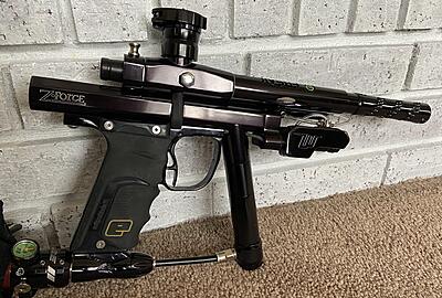

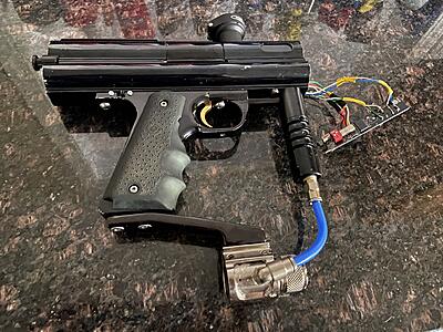

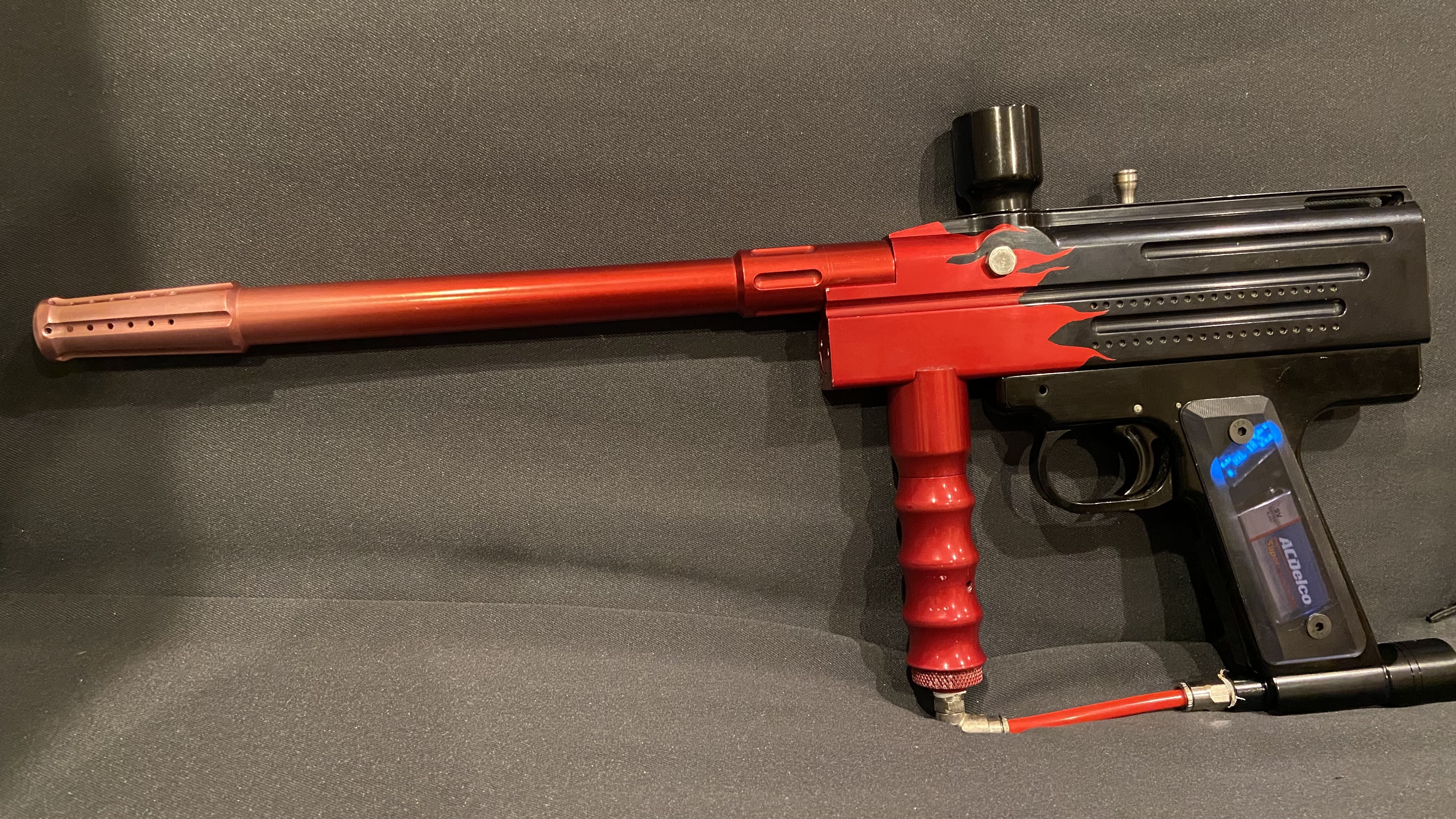

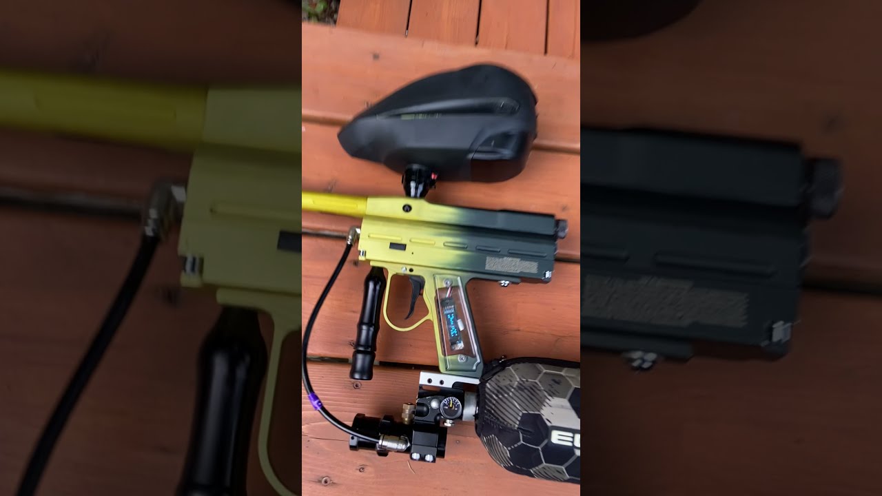

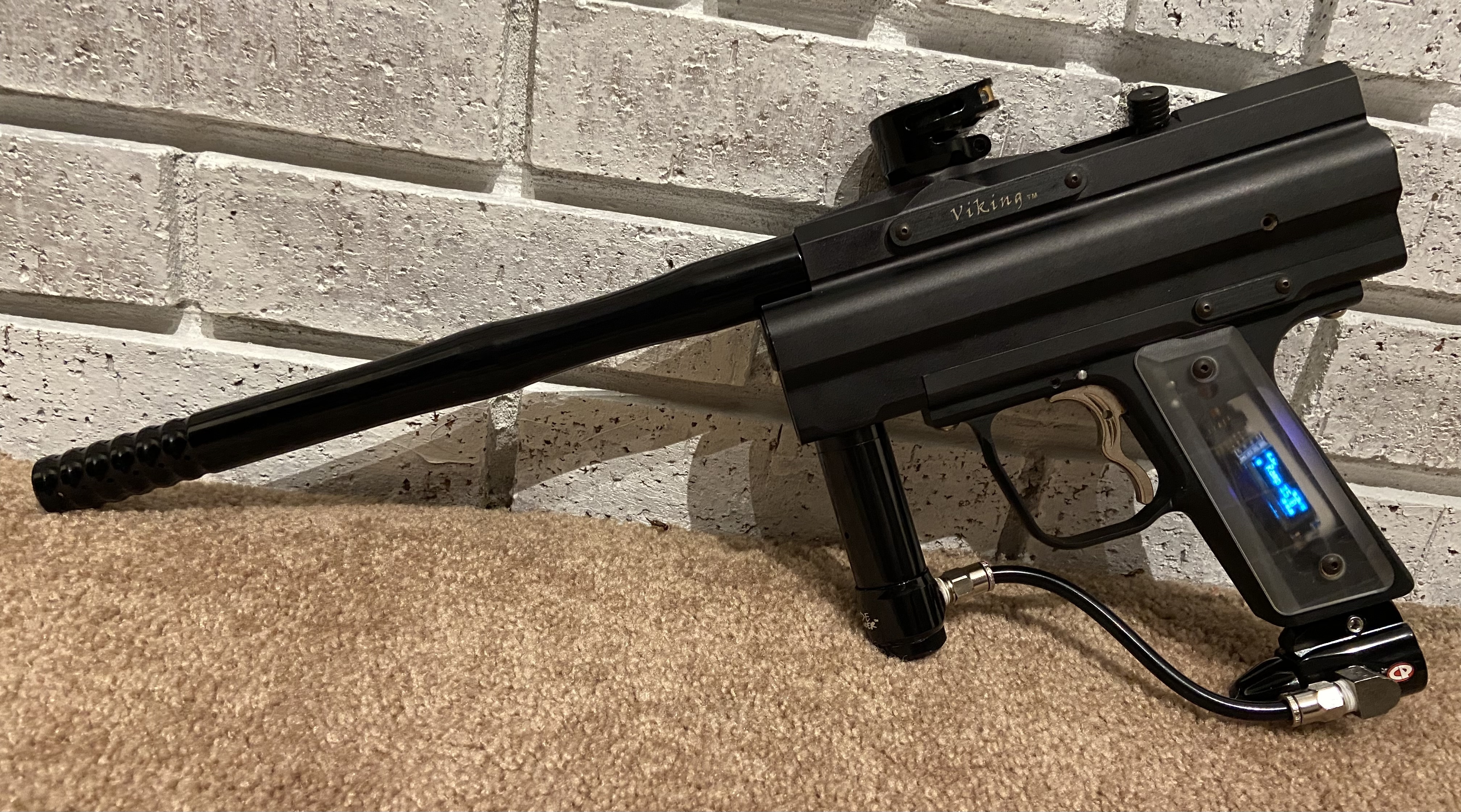

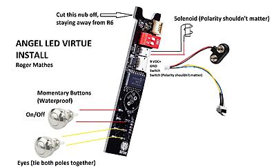

    Nothing super custom just all the recent swaps I’ve done. I’ll put up drawings and board settings to maybe help those in the future.
    • Angel LED w/virtue PM7 board
    • Gen E Matrix w/Morlock MK3
    • Shocker Sport w/Morlock MK3
    • Rainmaker w/Morlock MK3
    • Tribal BBT w/Morlock MK3
    • AKA Viking w/Morlock MK3
    • zForce Autococker w/Morlock MK3

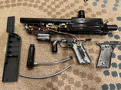

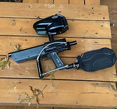

            I'm a bit disappointed you didn't try to fit the battery and board inside the frame on the Rainmaker. 🙂
            Nice work on everything, though!
            • Roger7pball

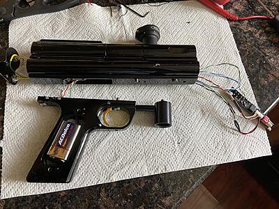

              Roger7pball commented
              Thank you! I know a lot of people get rid of the plastic shroud but I love the look. So the batteries stayed up there. Might wire in a 9 volt or LiPo cell someday.

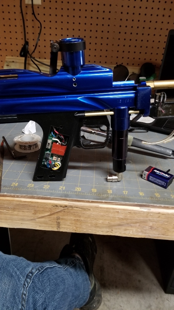

            • Rainmaker
              Der Printermeister
              • 1579
              • Cincinnati

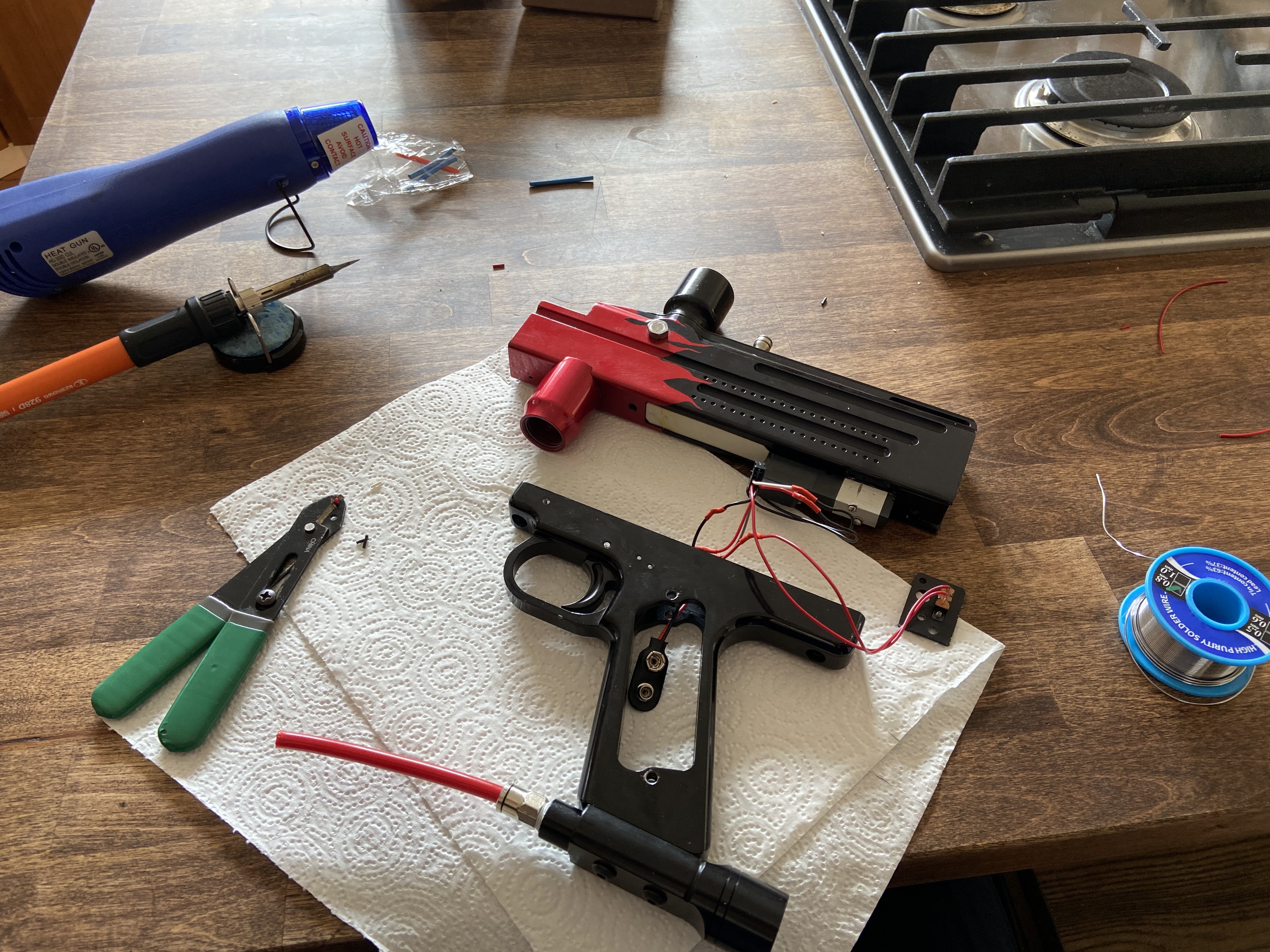

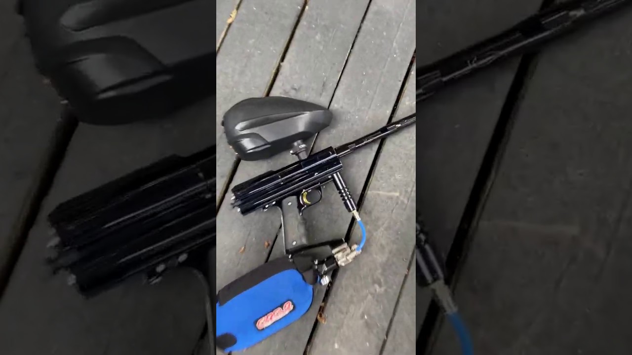

              Not necessarily a board "swap", but I did put a Rainmaker board (and solenoid) on an autococker...
              (Leg left in for Grendel )

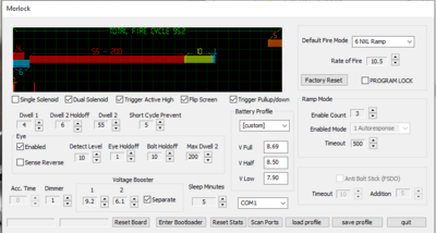

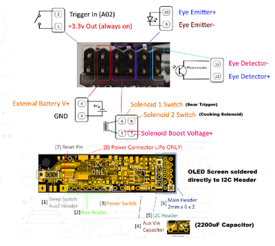

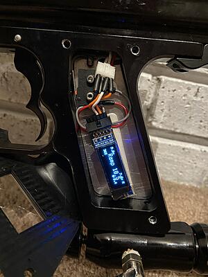

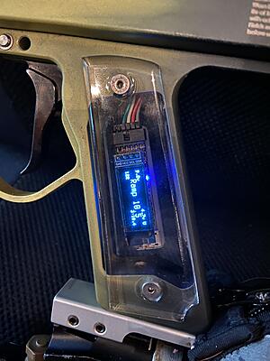

              How do you like the morlocks so far?
              • Roger7pball
                I like them a lot. I like the price, the programming app, the small size, the OLED screen, the fact that the designer is a member here and very reachable, and the fact I can pull the board/screen from one marker - reflash it - then stick it in another marker if need be.
                It’s a little more work to install than standard boards but I like the freedom.

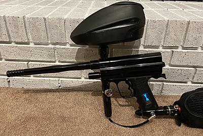

                Saw you said you were looking for a clamping feedneck. Most tribals used 13/16"-32 UN threads.
                Many markers used that threads
                Original impulses/ions/sfts/intimidators. If you have one laying around see if it threads up. All 5 of mine use ion feednecks.
              • Roger7pball
                Thanks for the heads up. I had read the Tribals are 28 tpi, while Impulse was 32 tpi. But if I get my hands on one I’ll give it a try without forcing anything.

              I love that Tribals are clearly Cocker extrusions with stuff bolted to them.
              • Roger7pball
                It makes finding detents and barrels easy! Finding a clamping feedneck is another story, one I’m taking up with Nummech.

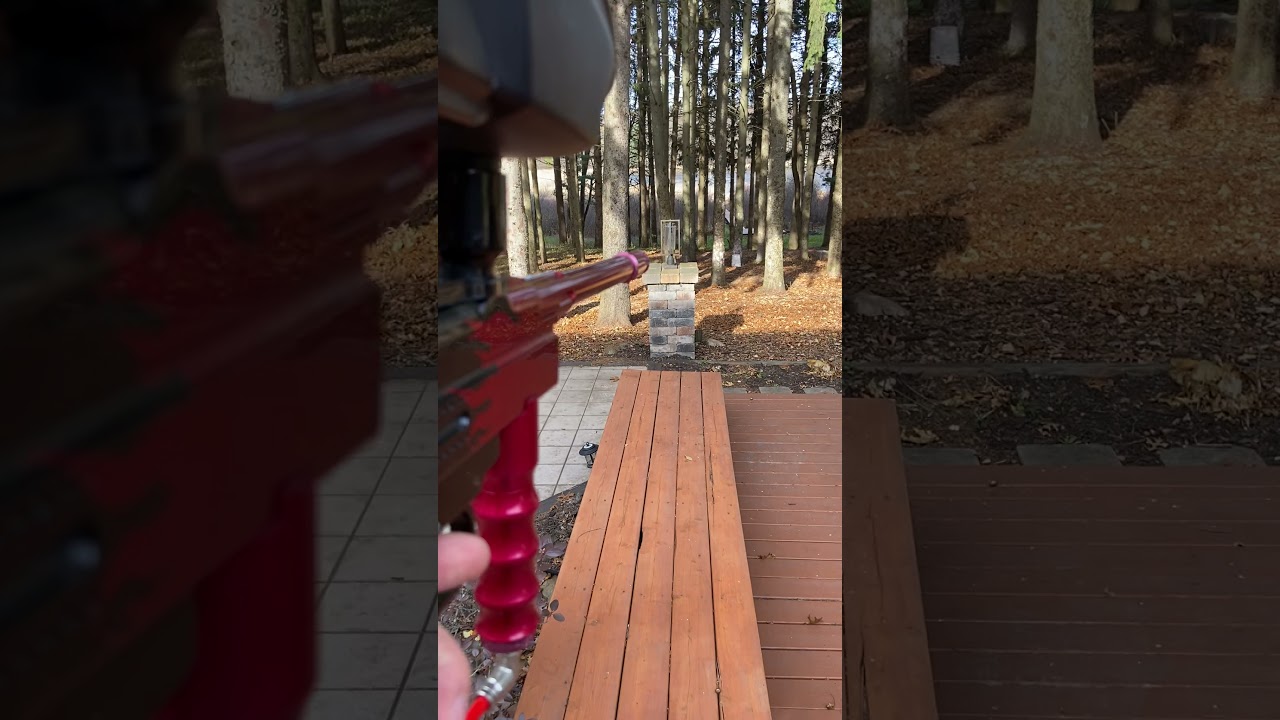

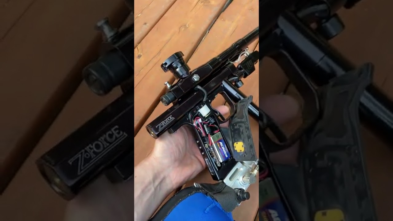

              • Roger7pball
                Reflective under the breach, but I’m out of town for a few weeks so haven’t had a chance to play with the vision settings much.  Capacitor is soldered to the Aux Capacitor location on the board.  The board was resetting when trying to cycle the solenoids.
              • Frmrspec
                Frmrspec commented
                Do you think the board resetting was because the power draw of those solenoids are just too high? .
              • Roger7pball
                Yeah the power draw of the pancake solenoids are relatively high.
