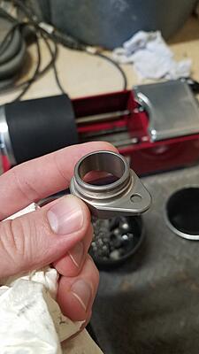

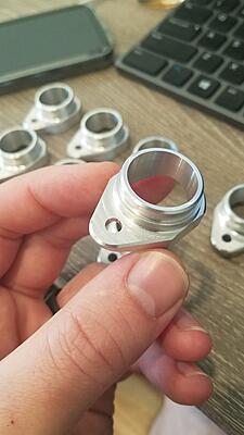

              Originally posted by Spider!
              You might ask LukeAO . He uses some pretty course stuff. It leaves marks, but they don't survive a deep anodizing.
              I use plastic media but it's for deburring and removing minor machining marks, its not meant to be for polishing, steel wool wipes the tumbling marks off in just a few seconds.
              I use several different shapes depending on the parts in the tank, here's an example of one of them:
