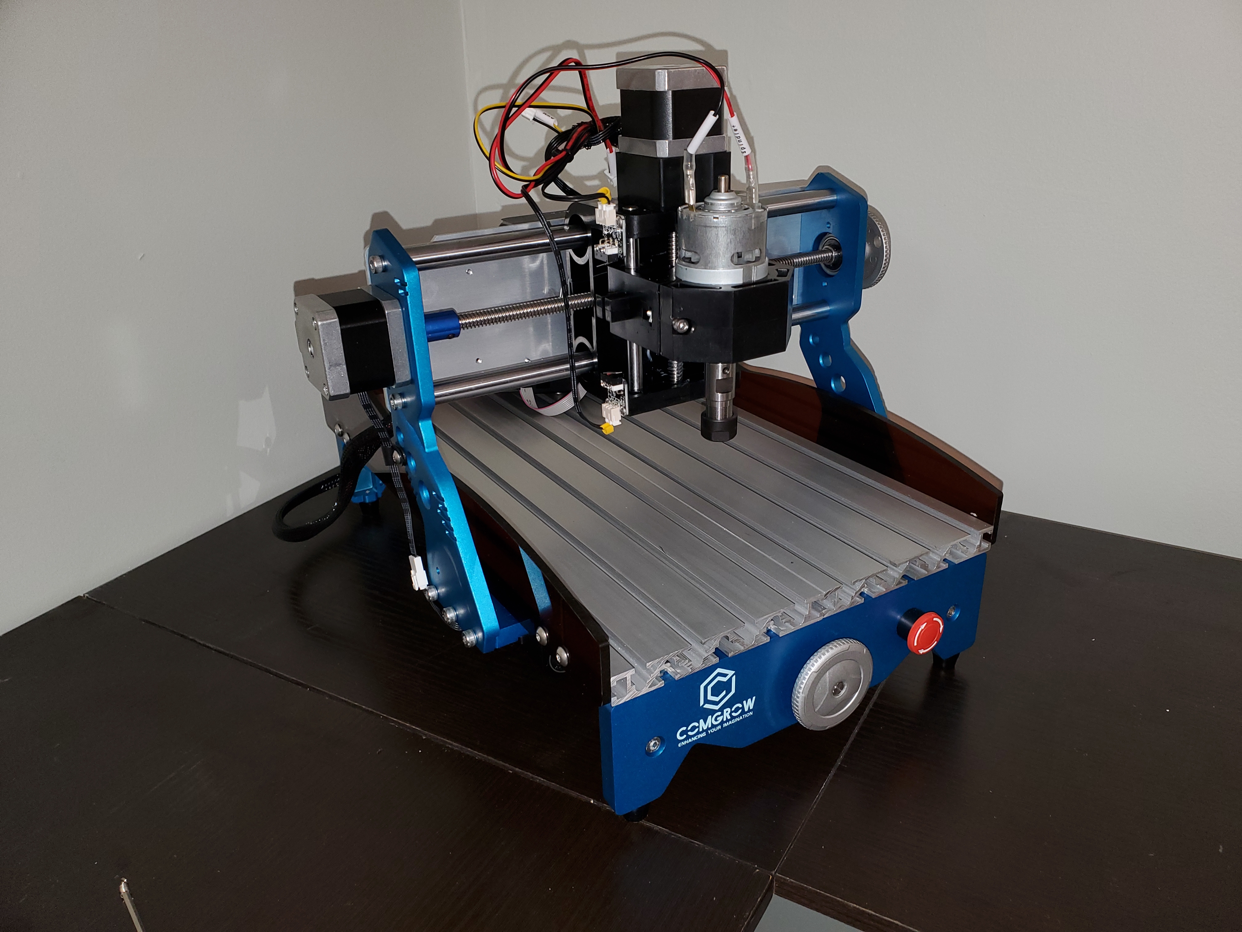

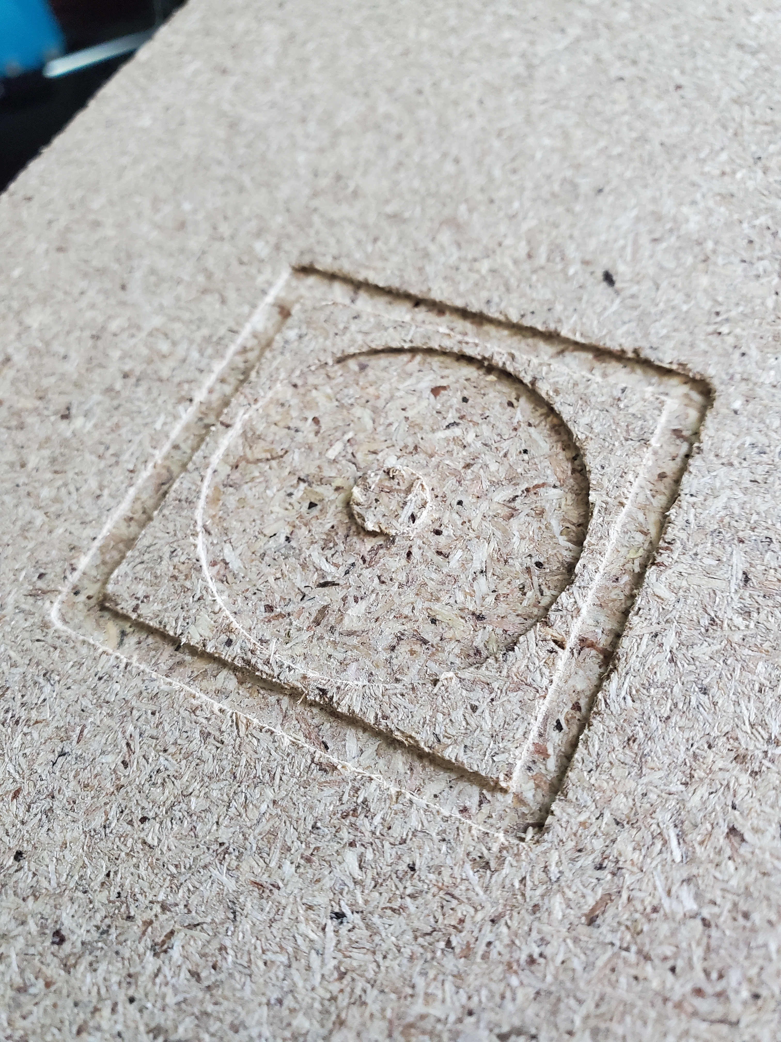

            Here it is. The el-cheapo, hobby grade (or lower) Comgrow ROBO CNC! After assembly and a little trial and error, I was able to run the sample Gcode with decent success.

              It's not terrible. I've been able to run a couple hole boring routines exported straight from Fusion 360, so that's really encouraging. I have a specific task in mind that is giving me some issues, particularly i'm already a little disappointed in the amount of Z-height that i have to work with. But I have an idea or two to work around it for now.

              Tbh that machine does not look like it will handle aluminium, but it might just be a matter of upgrading the spindle.
              XEMON commented
              The common upgrade seam to put a 300w or 500w spindle and it appears it can make light pass in aluminum ... But I tend to not trust random internet "finding" ... That's how you get 100 shot per 12g 🤣
