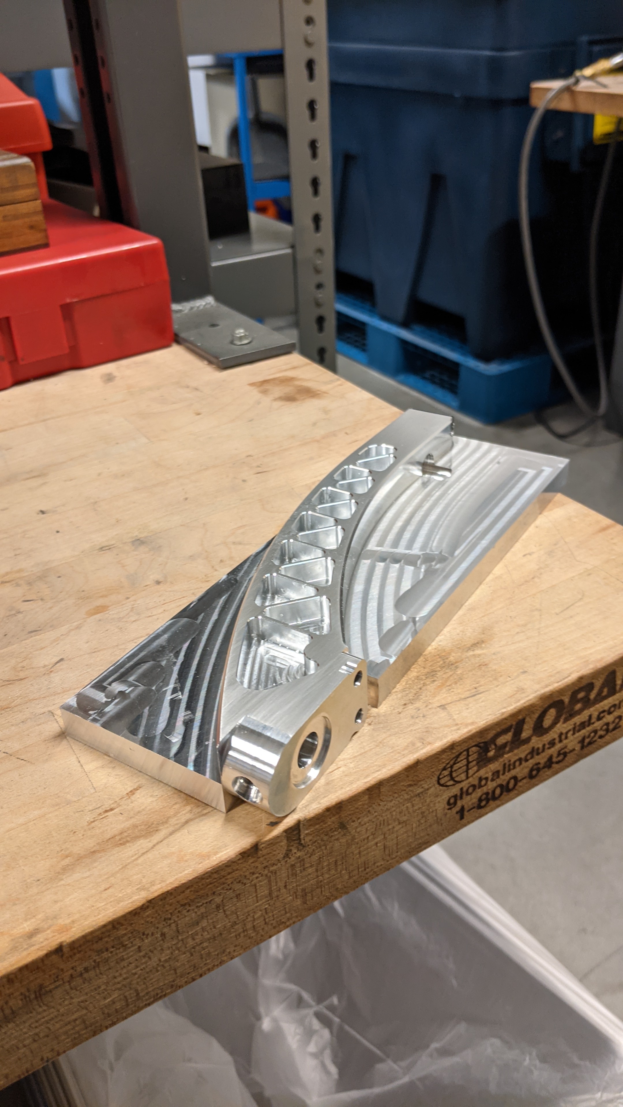

    I've held onto and used a Spyder TL+ with a 6" drop forward for all these years and when I recently got back into paintball I decided to get with the times and pick up an Emek. Simple, reliable, easy on paint, and uses modern air handling concepts. However, there no longer exists any person dumb enough to want massive drop forwards on a modern marker... guess that means it's time to fire up the CNC mill.

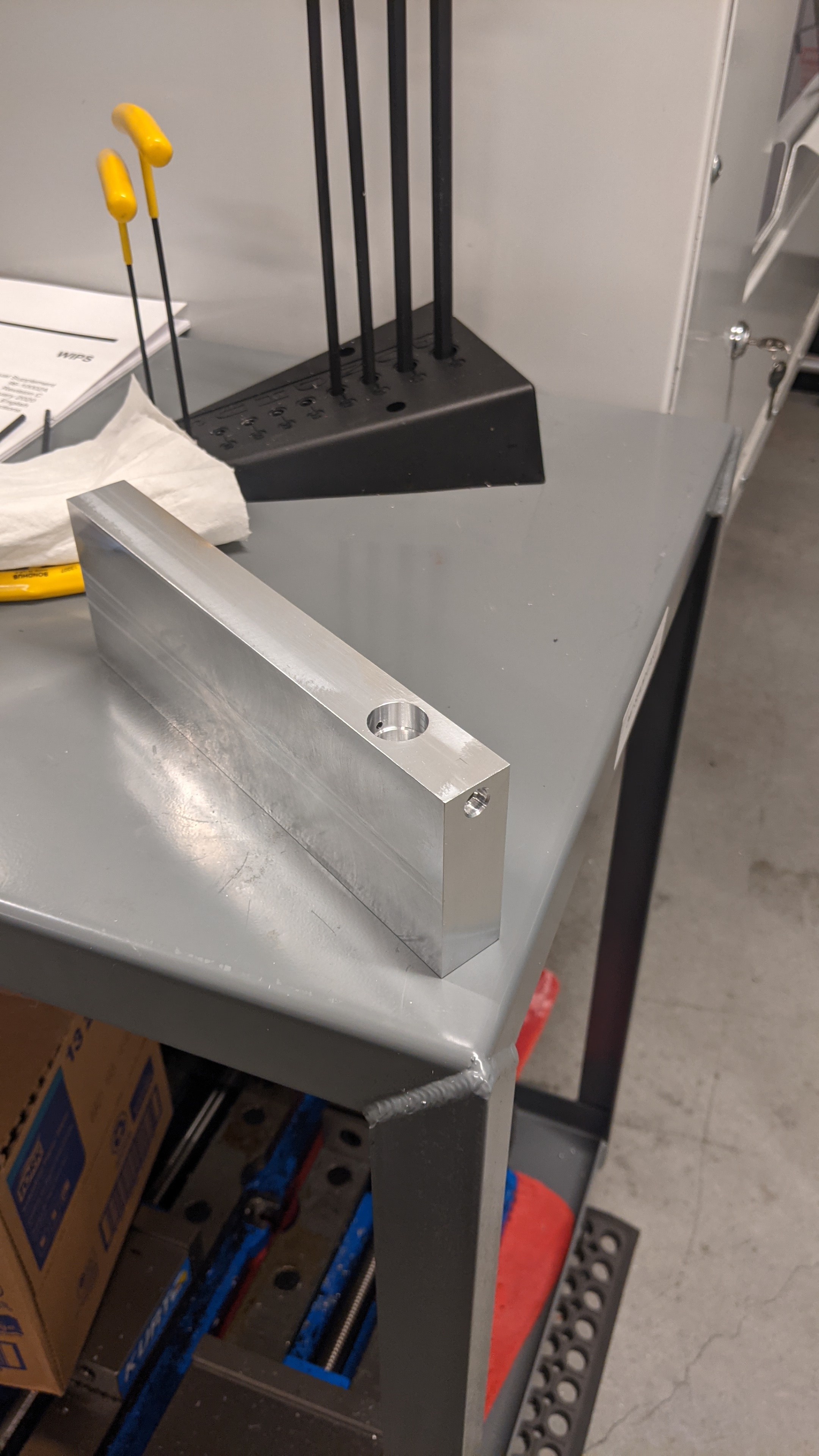

    Square and true block of 7075 with ASA porting cut in.

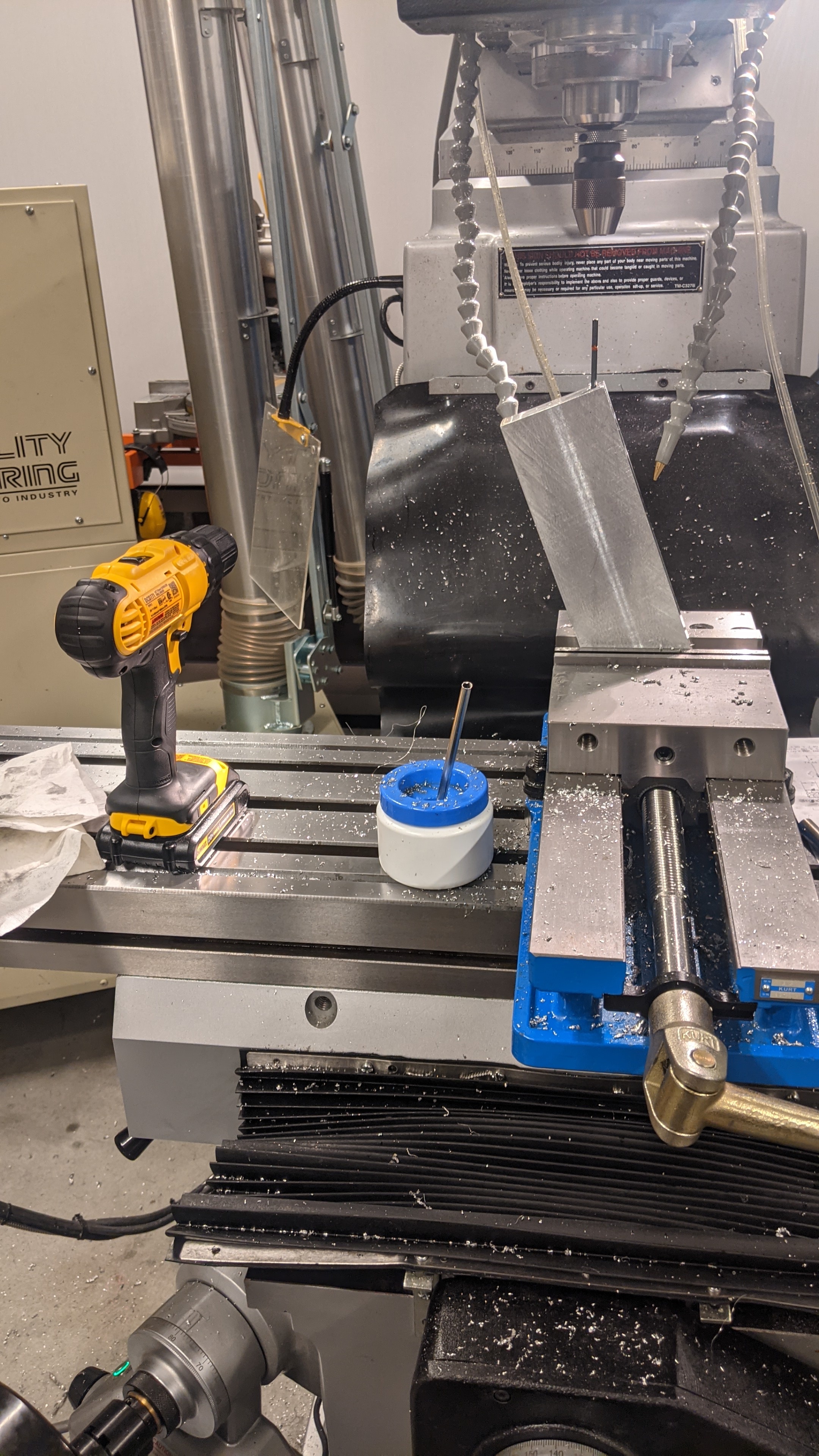

    Doing the long bore. 180mm with 4mm OD drill. (It went just fine thank you very much)

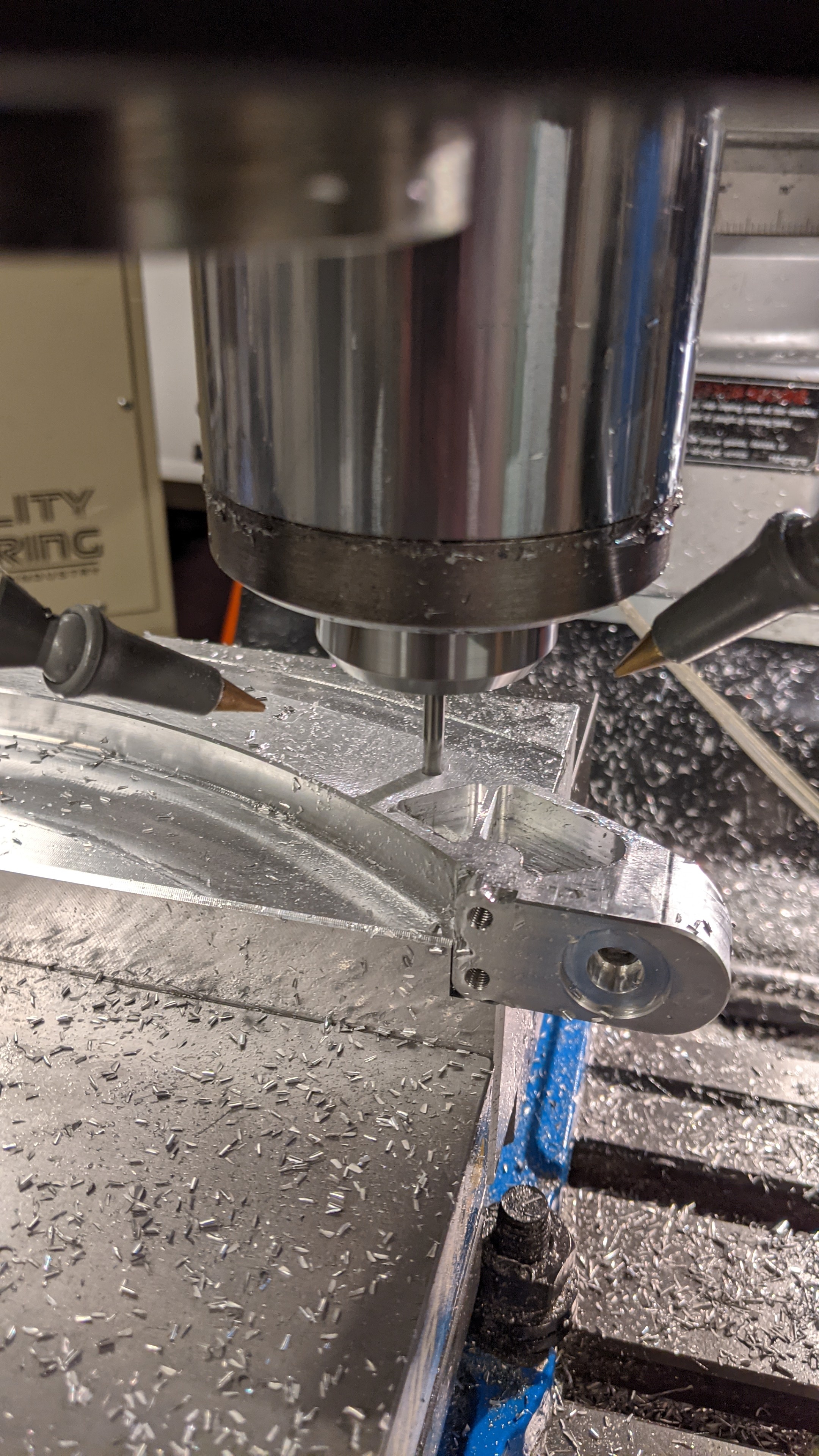

    Profiled and webbing cut.
    Machining side 2 in some soft jaws.

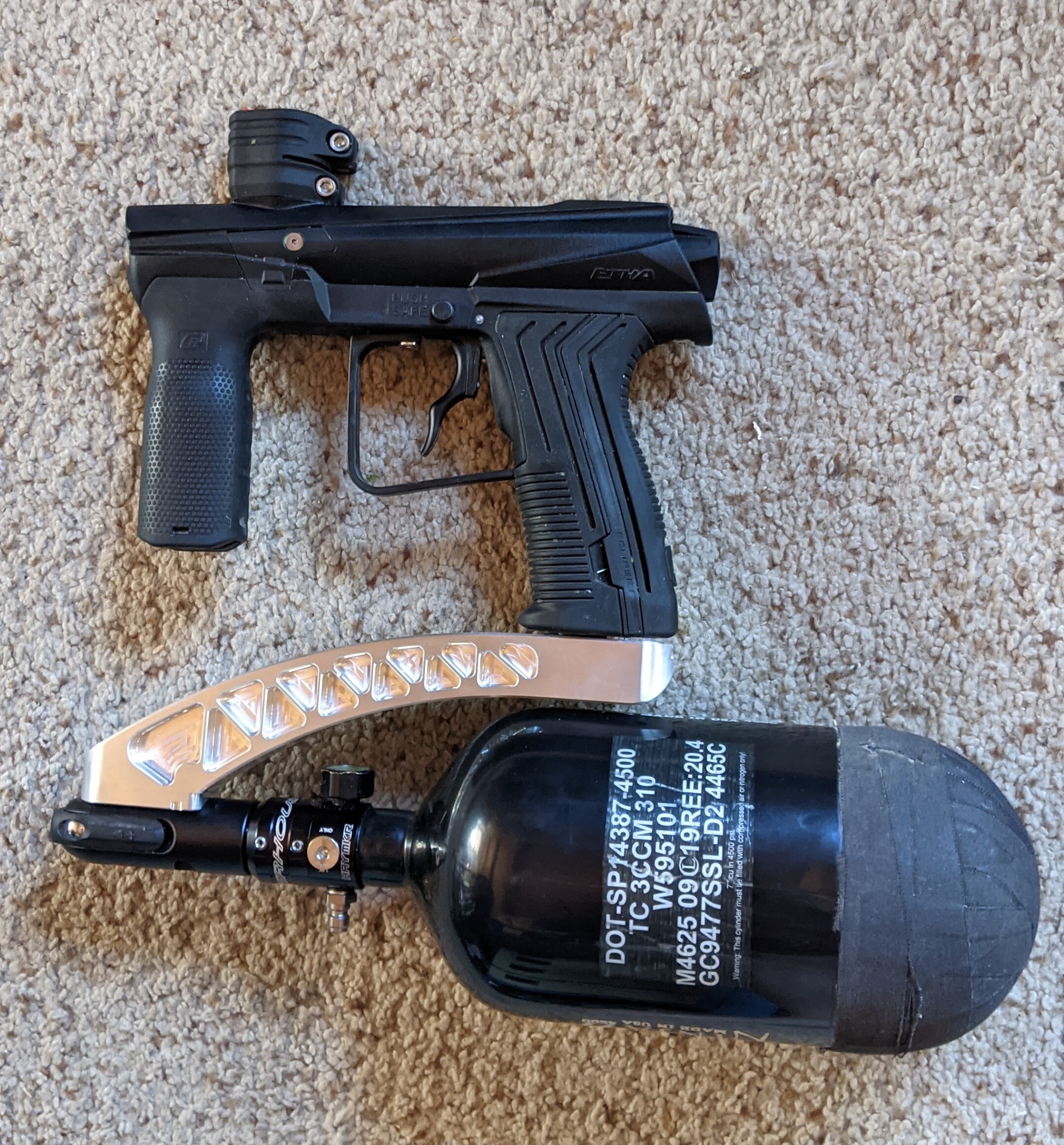

    Machined and installed for test! It all works. Now to send off to the platers for some sweet type III hard coat.
    I hope y'all get a kick out of a very retro element on a modern gun. I know I certainly do!

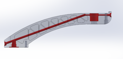

        Pictures should be working now. And here's the picture of the CAD showing the bores.

                Glad you put the CAD file, was wondering how you drilled the air line

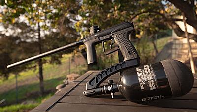

                    Back from the platers (Type III, class 2), installed, and working well.
                    Now for a playtest this weekend.

                      1) was that a drill bit you used on the long airline?
                      2) are we looking at 1300 shots per fill?
