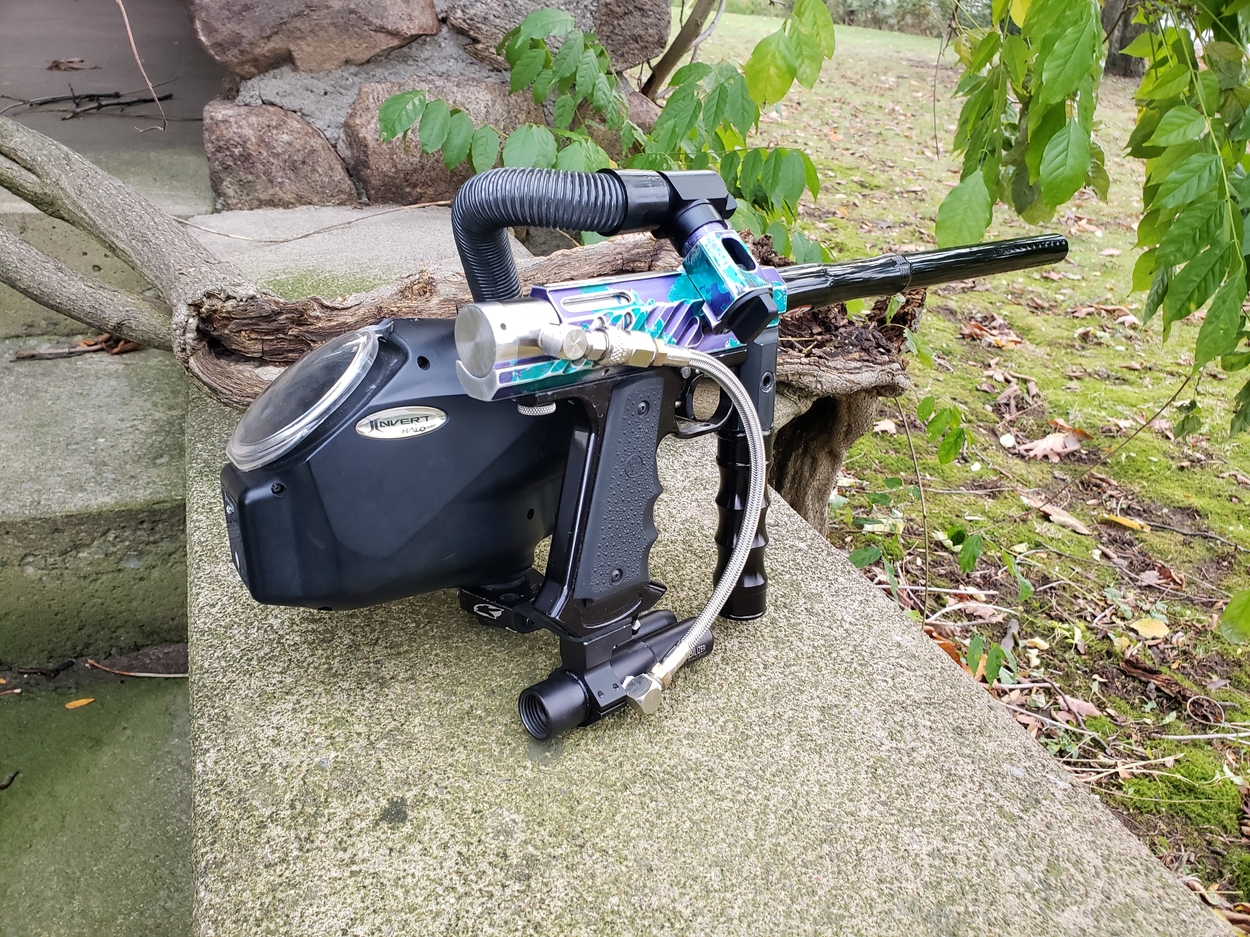

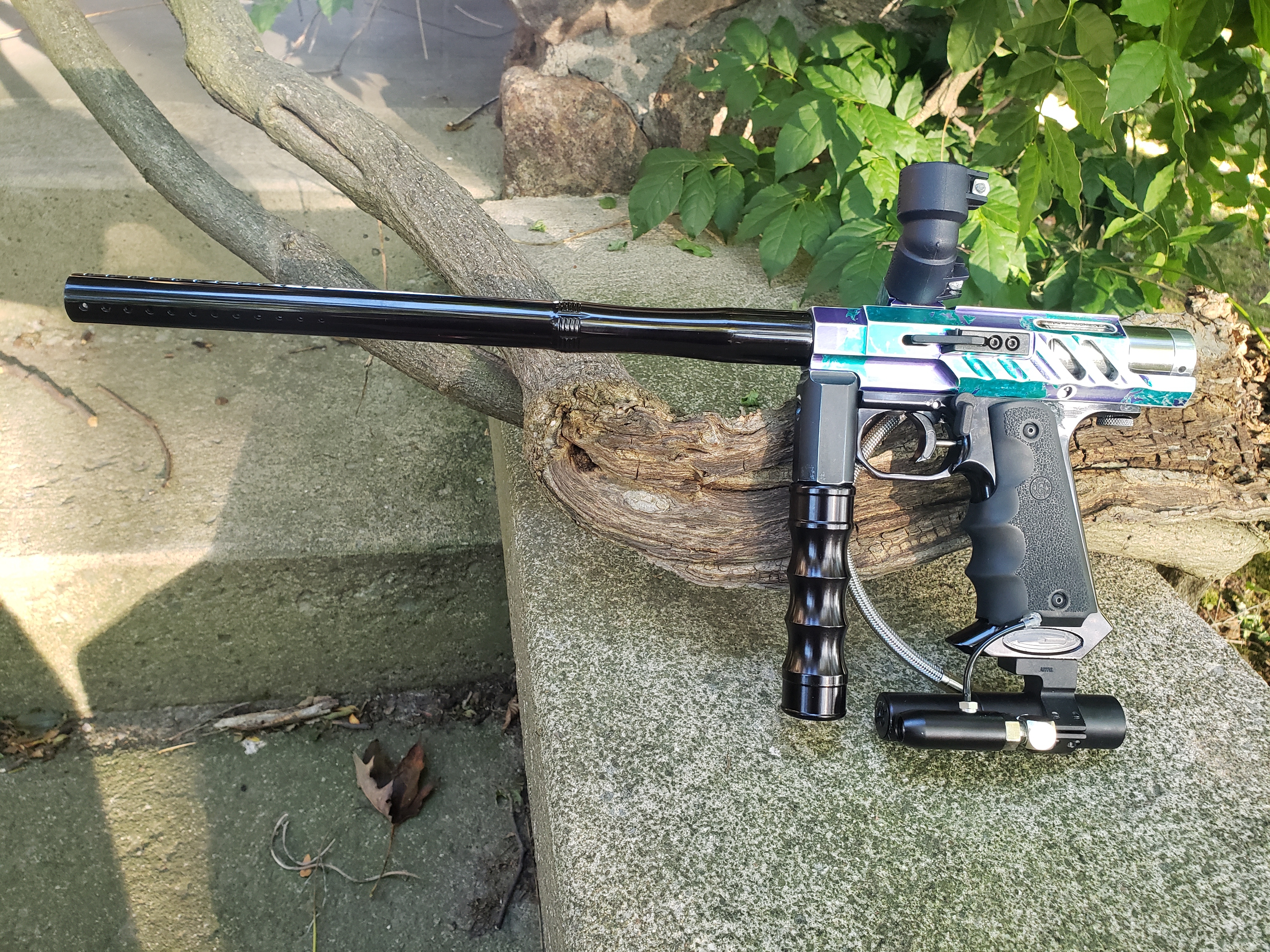

      Small update: got a SPAR frame and a Micromag and mashed 'em together.
      I wasn't 100% happy with the SS body and Cocker thread adapter, and I dislike ULE bodies, so I decided to go OG and get a Micromag. Found someone on here selling one, made an offer, and it arrived a few days later (ah, the perks of buying from a fellow Canadian 🙂).

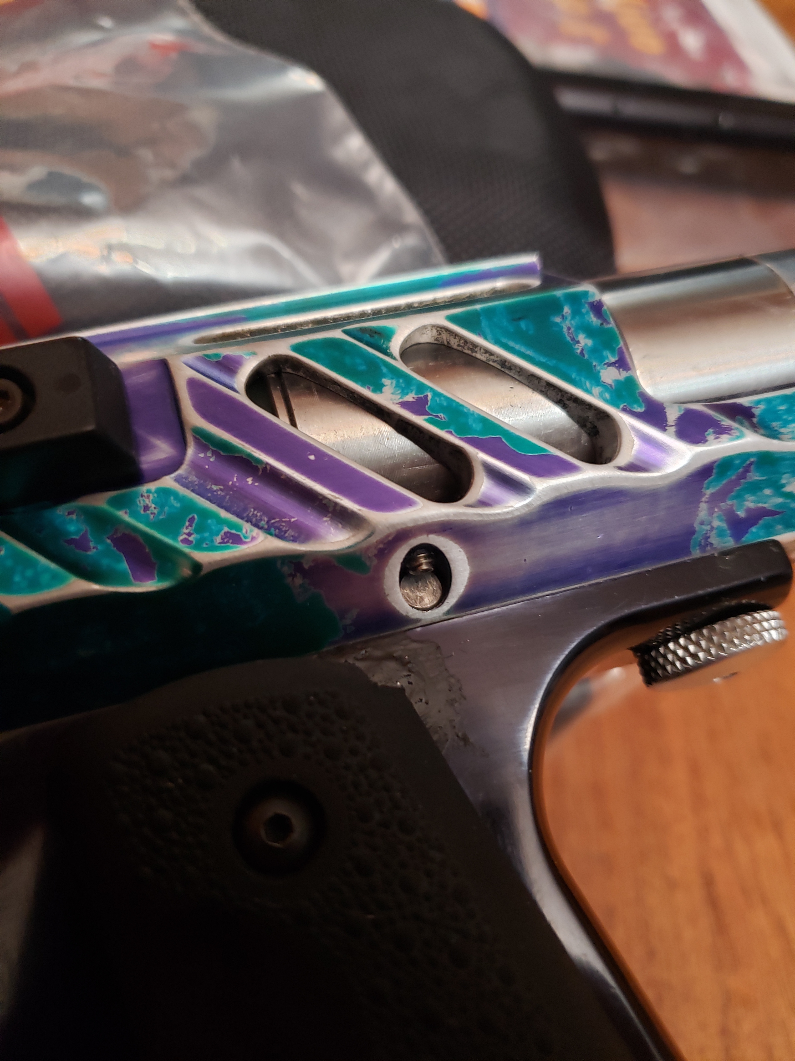

      One reason I wanted the Micromag I got was that it had already been modified previously - ie: cosmetic milling which included bobbing the rear "rail" - so I didn't feel horrible doing what I did... which was drill/tap the body for a small (4-40) setscrew to retain the sear axle. The frame Rawbutter converted for me is for a Classic RT, so it doesn't have the "wings" - used to retain the sear axle on a Micromag - that a Classic Mag frame would normally have.

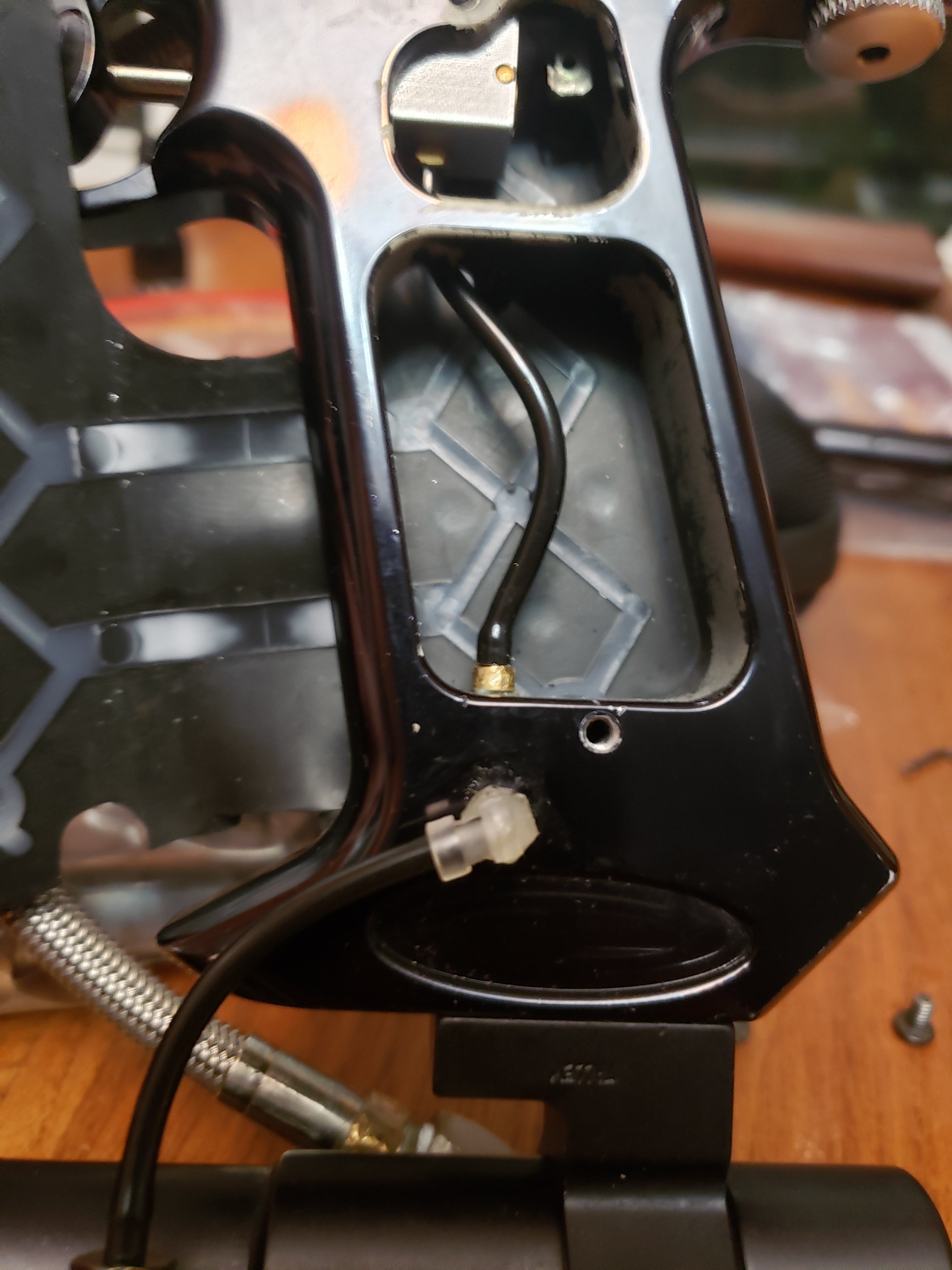

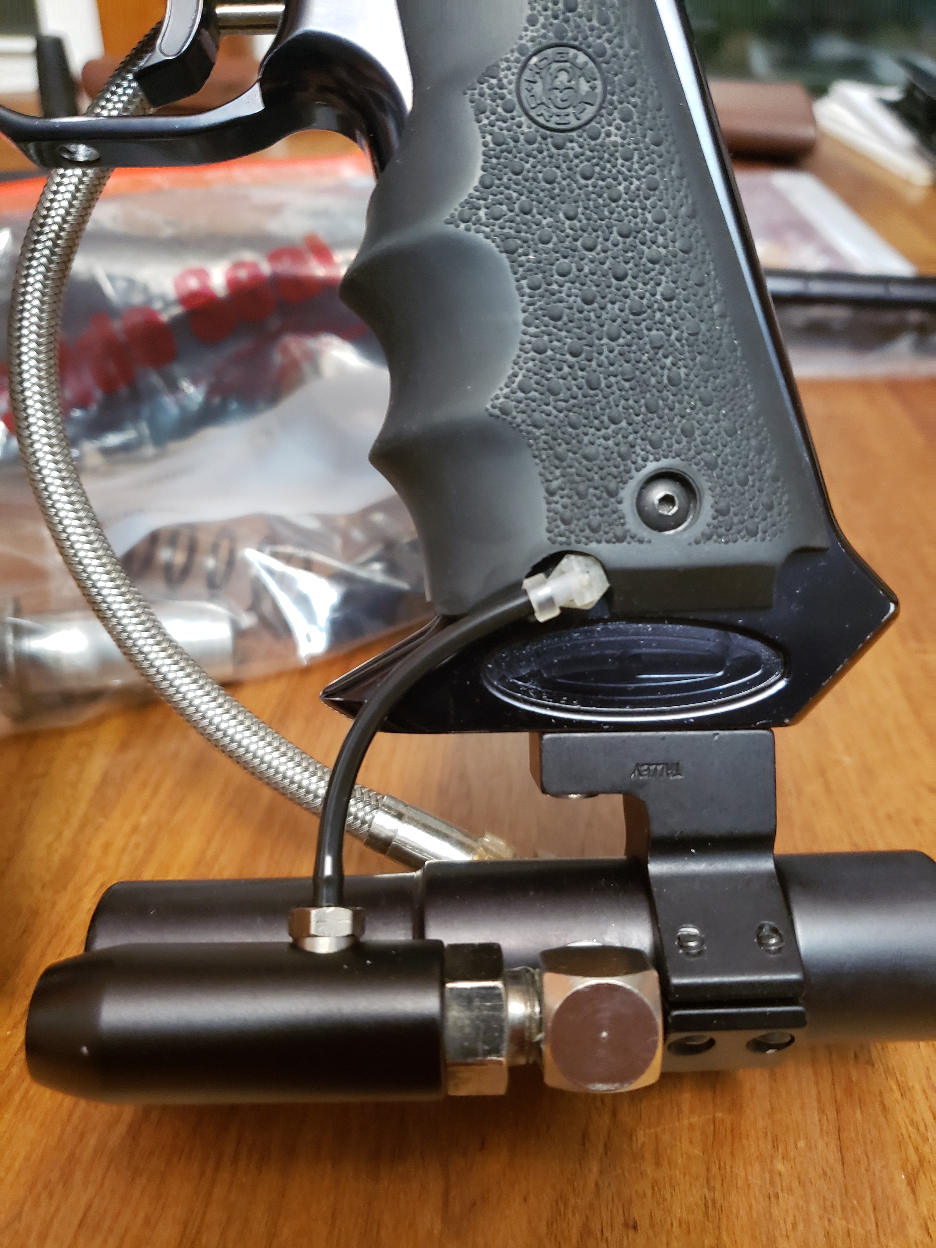

      I also wanted a clean way to get the LPR supply into the frame to the SPAR valve.... rather than cut a groove into the frame and/or grips, I drilled/tapped the frame for a couple of hose barbs and used the frame as a manifold.
      With the grips on it's not really noticeable at first glance. The inside barb is an old Cocker 6-40 barb and the 90° barb on the outside is a 10-32 elbow off a Rainmaker.

        I love the idea of running the air through the frame. That's cool.

          SPAR is Select-fire, Pneumatic, Auto Response - Rawbutter designed a cartridge-style pneumatic valve that allows for single shot or auto-response (fire on pull and release) with the flip of a selector switch.
          It requires a LPR to feed the trigger setup.
          I've also gutted the stock Mag AIR valve and capped it, to make it shorter and lighter, so I'm running the female Stab instead.

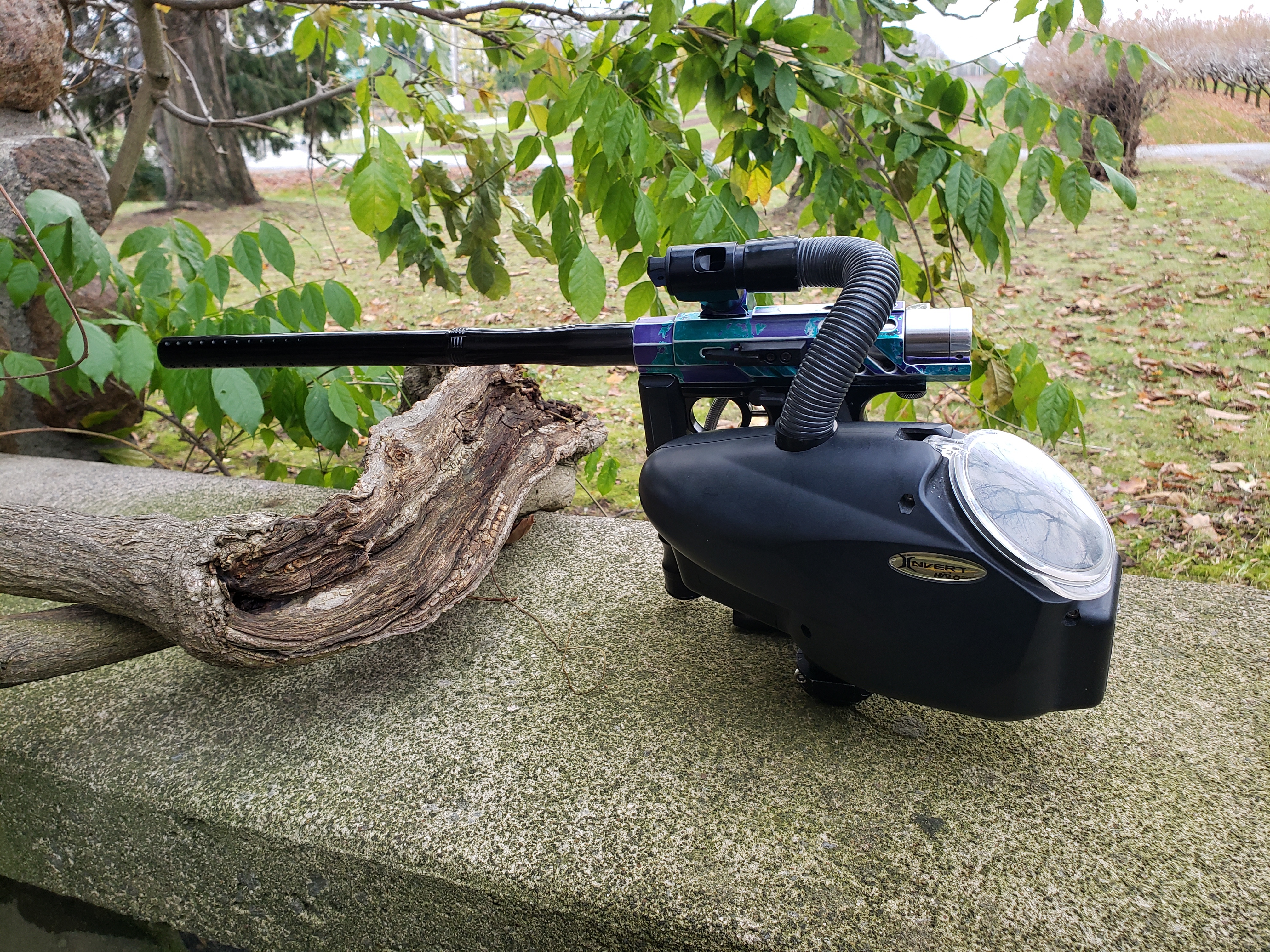

              I built a Warpless setup using a HaloToo (actually, multiple Halos since I had a bunch of broken ones), mostly because I've always thought Warps were cool.
              I'll need to try it out next season because Winter Is Comingâ„¢ and next/last time I play will be a No Batteryâ„¢ game.
              Makes for a super tight setup though.
