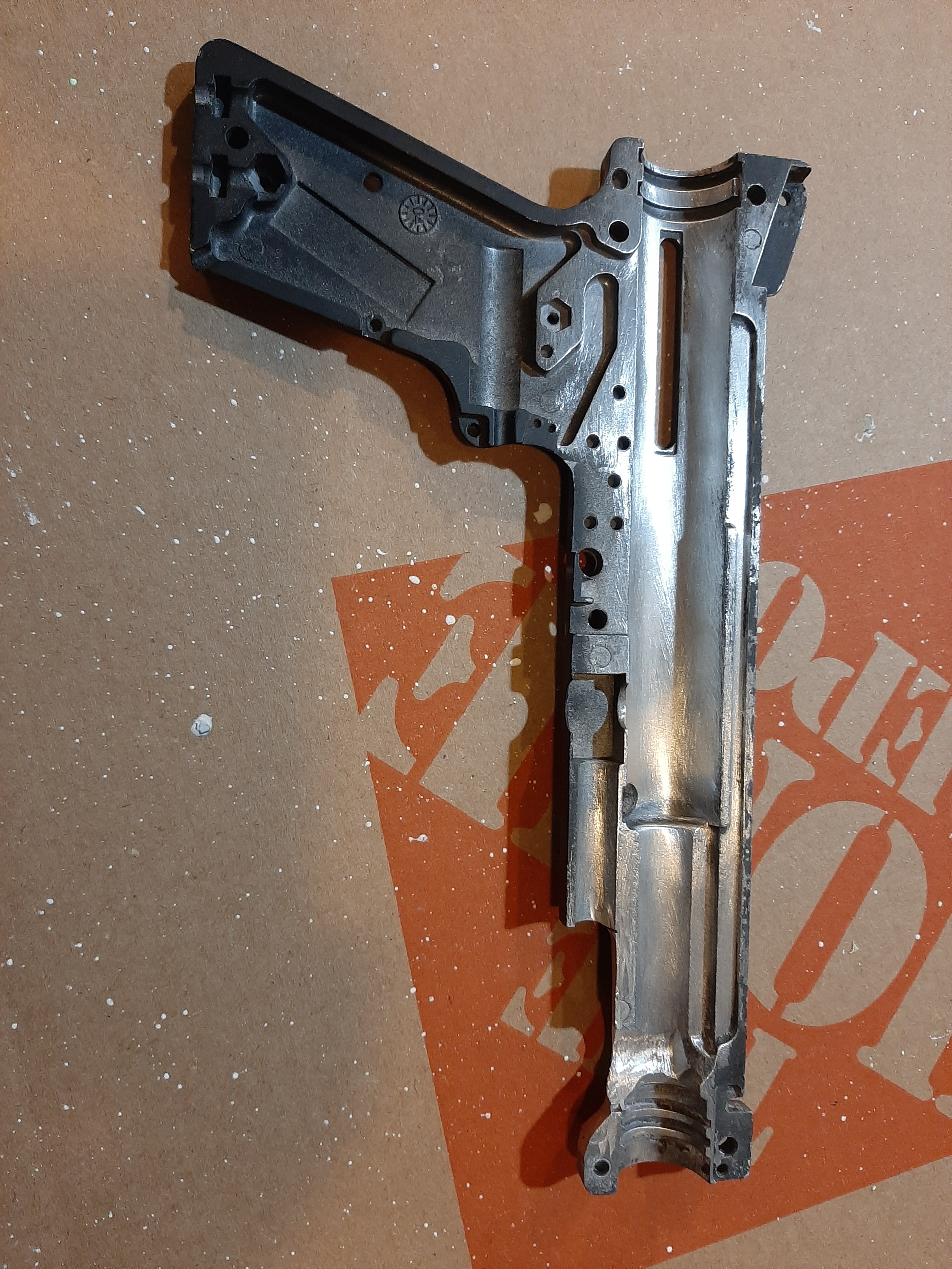

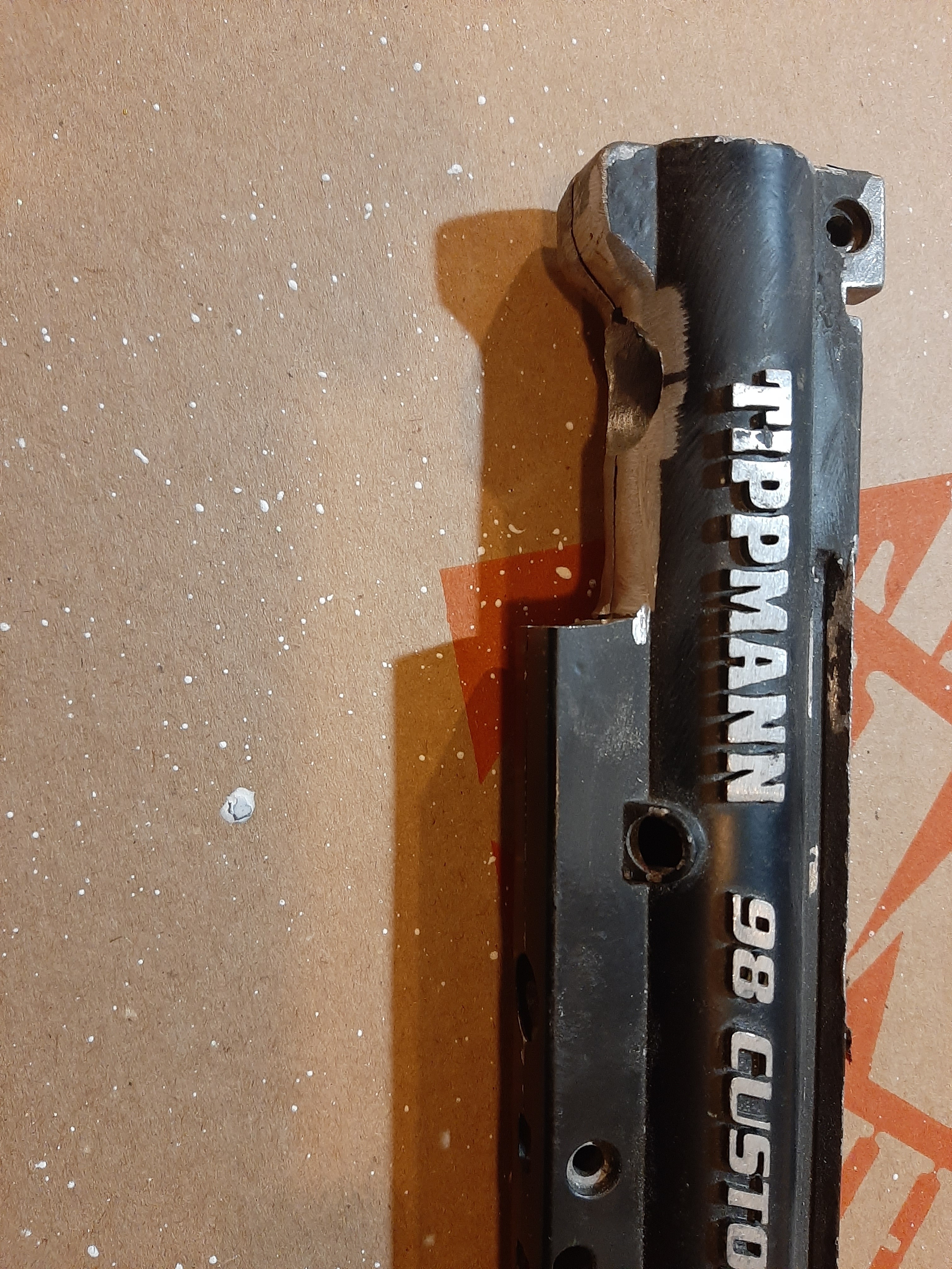

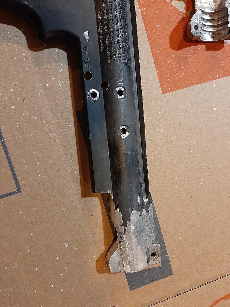

        Try these Click image for larger version
ID:	226724 Click image for larger version
ID:	226725 Click image for larger version
ID:	226726 Click image for larger version
        • lhamilton1807
          lhamilton1807 commented
          Awesome, so you ground off the front grip + some meat to get the mag to line up and added a hole for the paint to feed in. Couple questions then.
          We’re you able to integrate a ball detent anywhere?
          What’s your system for holding a mag in the body? Did you manufacture a magwell somehow?
        • COB
          COB commented
          'In the earlier guns, I made a metal mag well. After I began modding everything, I used Tippmanns' factory mag well modded to fit. I also used 3d printed mag wells from several sources. The key is to be sure that the magazine follower reaches into the bottom of the chamber, so the last ball in fully seated to be chambered not chopped in half. The pressure from the magazine spring holds the ball in place. I did not fit a detent. Epoxy putty was used to fill the original feed port. Also critical is placement of the new hole. Make sure in comming balls clear the bolt. Also, that the feed angle does not cause balls to jamb.

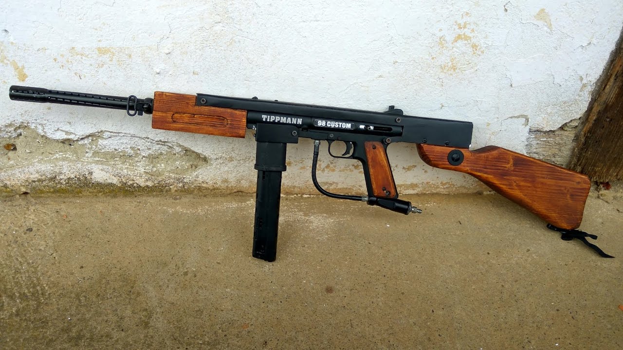

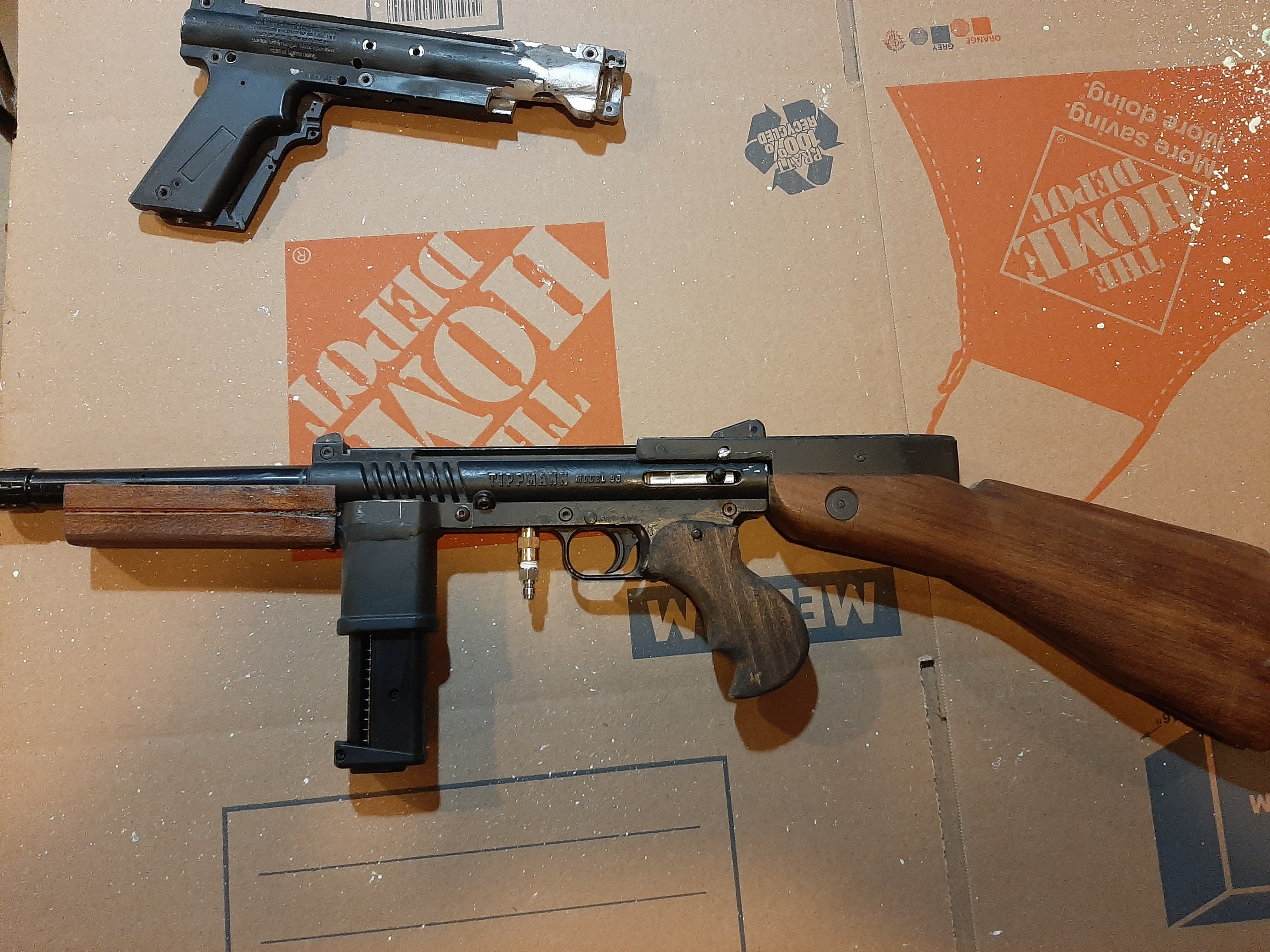

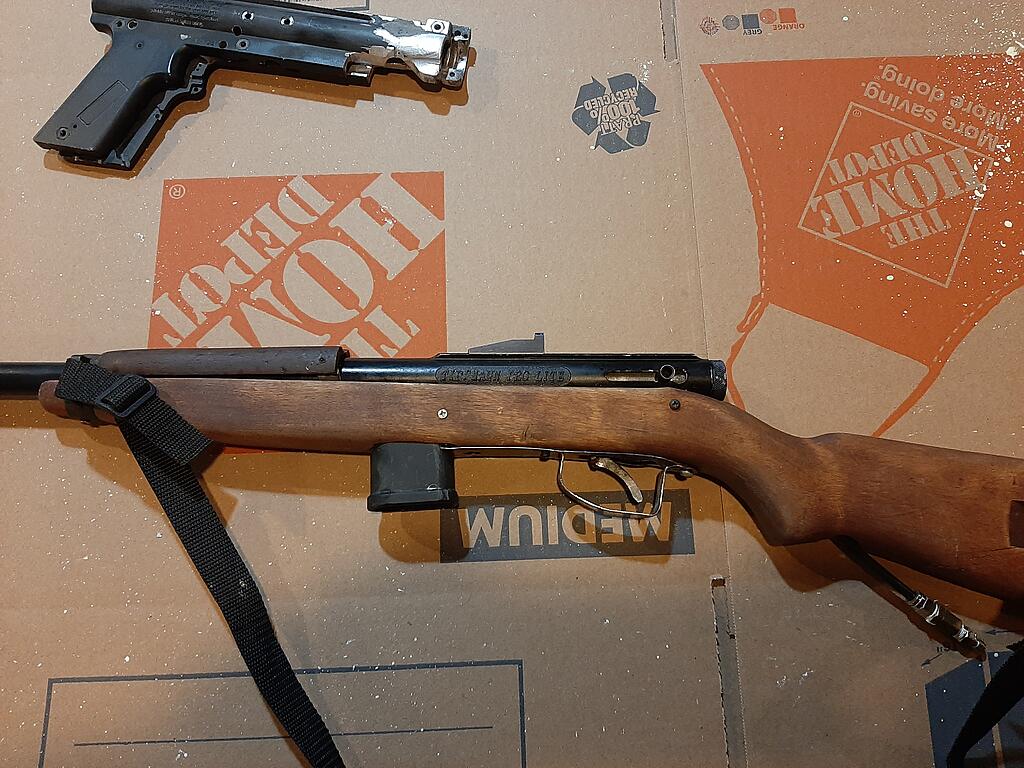

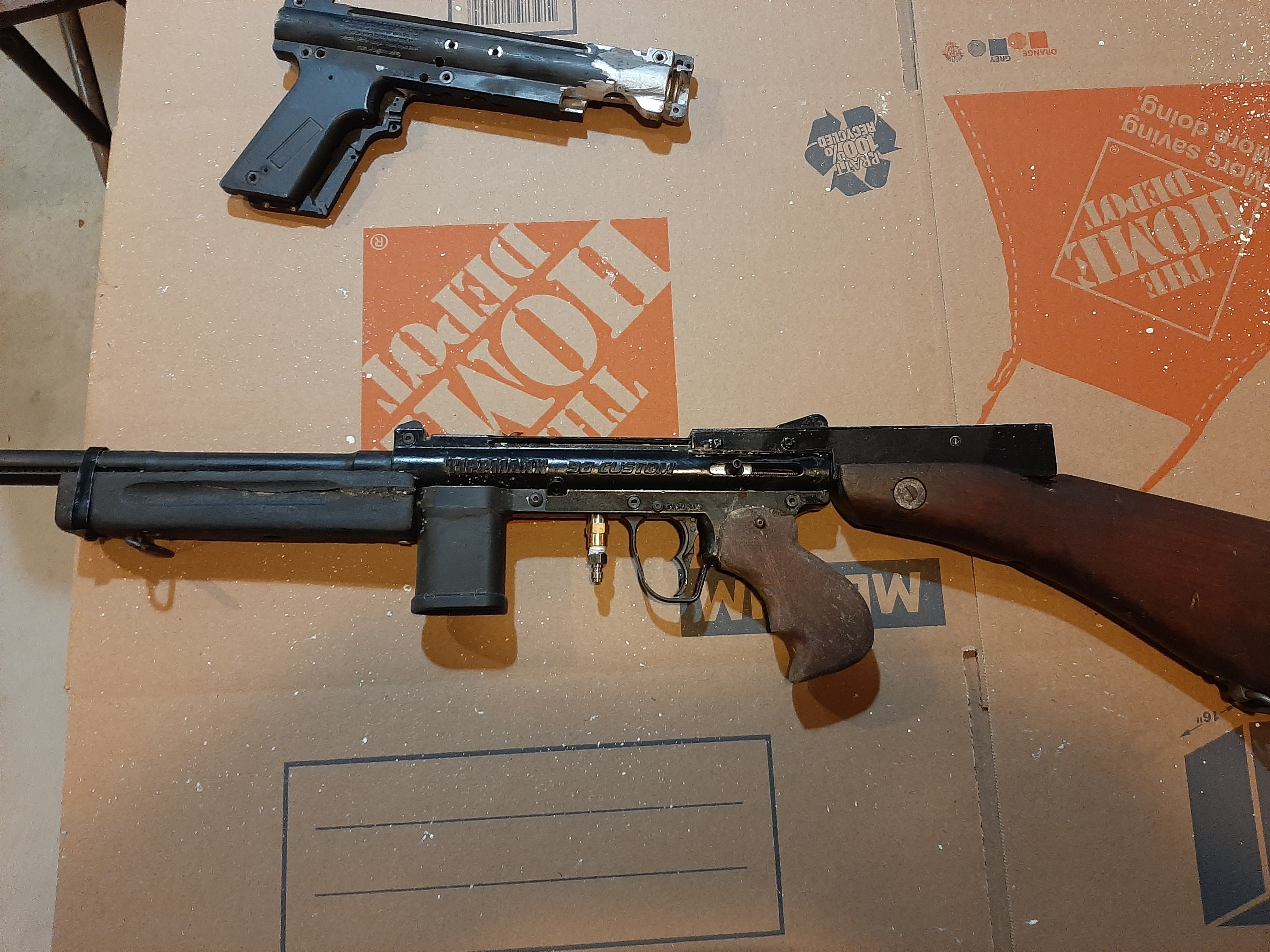

        finished guns Click image for larger version
ID:	226731 Click image for larger version
ID:	226736 Click image for larger version
ID:	226737 Click image for larger version
ID:	226738 Click image for larger version
ID:	226735 Click image for larger version
        • NONOBLITUS
          NONOBLITUS commented
          Man oh Man that Thompson is awesome
      • COB
        Expanded Gnome
        • 859
        • Sparks, Maryland

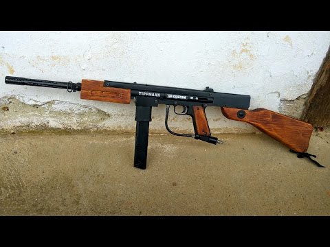

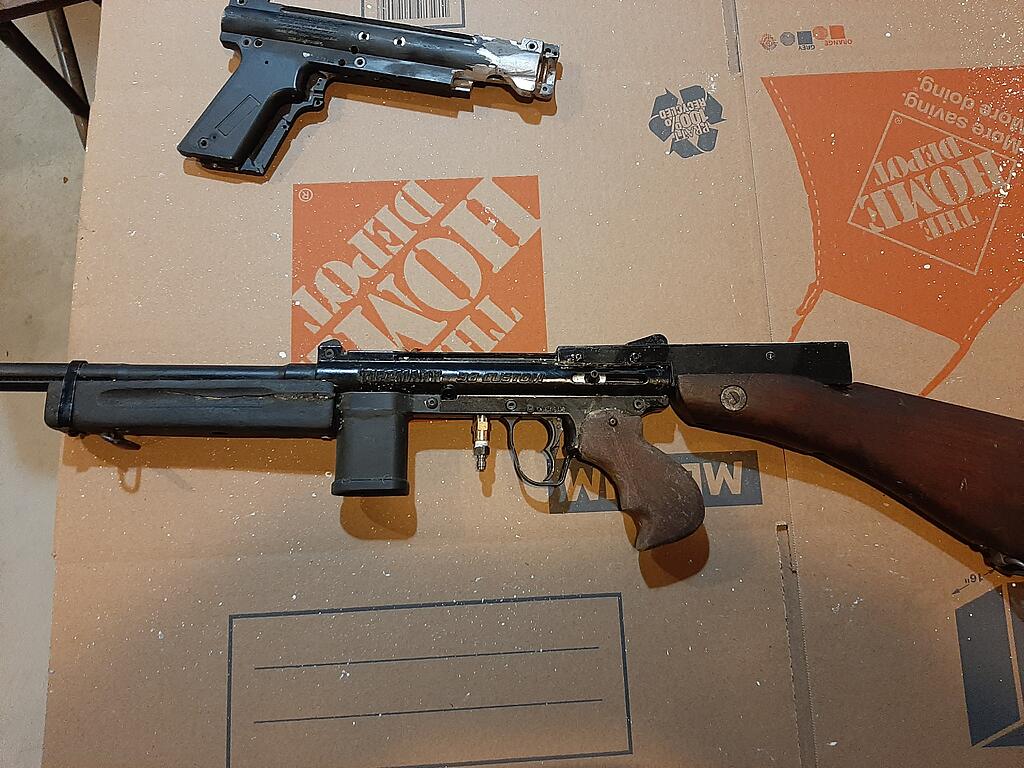

        The Thompson stocks are original, the fore grip and hand grip are handmade. The idea, for the rear projection for the stock, came from OneRoundOneBody on YouTube. I took their dress up ideas and made it mag fed.

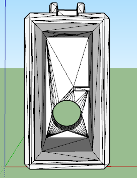

                  A lot of what we’ll start with is someone else’s 3D printer model for a mag well - there are a bunch of right feed options that we will try to convert into a vertical feed mag well. That way we won’t have to reinvent the basic dimensions and mag release. It’ll also give us cutting guidance.
                  We also wanted to make a T98 right feed cap that will function as a removable detent cover just in case.
                  My Feedback Thread
                  • lhamilton1807
                    Friends paint friends
                    • 1128
                    Quick update. Saw a YouTube video with someone else’s work (video linked below) and we’re using it for inspiration. Decent work, but we wanted a cleaner way to attach it to the gun. He wants to use Helix or DMags instead of Zeta mags, but the principle is the same.
                    We fiddled around with a model for a mag well that pointed straight out from the feed port. Because the mag well model wasn’t aligned with the xyz axes, it was tough to get it adjusted to our uses. We scrapped that after a few hours and started with this one as the base:
                    https://www.thingiverse.com/thing:4190624/files
                    My son went through and deleted all the lines from where the feed path in the mag well started to turn. He made it as far as extending the feed port straight out a little ways, but has some more to go. Once he’s done (hopefully tomorrow) we’ll send it to his friend with a printer. We’ll probably do the prototype in PLA because it’s easier to print, then after any adjustments are done we’ll print in ABS. No cutting yet, but we did order a DMag from MCS to test the mag well. I’m letting my son drive this one since it was his idea and I think it’s best in the long run for him to claim the bragging rights when it’s done. I’m assisting when he gets stuck.

                        Some acreenshots of the magwell model. About to send it off to his buddy with a printer.
