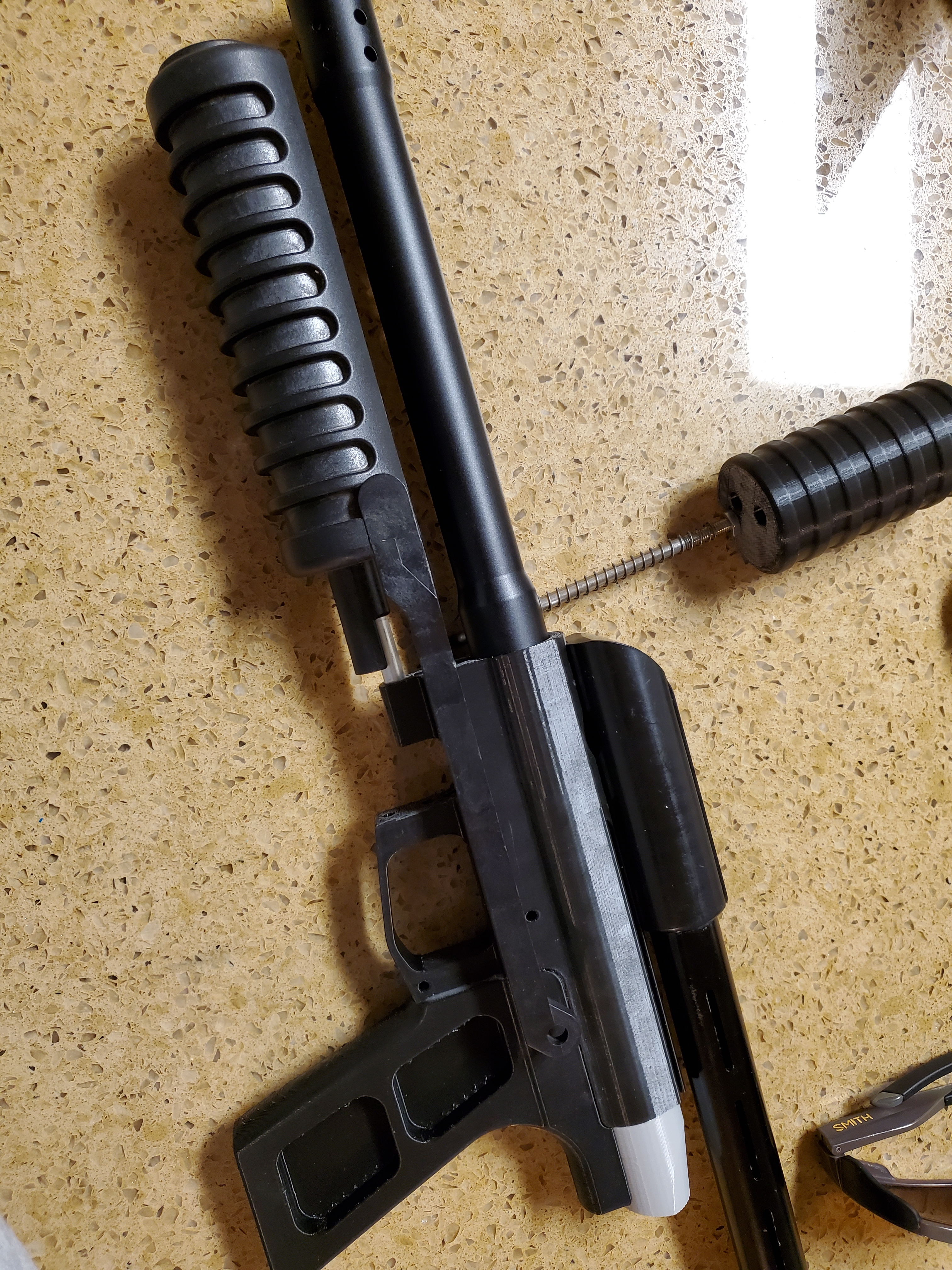

    Any time you can move the web of your hand closer to the line of the barrel you get an easier pointing marker. Nothing wrong with a side cocker like a buzzard style.
    Very true, I'd like to keep the pump from fully wrapping around the barrel as it may limit what barrels are usable and prevent line of sight down the barrel for aiming.
    Grendel that's not a bad idea. Only concern would be shimming on a marker to marker basis. If there's variance between the markers enough that the parts need to change it make manufacturing/servicing more complex. One nice thing about tying the forward/back stroke limits to the body of the marker is it limits the number of tolerance stack ups that need to be accounted for which helps with ensuring proper sear catching/releasing during the pump process.
    I mocked up a Hammer 7 pump on it and it doesn't look bad. I'll post pics later tonight.

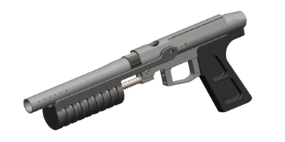

        Quick mock up with with a hammer 7 style pump. Undercocking with side pump arms. With a smaller sized pump and getting it closer to the barrel it would look pretty good. Also make room to fit a slider trigger and safety in the frame.

          More detailed mockup in CAD with side pump arms. Very crude pump on there right now that I would probably shift more toward a CCM EZ style, round bottom with angled sides. To retain the pump guide and potentially the barrel insert as well I added a socket head cap screw to pull the front halves of the body together similar to an SL68 for retaining the barrel. This allowed for the overall height of the frame to shrink by about 0.1" and puts the distance from the centerline of the barrel to the top of the trigger guard slightly less than a Phantom.
            XEMON commented
            This is looking great! I love those simple, heavy/sharp ribs ... Nice and grippy.
            The side lever are great, what about extending them a bit to cover the slots when in the forward position?
          • Lane
            Lane commented
            I think extending them is definitely an option along with some general updates to the pump ergonomics.

          Definitely extend them to cover the slots like a lapco.
          And if you do have to go with side slots in the final, which I hate, figure out a way to keep the screws from coming loose.
          also consider what is going to be your pump stops forward and rear. The guide rod can be the rear pump
          stop and the bolt in the barrel can be the forward.
          you don’t want the pump slots to be the stops as they’ll get peened up.
          • Lane
            Lane commented
            Hammer 7 and Empire trracer use small orings on the pump arm screws to keep them from backing out which is what I'd lean too. The intention is to use the slot for stopping forward and rearward travel at the moment. The wall thickness around the bolt is much thicker than some of the older nelsons so peening isn't a huge concern.
