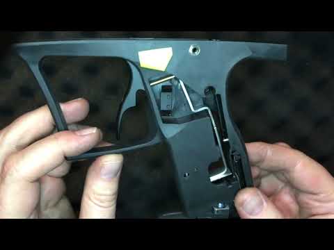

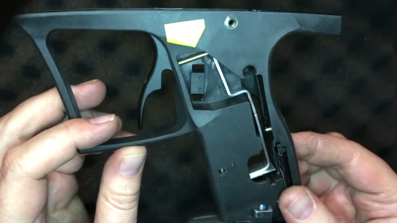

    double trigger Gmek frame
    I had some free time today and finally got to do a cool project I've been saving since Christmas. It's a double-trigger Gmek frame! Basically just the electronic frame with all the electro parts stripped out and replaced with a big pivoting steel bracket. And some roller bearings. And a custom delrin pin. And a brass trigger rod.
    It shoots great, of course. The only problem is that it's a little too easy to not fully release the trigger after a shot, so the 3-way doesn't reset and then the next trigger pull does nothing. So that will take some getting used to. But it was a fun project.
    Now I just have to figure out how to do a safety. Or I'll just use the ASA. I'll probably use the ASA.
    I also have thoughts about ditching the long rotating bracket and replacing it with hydraulics, but that will have to wait a few more months.

      Does the noid have a manual pilot button, or are you using an additional valve to actuate firing cycle? This is pretty sweet either way. It reminds me of the legacy mod.
      I have A 160r, and I know I can't get a mech frame, but I have a legacy mod. Its essentially a replacement noid with a laser cut acrylic wing to hit the trigger.
      You can rip some insane speeds on a mech with it. If I recall it was quickly banned from the mech tourneys when they first came out, and they quit getting made.
      I can take some pics for you if you wanna try to use some of his ideas, or even source a manual noid yourself.
      • rawbutter
        rawbutter commented
        I bought an extra Gmek 3-way from PE to do this mod. That way I still have the original to keep with the slider frame.
