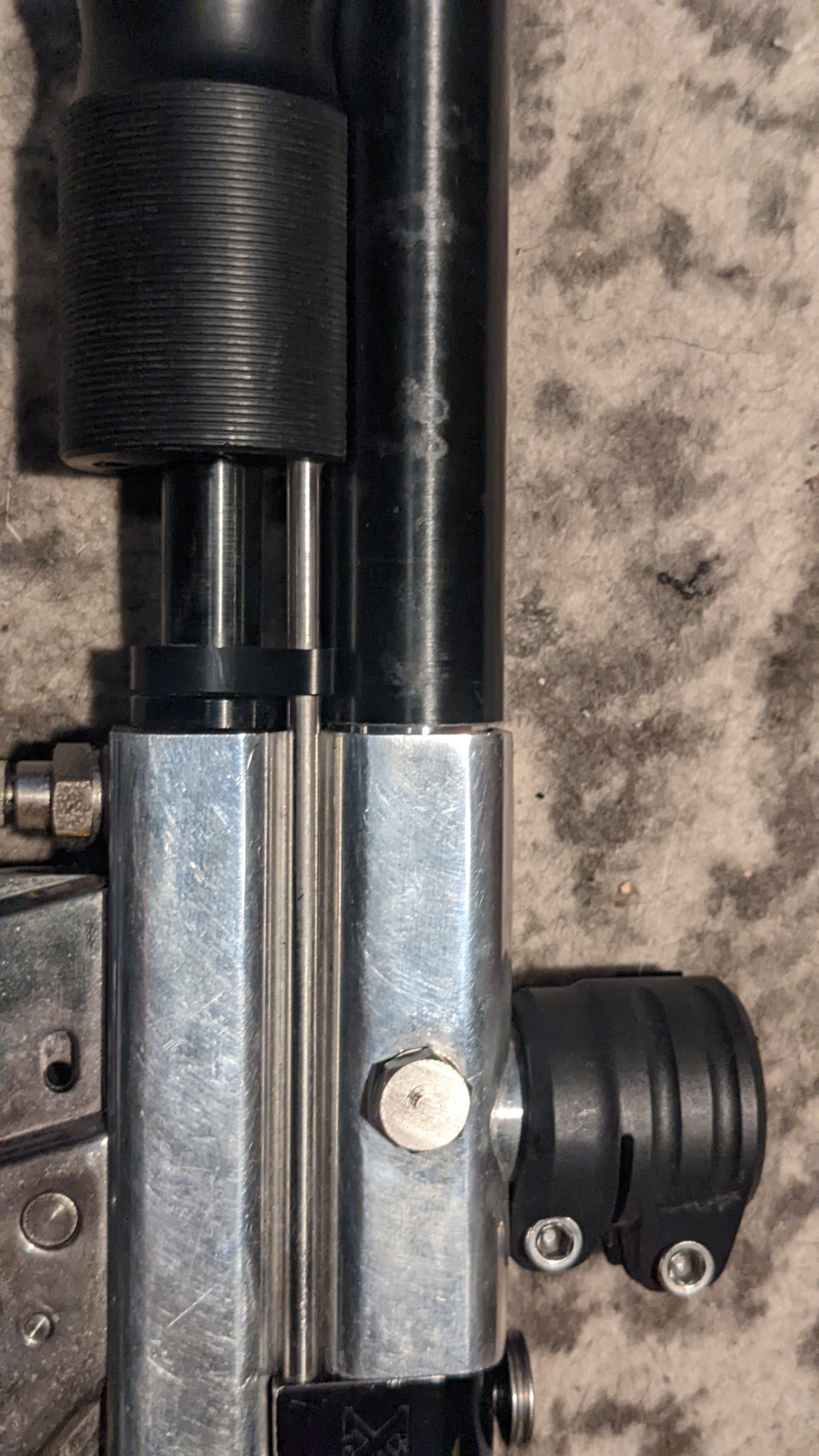

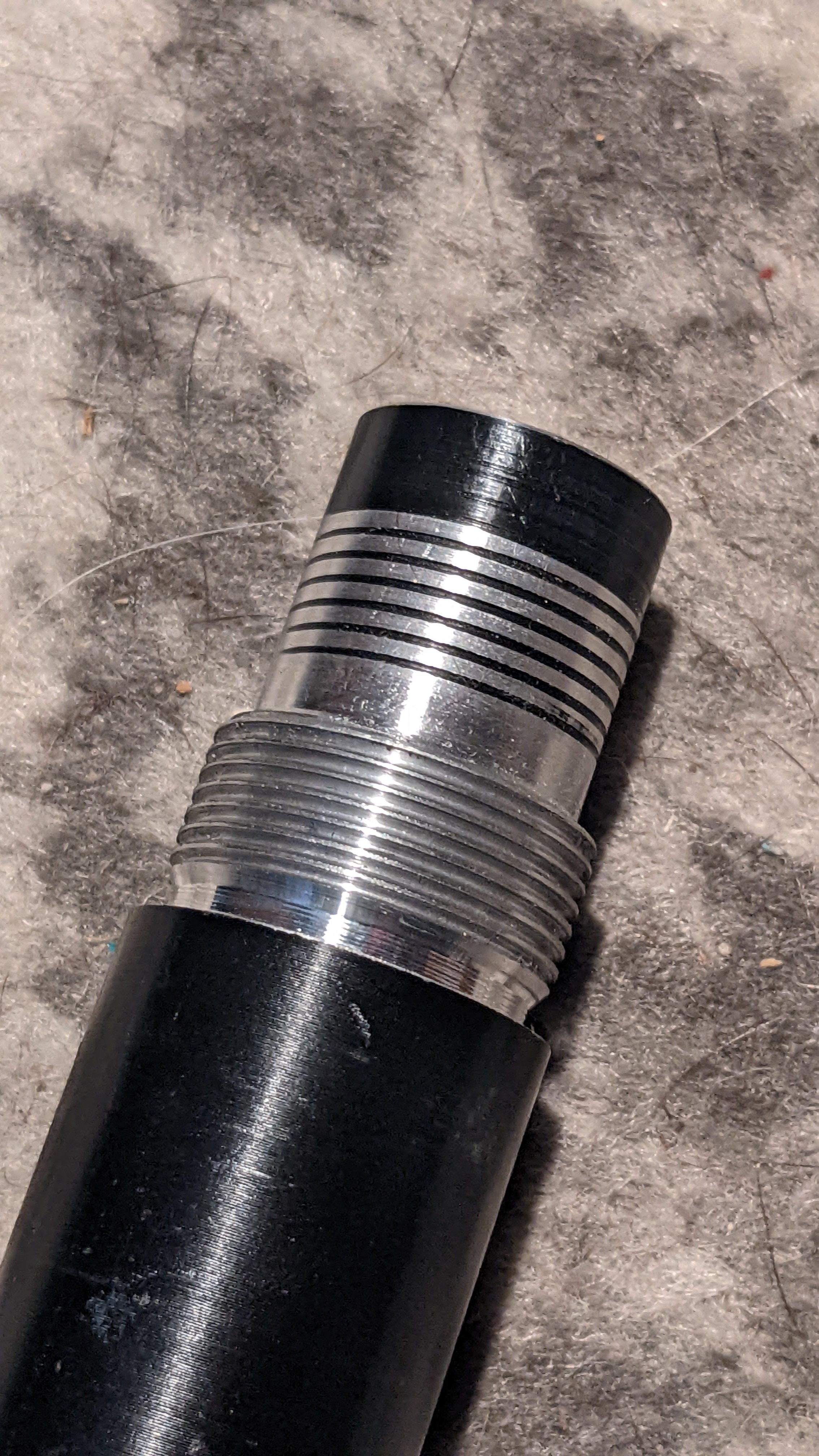

    Just wanted to share my first barrel re-threading.
    It was a .50 cal Spyder threaded SETHZILLA! Sent me for a project ... Rethreaded for cocker.
    now I need to do the second one 😅

    A 50 cal double??? Lol. Threads look clean....lathe or hand cut? Manual or cnc?
      XEMON commented
      Not double ... Not this one 😅
      SETHZILLA! sent me 2 so I can make one for me and one for him.
      Hi, and no single point here, I cut it to size on the lathe, then used the tailstock to line up the die ...
      PS: working on a .50 cal conversion kit for cocker ...

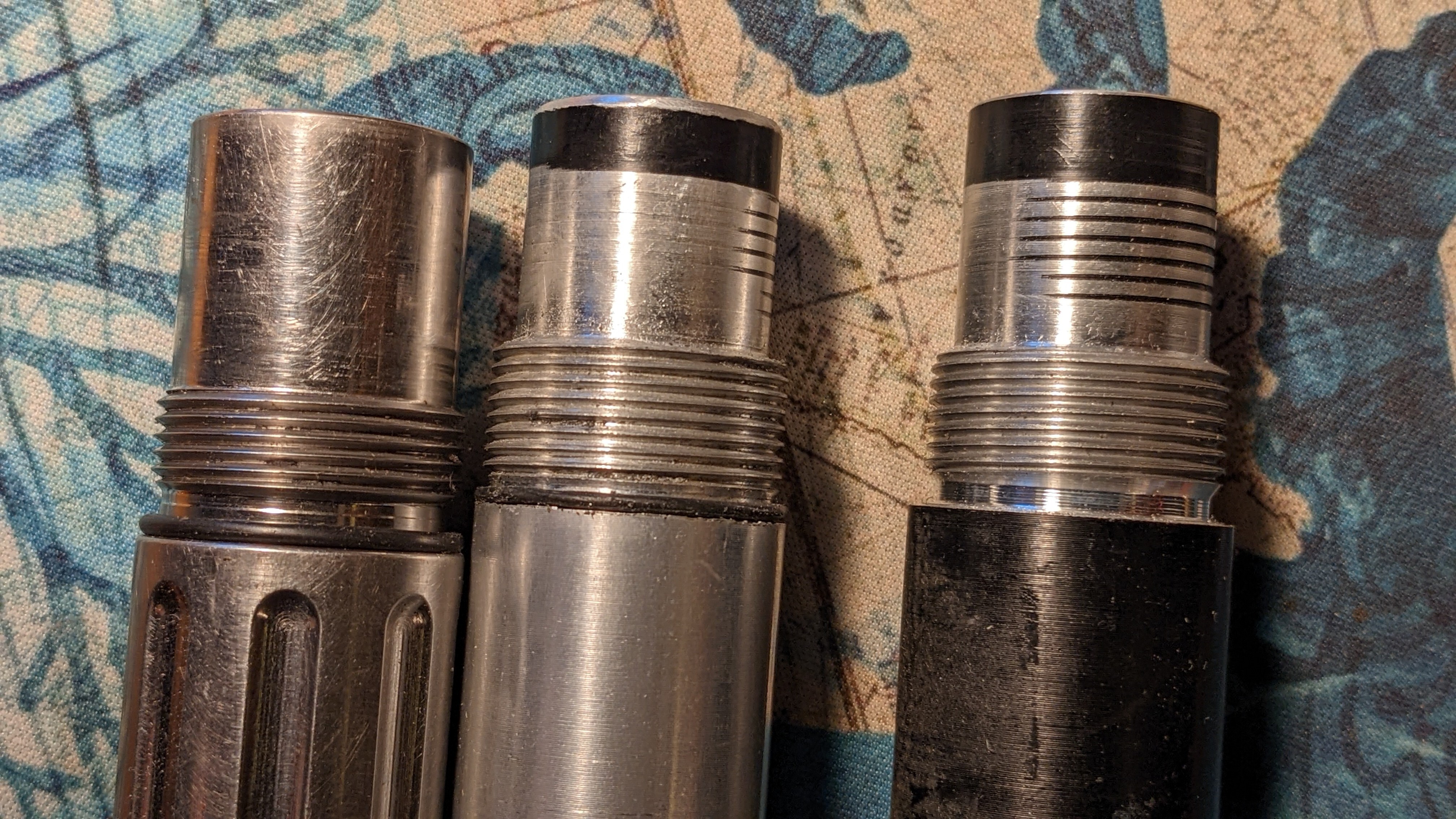

        from left to right:
        - stainless JT used as model - #2 re-threaded and thined down to fit on standard cocker body (the original spider barrel are about 20thou to big to fit on cocker 😜)
        - #1 just re-threaded
