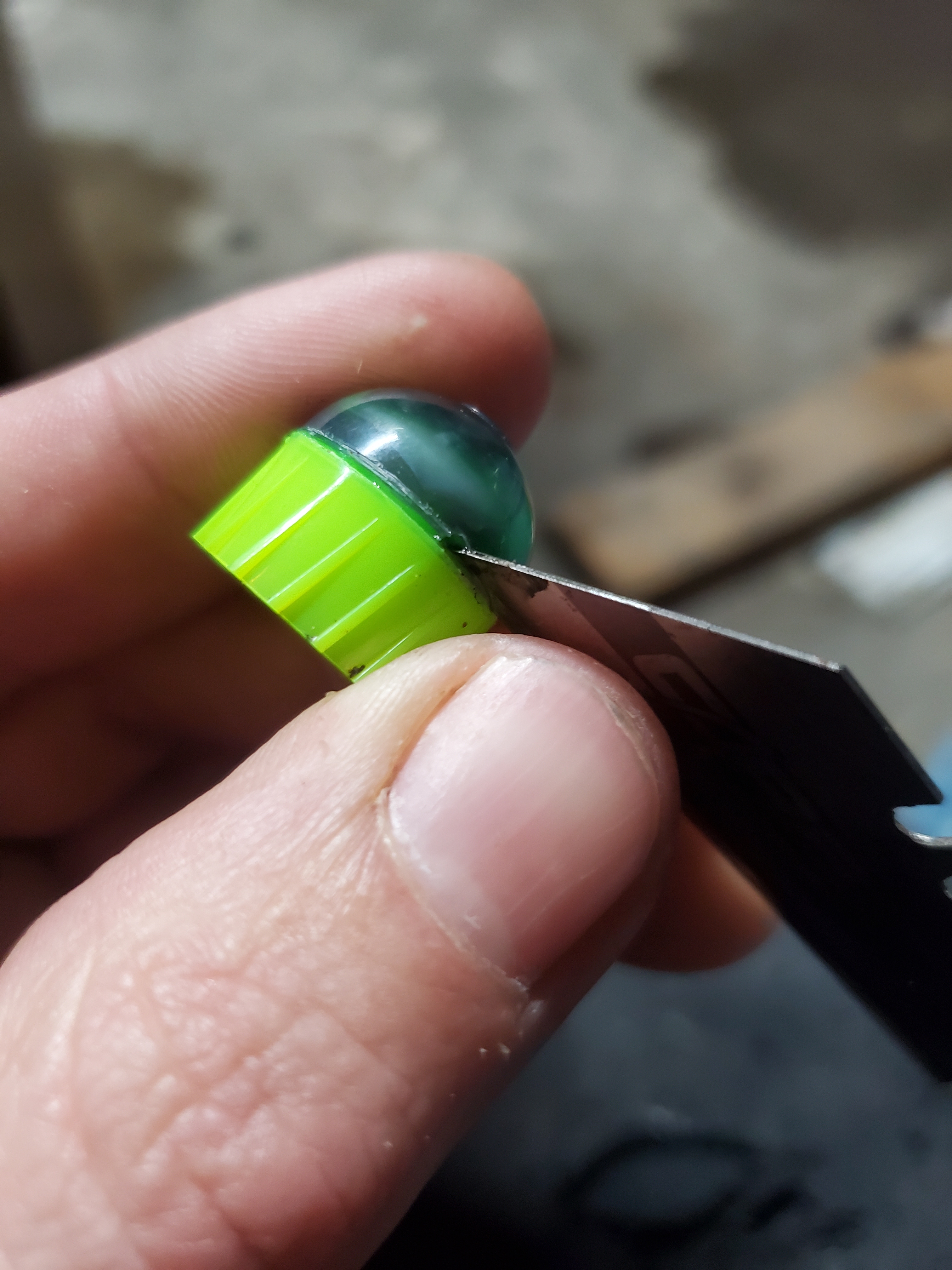

    So yeah these First Strike things are really nice, but at the cost of $0.33 each, it would be nice to have a couple that are reuseable for sighting in your red dot.

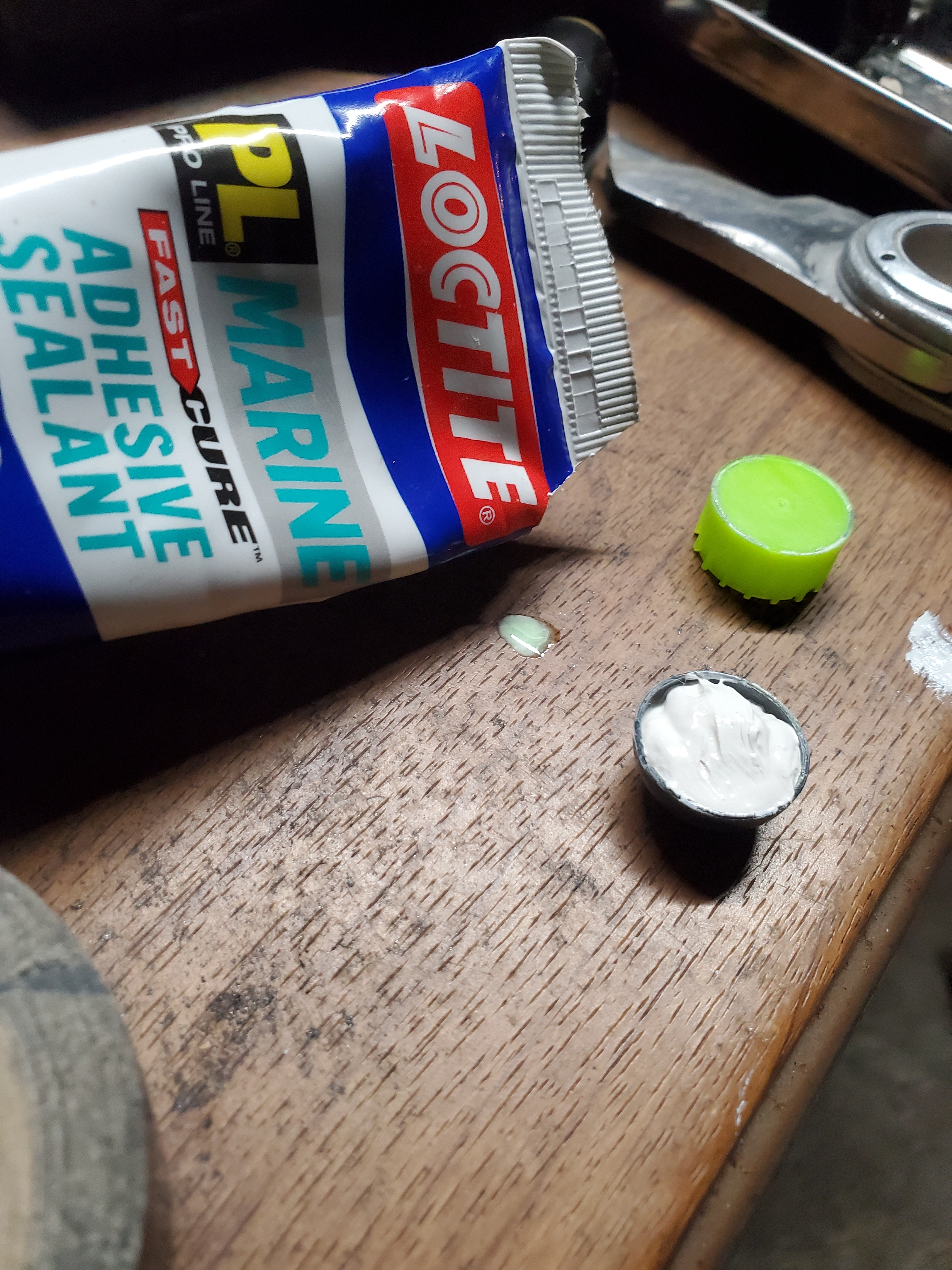

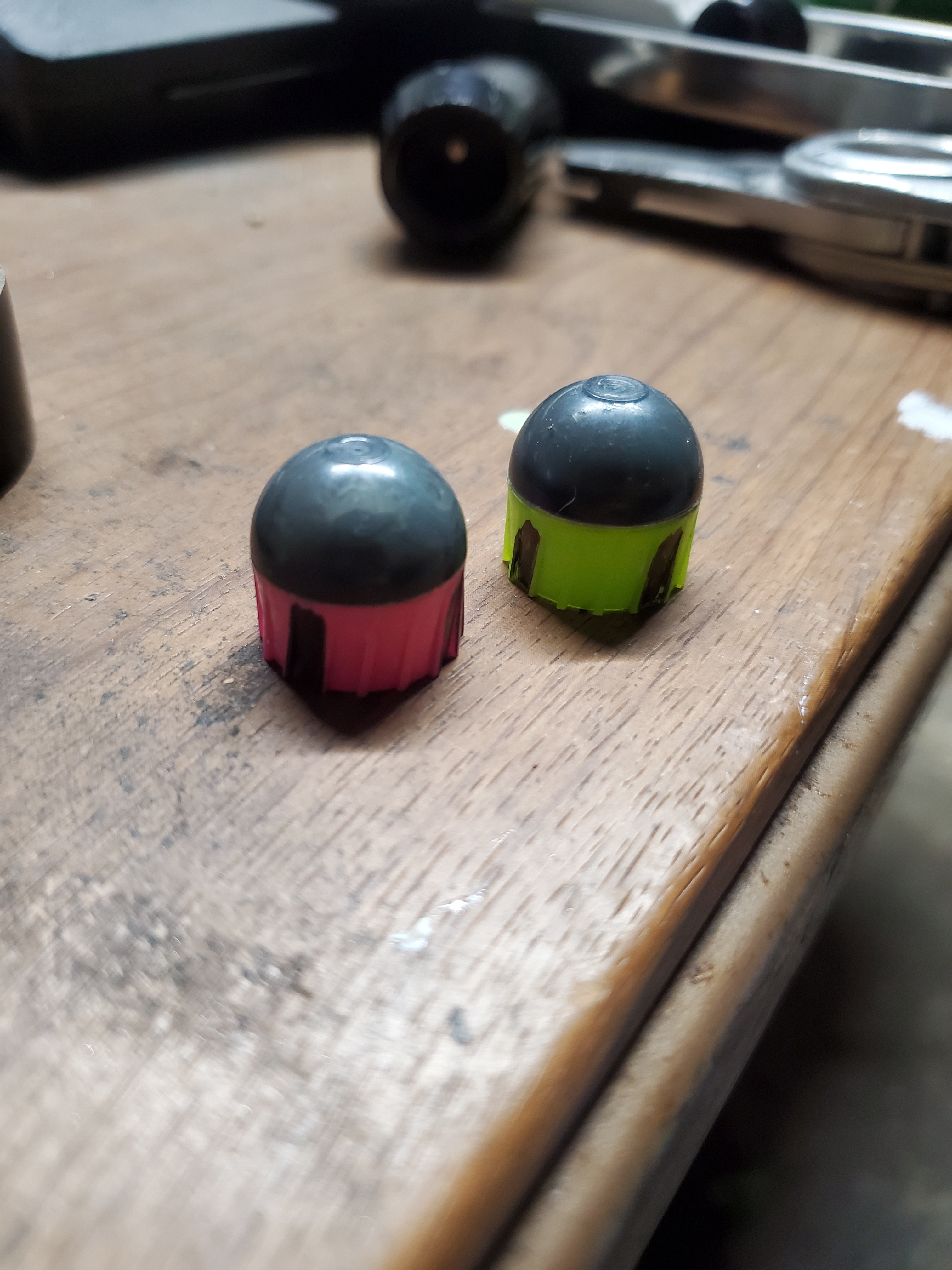

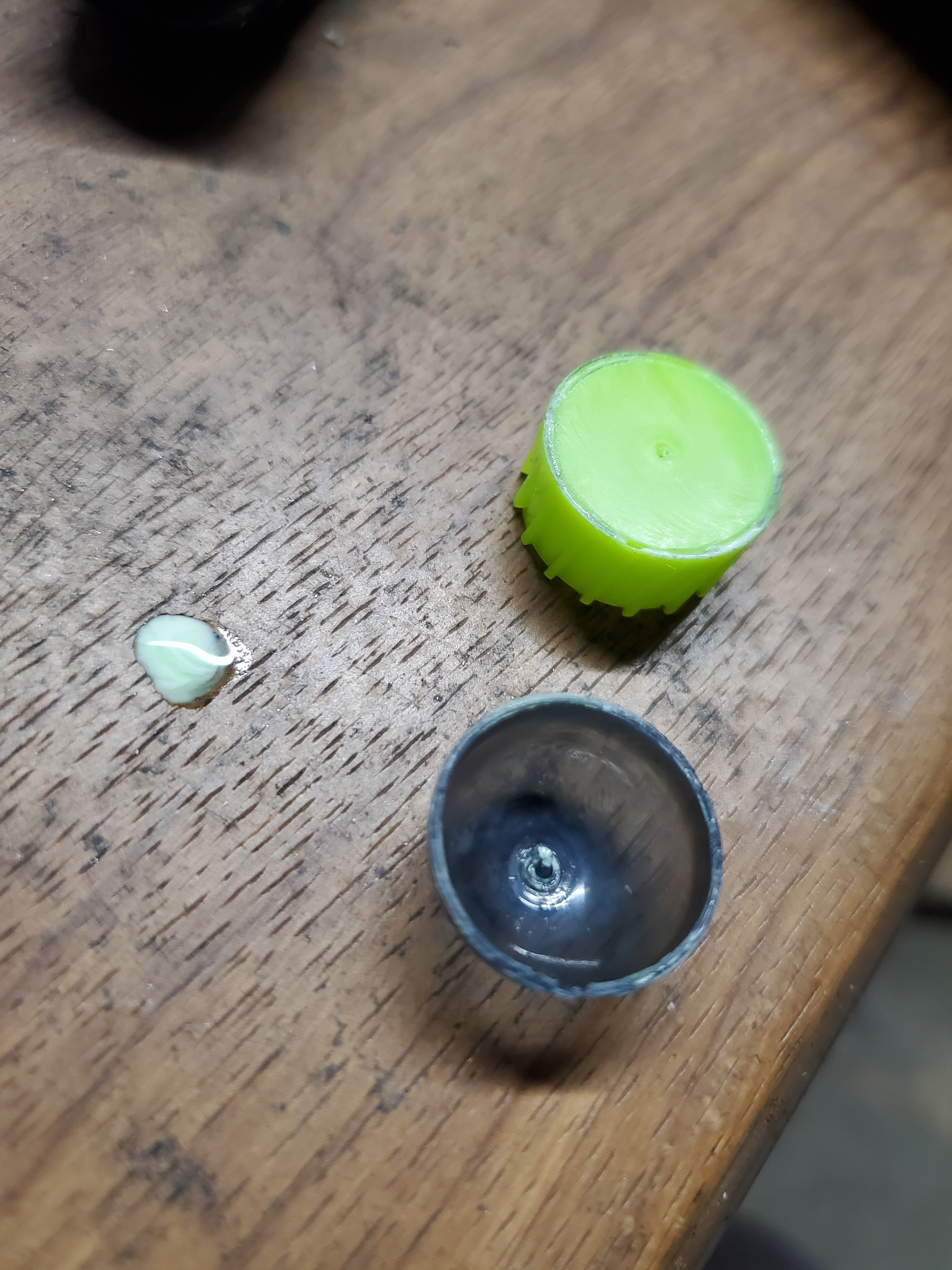

    So I carefully cracked these open and cleaned out the paint. Then I filled them up with some silicone. I carefully placed the two pieces back together and made sure they were centered with the ol finger feeler gauges. I let these dry for a couple days before using them. Most importantly I marked them with a sharpie so I know they are clearly my sighting rounds.
    I will weigh them soon to see if they are still similar to their normal counterparts. They still fly straight. I still set up a towel with a printed target as I can still potentially crack the nose into pieces hitting a hard target. So for a dollar, I got 3 reuseable rounds that I don't care if they fall in wet grass or get dirty because I can just wash them off and use them again.
