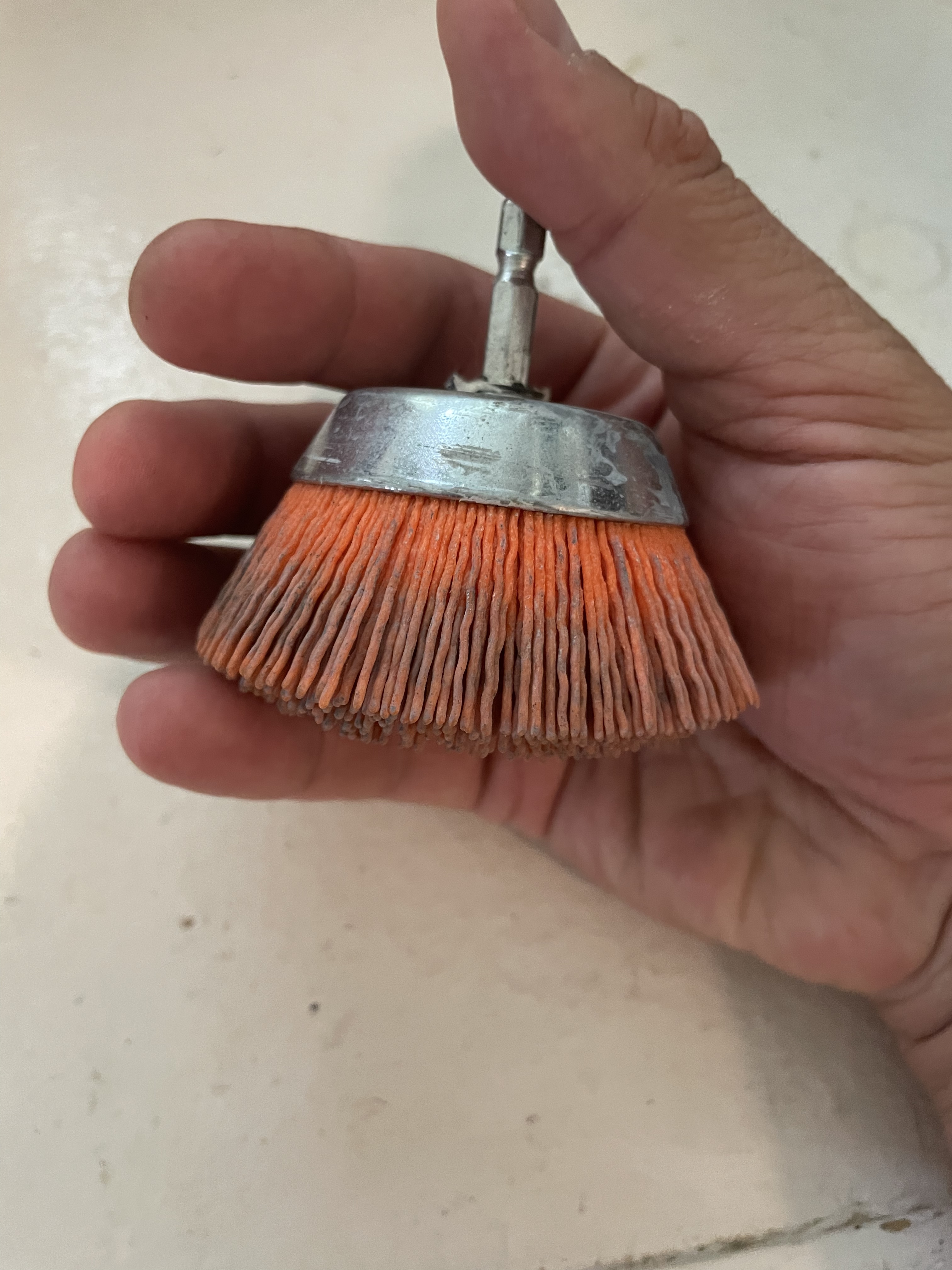

      I use Citri-strip to clean my Sheridans. Soak them
      for a few hours and then use a nylon cup brush in my drill to 90% of it off.
