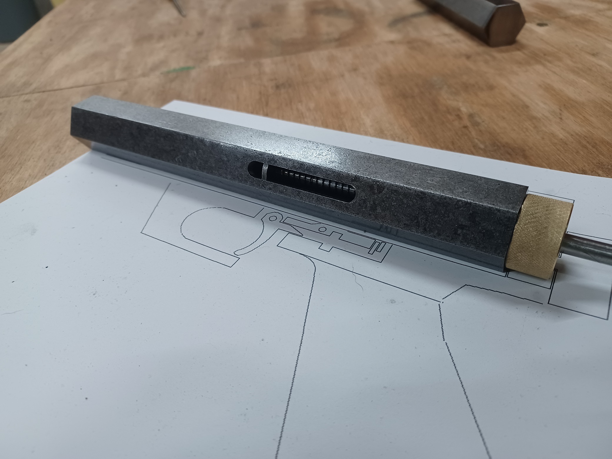

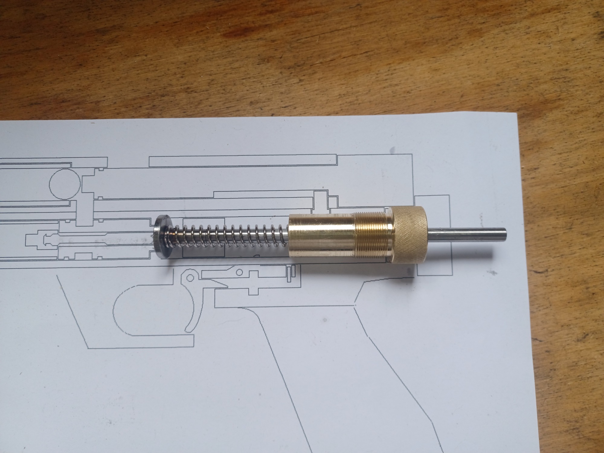

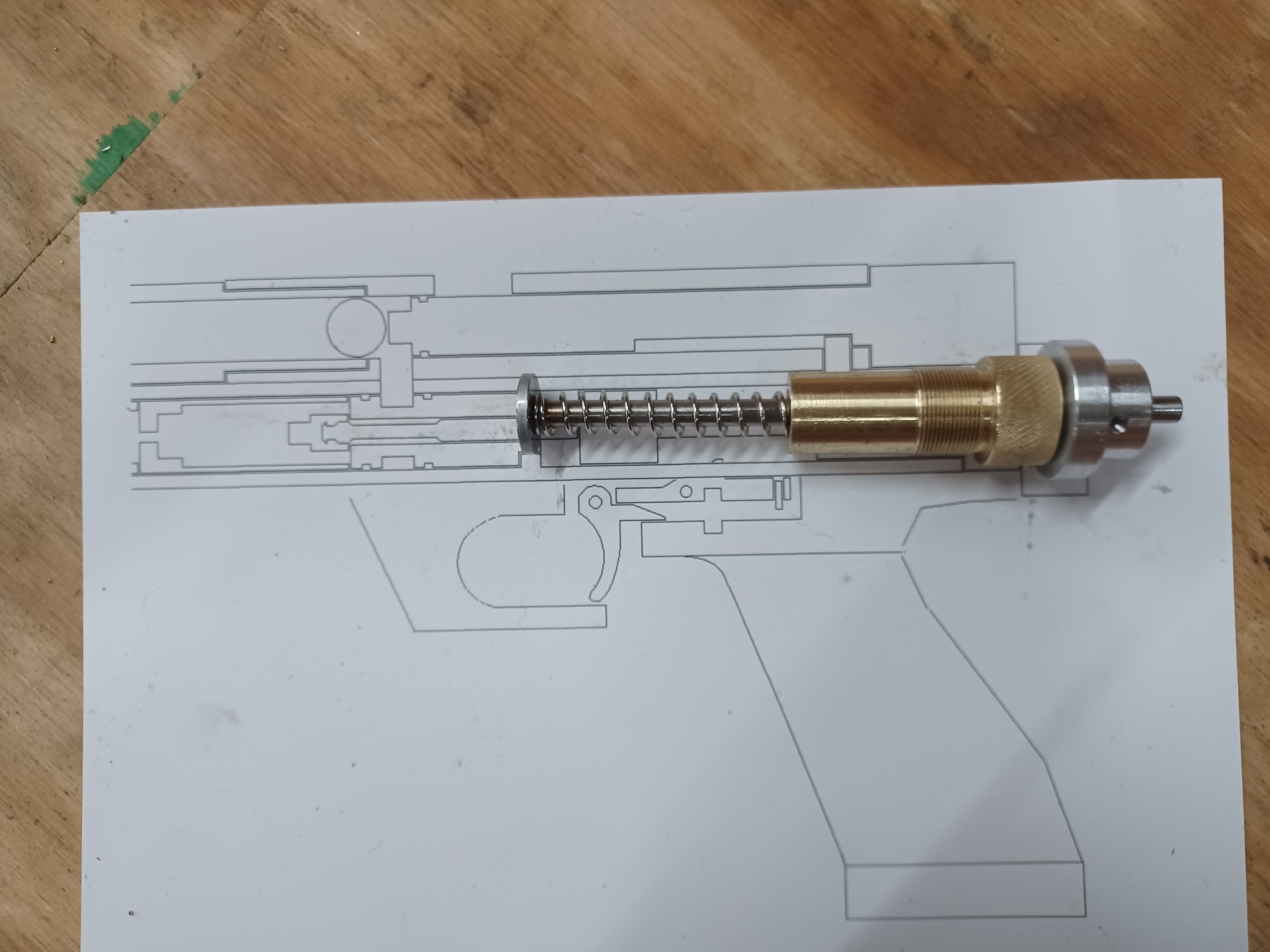

    stainless hammer. spring is totally wrong. i think i'm going to have to make my own spring
    time spent: 3 hours

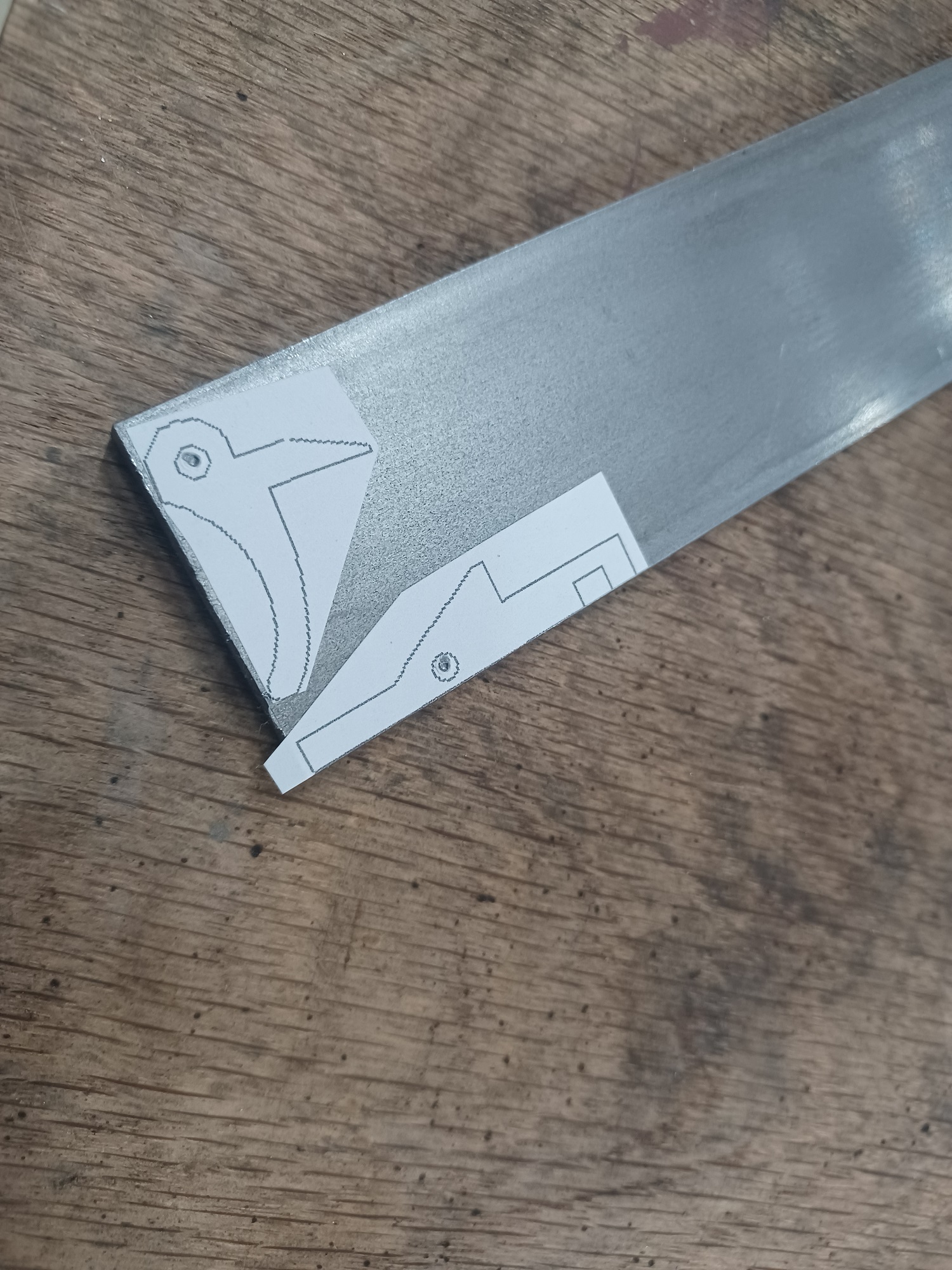

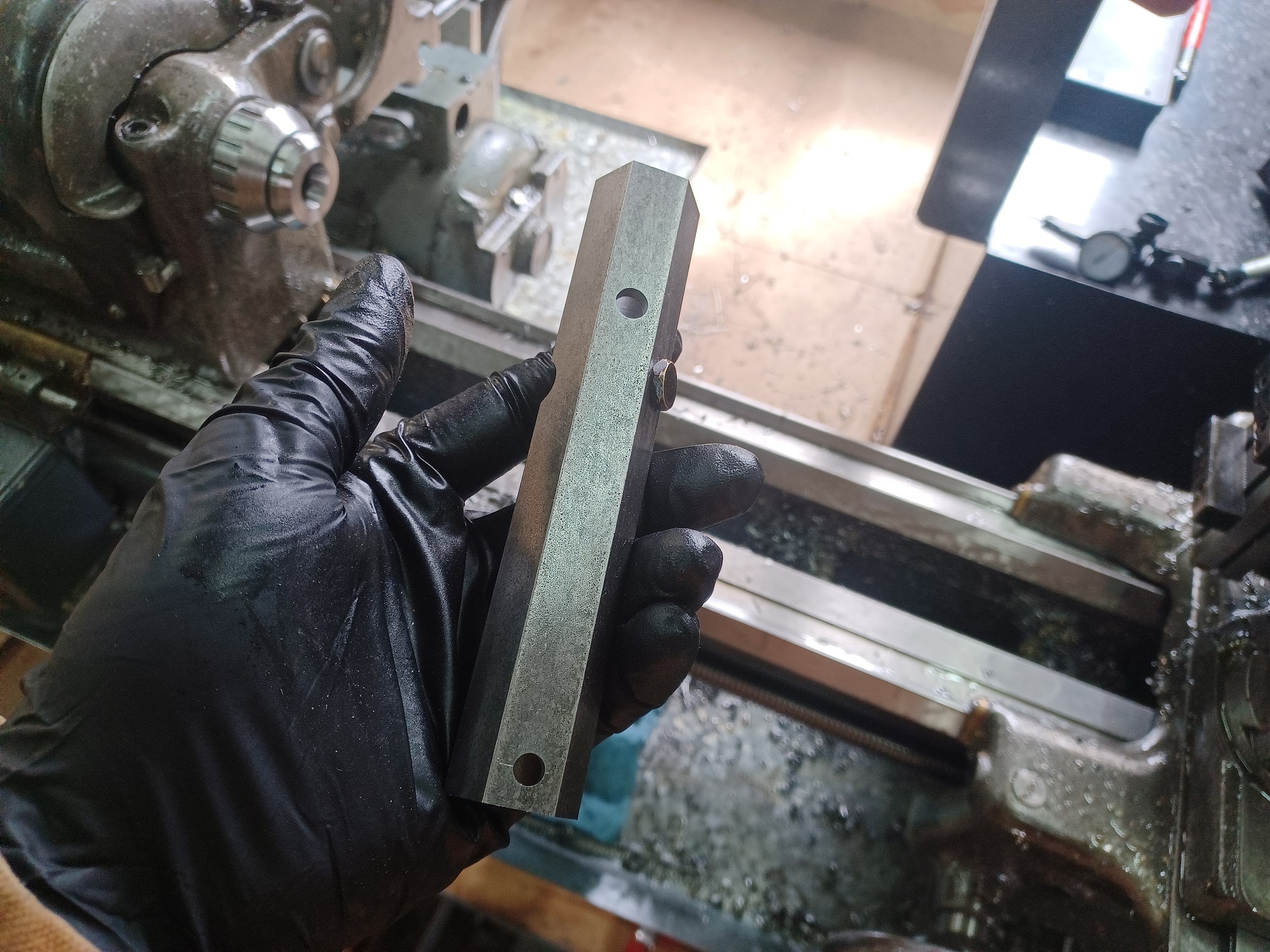

      milled a slot in the body for a sear. finished up the hammer assembly (minus a grub screw)
      time spent: 3 hours

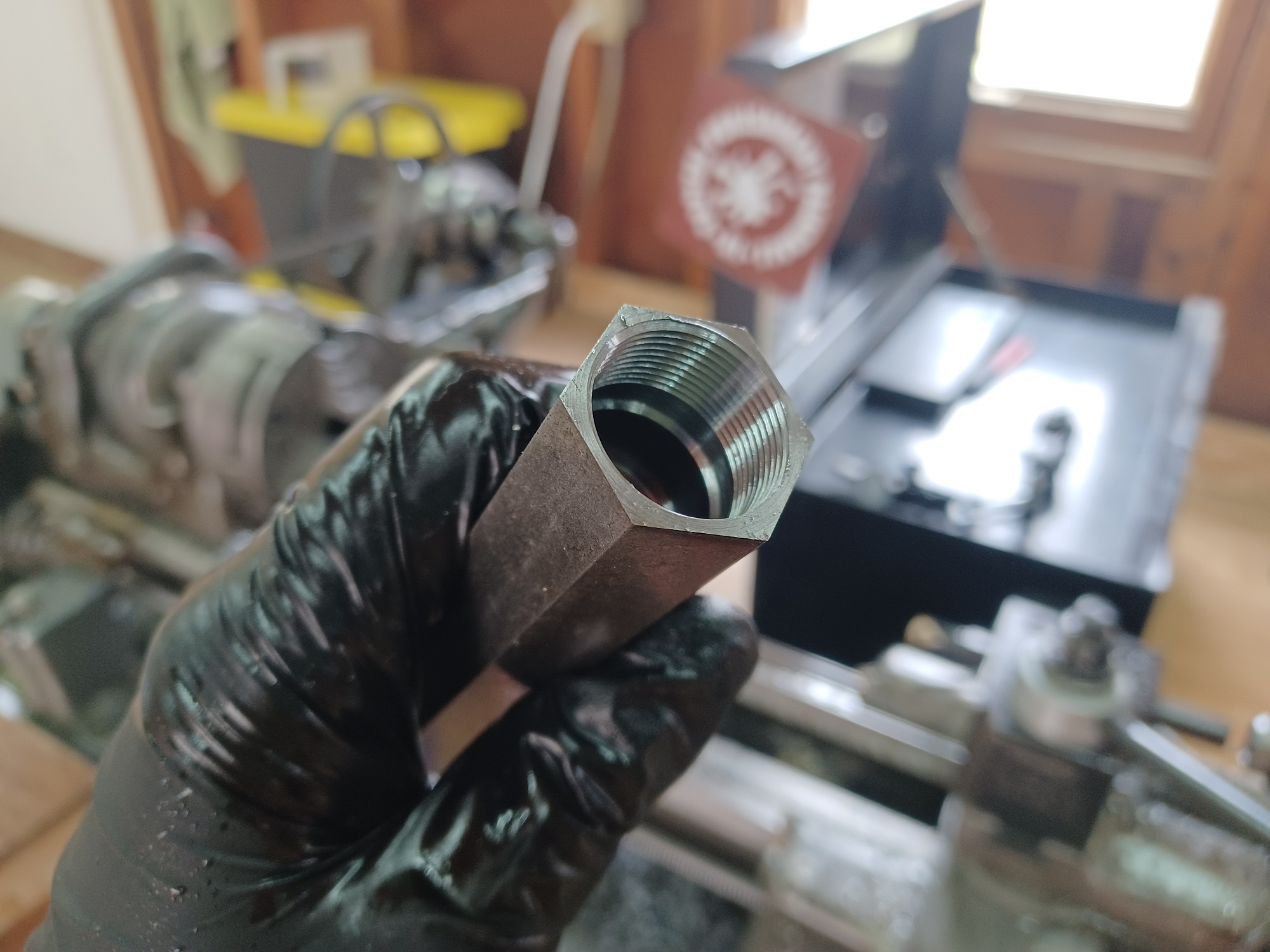

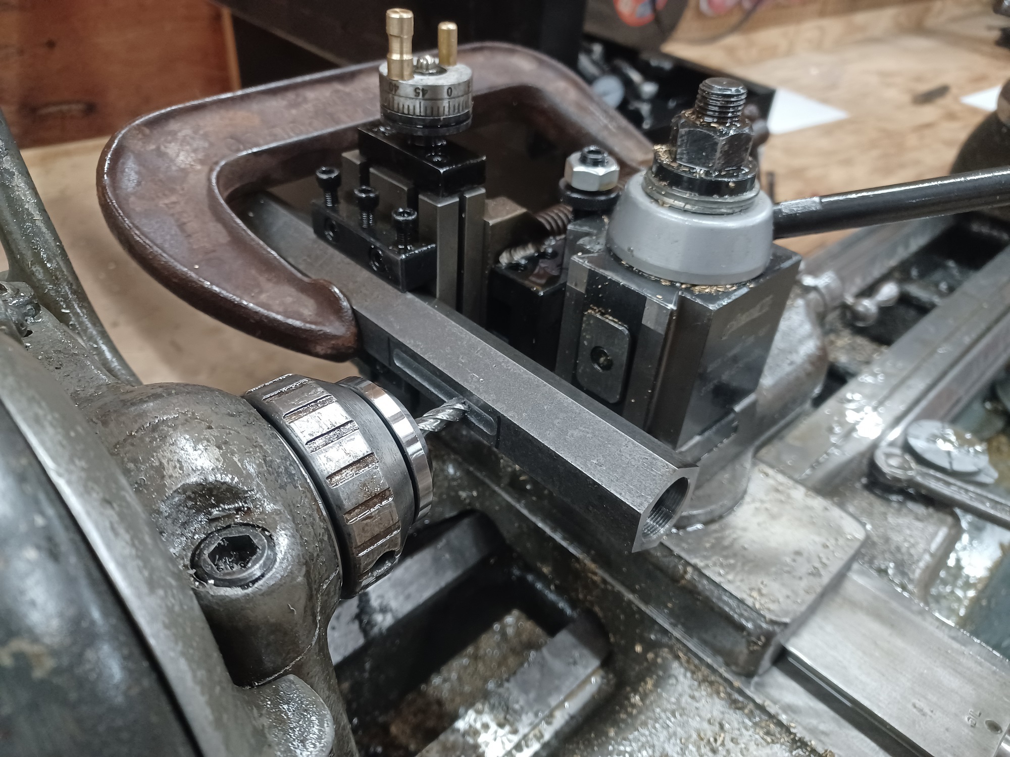

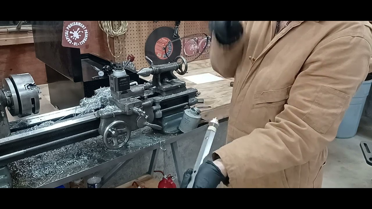

        drilled out the top tube. cocker threaded
        time spent: 4 hours

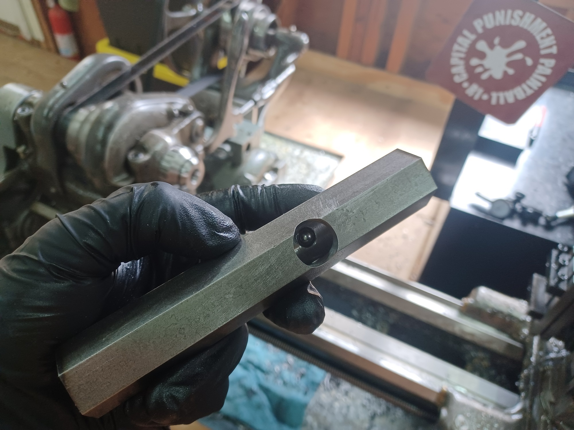

      • markdem
        G'day mate 🇦🇺
        • Nov 2022
        • 416
        • Rhode Island
        #20
        drilled a couple holes in the top tube. stole a detent from a cocker
        time spent: 2 hours

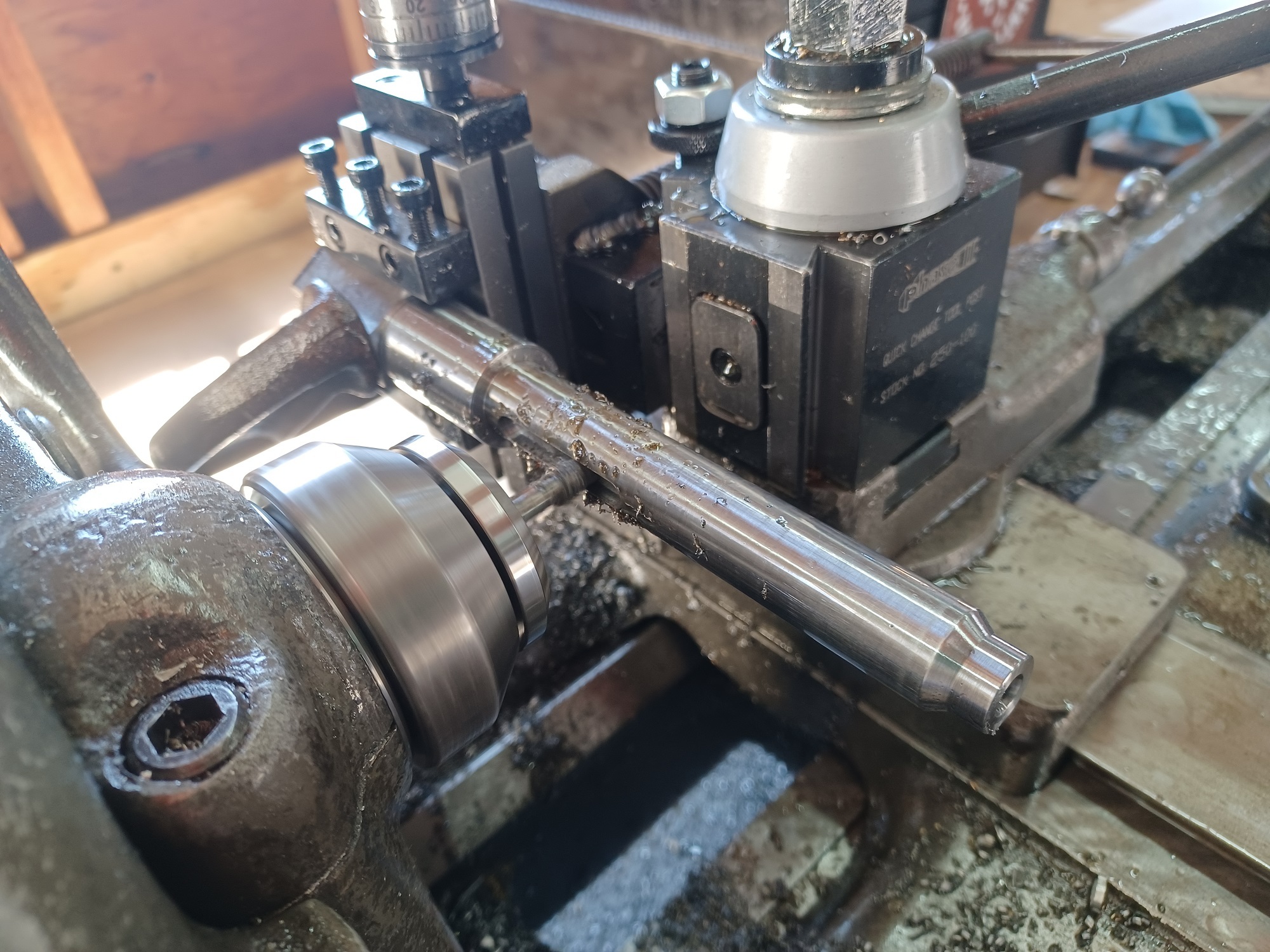

        • markdem
          G'day mate 🇦🇺
          • Nov 2022
          • 416
          • Rhode Island

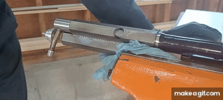

          #21

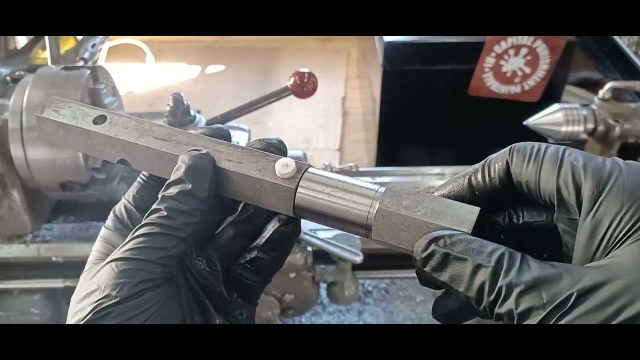

          did a good portion of the bolt. still need to make the bolt handle. a delrin pin/lug keeps everything tight whilst maintaining minimal friction
          time spent: 4 hours

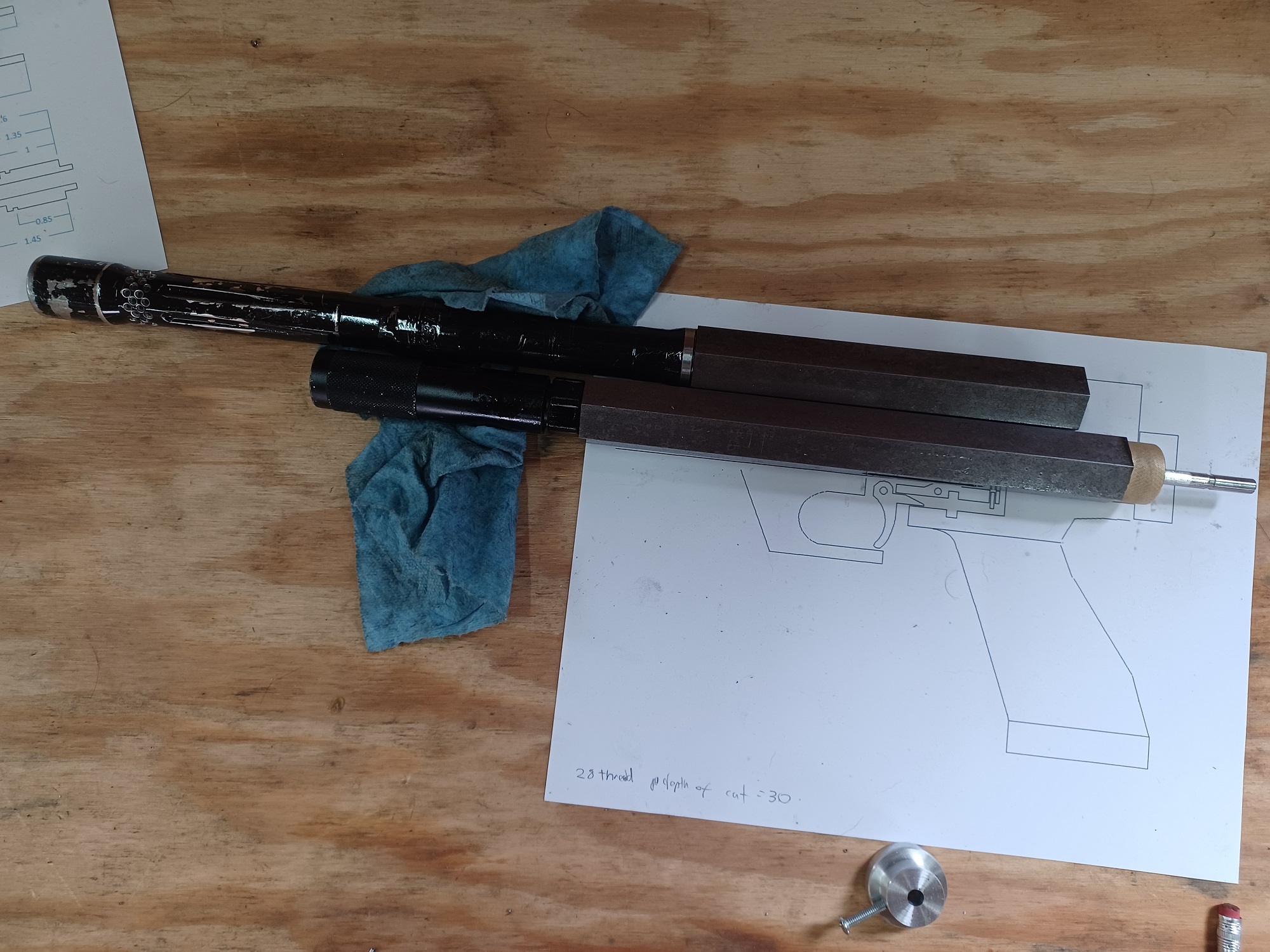

          • markdem
            G'day mate 🇦🇺
            • Nov 2022
            • 416
            • Rhode Island

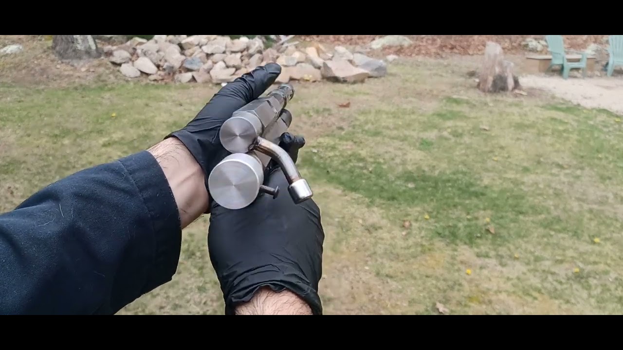

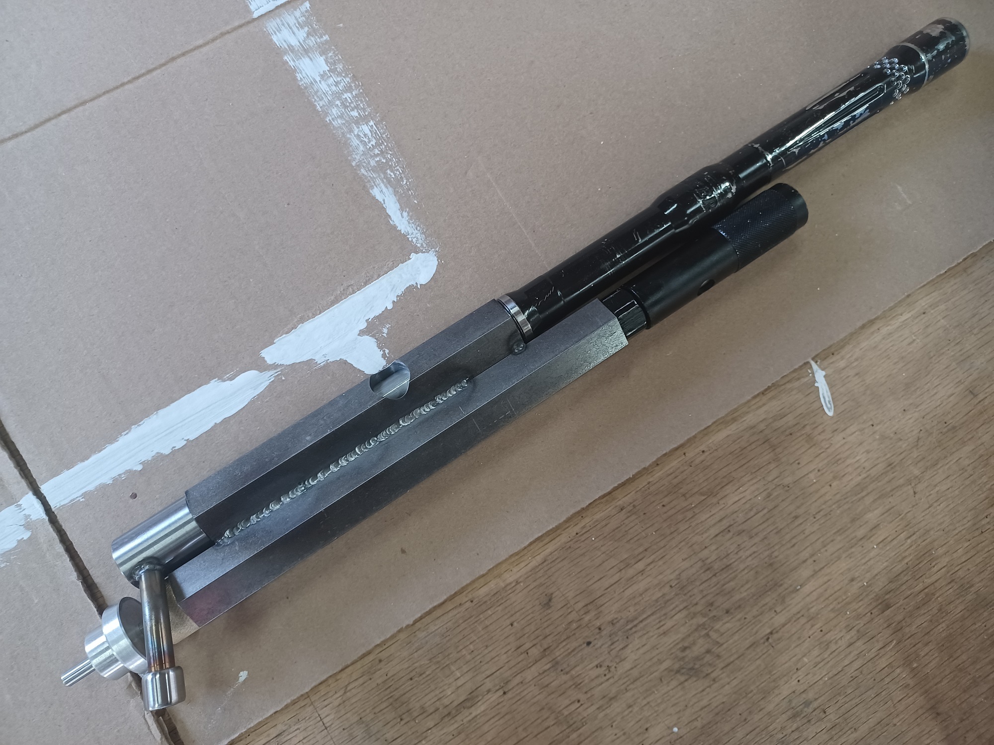

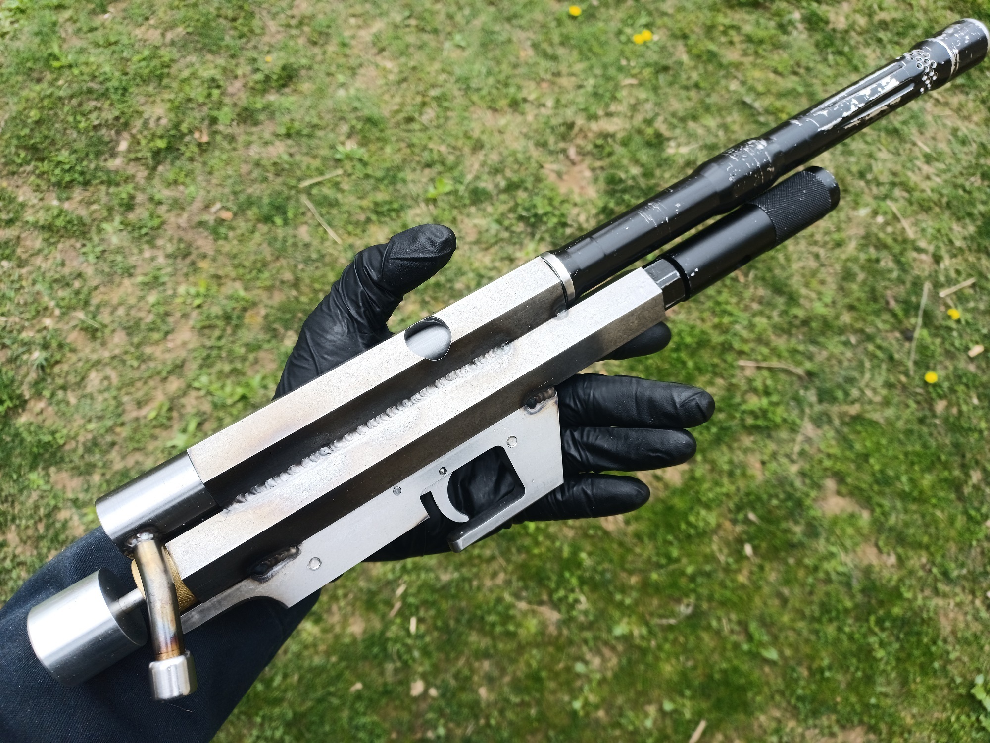

            #22

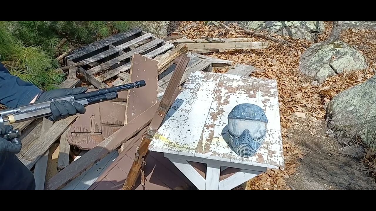

            let me clarify that i would NEVER shoot these velocities at a field. I simply aired up the marker, loaded a paintball for the first time and recorded my findings... still, 770fps is impressive and i wanted to see what would happen if i got shot in the mask at these speeds. one mask cracked, but still would have protected the players face. the other mask was unscathed.

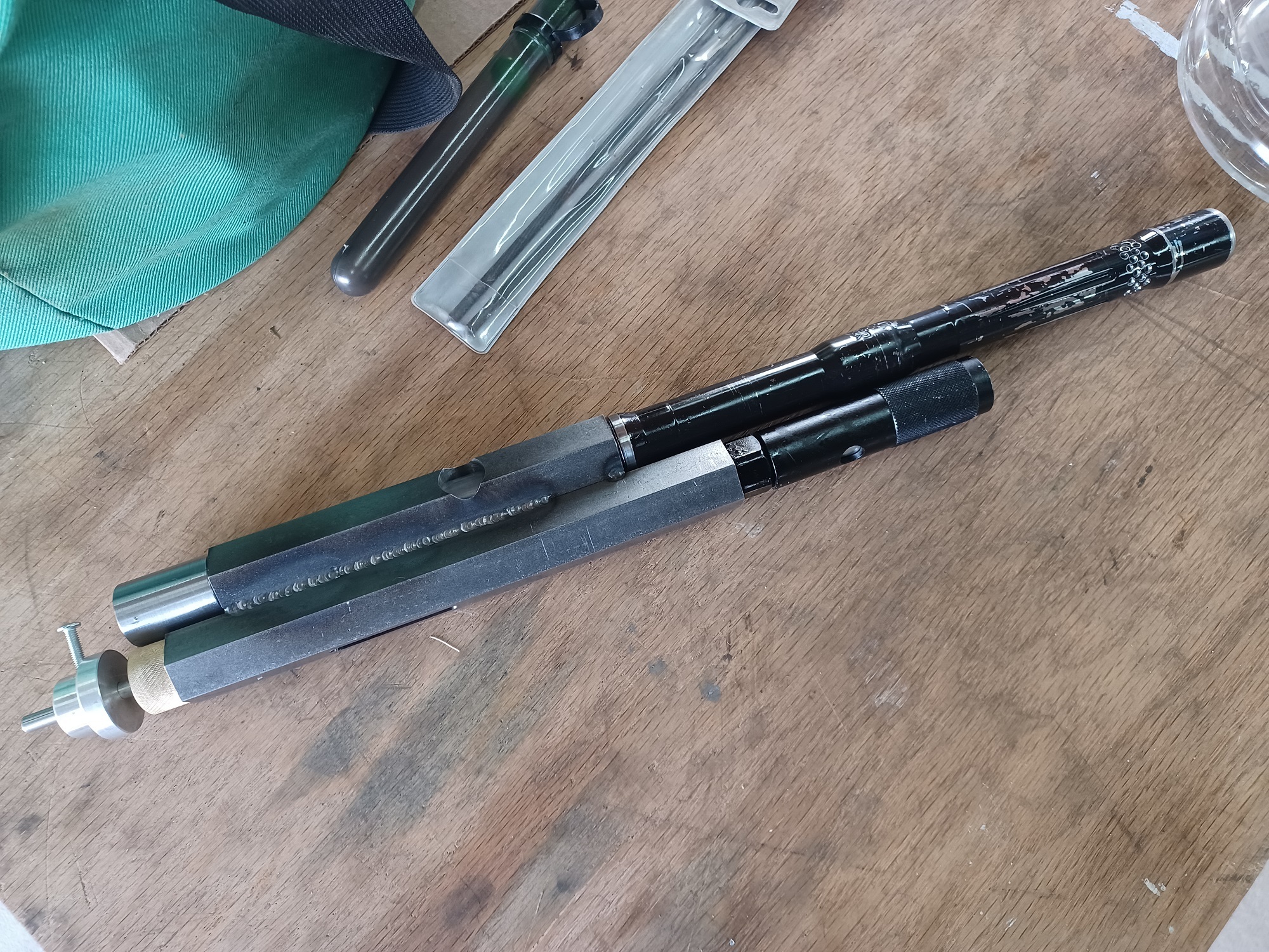

            welded the upper and lower tubes together. i was hoping to simply fuse the tubes together but as it turns out, 12L14 requires a stainless filler, so the welds arent as clean as i'd hoped. i didnt weld around the barrel threads in fear of messing them up.
            penetrating loctite was applied to the crack between the upper and lower tubes. this will act as an air seal around the transfer port
            time spent: 4 hours
            • Siress
              Siress commented
              I'm loving these videos. Have you got a 3rd party calibration certificate for that chronograph? I don't think I've ever heard of paintballs surviving the forces required to get up to 770fps over ~9". Now I'm wondering what the practical limit is for velocity of a paintball..
              Slow down there hoss I don't think anyone wants to get hit with a paintball going 777 fps

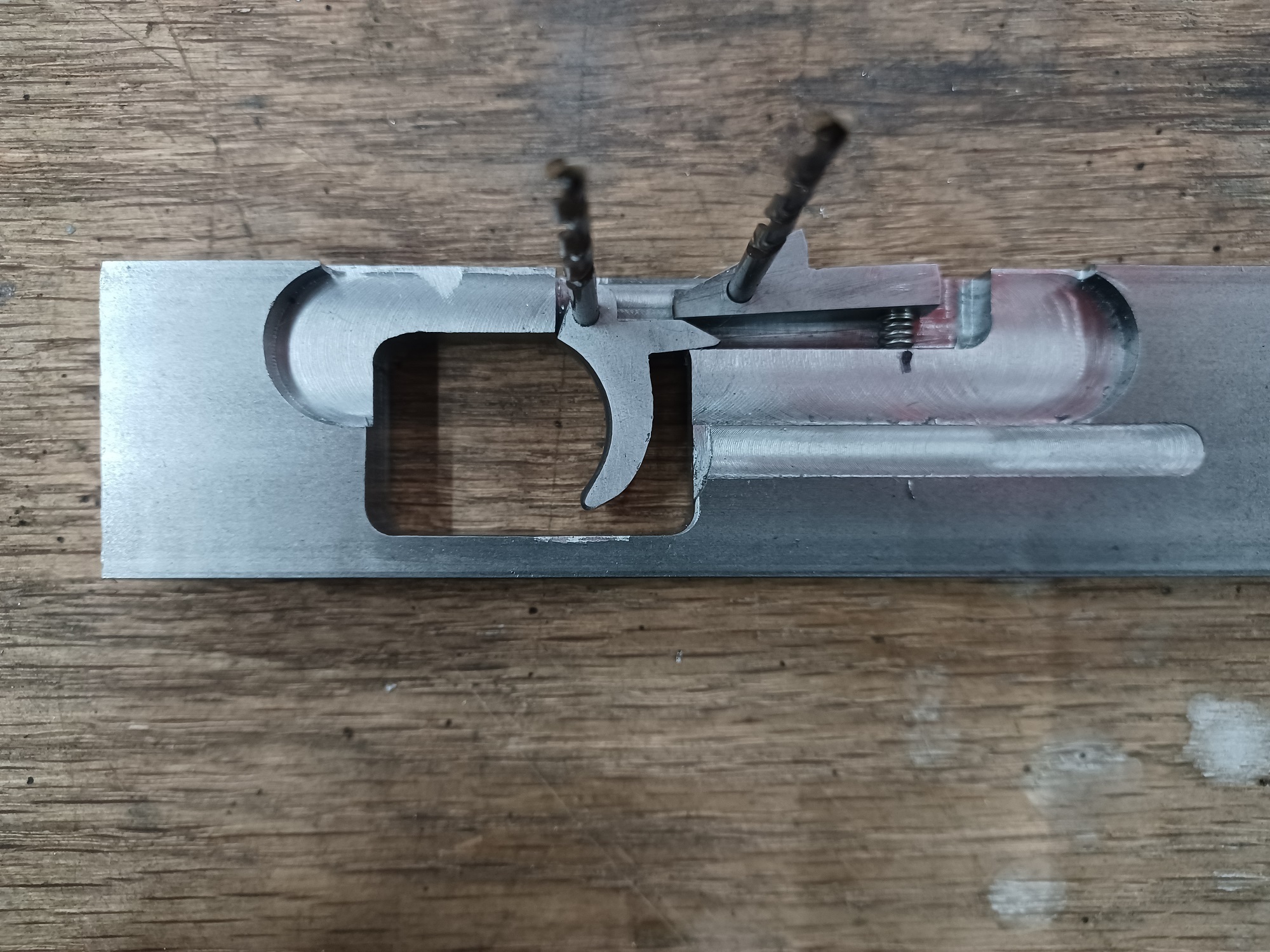

            • markdem
              G'day mate 🇦🇺
              • Nov 2022
              • 416
              • Rhode Island
              #24

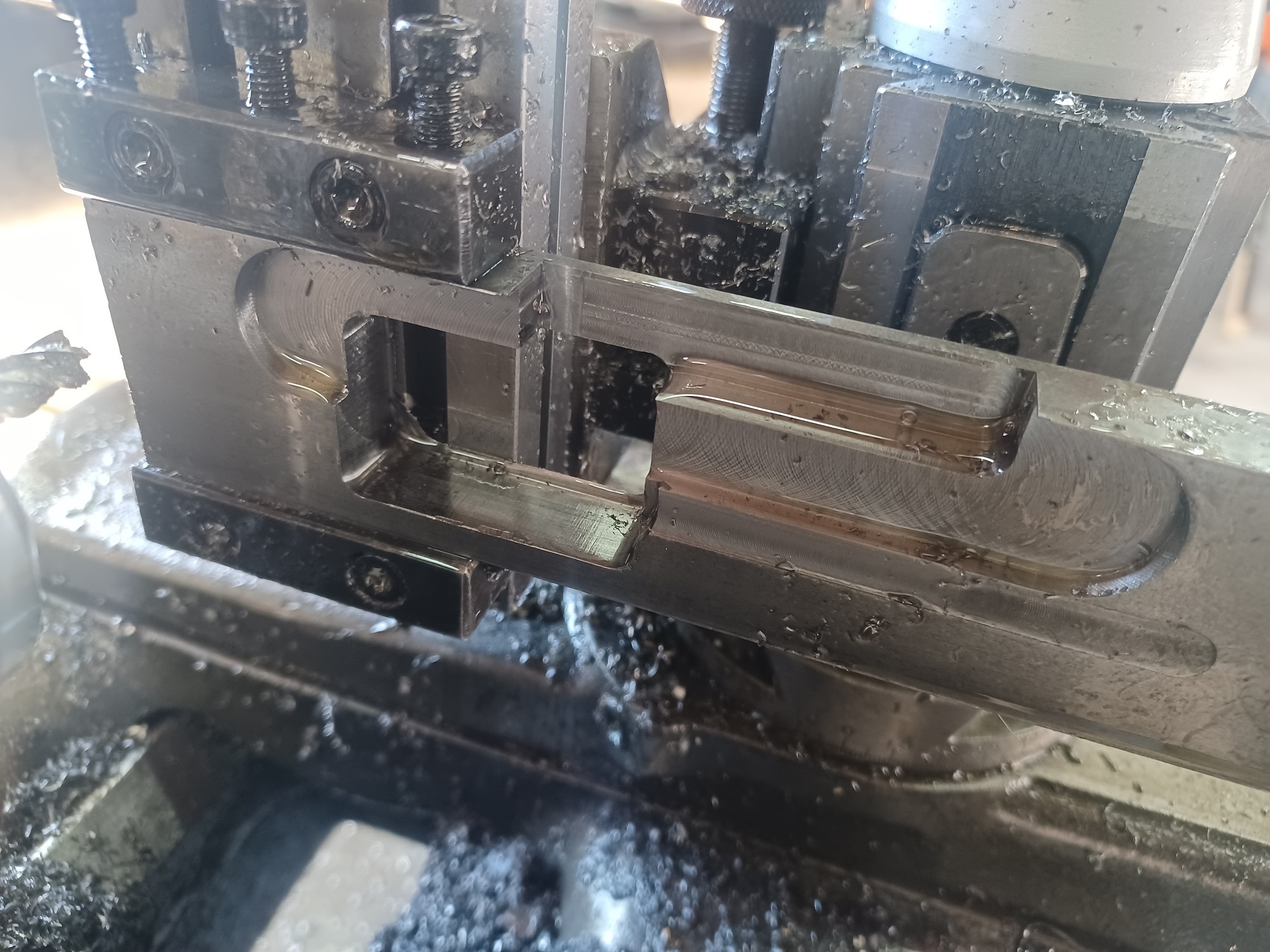

              carved out the innards of the trigger housing
              time spent: 5 hours

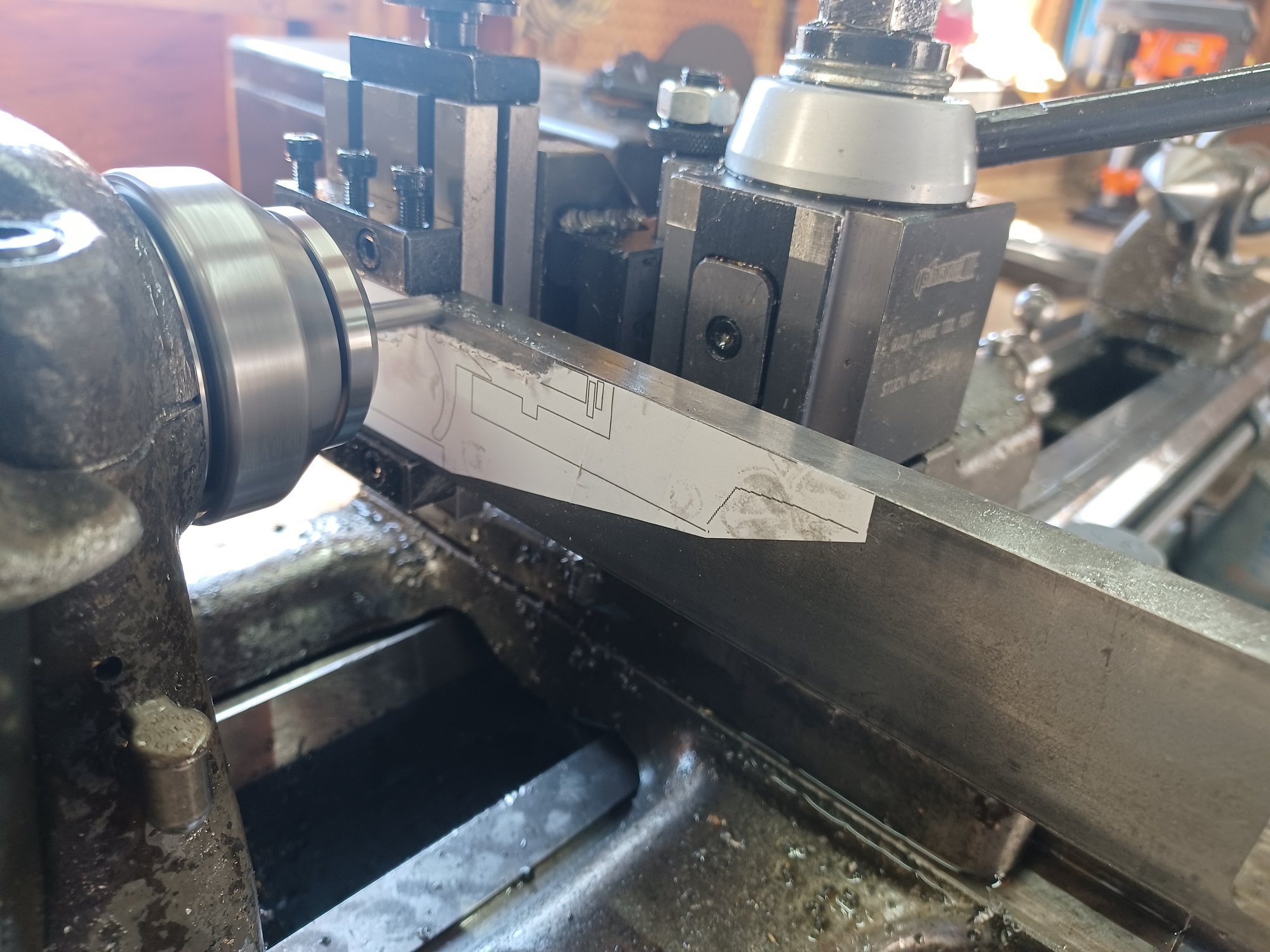

              #25

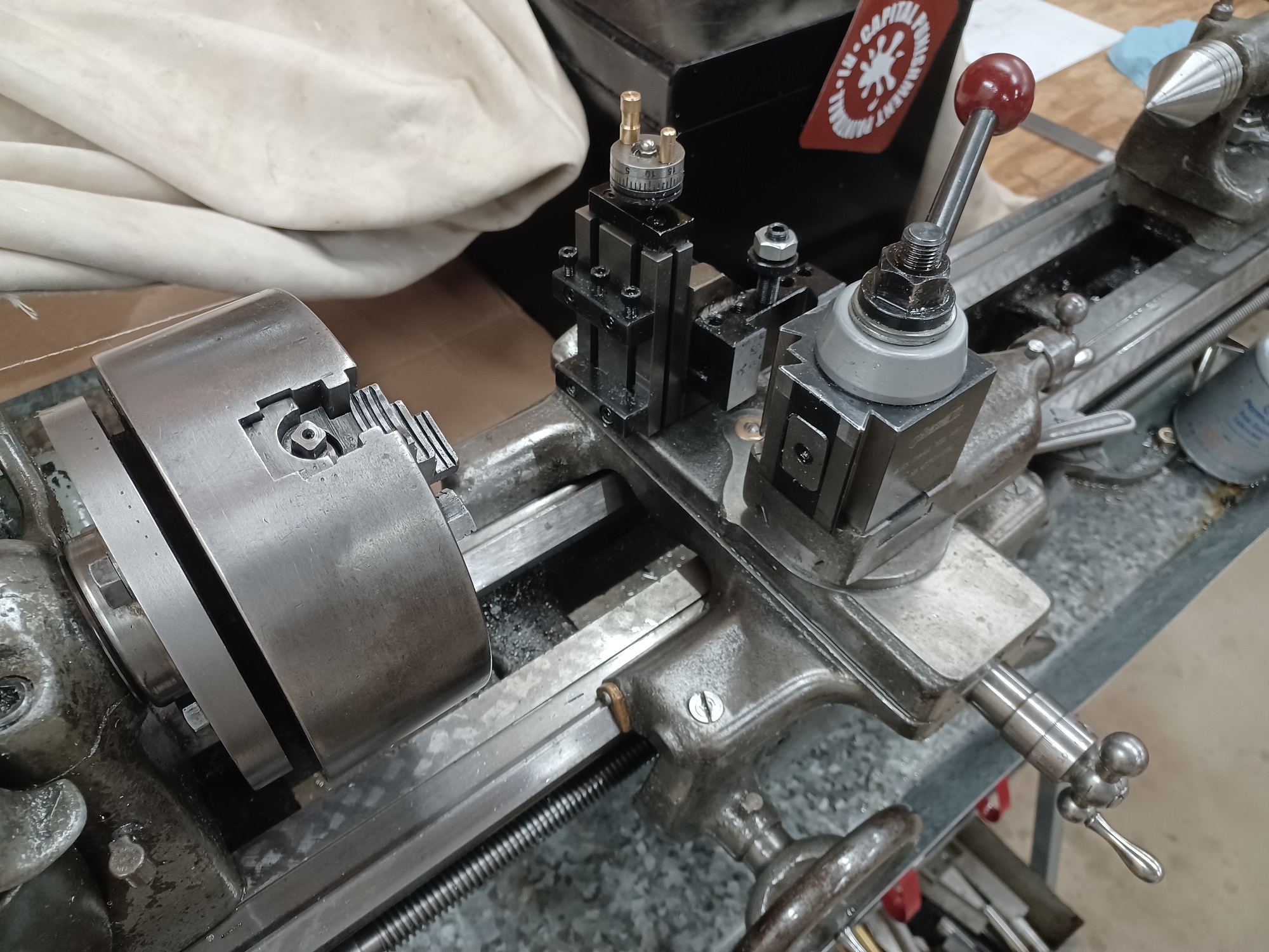

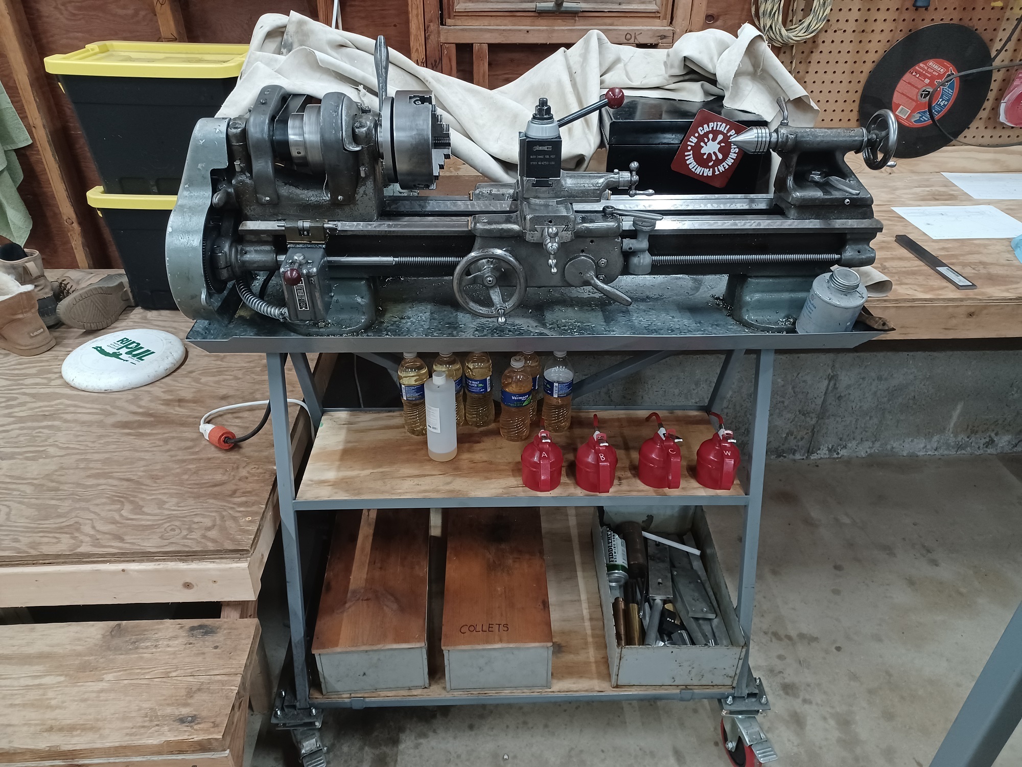

              for those interested in the tools i use. hopefuly this helps
              but in an ironic twist, this next part of the project goes back to basics. an angle grinder and a hand file were the best tools to use today
              time spent: 2 hours
              Tool Post Lathe Mini Milling Vertical Slide Bed Size 95mm x 50 mm - New Boxed - - Amazon.com

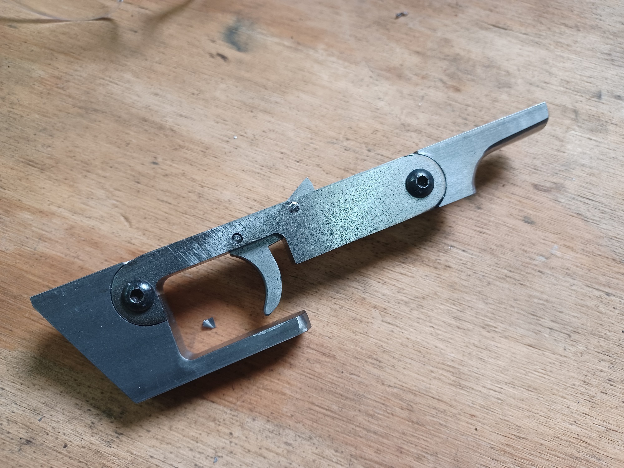

                #26
                trigger housing and internals complete
                time spent: 5 hours

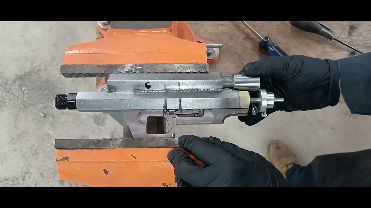

                  #27
                  welded the trigger to the body. spent a long time fine tuning bits. still a lot more fine tuning to go. i also got the velocity down to a more civil 350fps.
                  time spent: 6 hours

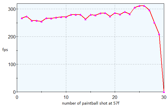

                  #28
                  this thing squeezes every last drop of gas from that little 12 gram! the 29th shot is at 210fps. the 30th shot wont even leave the barrel. the only way to know I'm running low on gas is by the sound it makes on the last couple shots

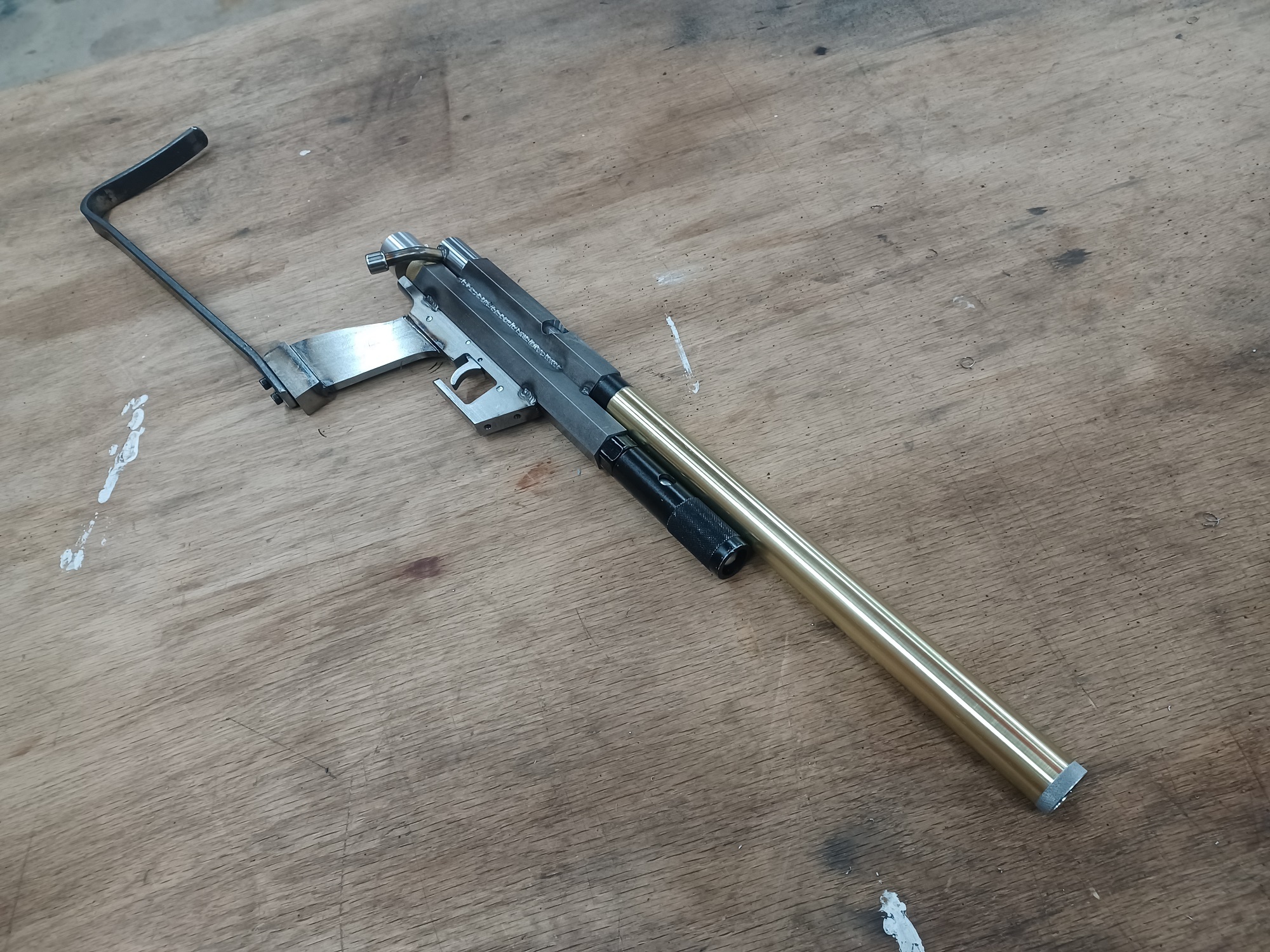

                  • markdem
                    G'day mate 🇦🇺
                    • Nov 2022
                    • 416
                    • Rhode Island
                    #29
                    slapped on a grip. bent a stock. did more fine tuning. decided to reward myself by making something fun - i rethreaded a 98 barrel for cocker, freak bored it and slapped on a giant 12" raincover.
                    next up: wood grips
                    time spent: 8 hours

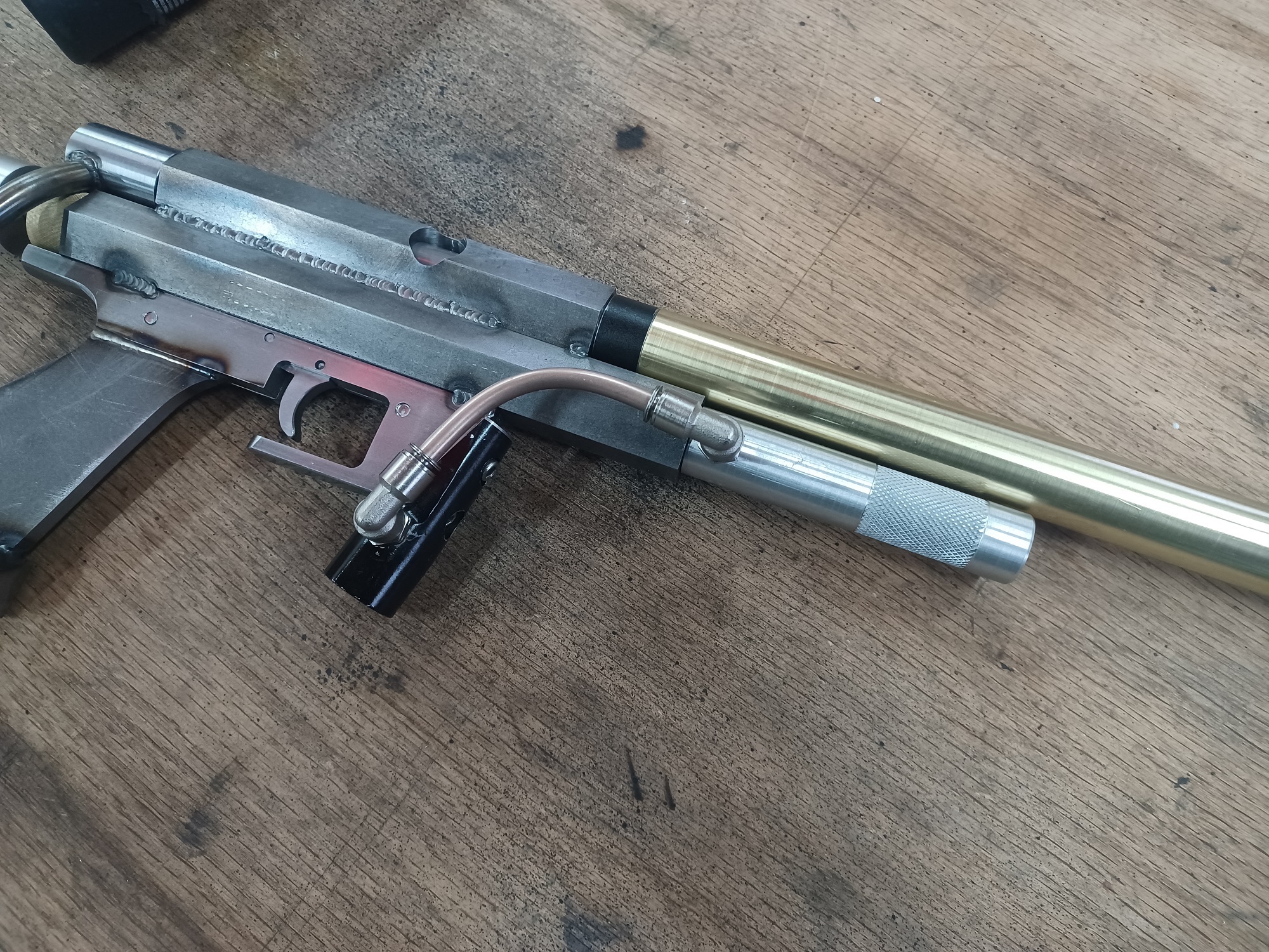

                  • markdem
                    G'day mate 🇦🇺
                    • Nov 2022
                    • 416
                    • Rhode Island
                    #30
                    was missing the parts I needed for the grips, so i focused on a constant air adapter instead. i'll be replacing the macro fittings with braided line asap
                    time spent: 5 hours
