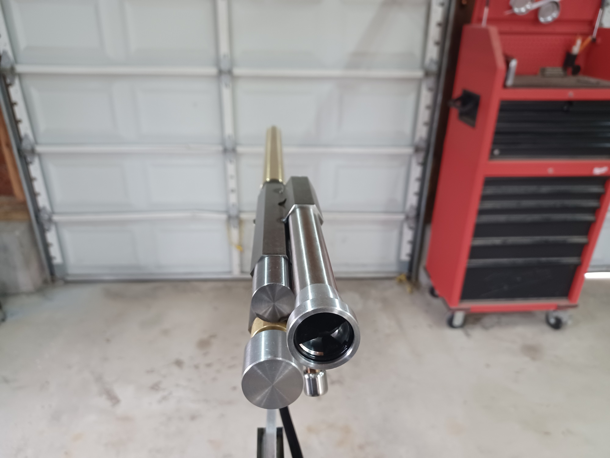

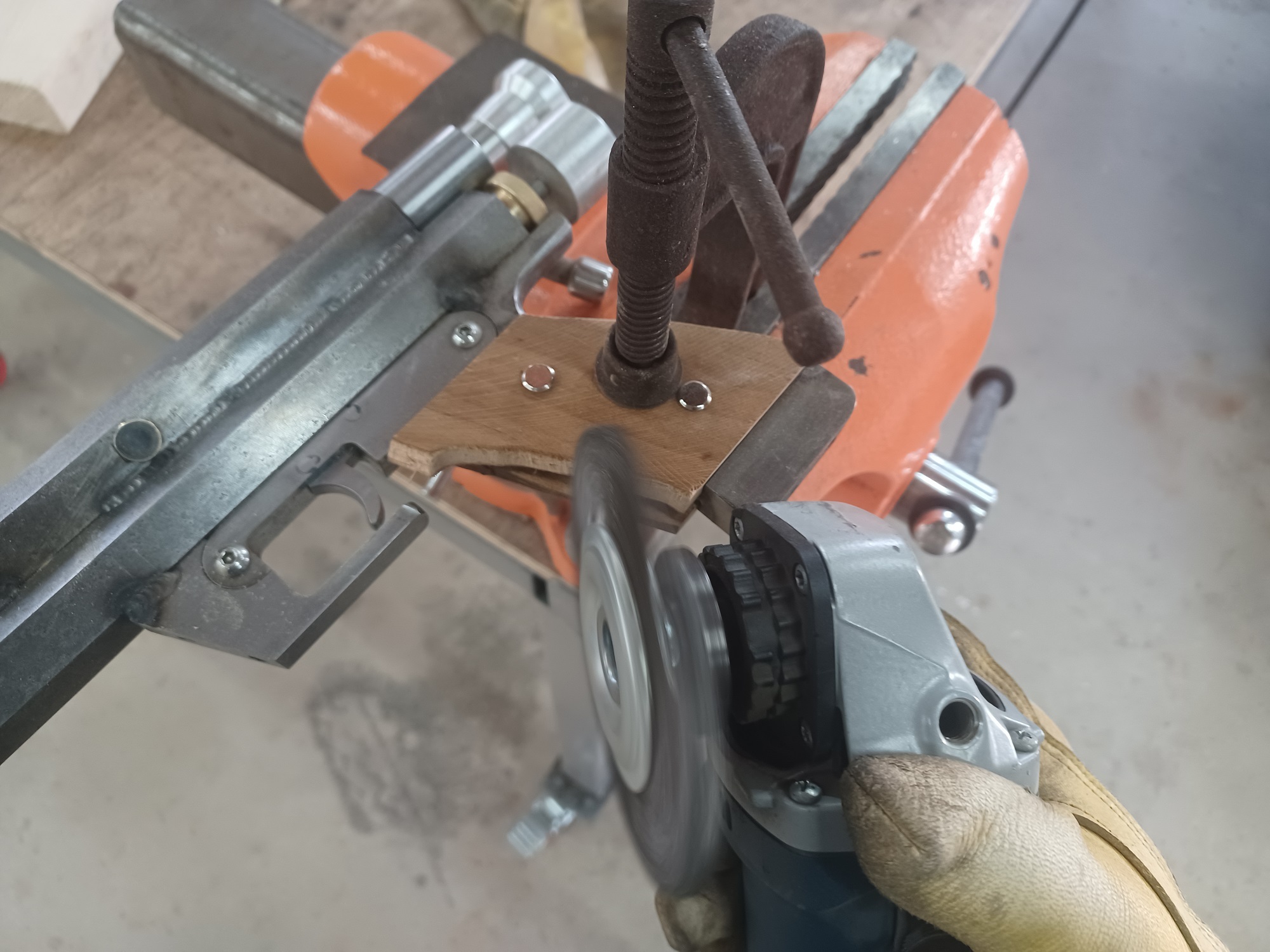

      made a feed tube. the tube is threaded into the body and reversible so i can flip it to the front of the gun if i want. its gonna get a field test tomorrow with Jonny at boston paintball. a little rough around the edges but its good enough for testing.
      time spent: 8 hours

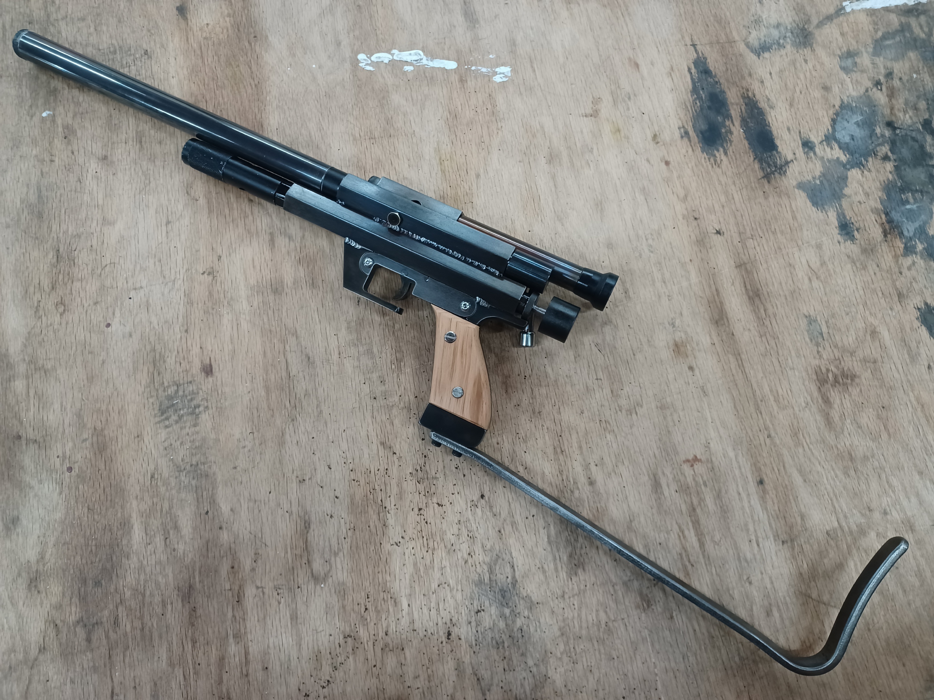

        #37

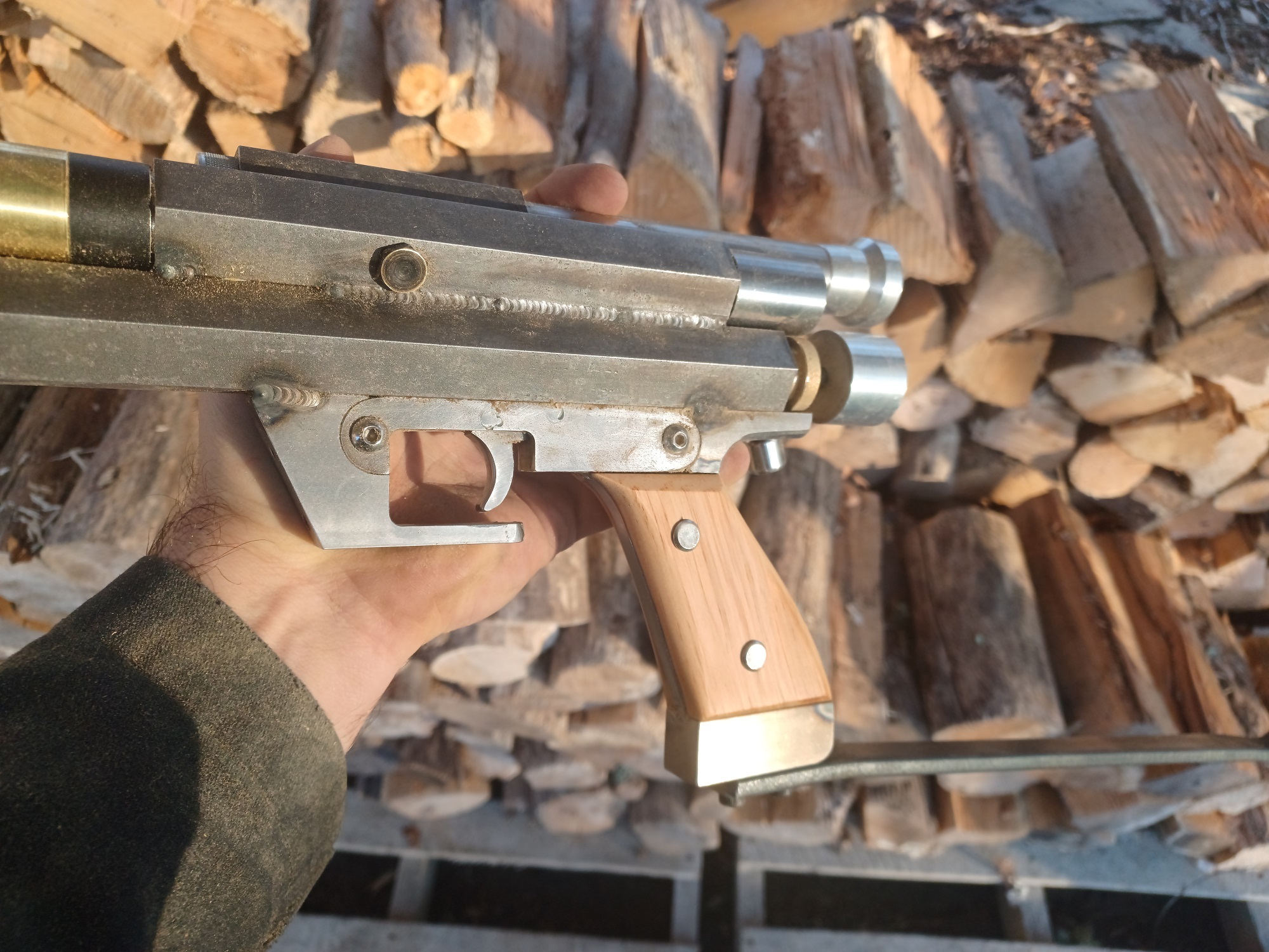

        grips. found some scrap in the basement. probably pine, maybe cedar. coated with furniture wax
        time spent: 2 hours
          Grips look cool! Nice work

            #40

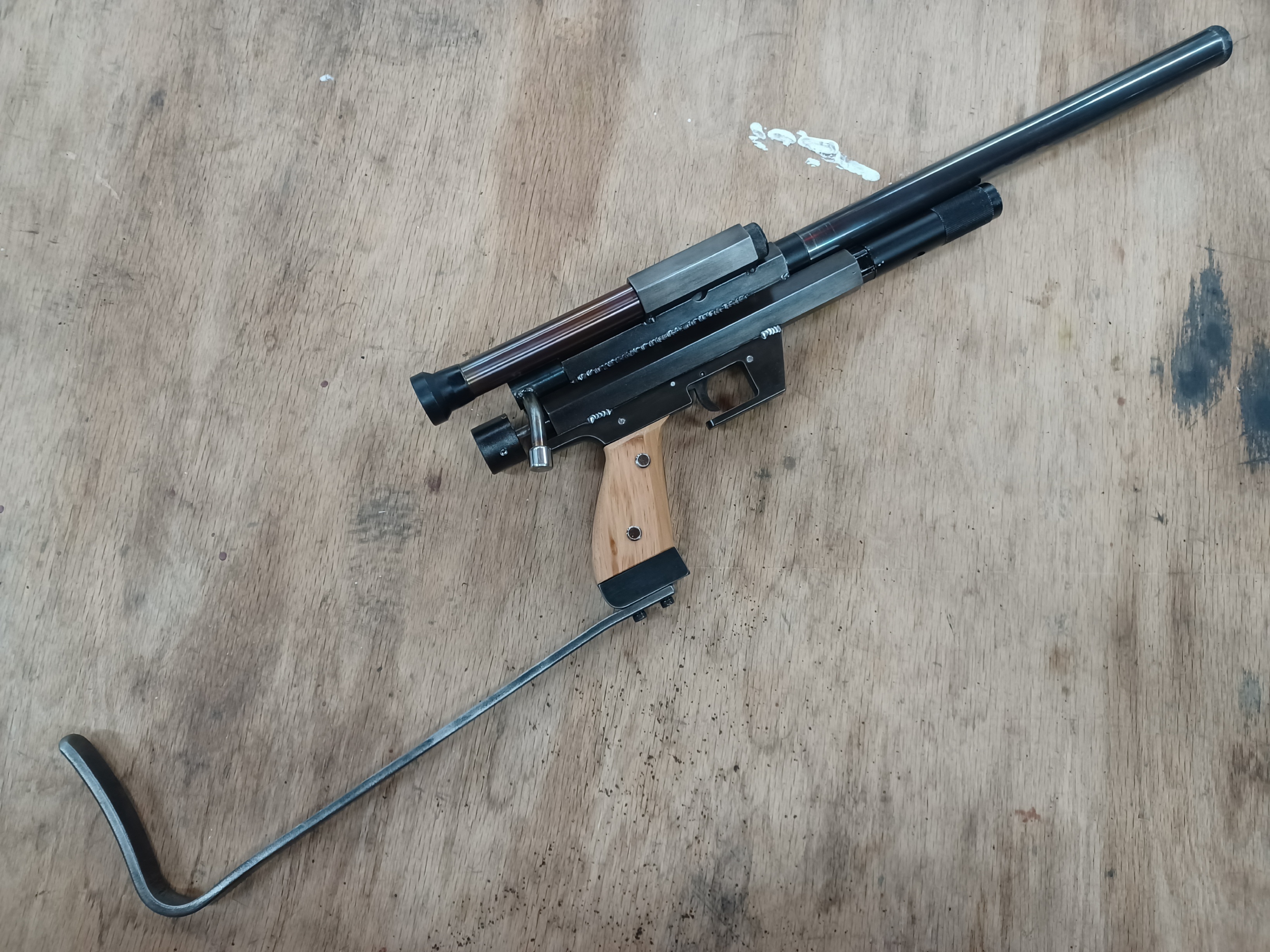

            Done. My wallet is empty, my wife hates me and a good portion of my life has been severely neglected but at least I can say I built a (functioning) gun from scratch. Obviously I will continue tweaking things for the rest of eternity but Im happy to call it complete at this point
            Time spent today: 9 hours
            Time spent over entire project: 93 hours
            estimated cost: somewhere around $500

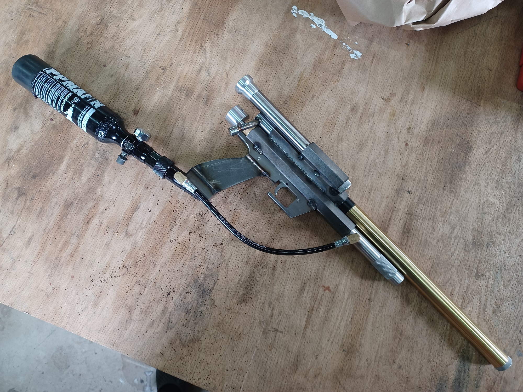

              #43
              Will this accept any standard Sheridan parts or did you follow the design but set your own dimensions?
              • markdem
                markdem commented
                I followed the design but set my own dimensions. Theres only a handful of standard parts on the gun:
                4x 10-32 screws. 2 in the trigger housing. 2 on the tank/stock mount.
                12 gram changer.
                Phantom feed gate.
                Cocker barrel.
                Cocker detent.
                O rings.
