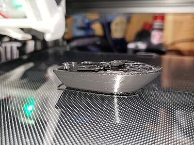

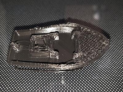

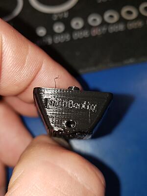

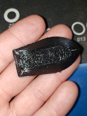

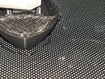

      Rainmaker any ideas where this went wrong?
      This gallery has 4 photos.
      • pghp8ntballer
        pghp8ntballer commented
        BrickHaus REPLACE THAT EXTRUDER BRASS GEAR. I say that from experience. I can see the wear in it from one of your pics in a previous post and I ran into weird feed/skipping issues on my Ender 3 V2. I found the brass gear wears fairly quickly... Like 3 or 4 spools. I ordered a dual gear extruder but until that arrived, I ordered stainless gears from Amazon. Once I put a new gear on and set the e-steps because the tooth count was different I was back in business. Then I got the dual gear extruder and have had even fewer feed concerns.
        FYI, I have only had a printer since the beginning of December... so like 5 months? So take this info with a grain of salt.
        I just picked up a Voxelab Aquila - which is a near identical copy of the Ender 3 V2. I immediately put one of the stainless extruder gears on it because I didn't want to go through that learning experience again.
        BrickHaus commented
        Thanks for that advice!!!
        I got my dual gear extruder today. Hence why I was messing with my printer all day.
        I did get a goodish benchy out of it, but I didnt realize I printed it with the creality software vs ultimaker. I have another one on the printer now running ultimaker just to compare. But it still isnt a great print. Ill keep messing with settings.

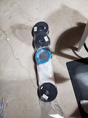

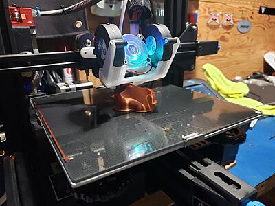

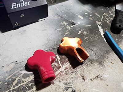

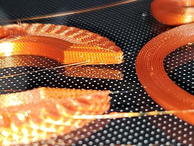

      I determined that my filaments all had water in them as I have had them all for 4 ish months, and my printer is in my basement. That is aside from my brand new spool of ttty3d silk copper filament. I didnt want to get into this roll yet, but after figuring all of my other filaments are junk, I went for it.
      I put my other filaments in a long piece of vacuum bag, with a large desiccant pack, and vacuumed it as much as my food saver would do.

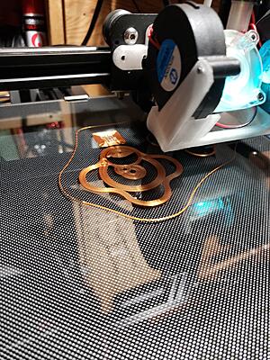

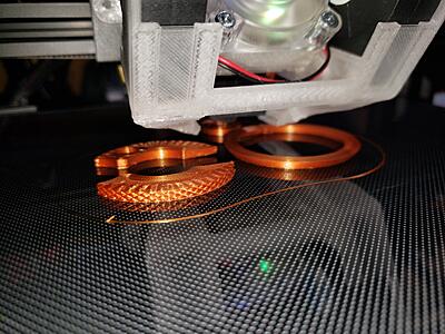

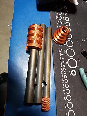

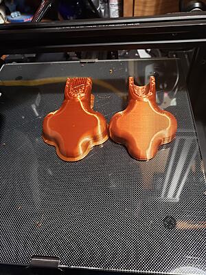

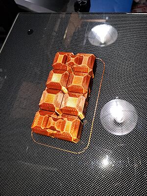

      I printed a fairly successful fidget cube over night out of the copper.

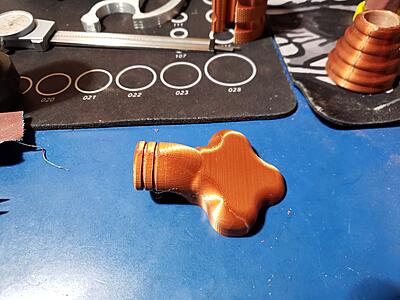

      I then went for a trifecta of pgpness by JomM this morning.
      A scifi tip, pump handle, and extended feed plug in silk copper.
      Things looked great on the first layer, but an hour in, I saw half of the pump handle was curled off the bed. So I failed the print and started it over with a slightly warmer bed temp.
      Velcor be with me!

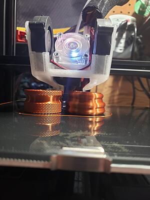

        BrickHaus commented

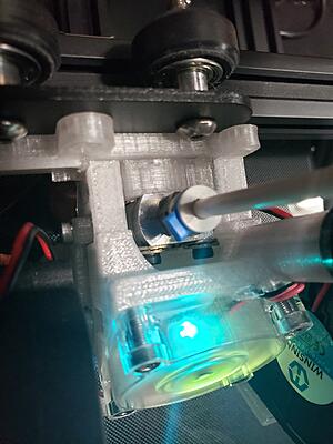

        Dual fan duct with a winsin 4020 cold end fan.
        I do have a new hot end in the mail now, but still trying to iron the issues out.
        Im currently running an extruder ratio check, and holy hell, at the stock 93 transmission ratio, I was only extruding 65 mm for a commanded 100?
        I set it to 143.1, and I overshot by 10mm, so im currently trying a value of 130.
        How could it be that far off?
      • pghp8ntballer
        I saw the same wacky high numbers when our installed my dual gear extruder. I just tried it 3 or 4 times before I was satisfied with the result. I think mine might be in the 130 range.
        XEMON commented
        I tried dual gear extruder, and it never worked ... i ditched it and went back to the original gears and it worked much better ... never had power or slippage issue that wernt cause by heat creep and flament getting stuck in the heat break (all metal hot end).
        @brickhauss, can you port a picture of your heat break?
        If its the same as mine, ill see if i have a spare titanium one for you

      XEMON i can't show my heat break this moment as I'm about half way through this print.
      i think its the stock creality heat break though. I did buy this printer open box from micro center, so there is a chance the old owner upgraded the hot end. ( my part cooling fans came with spun bearings so it got used)

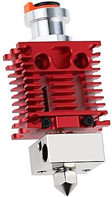

      That being said, the hot end I have in the mail should arrive tomorrow. I have a Haldis 3d red lizard Q1 to replace this hot end as a while. I believe its a bi-metallic hot end and should be better than titanium for heat creep.
      My stock extruder was a major issue, night and day difference when I swapped it, but my printer was also underextruding so I think it needed to be calibrated from jump.
      As you can see from one of these pics. Its actually working!!!! I should have some decent sheridan parts by 5 am. Too bad I leave at 4:30 for work. Lol.

        I haven't tried bi-metalic heat break ... It's on the list for the summer ... Get a lot of heat creep when it's over 110 outside and 90+ inside ...
        Let us know how it does, I'm really curious to see the difference.

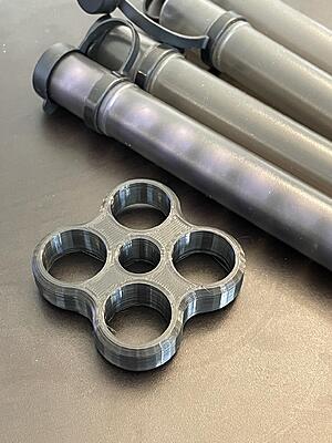

        Making a clip to join some 10 rounders. 5 tubes would have been better but the 4 tubes is the size of a pod so I can be lazy and just stick them in a pod pack.

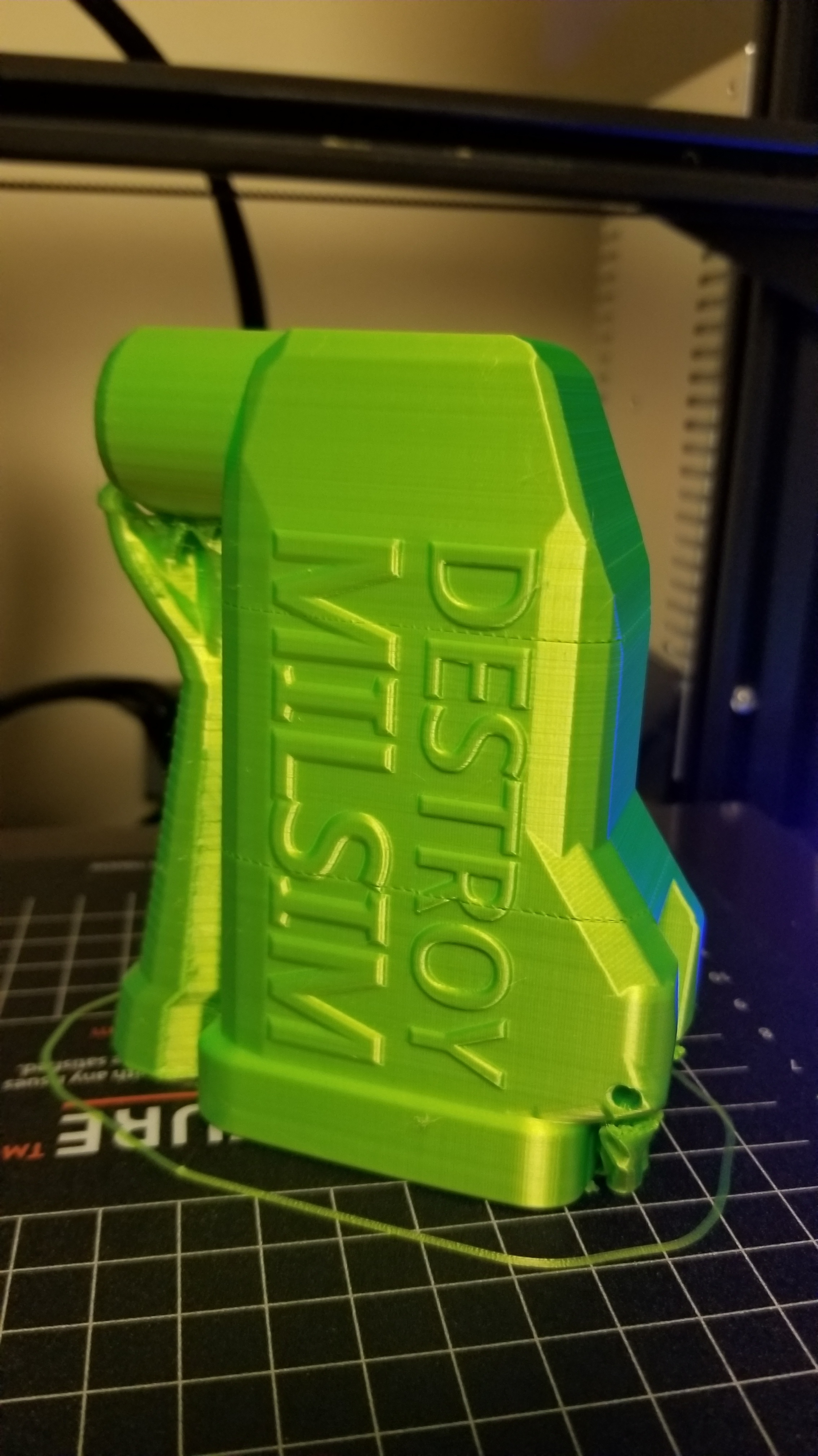

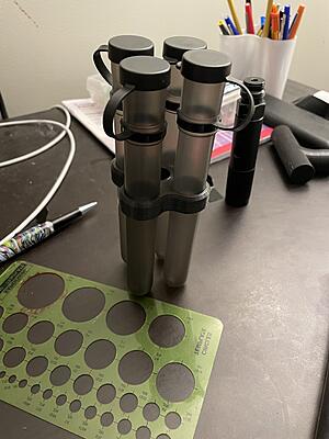

        I got half of my revolverloader 2.0 printed today. I kept knocking them off the bed so I resorted to a slooow print, and one piece at a time. Seems to have panned out! Revolver is printing now.

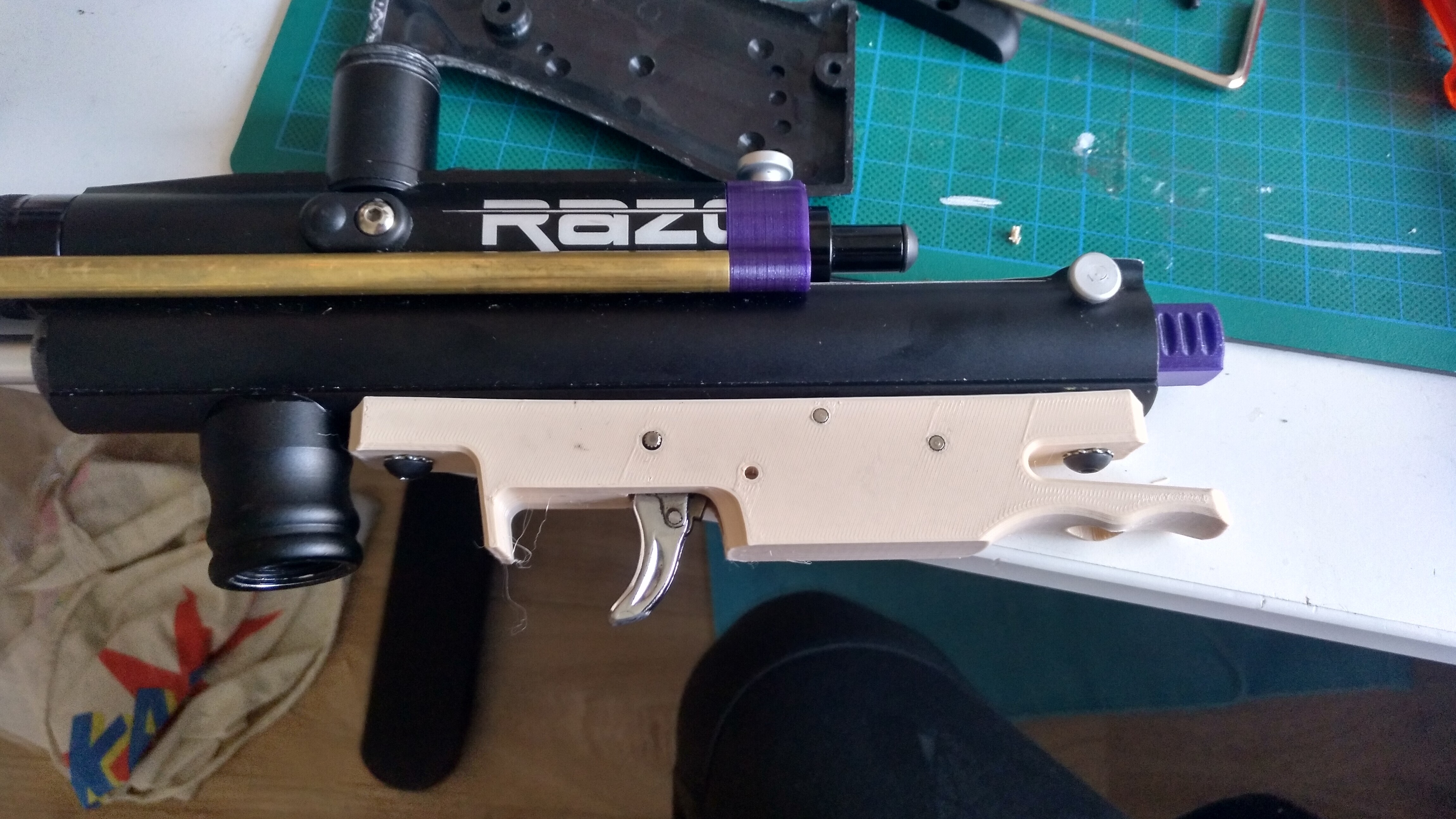

          2CEF886C-F9C5-4B31-9806-3380065DD3E9.jpegWell, progress on a slip on right feed adapter, Bringing it down to the body and adding a lip prevents it from twisting which is great. terrible heat issues though lots of warping and way too big, but progress

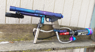

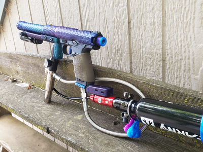

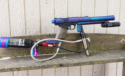

            My airsoft build is looking pretty done!

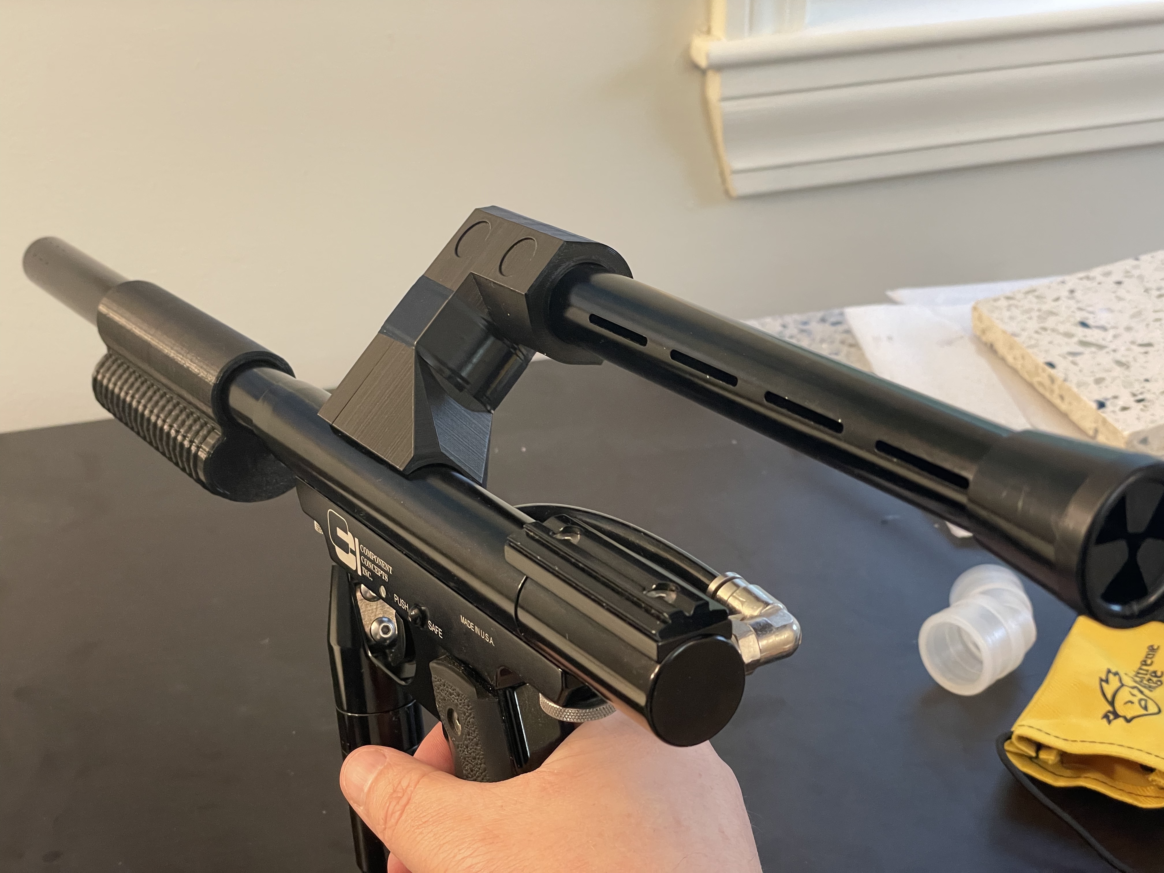

              #207

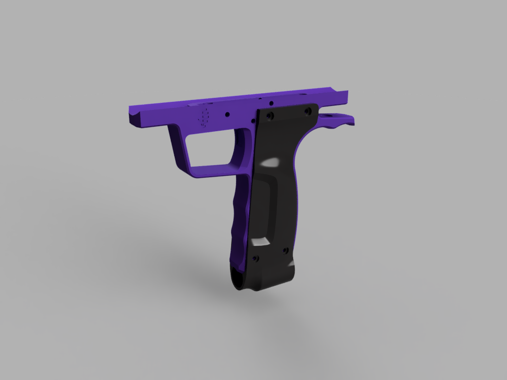

              Working on another update for my spump. The original grip is not very comfortable and also very heavy. While at it I also integrated my On/Off asa mount.
              Today I printed the first alignment test, and while some of the pin locations need twaking I was surprised to find the thing actually catches and fires fine.
              If it doesn't have the [F] i don't want it. - Europoor
              • Brokeass_baller
                Brokeass_baller commented
                Is this 90? Or does it lean forward like a Y grip?
              • devilzcall
                devilzcall commented
                Technically it's a 95° angle, but with the trigger notch being offset ~5mm forward it's pretty much straight.
                Apart from the grip sculpting, the model should be parametric enough to derive pretty any reasonable angle you'd want.

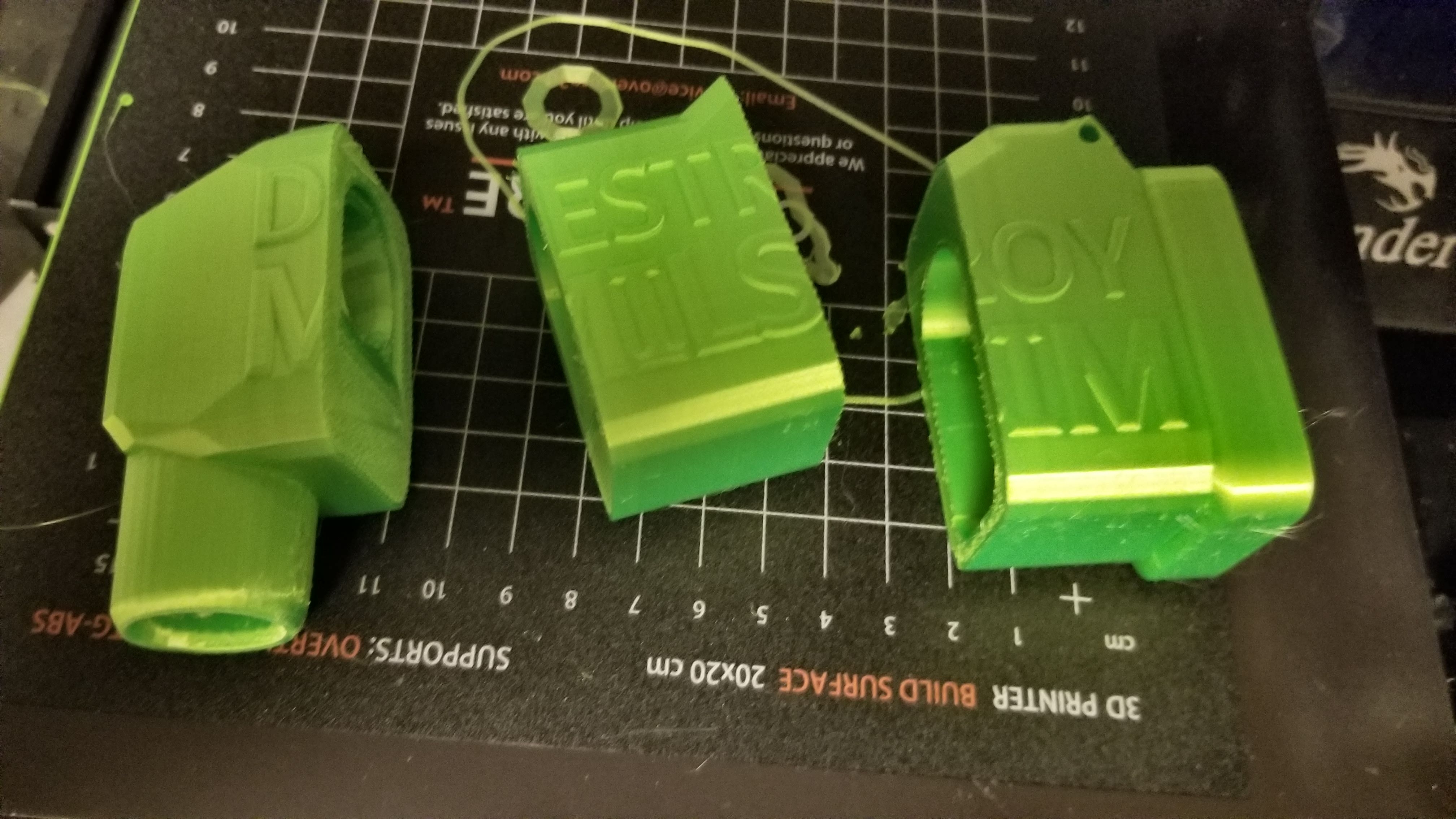

              Printed a MuddyBloodyFactory mag adaper. Pretty sure Cura is to blame for the two bad layers on this, as everything else was perfect. Those two just didnt fill correctly, and as expected from looking at it, they sheared apart with minimal force. Oh well re-slice and re-print

                BrickHaus commented
                Man you are having my luck lately..
              • OpusX
                OpusX commented
                Yeah. But no biggie. I will reorient, slice, and reprint.
              • MuddyBloodyFactory
                MuddyBloodyFactory commented
                ah sucks with the troubles. Also print the other way around! Designed for support free prints if you put it on the nose!

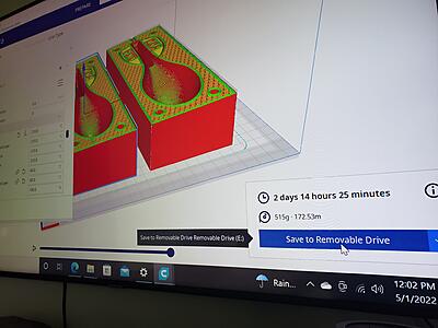

              But, the whole reason I got these baddies is to make rocket molds and make foam rockets for me and my friends to stop having to tracking rockets down as hard as we do.
              My pro is warming up right now to start the longest print I've attempted.....
              All of my previous molds have had like 5% infill, but they fail after so many rockets are made, so Im seeing if real infill numbers makes them last.. oof meter ready...
