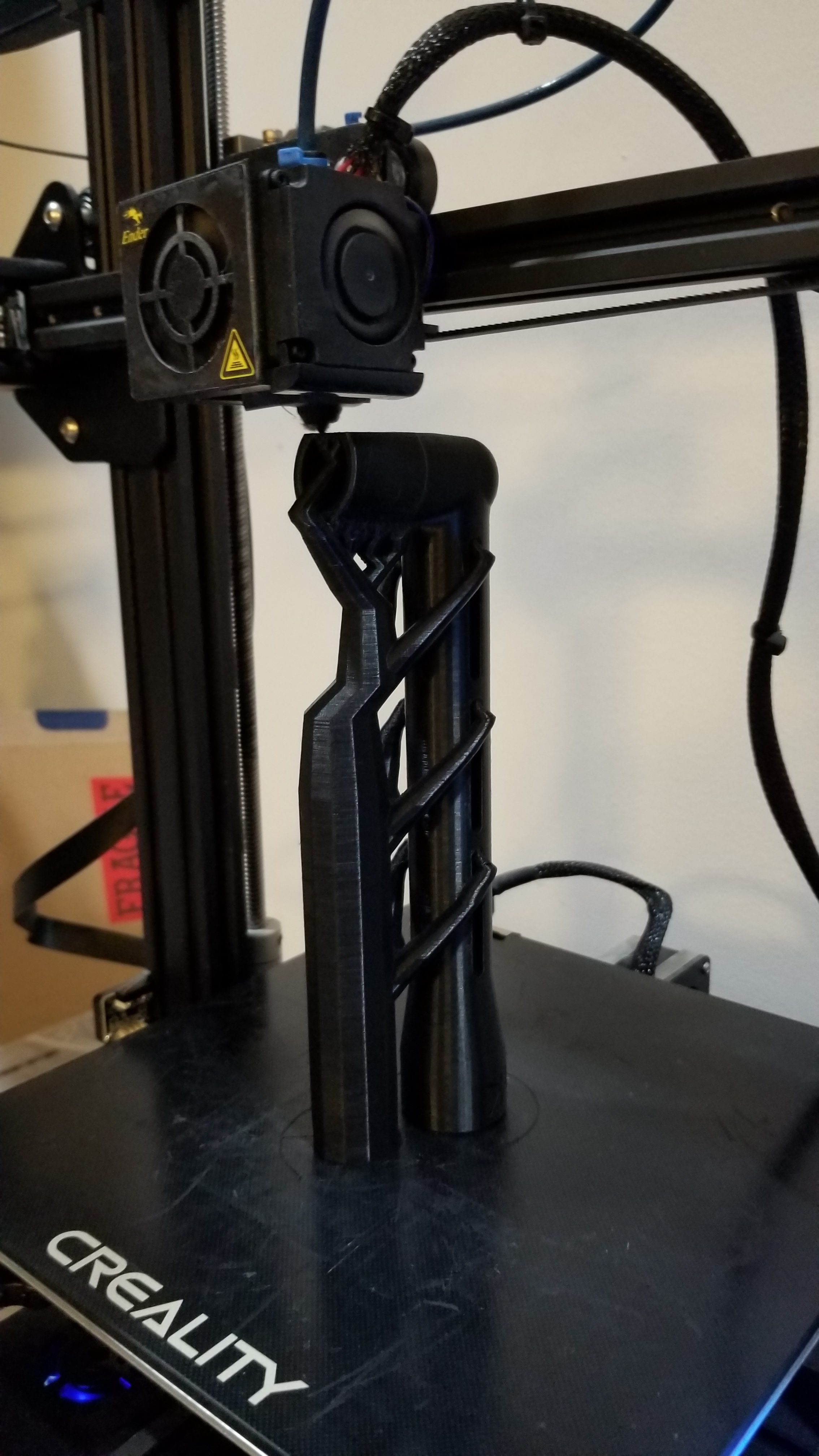

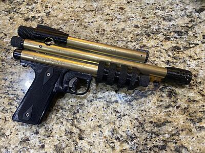

    I printed the updated version of my Automag horizontal foregrip. By the way, Thingiverse didn't update with the correct file last time, so be sure to download the latest version if you want it. The model up now is the correct one. This version has absolutely no side to side or up and down play. Tolerances are right on the money.

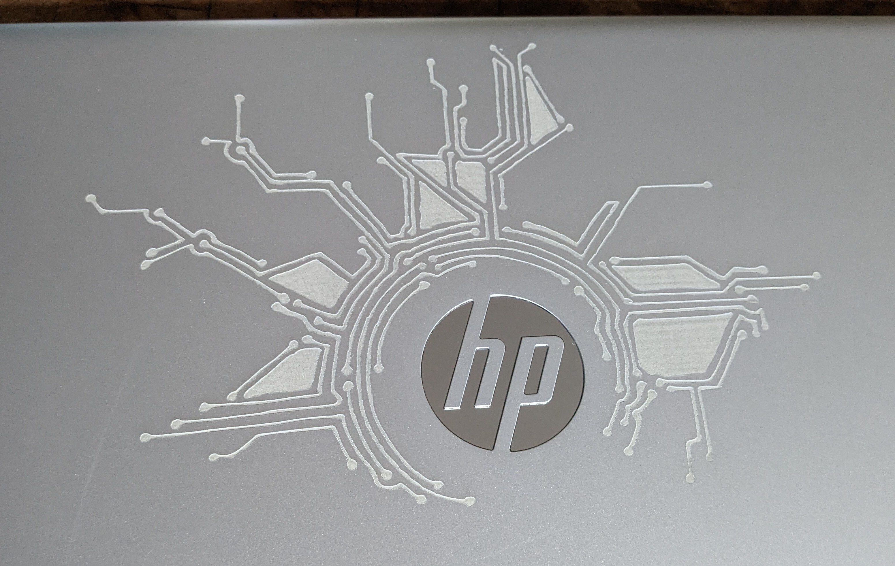

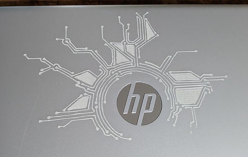

      Not 3D printed nor paintball related, but close enough ... Got the top of my laptop in the laser 😁

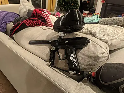

          3d printed 8" freak barrel paired with the mini rotor and 3d printed blade trigger on the mech ion conversion!!! Came out amazing. I am debating making the hoppers in small batches for sale if anyone may be interested.
          • ChillswitchEngage
            ChillswitchEngage commented
            @Alexndl
            Most certainly! These shell settings are probably overkill (Or not enough? Always open to feedback). Used with Prusa Slicer.
            Infill - 100%, rectilinear
            Supports: Yes. organic
            ==Layers/Perimeters==
            Layer Height - 0.22mm
            First Layer - 0.26mm
            Vertical Shell Perimeters: 10
            Horizontal Shell Solid Layer Top/Bottom: 10
            Minimum Shell Thickness Top/Bottom: 1mm
            Seam Positioned: Aligned (optional but makes nicer looking prints imo)
            Fill Gaps: Checked
            The upper and lower get printed upright as normal with supports. The feedneck gets flipped on its base and needs no supports. The button orientation can be left as is as well and needs no supports (I'd recommend .2mm layer height though). Clear filament is perfect for the button, lets me see the blue light nice and bright still.

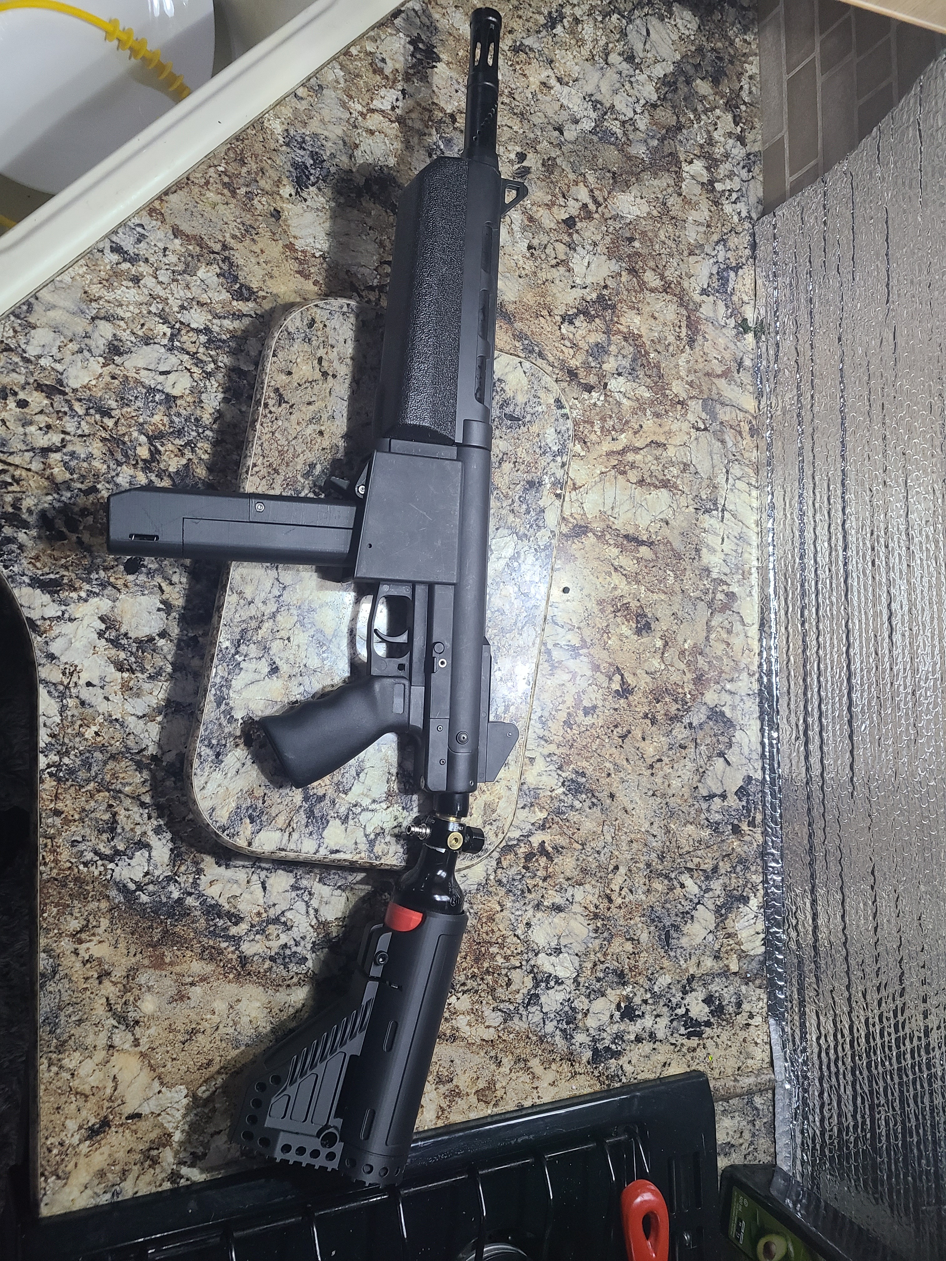

          Finishing up a Mozak 10rnd stick feed.
          Velcor will save us...
            BrickHaus commented
            Damn you printed on end? I need to re try mine

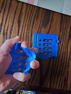

          One of the guys i play with asked me to print some jt ears for him that he'd seen. I only had blue tpu left but he likes them and wants more so i ordered more filament.

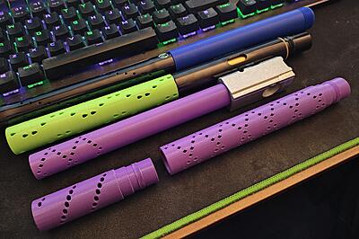

          Barrels, barrels, and more barrels. Started by wanting a short freak tip to match with a brass eagle avenger II I've been modding but the best file I could find didn't have the right threads so I made my own. Many hours in fusion 360 and many more on the printer has cascaded into a couple patterns for tips, freak tipx barrels for myself and a friend, and a vm68 threaded back that ushered me here. All printed in inland PLA+ on a Prusa mk3s+.
          • ChillswitchEngage
            Those are kick-ass! I wanted to try a 2 piece print but I read from paintballdna on a Reddit post about making 3D-printed barrels something about tolerances so they abandoned it. Glad it came out well for you!
          • Part-time Tech
            Part-time Tech commented
            Tolerances certainly were difficult, can't use any of the pre-designated thread tools in fusion because they don't give enough clearance. These thread together perfectly, all that's left is to fine tune the printer settings to get a better surface finish
          • Spider!
            Spider! commented
            Besides the normal print calibrations and extrusion rates, my seams cause trouble as well on threads. On those coarse Tippmann threads, I used a Dremel disc to run on the root and both sides of the thread. That made the fit work.

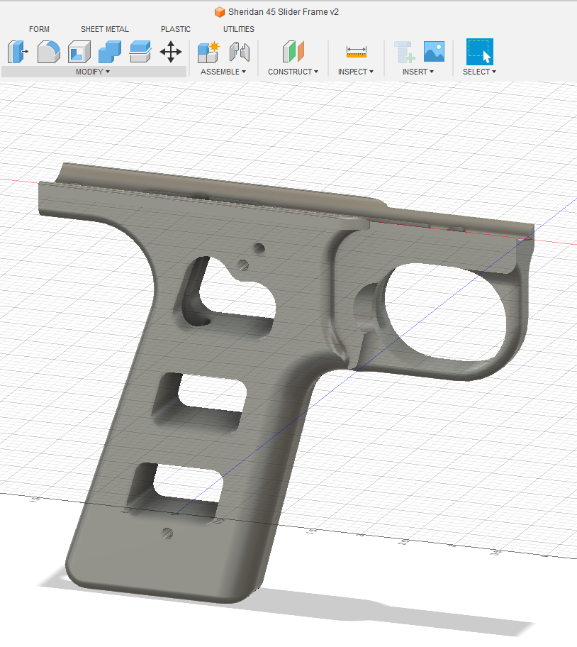

          It hasn't hit the printer yet, but here's a preview of a little something I've been working on.
          My Feedback Thread
          • RAZRBAKK
            RAZRBAKK commented
            Wow, that is sweet. I'd love to see a variant that takes the AR style grips as well. Looking forward to seeing how yours comes out.
        • SETHZILLA!
          Apocalypse Dude
          • 849
          • Atascadero,CA
          #356
          Do i spy a round top frame for Sheridans? JonM
          Feedback:
          WTB:
          • JonM
            JonM commented
            Indeed you do. Based on a Benchmark slider no less.

          Are those the ones from Thingiverse?

            Yes, my buddy thinks they're a little too thin. Next ones i print I'll probably make them thicker.

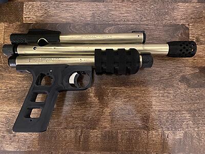

          I printed out my first prototype frame today. It’s close, but there are some tolerances that need adjusting. I had to mill out the slot wider using my drill press to even get the trigger to slide freely. I also discovered that if I screw in the rear frame screw that the hammer can’t catch the sear. Those issues aside, I think it turned out great. A few more tweaks and I should be able to release the STL to the world.

            I printed out a second version of the frame today. Unfortunately it was a case of two steps forward, two steps back. However, I at least learned a few lessons that made me rethink my first print and make it work. It took an o-ring sandwiched between the rear frame screw and the body, but it works. I’m still not completely satisfied with it in its current state, so the STL will have to wait. At least it’s working and playable as it is now.
