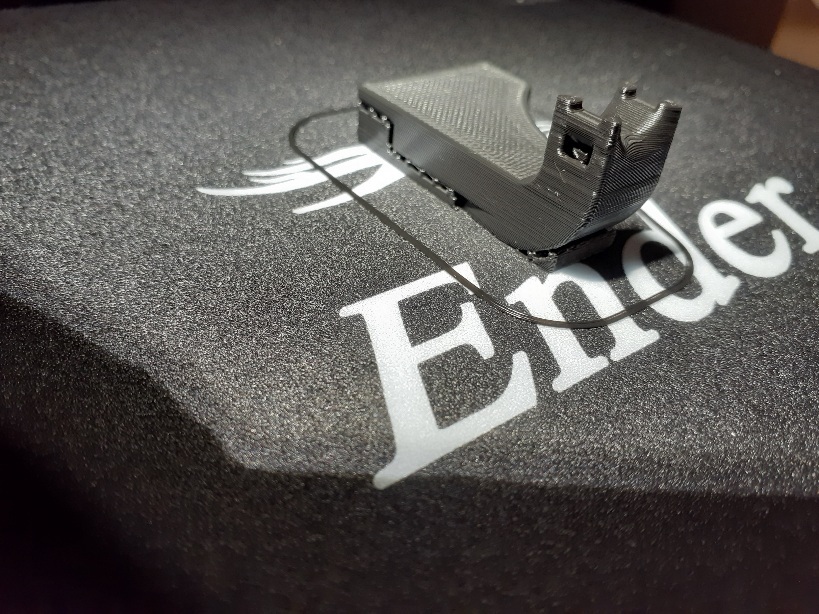

            Update
            Tried a new roll of PLA+ on the glass bed with no change in adhesion
            flipped the bed upside down, was better but failed mid print
            Ditched the glass bed...
            the previous owner was not good wirt setup and the original magnetic bed was damaged at several point from collision with the nozzle... sanded the high spot (yep it was THAT bad), did the levelling the best that I could and...
            Printed two parts with no issue...

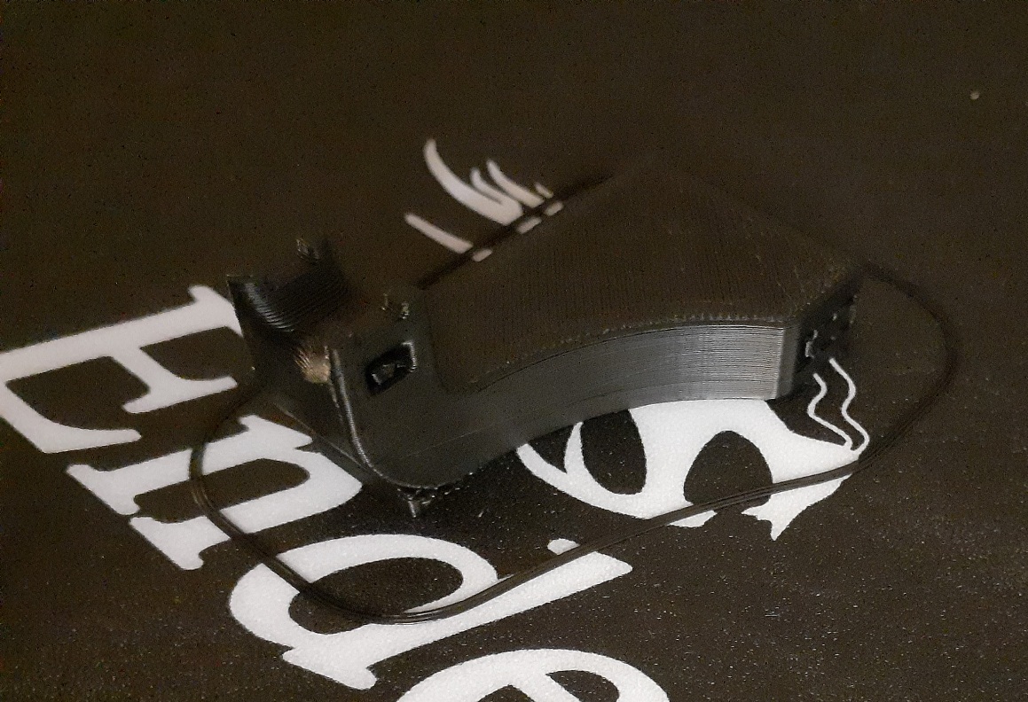

            Here is the strain relief I made for the heated cable
            PLA+ 220C nozzle 60C stock parameter for speed and else
            Click image for larger version  Name:	20220110_001513.jpg Views:	0 Size:	350.4 KB ID:	215320 Click image for larger version  Name:	20220110_001609.jpg Views:	0 Size:	214.3 KB ID:	215321
            Tonight I am trying the Rainmaker reverse feed setup for my spyder pistol
            Rainmaker, do you used support for it printing standing up? (Not sure it need a lot)
            • Rainmaker
              Rainmaker commented
              Sweet!! Glad you got some prints to finally stick!
              As far as the reverse feed, you shouldn't need any supports. Just print it with the feed tube side on the bed, and make sure your first layer looks good
