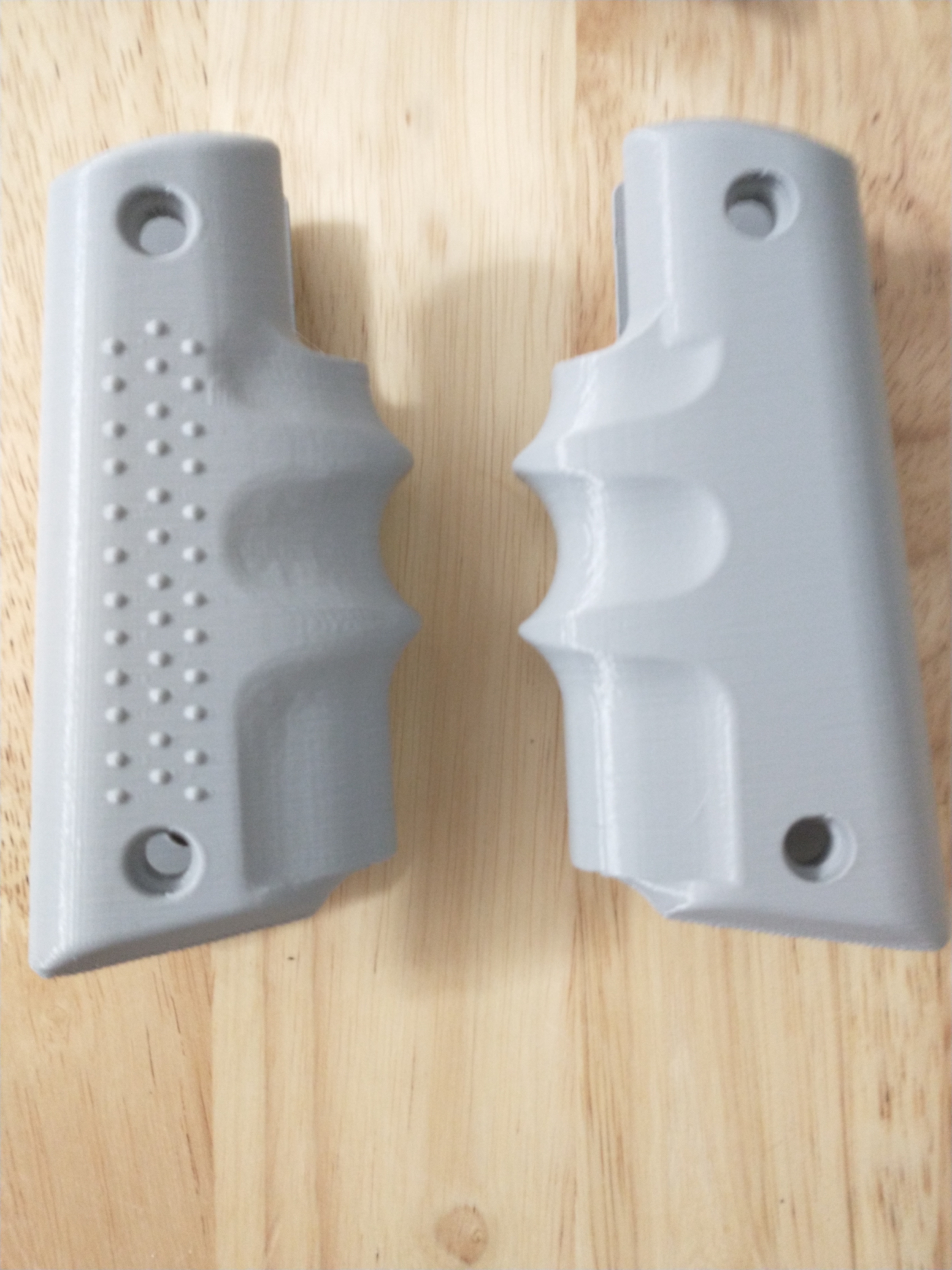

          Let's see if my phone can get through this. The top and bottom corner-edges on the right are treated with some of those tiny fillets. The finger groves are treated with tiny fillets as well. The grip on the left was run through Blender and sculpted as little and as clean as I could do it.
          The fillets on the right were as large as I could get them (with three decimals that is).
          Click image for larger version  Name:	IMG_20220222_131938578.jpg Views:	0 Size:	2.08 MB ID:	235305

            Your issue might also be the fillets converging at the front of the finger ribs, in which case I'd recommend you cut those off in the surface tab, fillet your edges and use the patch tool to bring them back. If you'd be willing to provide a source file I'd be happy to demostrate.
              Yeah, those are a problem also. I'll do the surface thing. I've watched the video before and I will learn better by doing it myself, even if it takes several tries. I need to learn it. I can't plan every fillet.
              I didn't think of using the fillet tool in the surfacing tab. Thanks!
