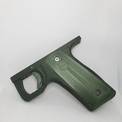

    Hey! First time back since the big reset. Releasing the files for this has had people telling me to get on here and how cool the MCarterBrown printing community is. So whatsup cool cats (and dogs)?!

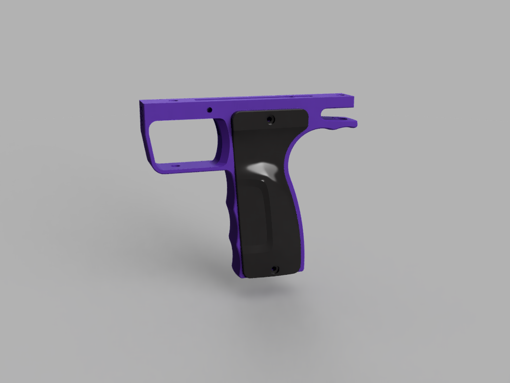

    I made this 3d printed pump hinge frame!
    link to the frame:
    https://www.prusaprinters.org/prints...hinge-frame-g5
    I mixxed up Andy's from zdspb.com benchmark frame file and an automag frame file a friend had commissioned. Optimized for fdm printing, takes inserts and screws and thingys, and yea. Lot of different parts need consideration to make em work better for this tech. Tried to break it all down a bit on the prusaprinters listing. Hoping to make some more youtube videos and stuff, and how to guides as well.
    Would love to get into it more here and get your feedback, etc.
    I designed a trigger for it too but I think the trigger could use more work to be more durable. I just ordered a bunch of the triggers in mjf nylon 12 so will see if that's cool.
    I'm selling the parts kits for these on my website (muddybloody.com) to help raise some funds for a high temp corexy build. If I can raise the $ for one I will release the full bill of materials (BOM) on the parts. Screws and inserts and stuff. Currently the files are under creative commons attribution license, so I'm not trying to hold out too much on ya, and yea eager to share the BOM too, but felt this was best route for now.
    Once this is doing good enough out there in the wild, I will finish up my slide frame version.
    Check it out! Let me know what you think! Feels good to be back on a forum platform

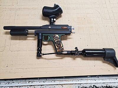

    Pictured is SETHZILLA! 's build with a prototype of the frame

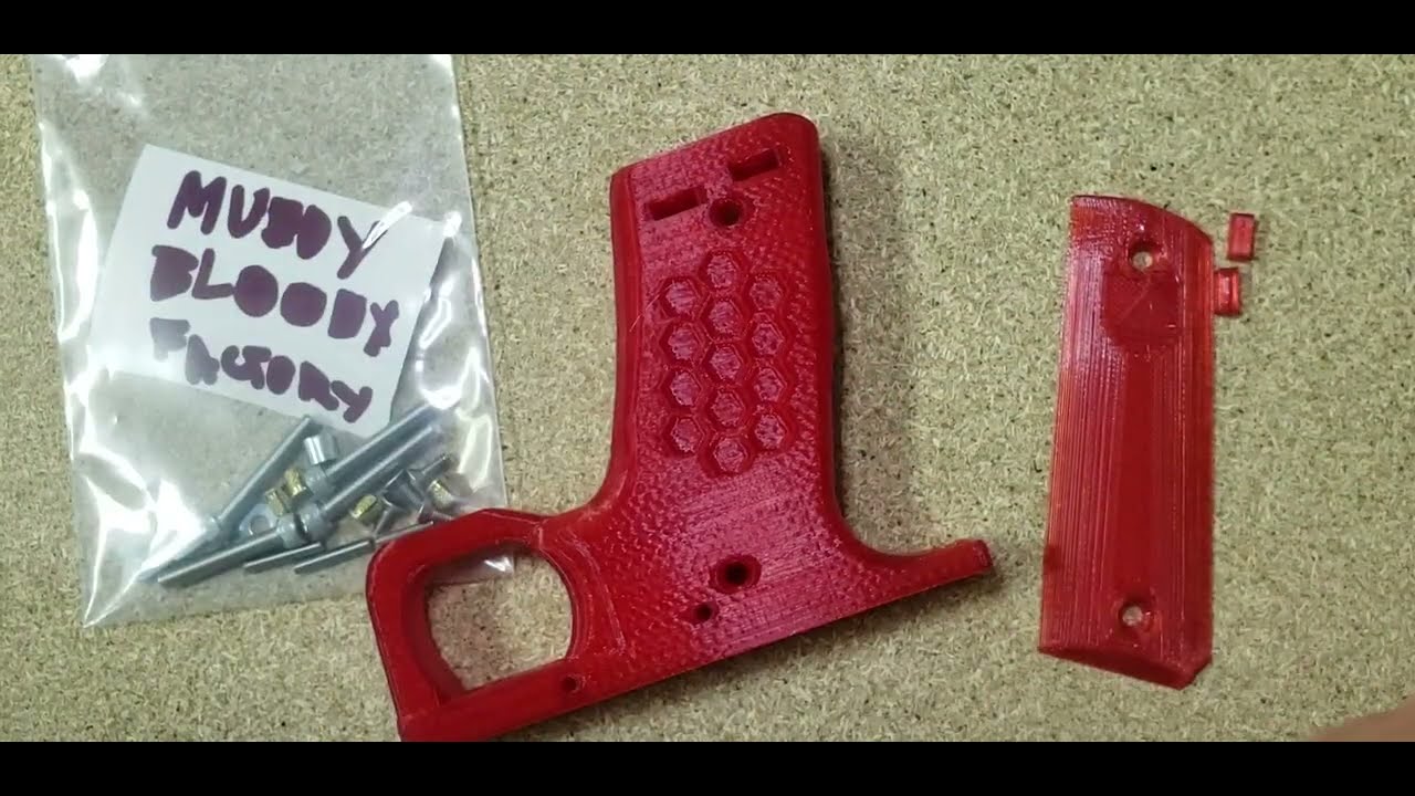

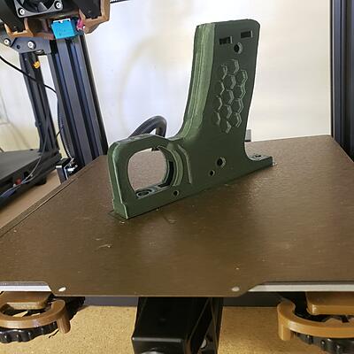

          Looks like people are starting to get their parts kits in. Going to have to make some how to assemble videos. Just did this hump back finger groove remix. Haven't published or printed one yet. Seems I left the safety hole in too lol. Not sure if any brave souls want to start experimenting with autotrigger.

          Just put this set up video together! Now on to some remixes!

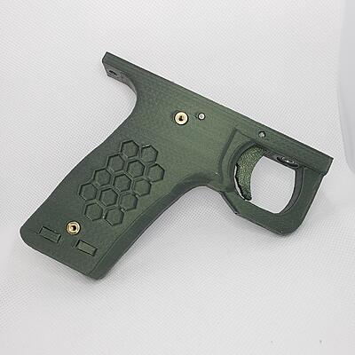

            Just added a bunch of variations to the prusaprinters listing! 2 style of finger grooves (or no grooves) with 3 style of backs and no grip screw options! 15 different remixxes in total.

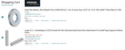

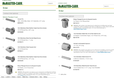

                Here's a quick run of the BOM.
                Will try to edit this comment with links/part #'s
                -You need 2 of the bigger dowel pins, one for the trigger, and one for sear.
                -One of each length button head screws, Long one for the front of the frame, short one for the rear, for connecting to the body.
                -The unthreaded spacer and washer are also for connecting to the body.
                -Two 2.5x14mm pins for securing the ASA nuts so they cant strip the plastic or get funny on ya
                -Two square nuts for the ASA mounting
                -Optional length of the Socket head screw, long or shorter depending on your ASA
                -Four brass expanding inserts for mounting your grips
                -4 countersunk hex screws for mounting grips
                *the small 2.5x14mm dowel pins are listed with both mcmaster and amazon links.
                *You can probably source alot of this hardware from either mcmaster or amazon. The spacers and expanding inserts probably the hardest to find. I will try to publish the tinkercad files sometime soon so you can edit these things to your own spec.
                *Buying all this stuff gets expensive since you can't just buy one at a time. I might offer kits again in the future, if someone else wants to, be my guest. Just give me credit! I'm now using alot of the hardware on other projects, so hopefully it doesn't go to waste! Ahh
