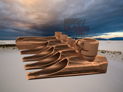

    Modified stock body stl file from GOG for the eNMEy, for you to 3d print and edit! Optimized for easy FDM 3d printing and looking good, with editable tinkercad link.
    The feedneck uses stock emek feedneck levers (with a longer bolt). Regular Enmey feedneck versions included as well. I have not tried all the bodies in the link my self, only the emek feedneck lever version.
    I suspect they would be better if thicker and more durable. Since it's on tinkercad, thicken em up your selves if you want to! Also some of my remixxes in there might be kind of thiccc.
    In an effort to figure out how to release more files and tinkercad links, I started a patreon (called HomeGrown3D @ patreon.com/HomeGrown3D), and am moving away from print farming/retail so I can focus on design. This was one of the first requests from patrons. Don't worry no paywall for these! When possible, I am trying to keep my paintball stuff under a copyleft/share alike commercial license, with a focus on sharing editable tinkercad links. I also may do a few limited releases to spark more interest, so stay on the look out! 😎
    Get at em straight at the source, check out the description in the link for some printing information, and see my weird unrefined work flow and everything (yikes😬):
    https://www.tinkercad.com/things/kX1dIzt0jF2
    Enjoy and let me know how they go! This just the start. I look forward to see everyone's prints and remixes!

        I like the design, especially the "half block" version
        How do you print those? Nose down with surrport for the feed?
        • ChoSanJuan
          ChoSanJuan commented
          I printed completely vertical, but if you are worried about axial sheering forces, I'd kick it maybe 15* with the underside dealing with the supports/overhang. The worst part would be the feedneck, but since it's the feedneck clamping against the layer lines, it should be fine. The 15* kick should give you non axial gripping forces, but I'd skip it TBH.
        • MuddyBloodyFactory
          MuddyBloodyFactory commented
          Sorry for my slow reply. What ChoSanJuan said. I set these up just for vertical, nose down. Supports only needed for the feedneck. You could also print it at an incline for more strength but I decided against it for this design.

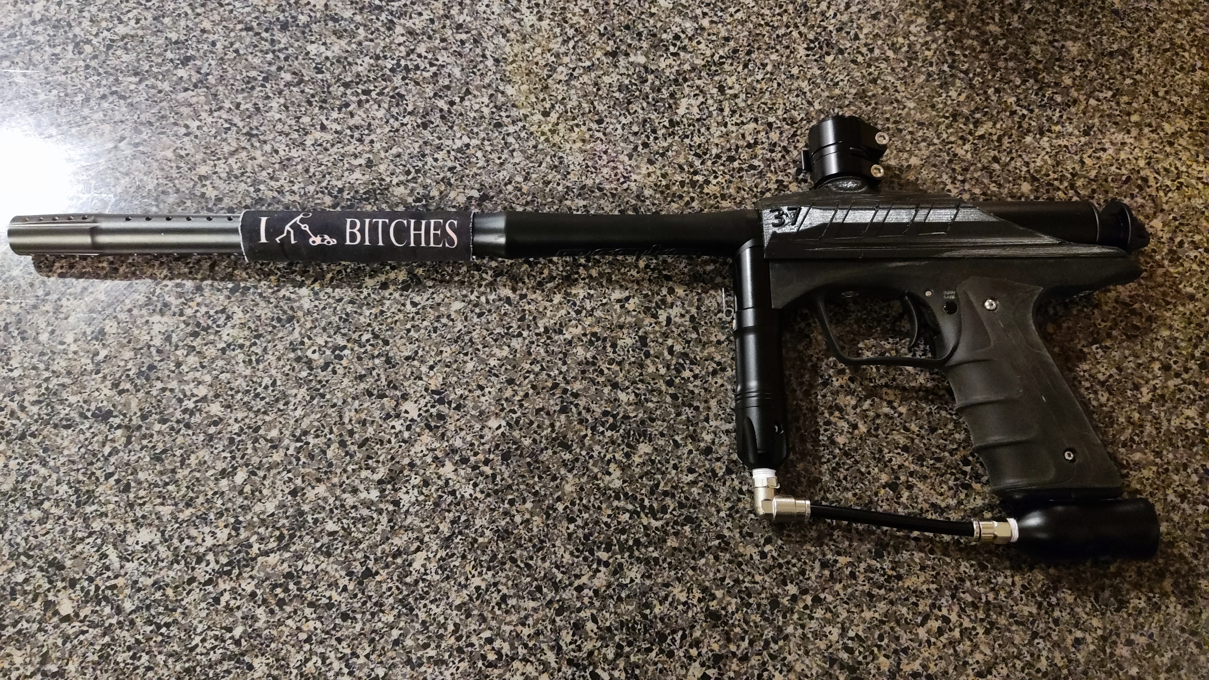

        Good stuff! Got it on last night after getting home from work. I added my jersey number to the front. I'll probably do more like add some vinyl to the little windows and color my numbers. I'll post that later. Future reprint will be done on my when I get my resin printer up and running/unpacked from storage from moving.
        GOOD WORK!

        How well did the fdm-printed body hold up? I’ve got an eNMEy coming in the mail and am already looking to upgrade the feed neck at the very least. Will a standard EGO 07+ feed neck fit on these bodies?
