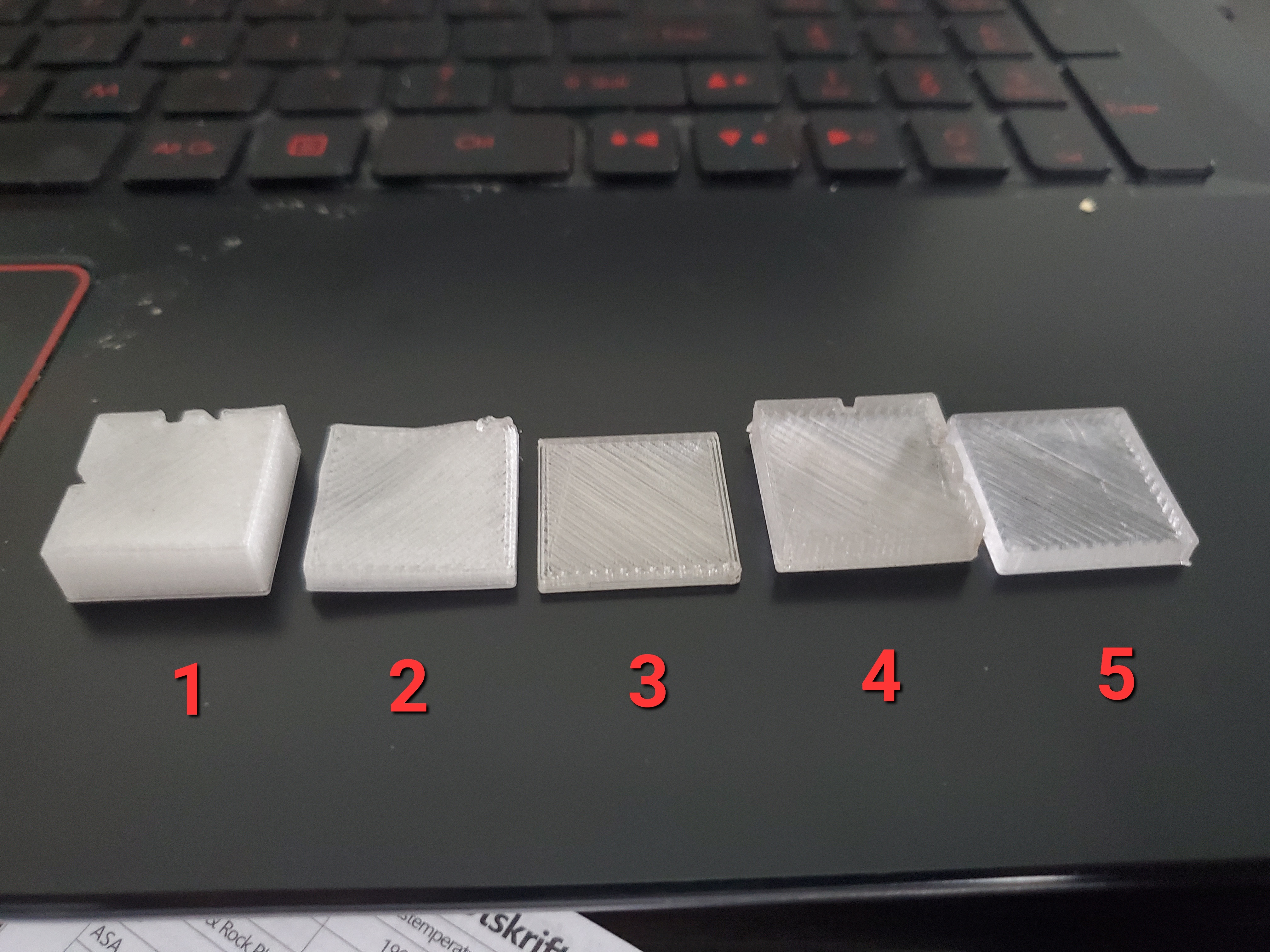

    I've been wanting to try this for awhile, and just haven't taken the leap yet. We'll, the other day, I realized I had a gift card balance on my Amazon account, so I figured why not, and I bought some Overture Clear PETG. Let's try to make something clear!!
    Now, I know it would be better to just spring for a resin printer and print in clear resin, but I'm just not set up to handle post processing the resin prints. So I'm just using what I've got. The good old Anycubic i3 Mega.
    I started with a guide I found online, which gave a few recommended settings. These settings are mostly focused on increasing Temps, and mooshing your print lines together as much as possible so that you have absolutely no gaps. So basically: High temp, low speed, high extrusion multiplier, high line overlap, etc. The other key factor is print line orientation. You want to have a much of your print lines laid in the same orientation as possible, so I set my top and bottom layers to zero, and set my infill to print only in one orientation instead of alternating. https://www.printables.com/model/153...to-print-glass
    Here are the main settings I STARTED with:
    - Extrusion multiplier: 1.01
    - Extrusion width: 0.5mm
    - Layer height: 0.1mm
    - Top solid layers: 0
    - Bottom solid layers: 0
    - Perimeters: 2
    - Infill: 100%
    - Infill overlap: 15%
    - Infill extrusion width: 103%
    - Infill angle: 45°, not alternating
    - Temps: 265C nozzle, 70C bed
    - Cooling: None!!
    - Print speed: 20mm/s

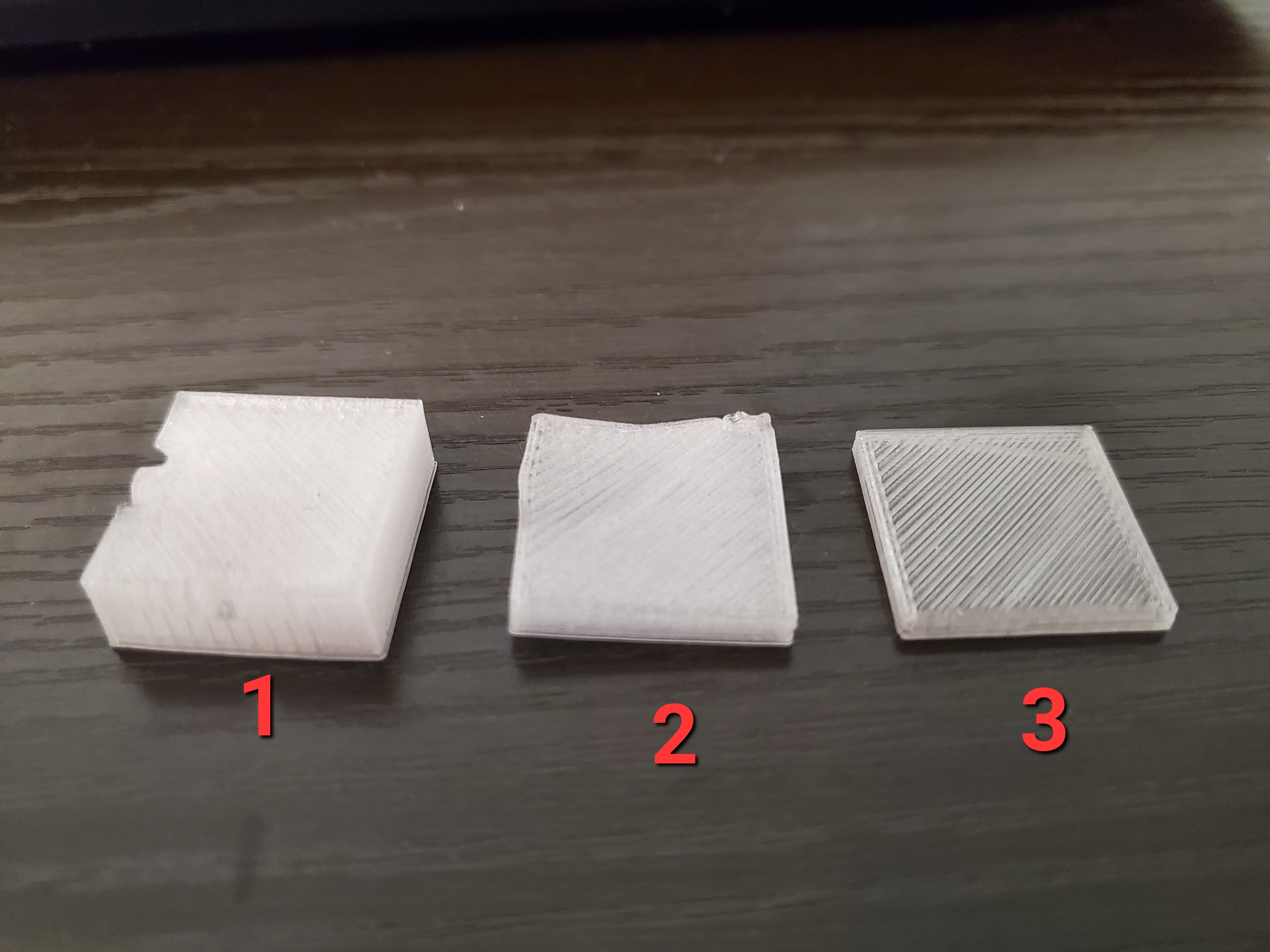

    I sliced up a calibration cube and hit PRINT!
    Aaaaannd.... it was cloudy. Well, I kinda expected that on the first try, so let's tweak something.
    2nd try:
    Settings changed:
    - Infill overlap: 35%
    - All other settings unchanged
    Result: still cloudy, not much change

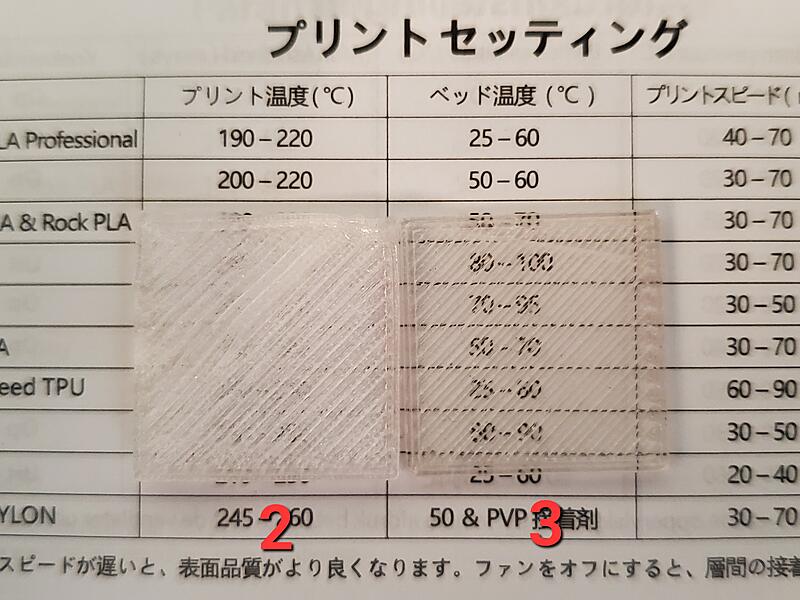

    Next I tried just throwing the filament in the dehydrator for about 4 hours. I wasn't noticing any popping or bubbling in the print, but even a little moisture can have a big effect on print quality, so better to rule that out.
    3rd try:
    Settings changed:
    - Filament dehydrated for 4 hrs
    Result: significantly less cloudy, but gaps between print lines are much more apparent
  • Rainmaker
    Der Printermeister
    • 1585
    • Cincinnati

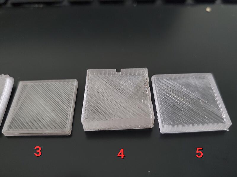

    Next I wanted to try to reduce the gaps, and really moosh the print lines together, especially in the first layer, so I adjusted first layer flow and width, and decreased the number of perimeters to 1.
    4th try:
    Settings changed:
    - Perimeters: 1
    - First layer flow: 103% (up from 100%)
    - First layer width: 101% (up from 98%)
    Result: first layer appeared somewhat more solid, with less gap between print lines, but overall clarity relatively unchanged.
    Those settings seemed to really help the first layer, so let's apply something similar to the overall settings.

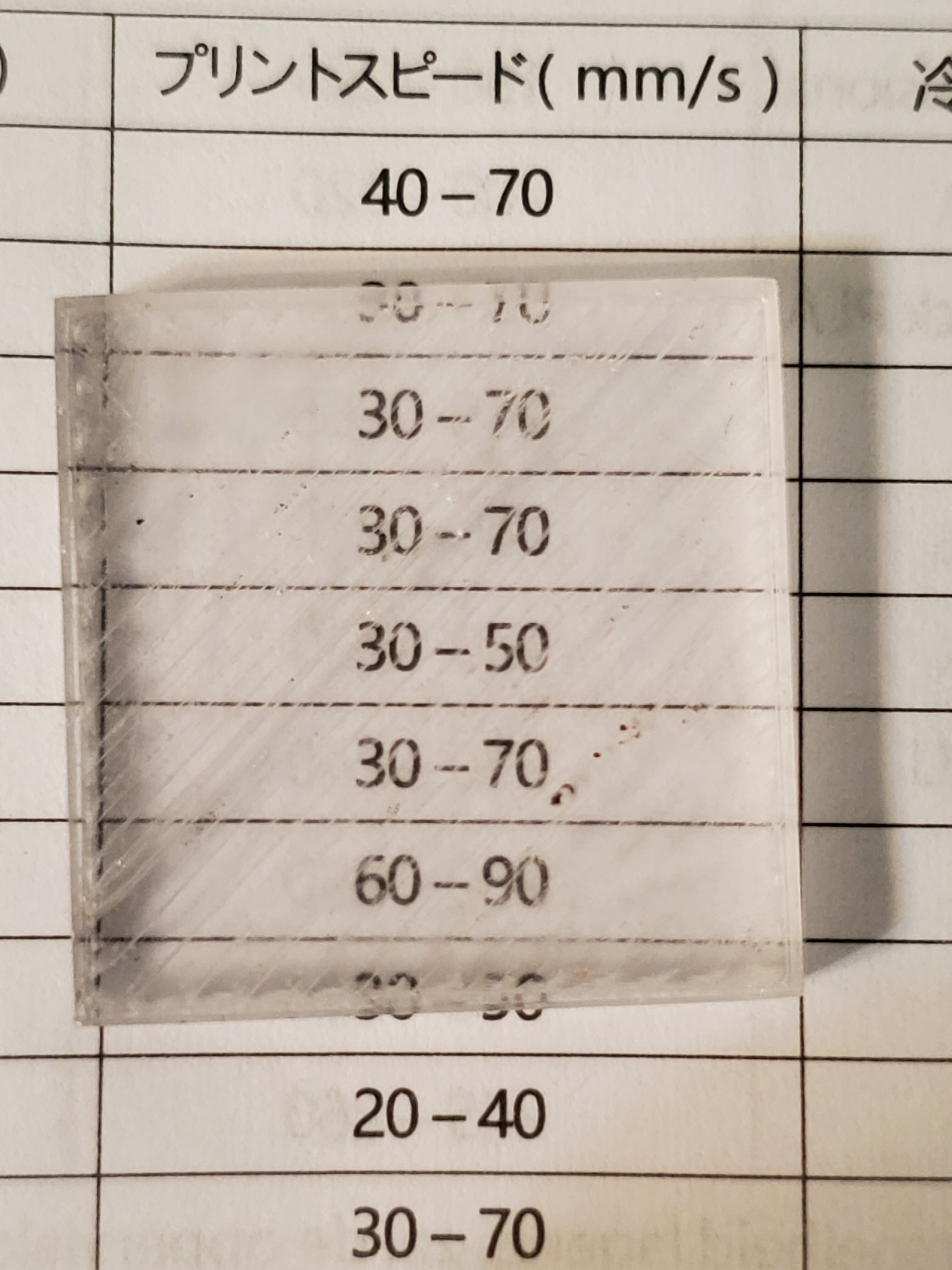

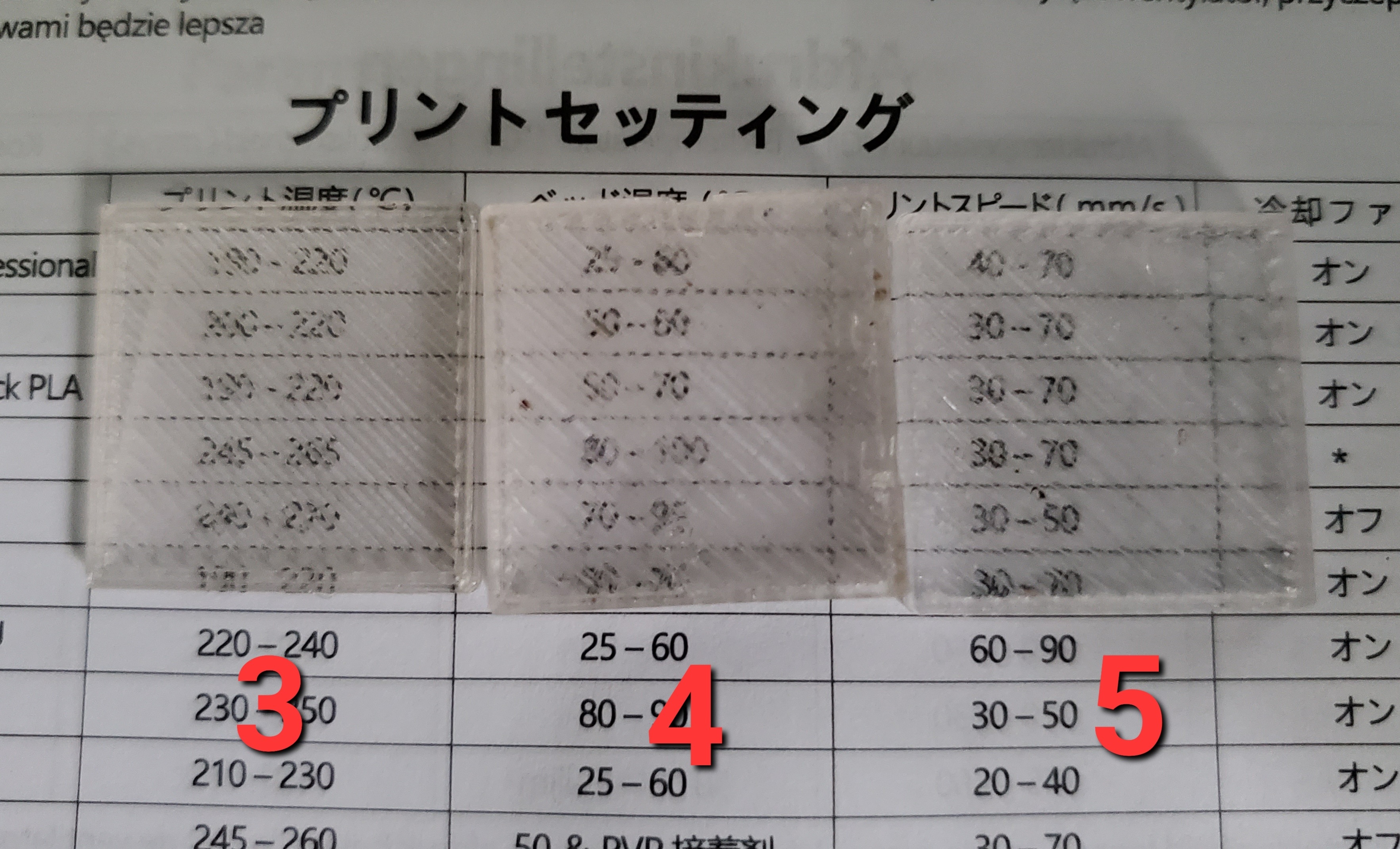

    5th try:
    Settings changed:
    - Increase (overall) flow: 105%
    - Decrease speed: 15mm/s
    Result: improvement in clarity, gaps between print lines much less apparent.
    Now we're talking. The print lines are really mooshing together well now, and the print is see-through for about a 1/4" thick solid section. And this is with no sanding or polishing.

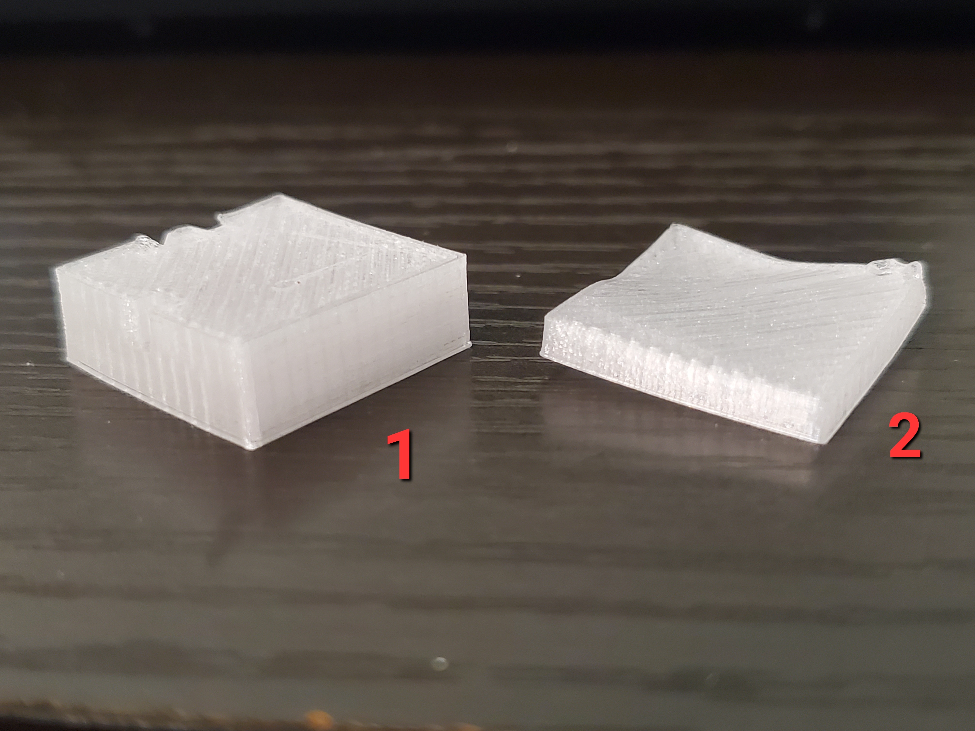

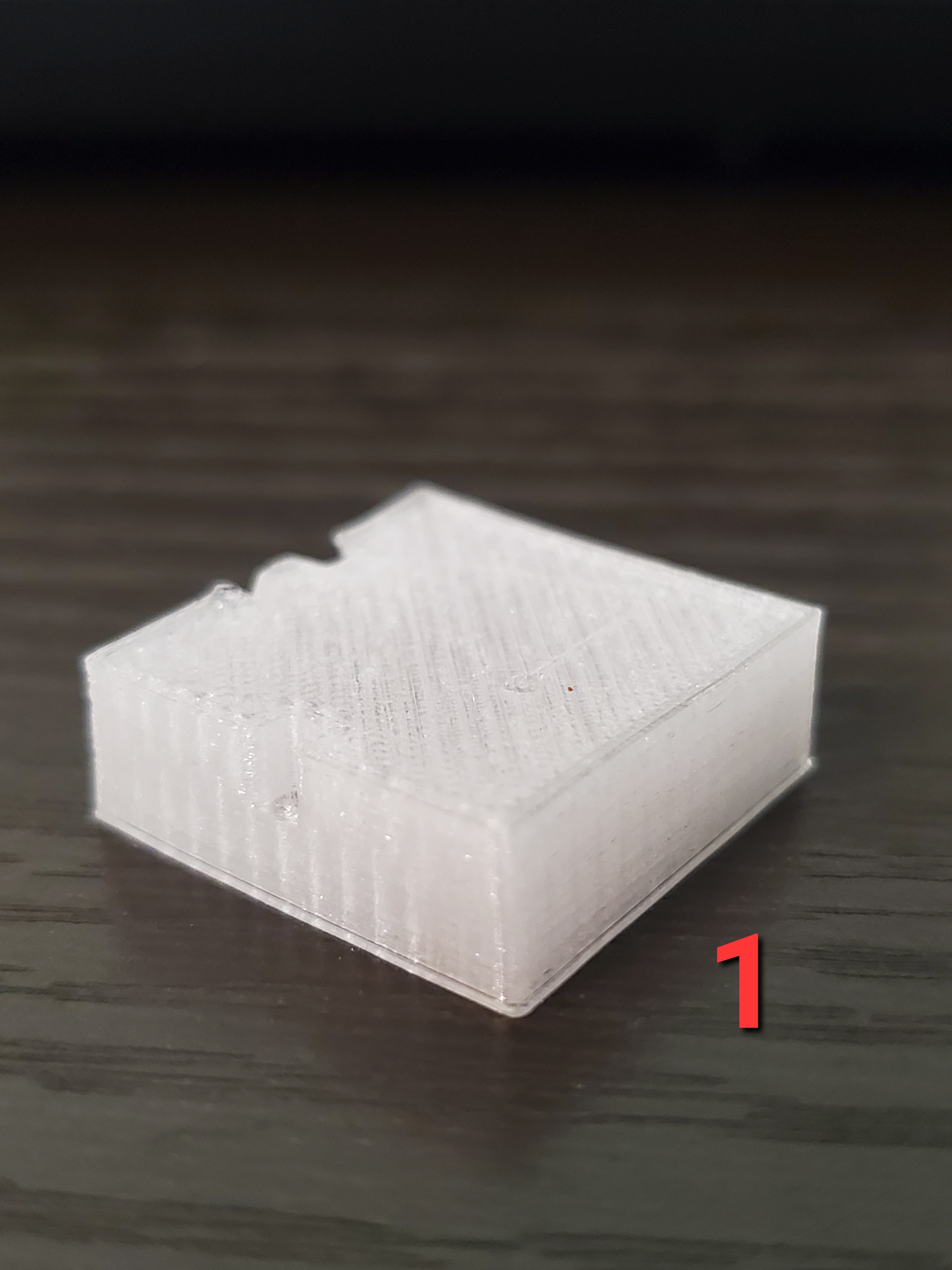

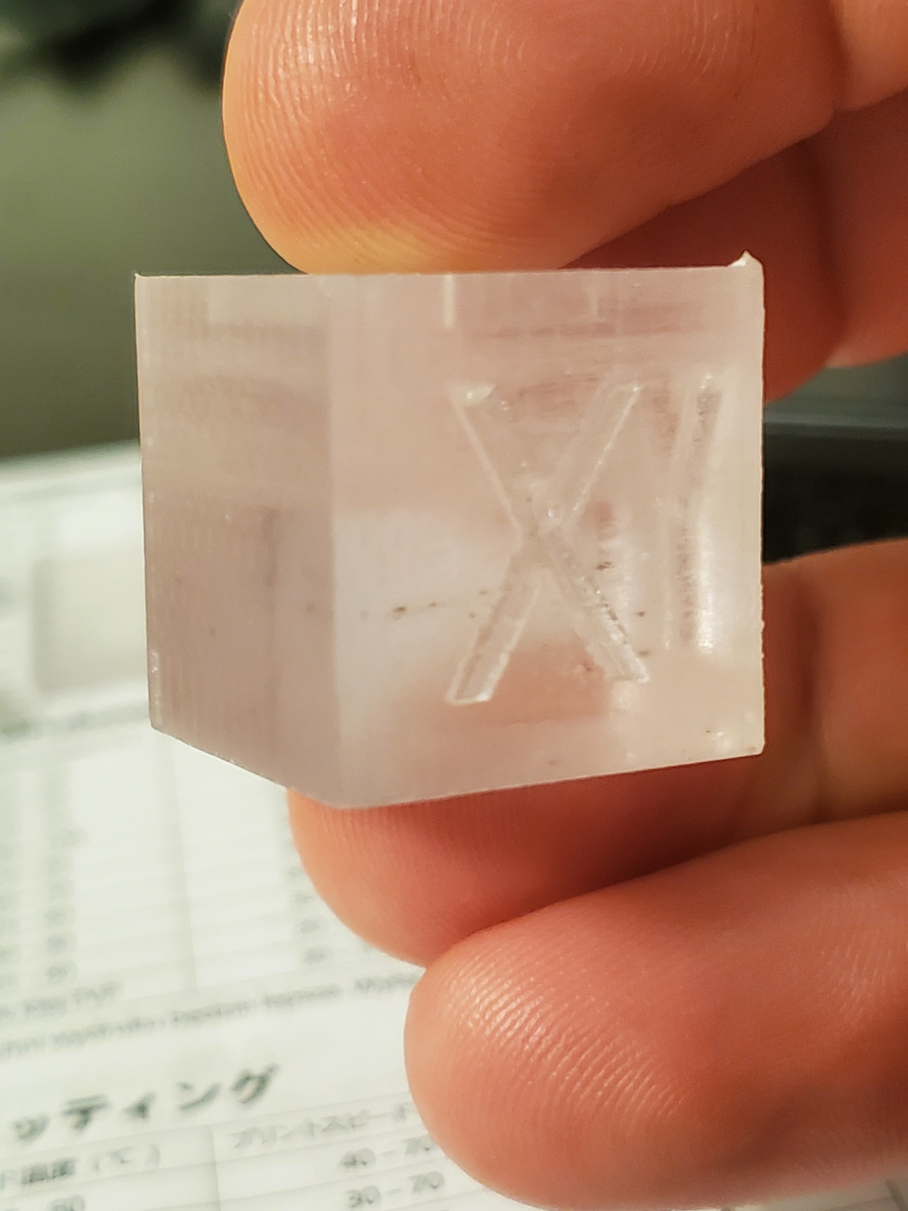

      I decided to go ahead and let the whole calibration cube finish:
      And also tried a little sanding on the #5 test print. I got it down to 2000 grit, but I can't find my polishing compound, so I'll have to try polishing another day. But i got some great clarity with the 2000 grit sandpaper!
