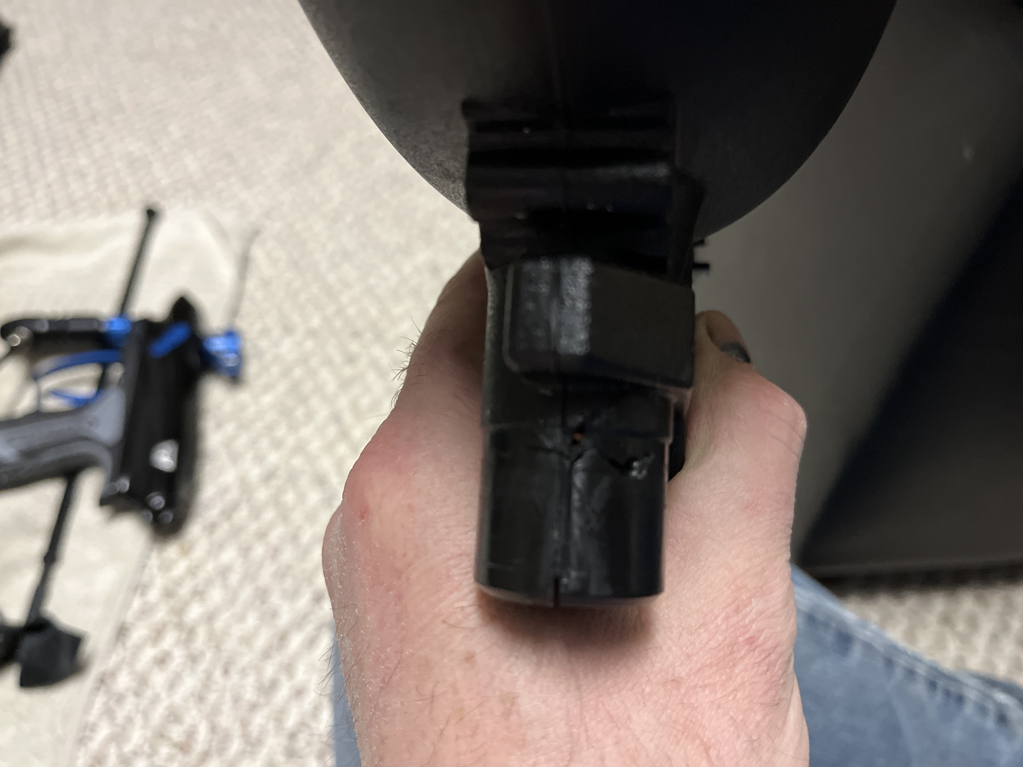

    Anyone know of a 9v revvy body that can be printed? Just noticed my feed neck is cracked. I’d hate to see this get junked - the board an everything else work fine.

              I fixed one of my 9 VDC Revvys that cracked at the neck by welding the crack with a solder iron and some tie wraps as some fill rod (inside and out). Make sure you do a good mixing of the base material and the tie wrap. Then I used some fiber reinforced 2 part epoxy to overbuild up the whole neck area and once that was cured I filed and sanded back into shape. I did this years ago and it is still holding up. I love 9 VDC Revvys on open class pumps especially for big games just the right size to not have to carry any or a lot of paint on the field and agitate just enough for maintaining a nice stack for feeding.
