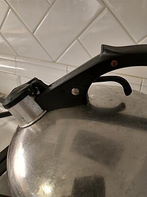

    This print was a trigger for my parents' kettle, where the original broke apart. The print came out pretty accurate, considering I followed a photo of the parts with polylines in Fusion360. The problem was that the PETG and PLA+CF prints would go soft and deform. It isn't boiling hot since you pull it with your finger, but apparently over 60C.

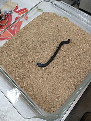

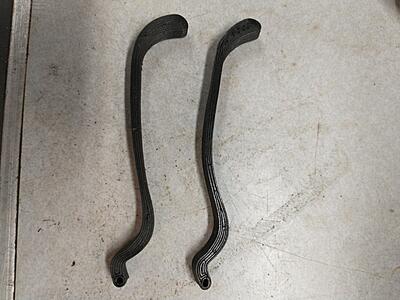

    I had a pyrex dish that my wife donated and some sand on hand, so while she was out I put a new PLA+CF print in the oven at 175F for an hour. The oven had been preheated for 1/2 hour before but still wasn't up to 160F on a separate oven thermometer. When it finished, it was at 175F. I let it cool on the stovetop for about an hour; I could see no significant deformation. Since fitting it on the kettle, it has been used several times with no softening or warping. Below is a pic of a new print and a used/warped print.

      Update. So while annealing made the part withstand the heat of the kettle more, it has started to soften again after extended use.
      I suspect that annealing aligns the plastic to the new shape, the actual glass temperature is still the same. Repeated exposure to that temp under stress breaks up the structure, so that the part will flex more easily each time.
      I will test this by putting the trigger back through the annealing process...
