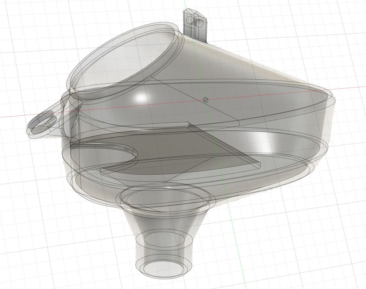

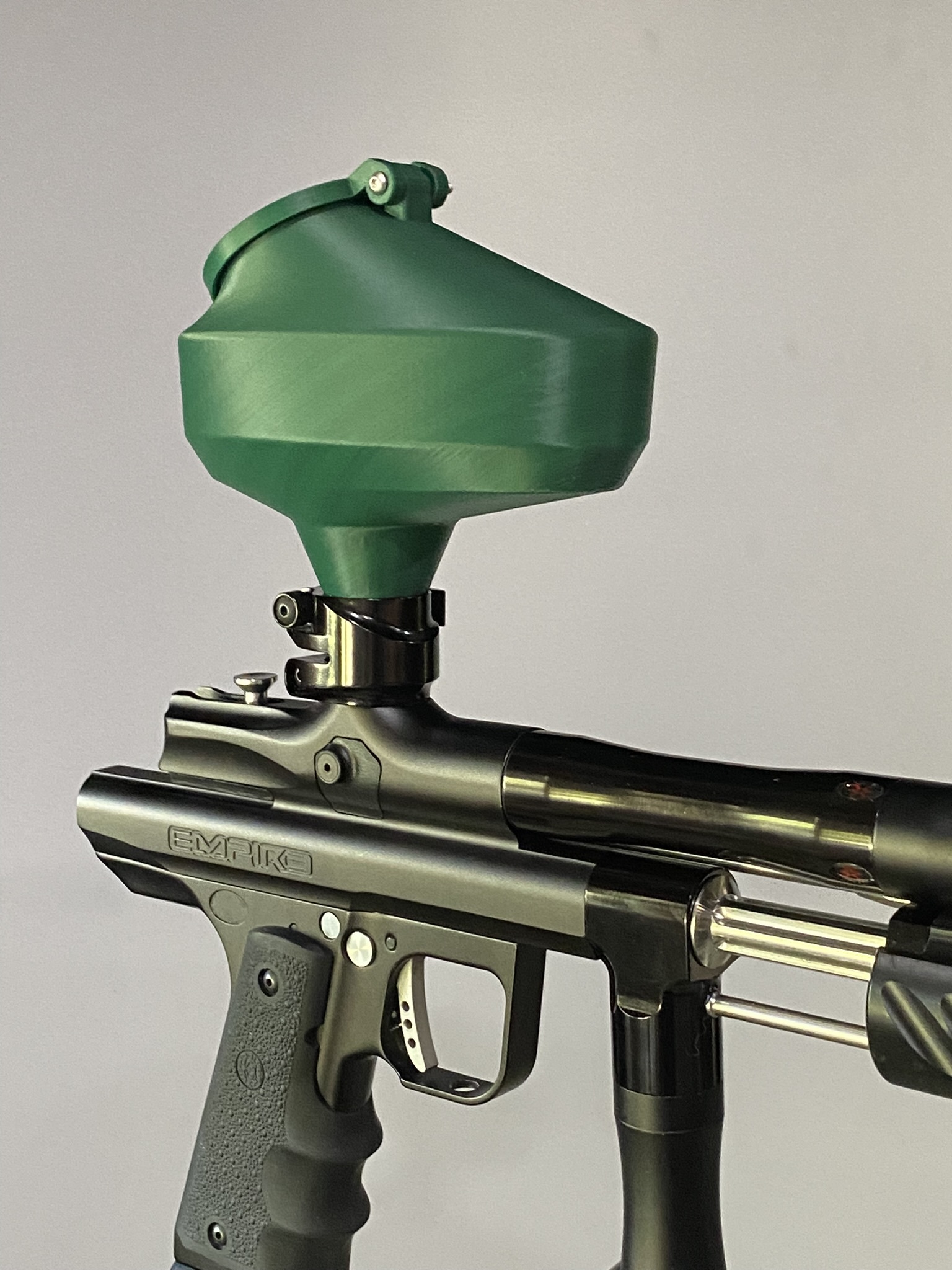

I designed a 3D printed hopper that holds 70-80 rounds. Here are the STL's: https://www.thingiverse.com/thing:6140554
The assembly needs some M3 hardware and a couple 12mm diameter magnets. I tried creating a version that has a shelf over the feed similar to the Dye Primo or Empire splitter gravity loaders. It feeds reasonably well but could probably use a better design. I'd love some suggestions to make a V2 at some point.

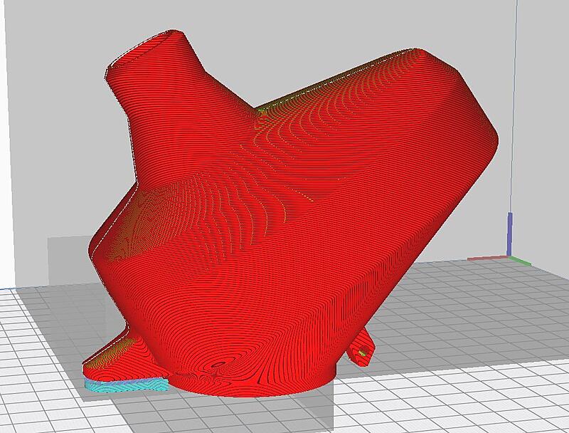

Printing-wise, the design is mostly printable without supports when the mouth is connected to the buildplate. The only element that will need to be supported is the magnet area. The lid is flat and doesn't need supports.
