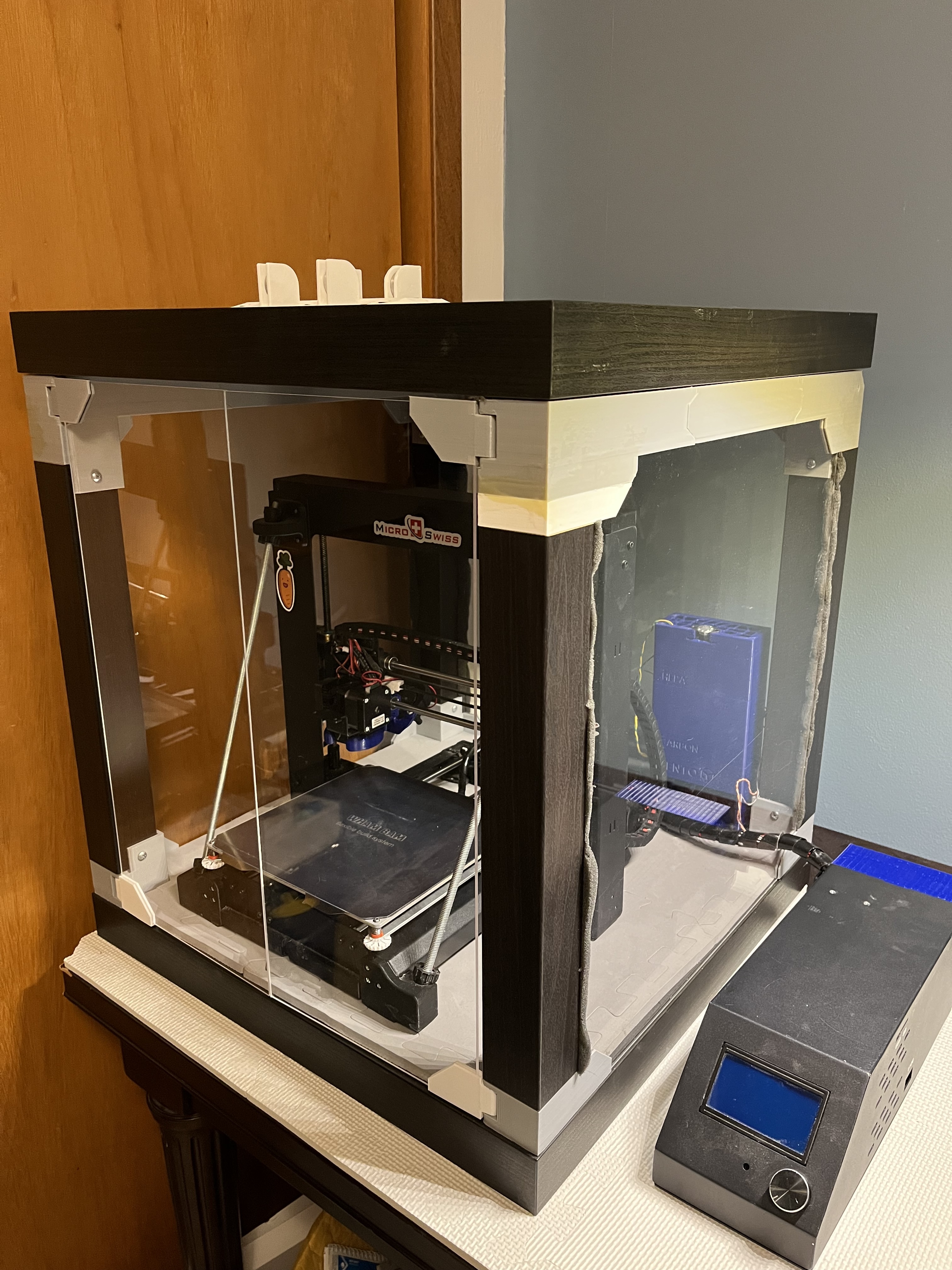

    8. Prusa Lack v2 Enclosure
      1. 2x IKEA Lack tables - purchased locally
      2. Various screws & magnets - found them at Alibaba/Amazon/Ace hardware
      3. TUSH (The Ultimate Spool Holder) - (printed) found a remix that's adjustable & fits on the top of the enclosure. Can't find link
      4. Filament guide - (printed) will eventually replace with a slot to support taller prints. Not a problem right now
      5. 92mm PSU fan adapter - (printed) my own remix. Replaces noisy 40mm case fan with 92mm silent fan
      6. Undermount brackets - (printed) to put the PSU under the enclosure
      7. Filament Dust Filter clip - (printed) cleans dust off the filament as it enters the enclosure​

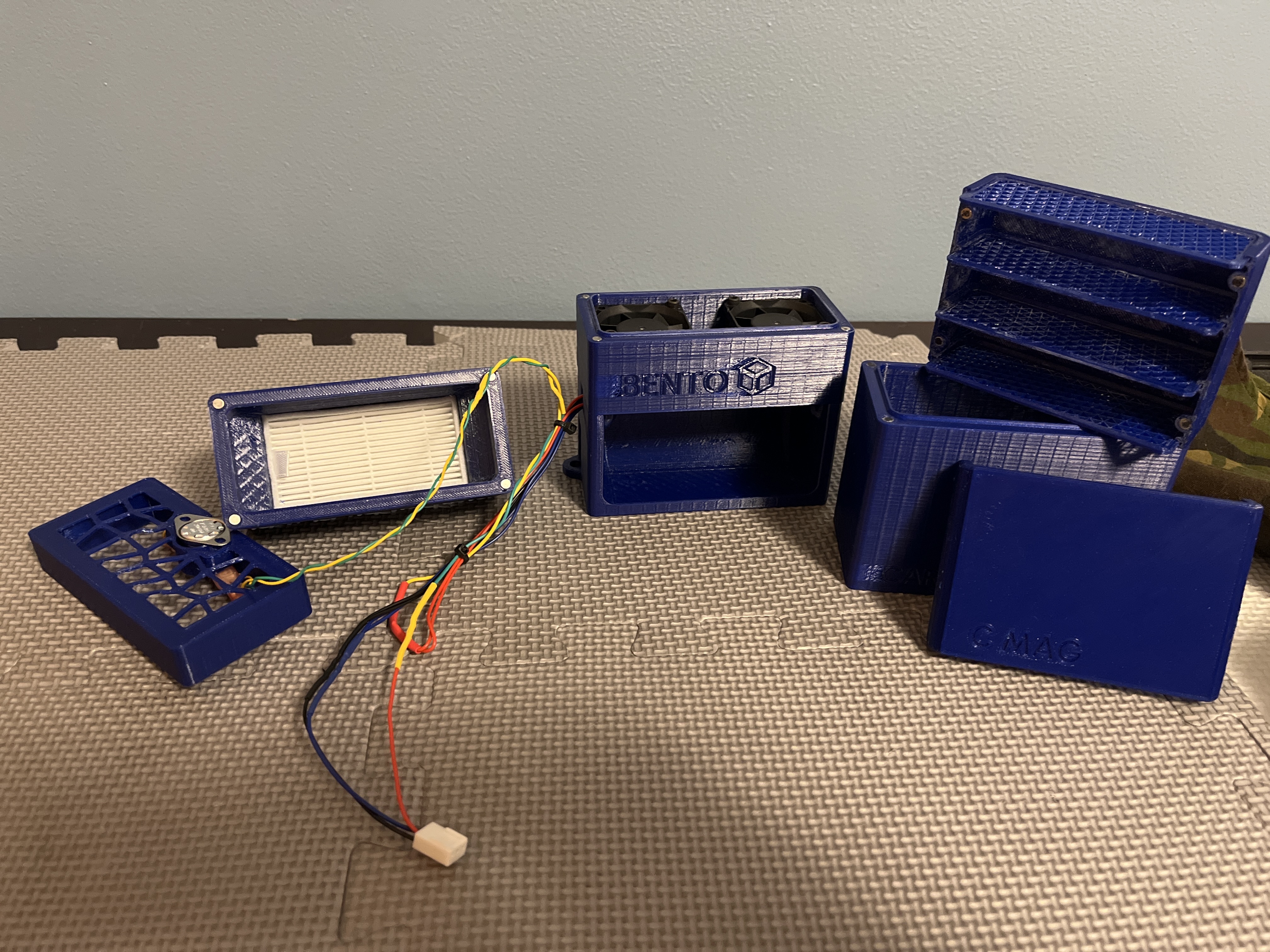

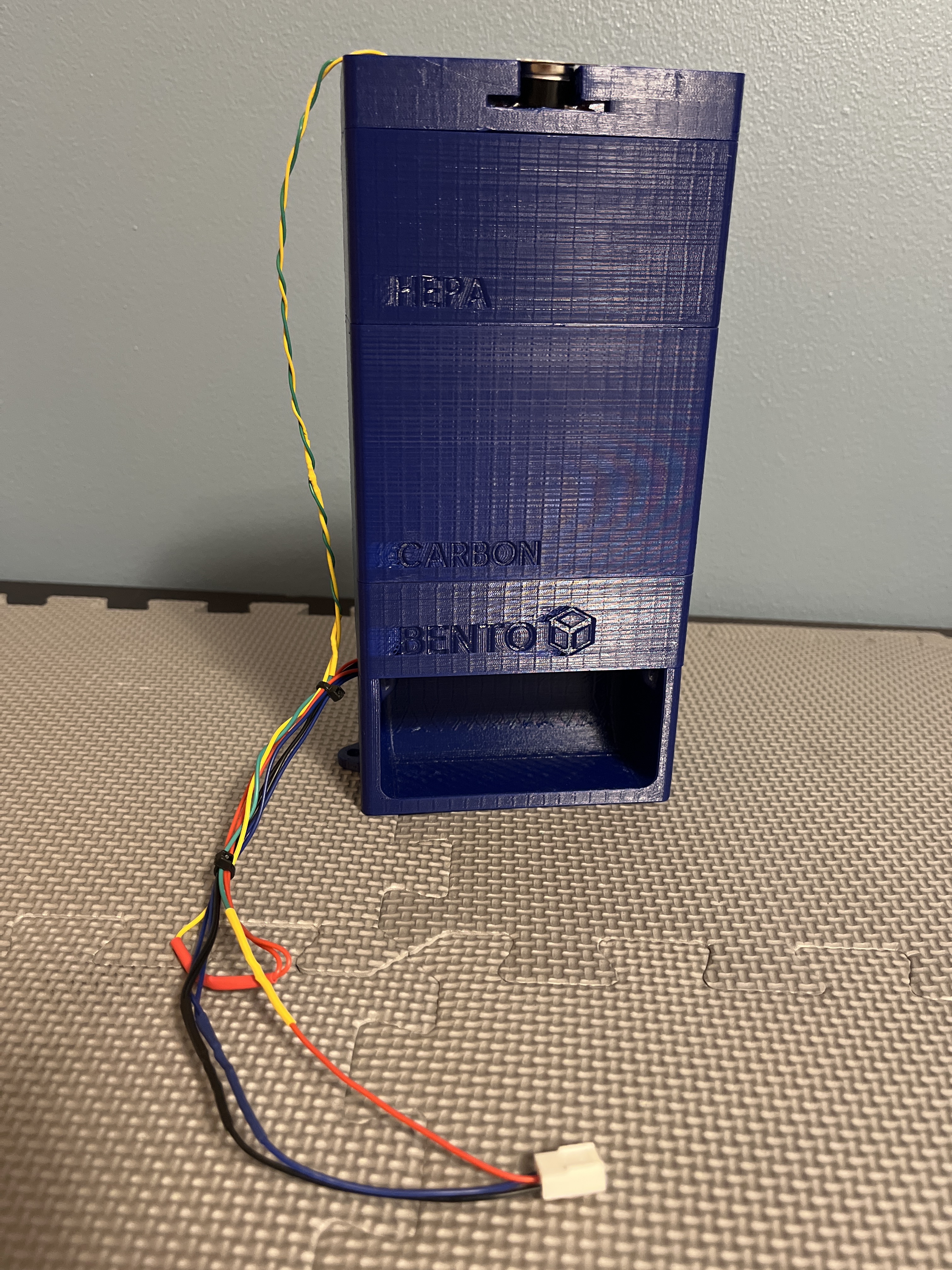

      Printed and wired up. Have yet to test
      1. BentoBox v2 - printed in PETG. HEPA filter & activated charcoal filter out toxins from ABS, ASA, Nylon, etc
        1. 40C normally open thermal switch - keeps the fans off until the enclosure gets up to temperature
        2. magnets, brass inserts, 4028 fans from Amazon (see BentoBox documentation)

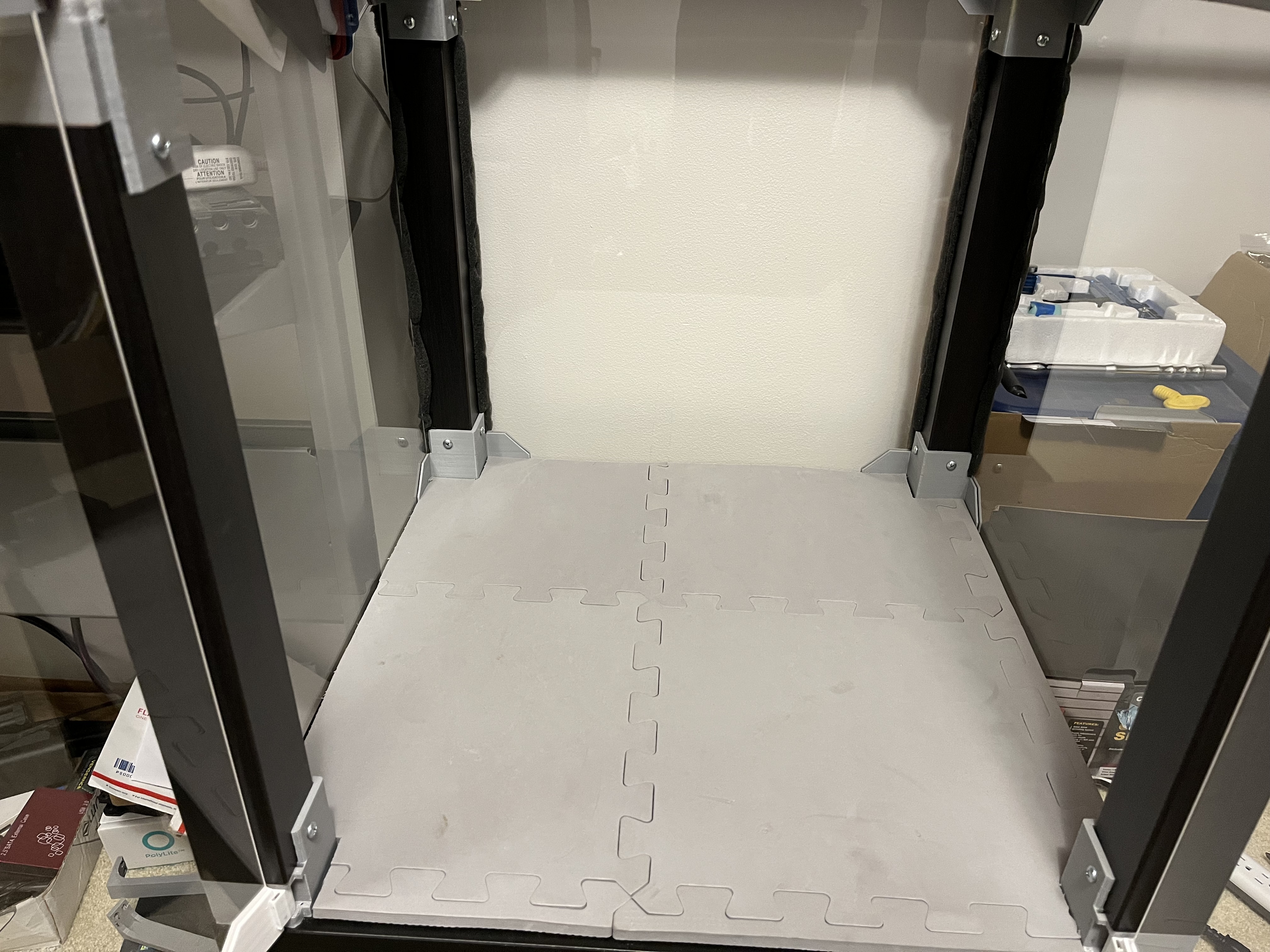

        3. 1/2" thick interlocking 12" foam squares. Free from a yard sale - DONE

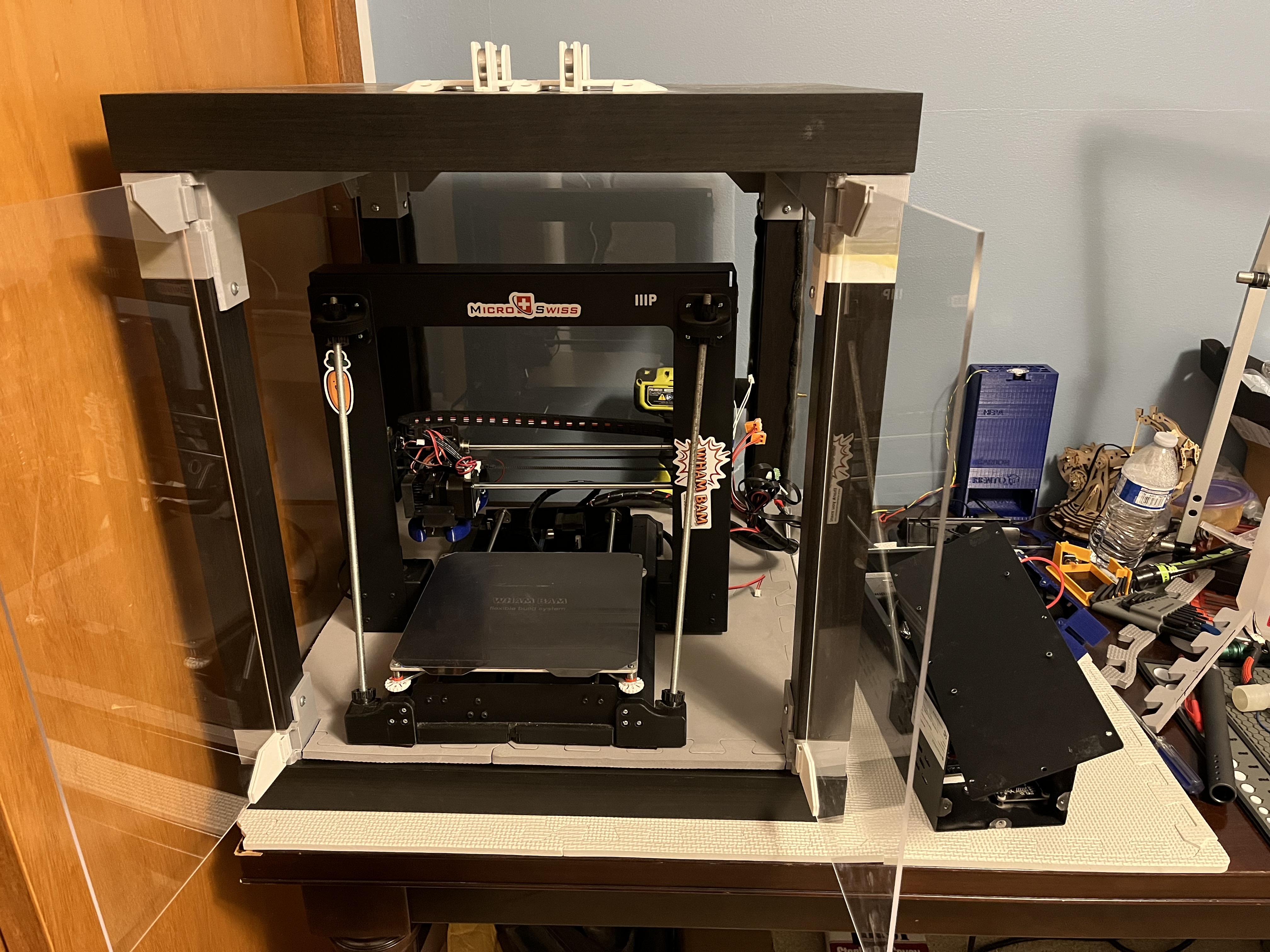

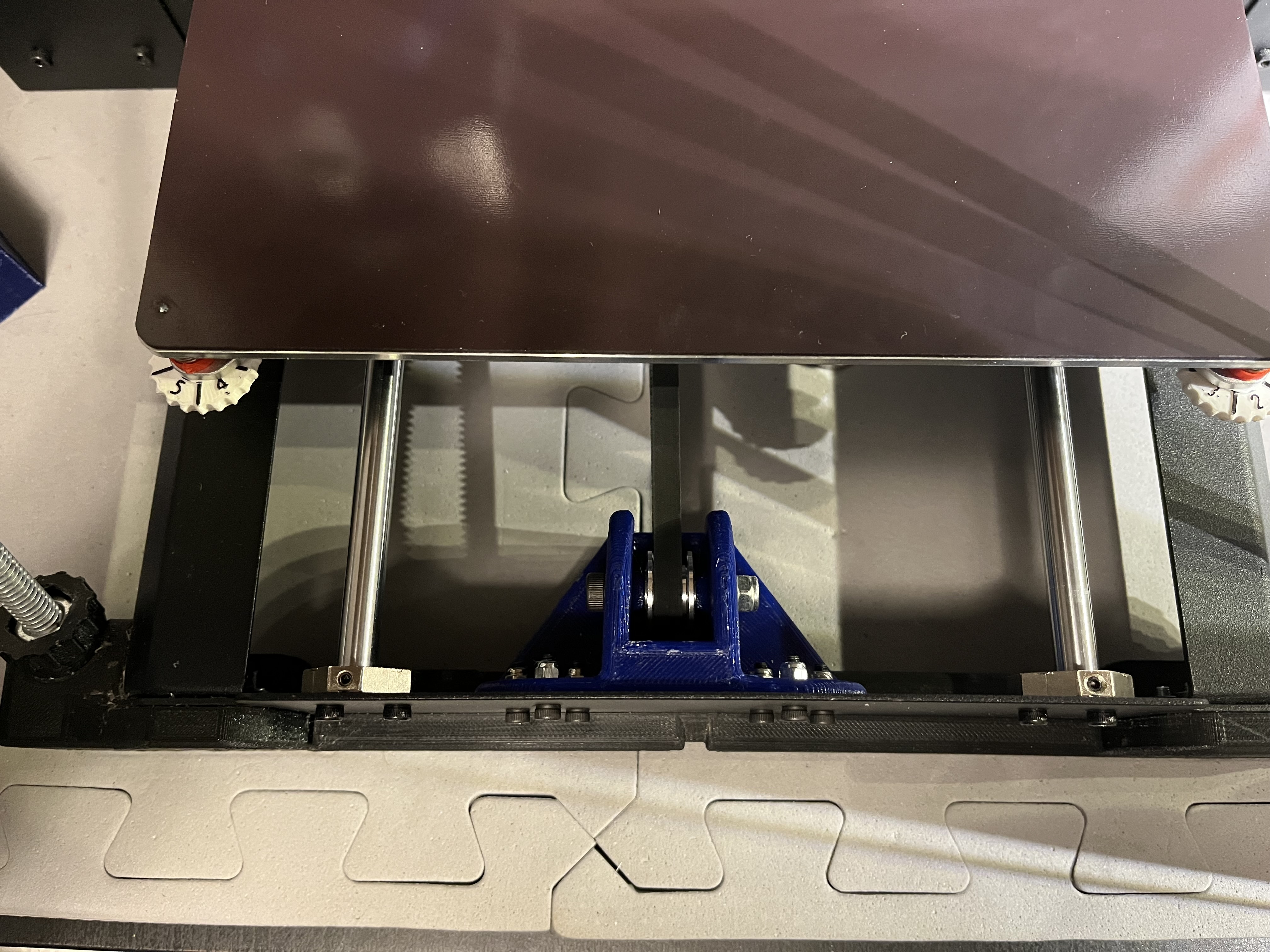

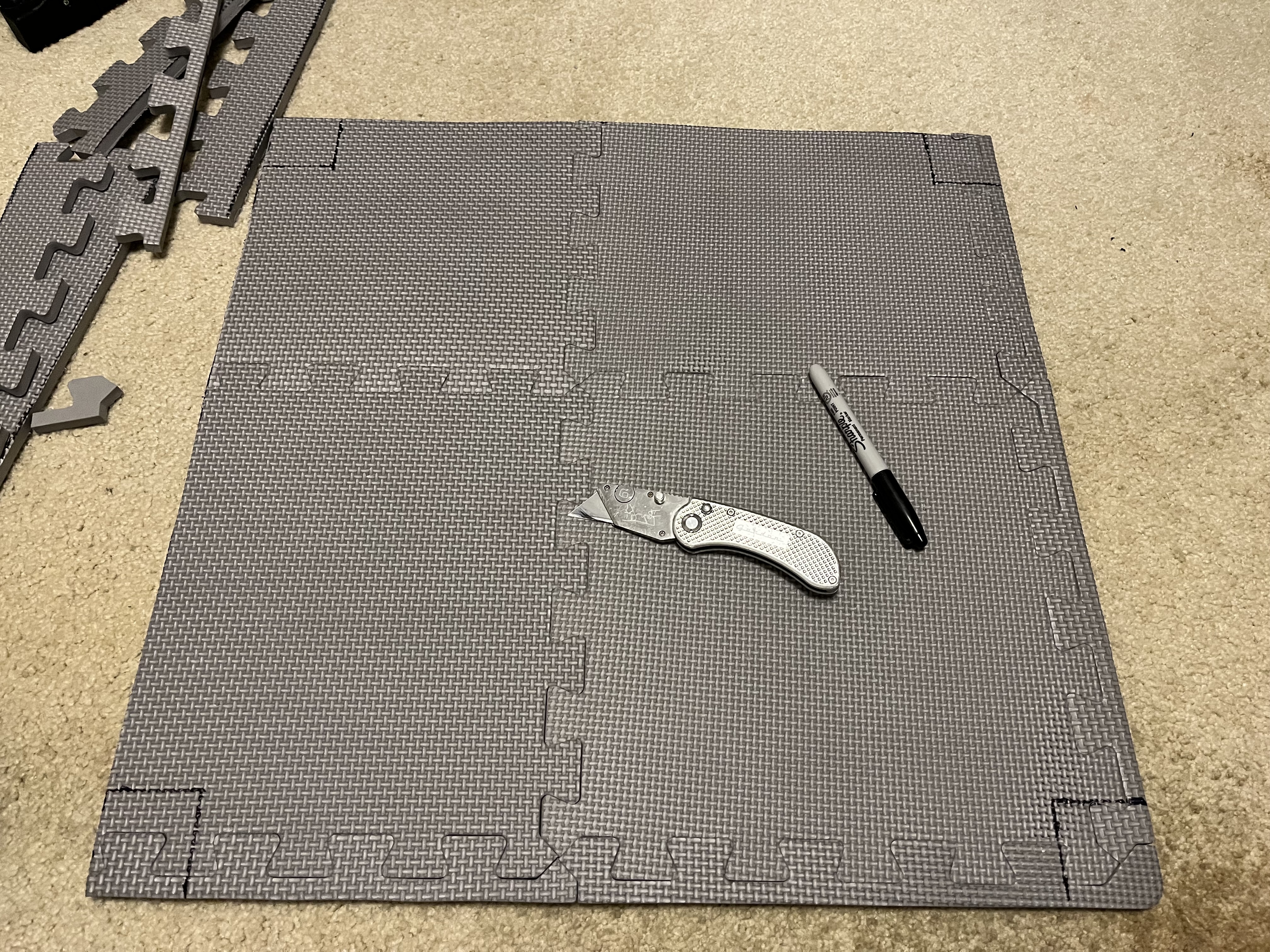

            finally moved the enclosure to the work table next to my tech mat and installed the foam flooring for noise & vibration dampening. HUGE difference in printer vibration. The ikea lack tables are just so flimsy that even with printed braces it wobbles all over when printing.
            Post #4 updated w some pics
            I’ve got most everything else in the mail, just haven’t made time to install it.
            My Feedback Thread

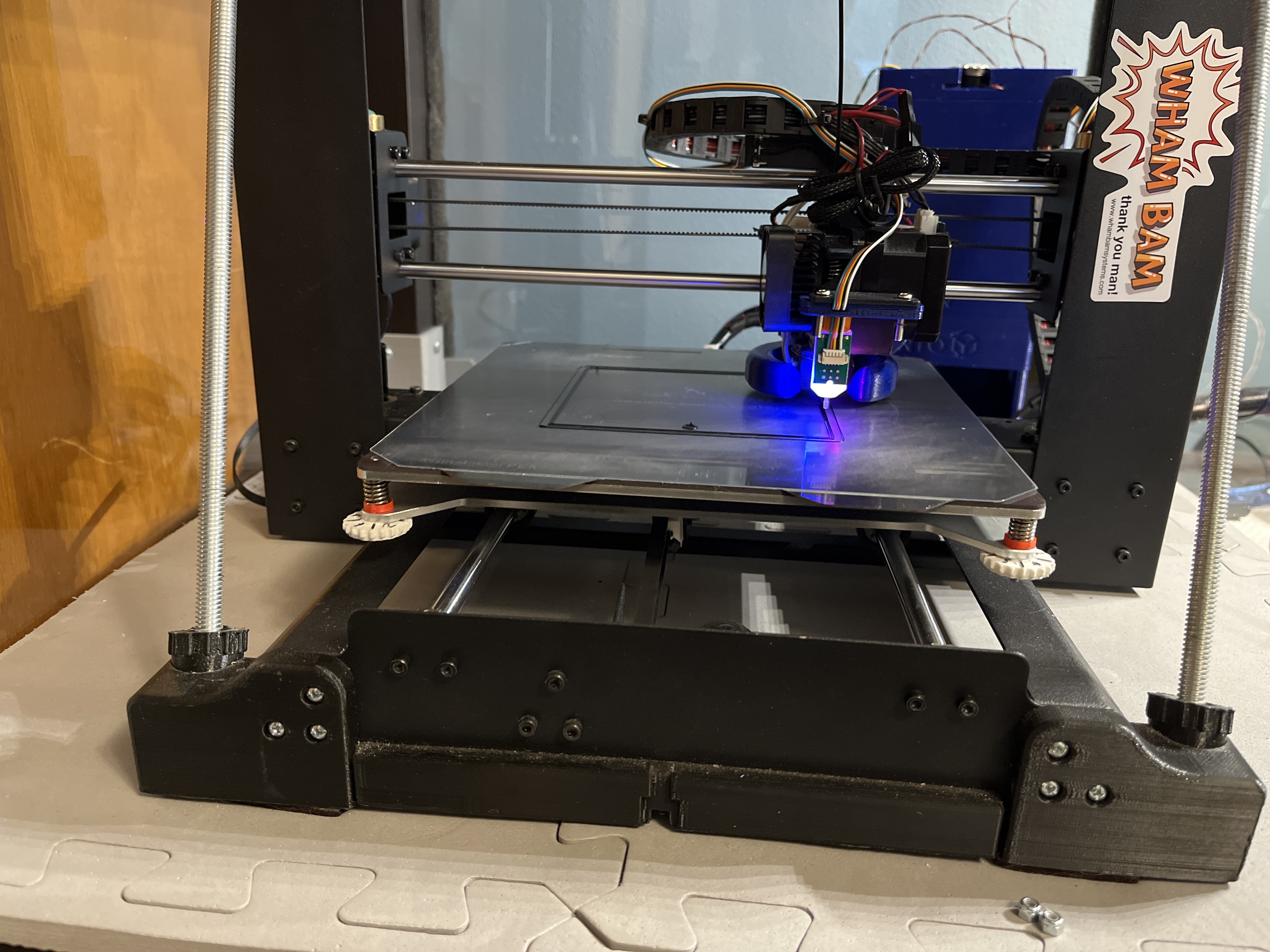

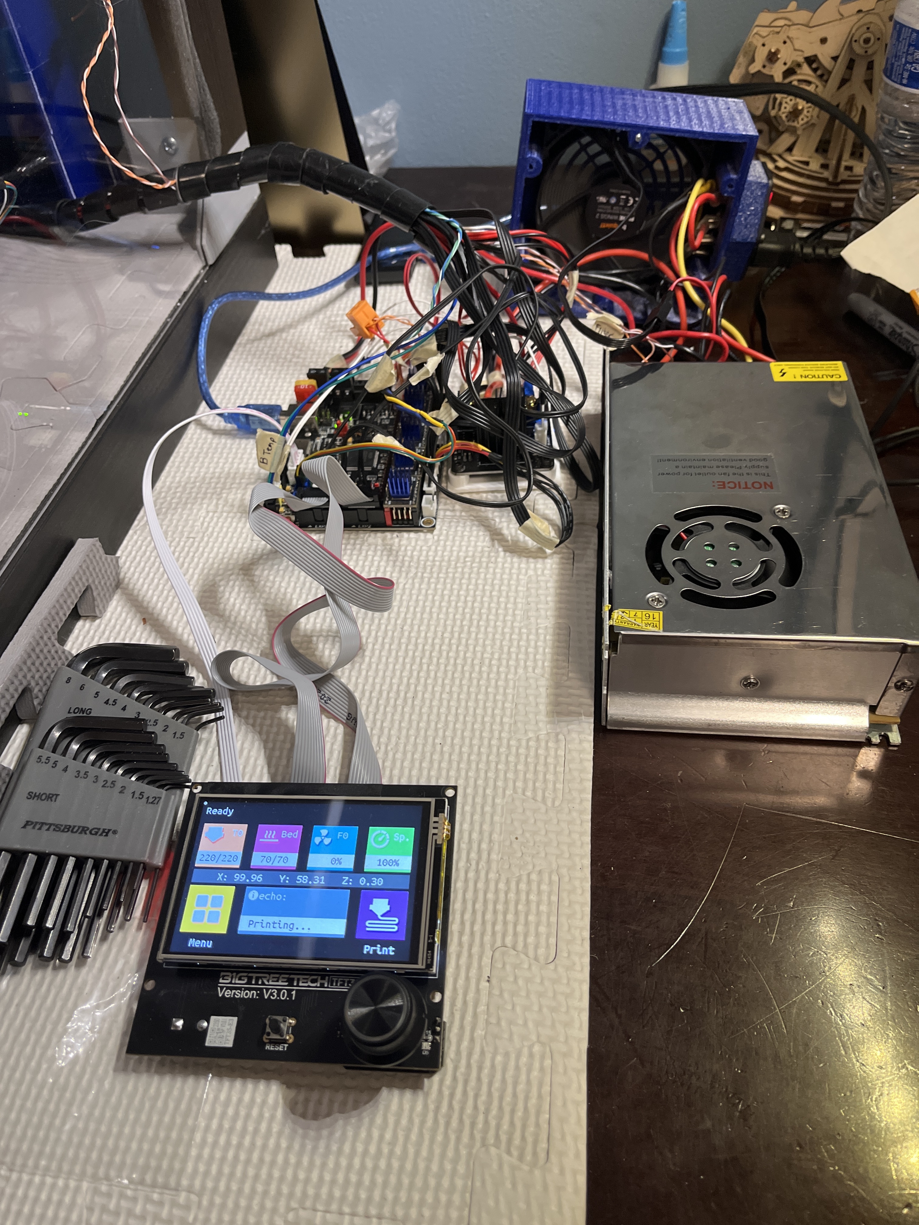

                New magnetic base came in and is installed. Had to replace the thermistor in the new heated bed - Marlin didn’t have a profile for it that would read accurate temps.
                After about 16hrs of fiddling with the firmware settings, I have Marlin 2.1.2.4 working perfectly on the new board. It’s soooooo much quieter! No bearing rattle, no motor screams, and the fans are near silent. I hadn’t planned on Z motor alignment as a capability, but when I found it I was glad I’d bought an extra motor driver. My dual z motors now work independently of each other, so I can use the BLTouch probe to run a leveling program that gets the motors within 0.01mm in height. Auto bed leveling also works like it should.
                Problem is the new touch screen won’t fit the old case like I thought it would so it’s all a mess of wires right now. No matter! I’ll just print a new case.
                My Feedback Thread

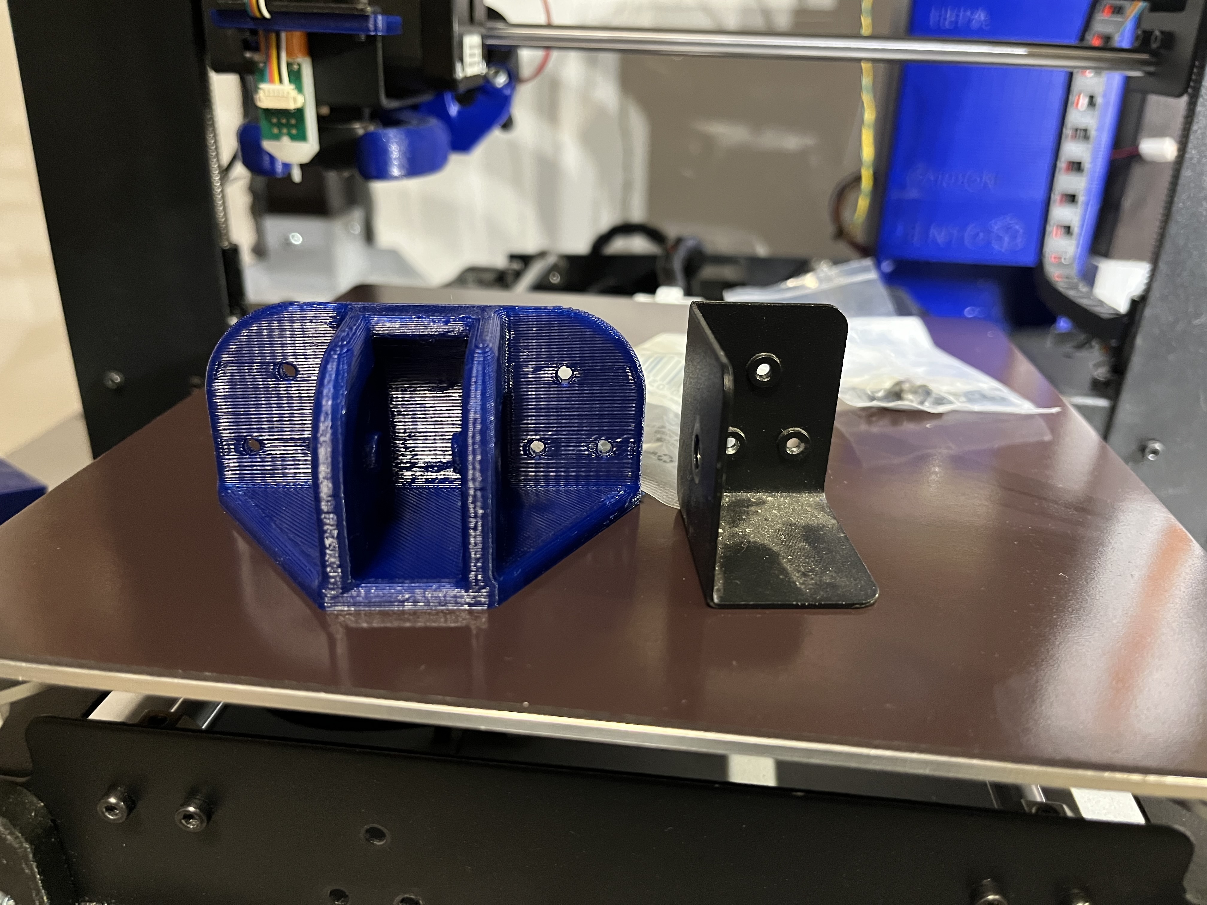

                  I noticed I had issues printing perfect circles - they were coming out with nubs and the Y axis was probably the culprit. Typical problem with this printer, but the flimsy metal bracket for the idler pulley can be replaced with a printed one. Just a few bucks in hardware and 3 new holes in the frame, now it’s installed
                  My Feedback Thread
                  • boarder2k7
                    • 246
                    • Laniakea, Pisces-Cetus Supercluster Complex, Virgo Supercluster, Milky Way, Orion Arm, Sol System
                    Looks good! How's it working after that idler bracket replacement?
                    • lhamilton1807
                      lhamilton1807 commented
                      The circles are much nicer! I think I need to fine tune the belt tension still, but this solves 95% of the issue.

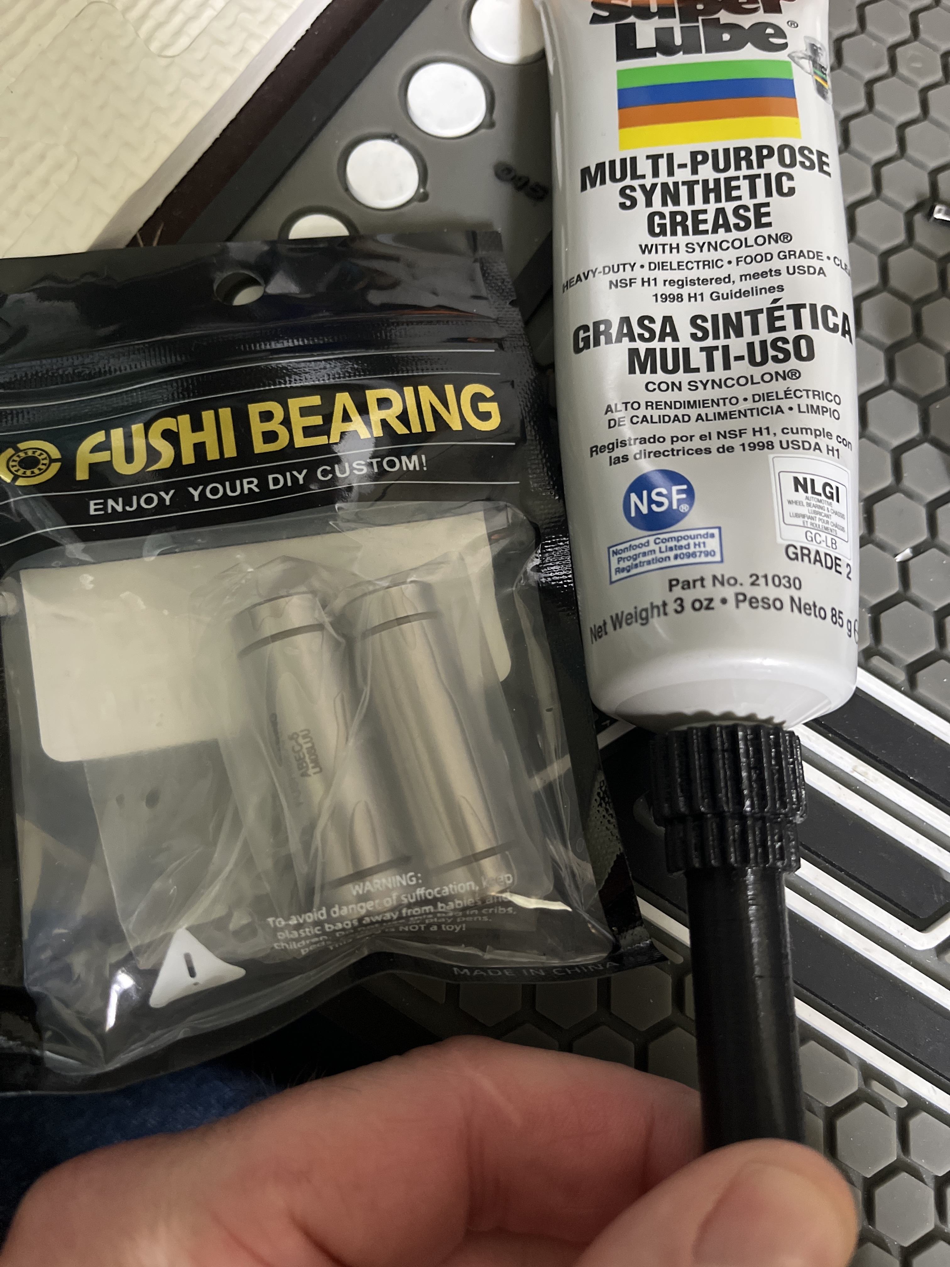

                    The drylin bearings were just too grippy, and layer lines were just too inconsistent.
                    Found some good-rated bearings a while back and packed them with grease using a printed nozzle
                    they’re quiet, smooth, and make for great prints. Followed this guide - pretty simple.

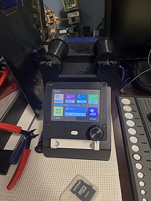

                      Edit: realized I hadn’t posted pics of everything assembled - custom internal board mounts and a touchscreen case. It’s no longer a pile of wires and boards 🤘 Also printed a spool holder/roller that fits on top of the control unit. Rolls really nice.
