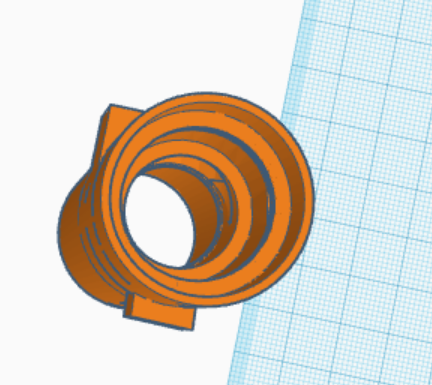

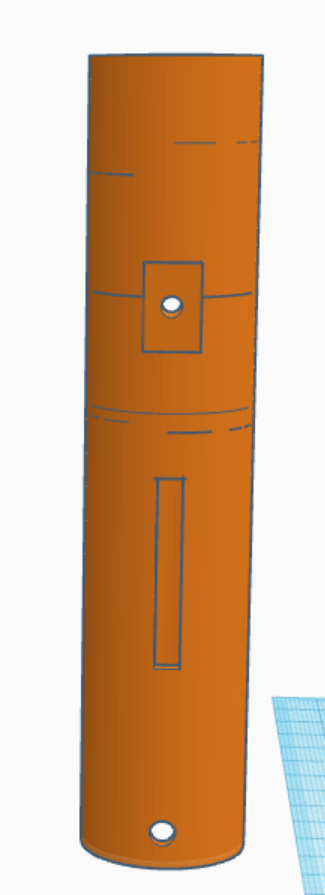

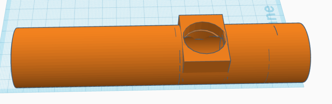

    I started by measuring around the main body of the valve, and then checking the distance from step down on the valve to the tip of the bolt.
    I made a cylinder the correct diameter to snug around the valve and then made another to match the bolt diameter, placing it in front of the other and matching the outer diameter. The head spacing for the bolt to rest comfortably took 2 design iterations.
    Next came the barrel threading, I pulled an autococker threaded barrel from Thingiverse and made a negative of it and hollowed it out, adding a cylinder around it the same diameter as the one for the rest of the body, this head spacing also took 2 iterations, I was left with some threads showing on the barrel and a large gap between the bolt chamber and the barrel, I remedied the chamber side but did not want to remodel the thread portion so I added a "shroud".
    After that, I grabbed a feed neck and grabbed a rough diameter for the threads and put a hole in the top for the breech. Easy peeazy. Totally done!
    Then I realized that I had forgotten that I needed detents, so I went back and dropped a cube matching it to the outside diameter as best I could and redrew my hole. I have not added the holes for detents as I have to buy some to measure and test.
    I went back to classic body and took measurements for the sear, on/off, and mounting block and added holes for them. I will be getting some heatserts for the front trigger frame screw, but for now mounting it into the PETG has seeming been solid.
    I have not tested it, and won't be letting it out into the wild until I've had my fun with it, thought I'd share while I'm poking though. All in all about 2 hrs modeling so far.

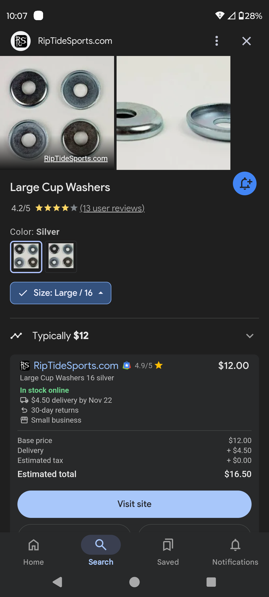

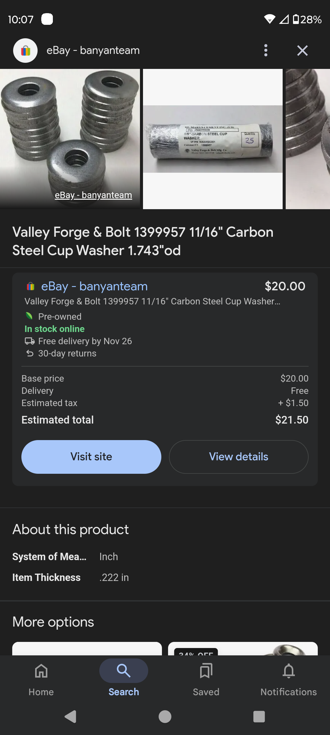

        Crap screengrabs but I was already considering something a long these lines. cougar20th

        • cougar20th
          cougar20th commented
          Youll have to make sure the OD of the washer is within ID of the body, The ID of the washer is larger then the bolt and that the thickness of the washer is accounted for in your design.
