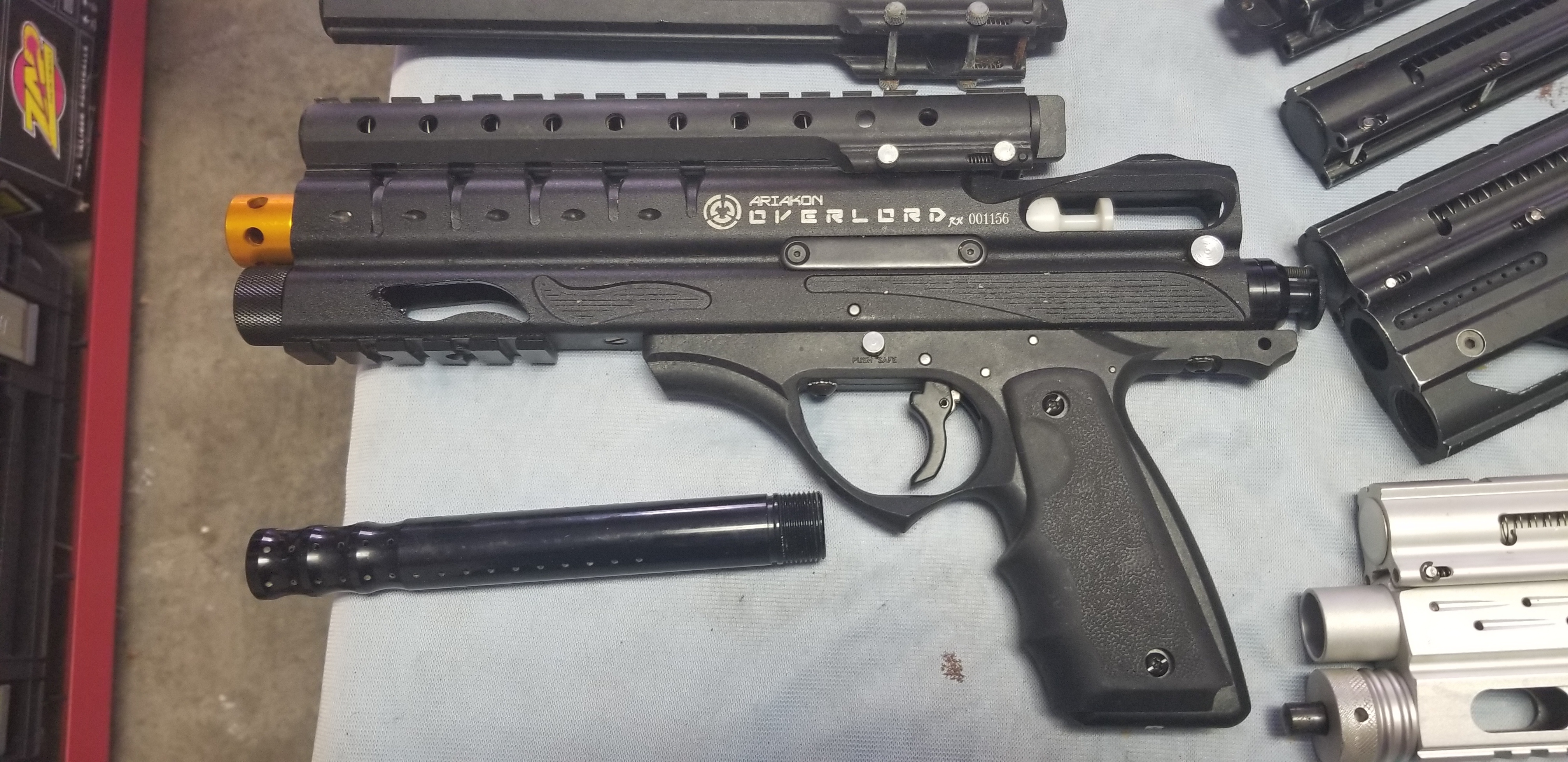

    Was wondering if anyone here done a cram and jam for either of these pistol. I would think it would attach to the rail and held by some set screws.

    I've thought about making one, but I'd honestly try to add the spring pins the standard magazine uses to latch. I have never worked up the motivation further than that.
    That being said, I think if you utilized that spring latch mechanism, the cram jam would work on just about any stbb pistol.

    For a cram and jam I would think the easiest way would be to bore out one of the magazines at the back end to accept a tube

      Oh this may work. Easy solution

    I used to have an ariakon direct feed that would have been suitable for a cr and jam mod. Might be able to find something similar
    FYI if you are working with an ariakon, the parts will be different then everything else. They made almost everything proprietary so it wouldn’t work with the armotech design to avoid lawsuits. Even the magazine retaining pins springs and clips are different. I had a Zeus and an ACP and the mags are not compatible because the pins are different sizes.

    Then Ariakon likely not used in years. Put cartridge to it and it fired great. I was surprised.
    Now I want to set it up for constant air using on/off and a 9 or 13 tank. Bottom of the grip has two holes that are not threaded and also not same pattern for most rails or on/off. Got to figure something out to do this.

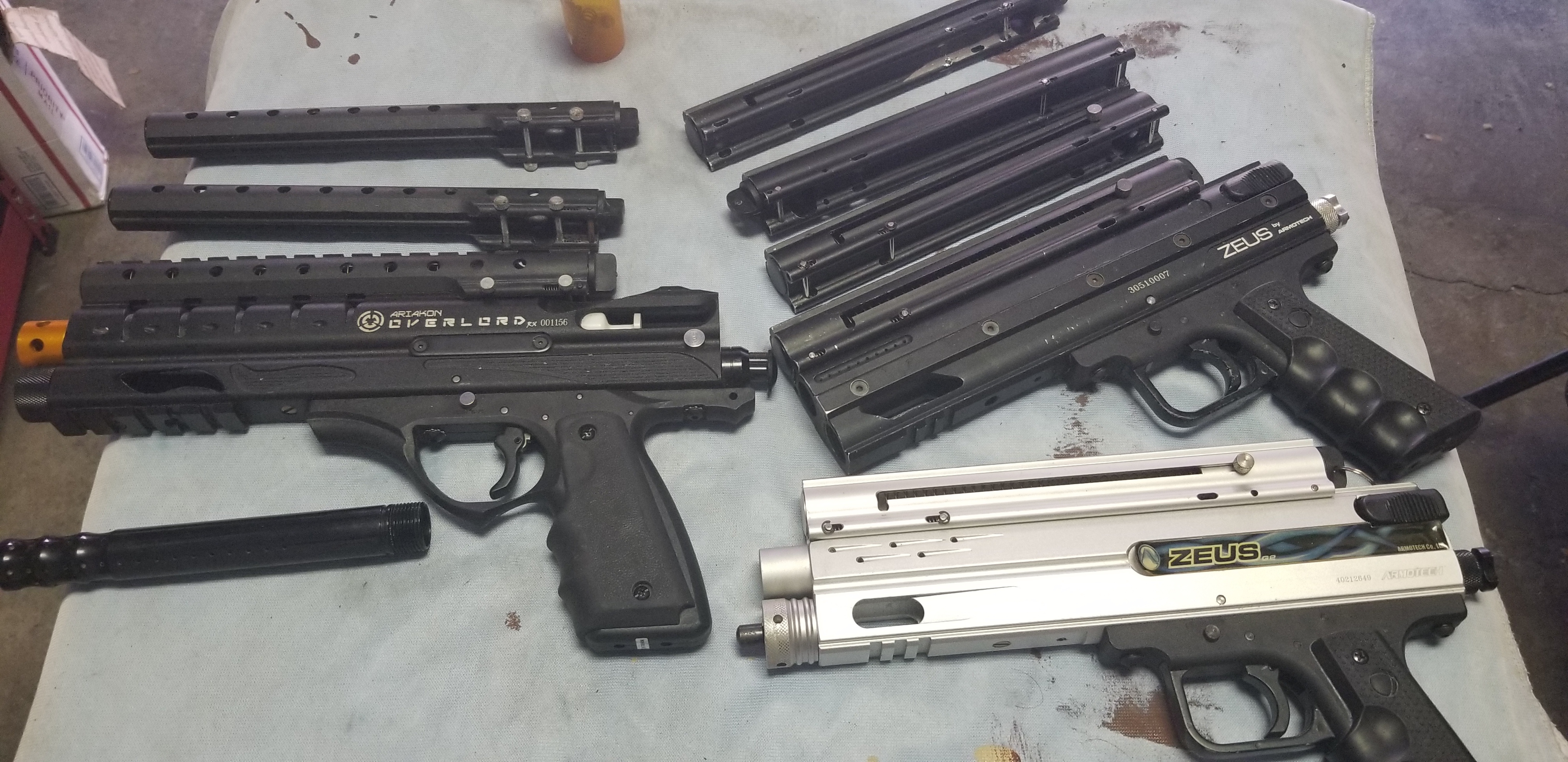

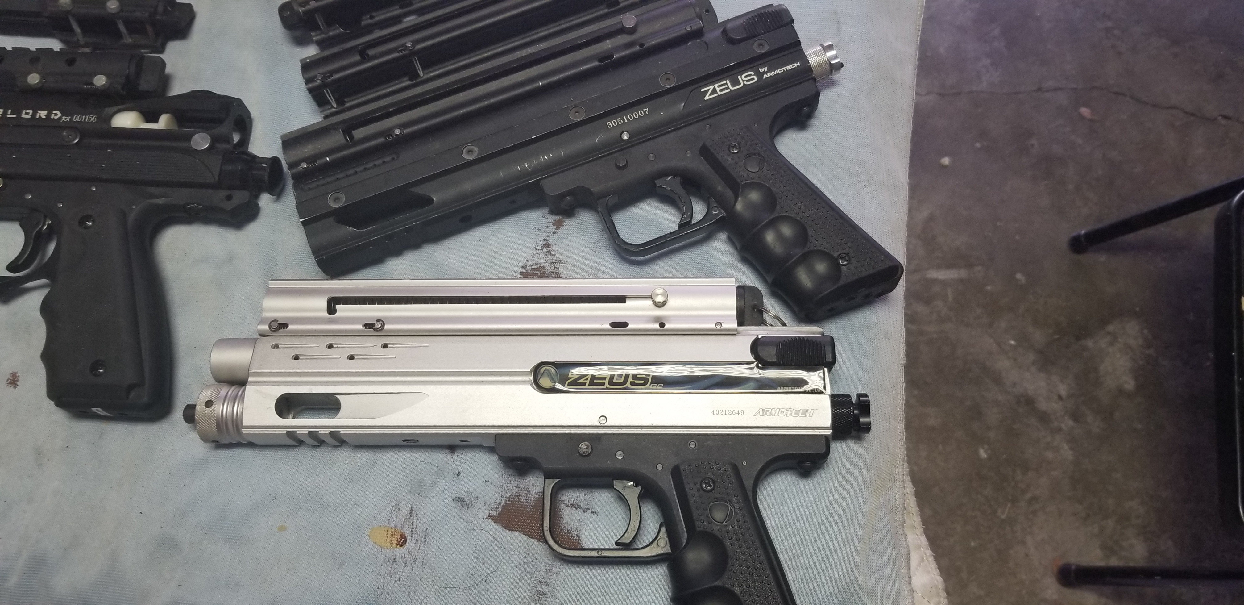

      Hey Ducky. I've got a pair of Zeus's I still use.
      I'm just gonna be honest with you and say that, sometimes, you're just not gonna be very lucky with them. One of mine runs pretty much no problem. My other one is extremely temperamental, and I'm always chasing down a leak, struggling to get it to cycle, or some other sort of issue. The one I have that works really well is an Armotech branded one, the one I have that isn't as reliable is a Warsensor branded one.
      Spyder Valves work, and so do Spyder valve springs. The cupseal it likes with whatever valve you're going to throw in can be a crapshoot. Hammer Spring I use is a cut down Tippmann main spring, can't remember if it's 98c or A5 (I'm leaning towards 98c). It shouldn't need any paint to cycle. The design is, quite frankly, flawed on these things. Or the tolerances are all over the place. Likely both. The main spring is really heavy, and you lose a ton of air out the back each shot, since the bolt is designed to sit flush against the body of the marker, and has no O-ring to seal it up. They're all pretty old at this point, and likely pretty well worn, and loosened up (or they just came out the factory loose), so it could simply be that you're losing too much air for it to properly cycle. You could try experimenting with different valves/springs to resolve the issue. I've thought about cutting a groove into the bolt somewhere to fit an O-ring, but I don't have the tools to do that properly, nor do I know where the best place would be to put one.
