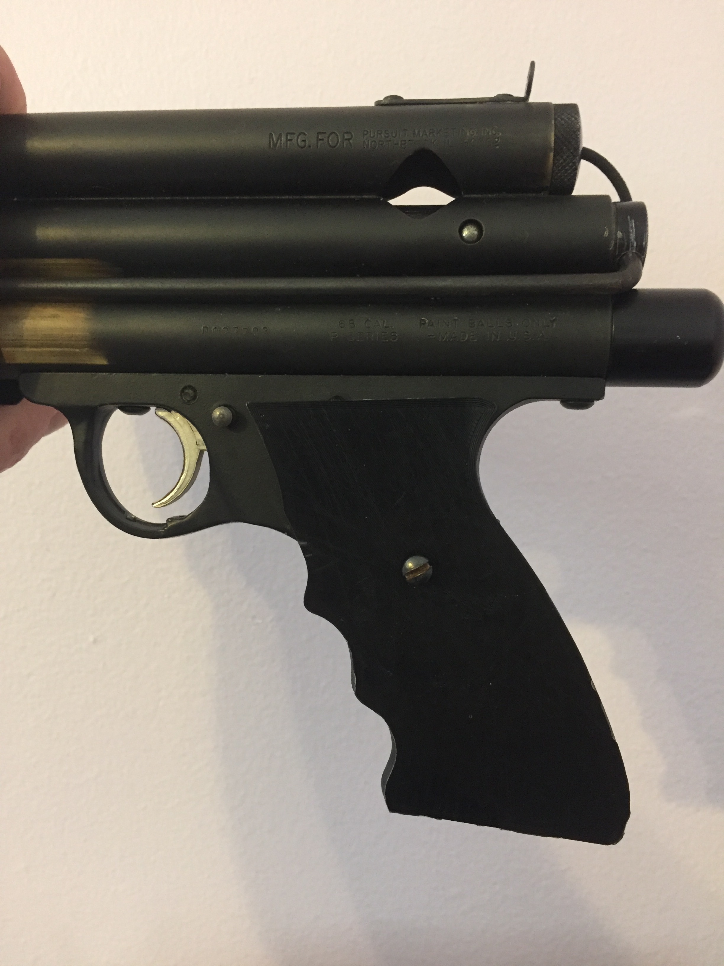

          Reconstructed from before the Big Sad,
          Rainmaker sent me the file and I used it as a 3D printing challenge. The model was well formed except for some holes in the mesh body. After a few clicks in fusion 360 I had a printable grip.
          Make a quick repair in Fusion 360
          Slice it in Prusa Slicer, 0.20 mm layer heights, 0.40 mm nozzle.
          Printed on a Prusa Mk3s in MatterHackers Brown PLA.
          Awesome model, printed smoothly with no supports!

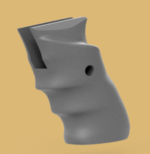

              Thanks to Carp letting me borrow his spare PGP, I've also been able to work on adapting the Battlegrip profile to the PGP grip frame. CAD snapshot, and a thin test print to check screw hole location and grip frame fitment:

              • Aperture3D
                Aperture3D commented
                Looks incredible! Great work.
              • Rainmaker
                Rainmaker commented
                Aperture3D - did you say you liked the feel of the grip? This one has the same shape
              • Aperture3D
                I love the profile, it is super comfortable!
