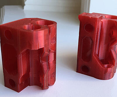

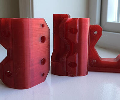

        I've been printing a lot in Nylon blends, and lord I know you're right. I gave up and set up a dehydrator.
        But it's not just for Nylon - someone on prusaprinters posted these pictures. That's Stronghero PETG (one of the cheapest filaments on Amazon) at 260C (Crazy hot for PETG!), with zero post-processing. I wouldn't have believed it before I started dehydrating. Everything goes in the dehydrator before it goes in the printer now...
          Wow, that is insane! I need to use a dehydrator. What dehydrator/dryer are you using? Storebought? Homemade? Oven?
