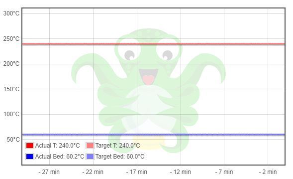

      That's a really good idea! Thankfully I haven't had any issues maintaining temperatures inside this particular enclosure. Although, I may need to look into a heater of my own if I want to quit borrowing my wife's hairdryer.

      • boarder2k7
        boarder2k7 commented
        Eww, light mode octo? How aren't your eyes burned out? 😆
