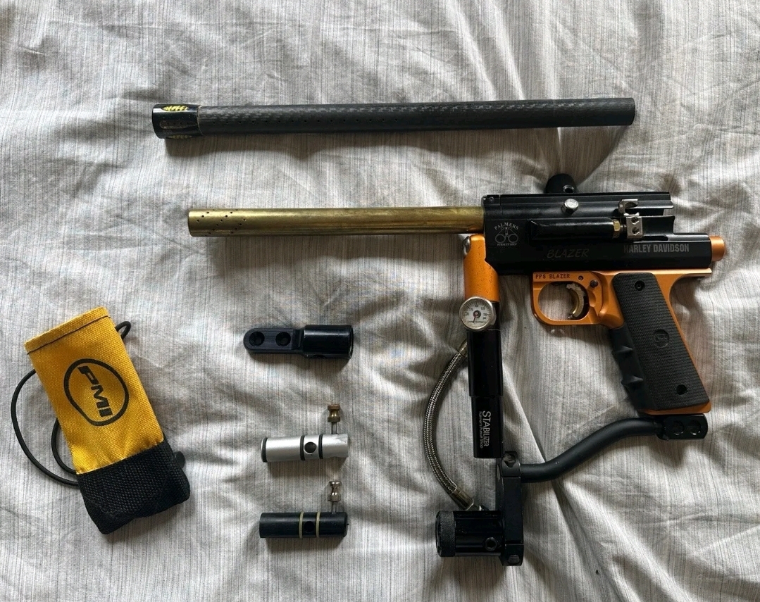

    I just heard about Palmers shutting down so I am guessing this might he the right place to ask. I just picked up a RF blazer and I was wondering if someone is able to convert it from Right Feed to Center Feed.
    Does anyone offer an o-ring kit for the Blazer?

    I wonder if Mozak Machine could install one of the right feed vertical adapters he puts on cockers.
    • Hellion360
      Hellion360 commented
      Pretty sure these feednecks are welded on not press fit, and thus they won't. Doesn't mean it can't be done, just not with those press fit pieces... Unless they are pressed and welded but I am not sure.
    • Grendel
      Grendel commented
      Yup, the feednecks on Blazers are welded. Not sure there is enough meat for modify to a slip fit like an Autococker uses. What I did for both my Blazer (I no longer have) and my Pyre is cut down the RF tube to the bare minimum and modified a RF elbow to bring the feed more vertical with the body. Tools needed - Tube cutter and a bastard file.

      Get a universal power feed it will put the hopper center line
