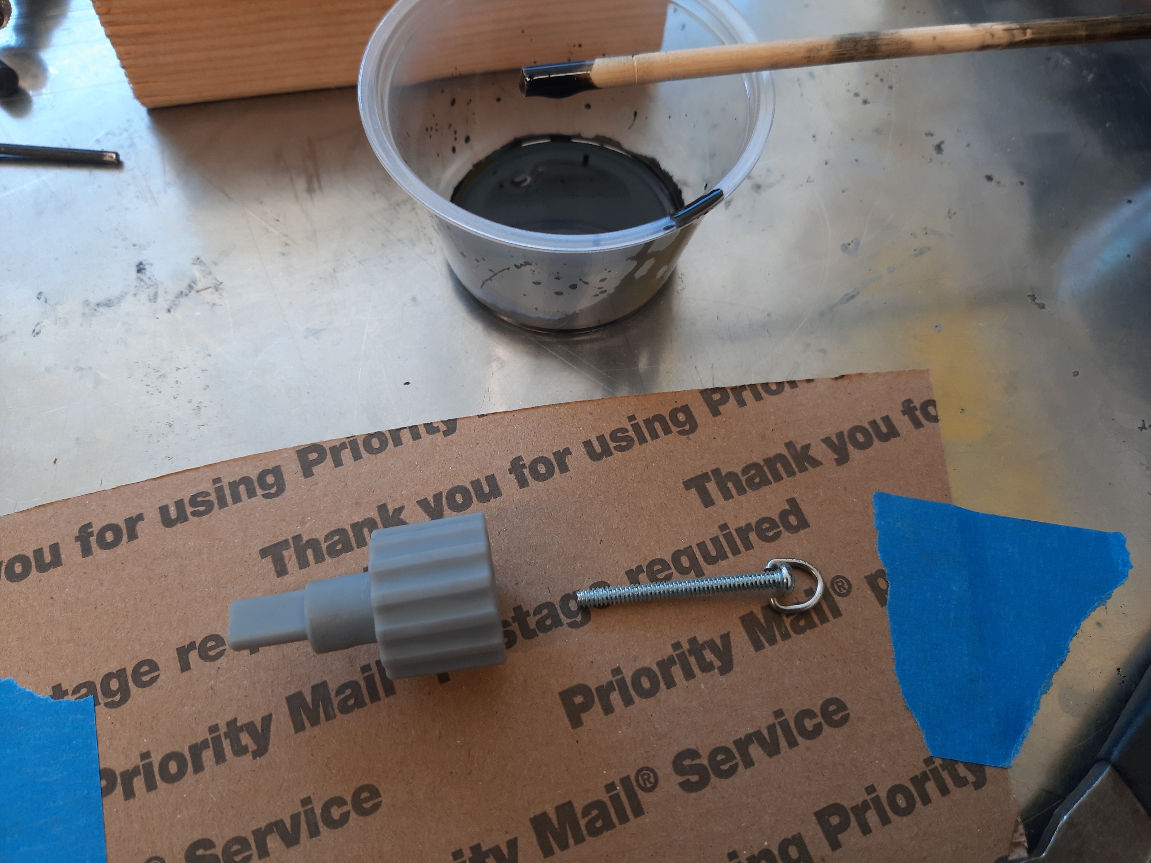

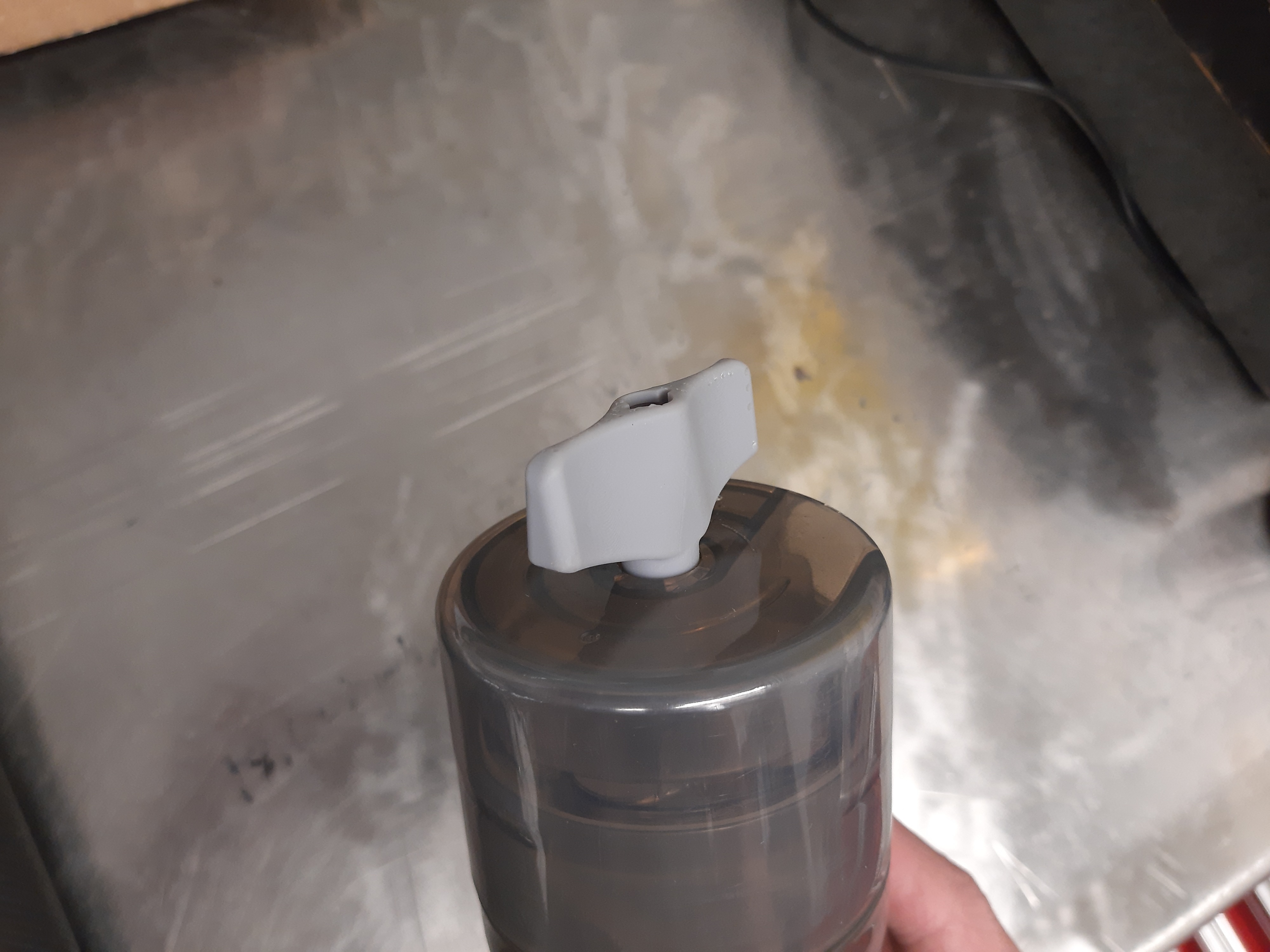

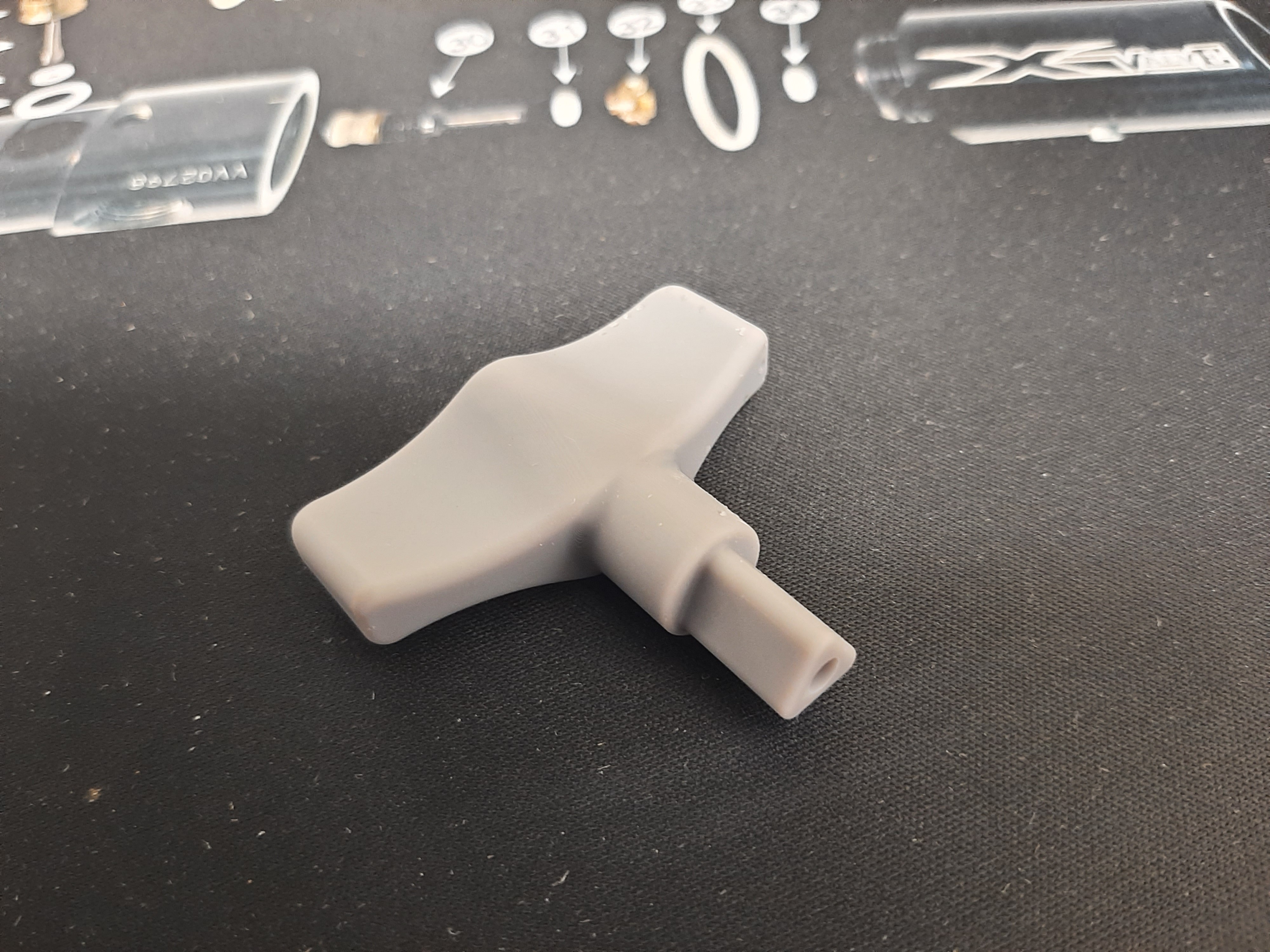

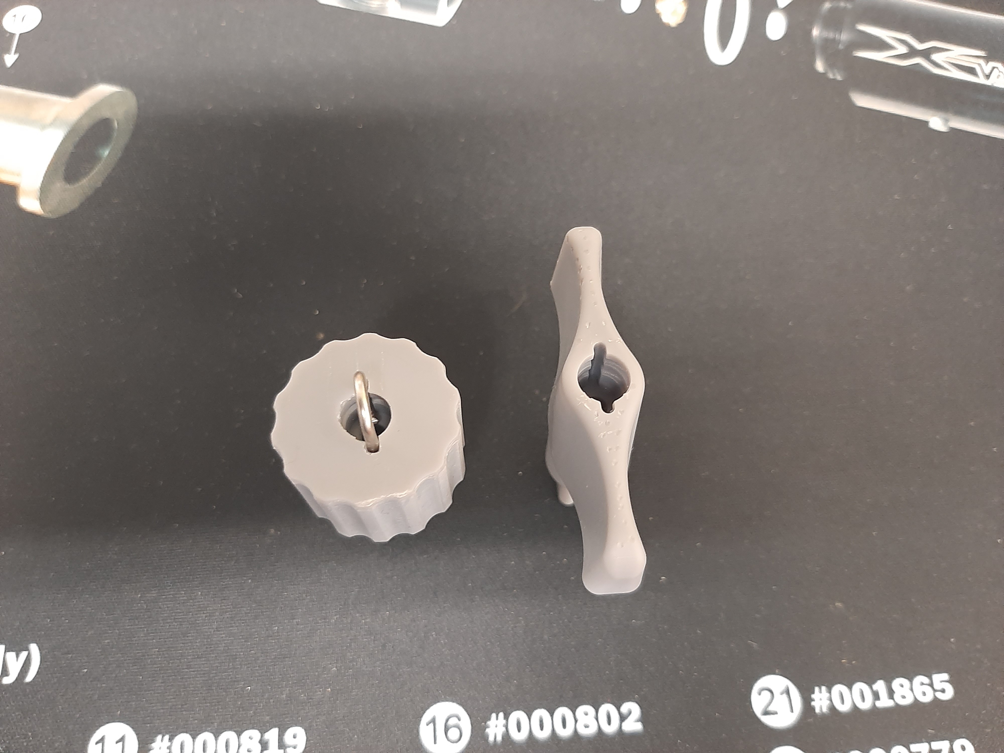

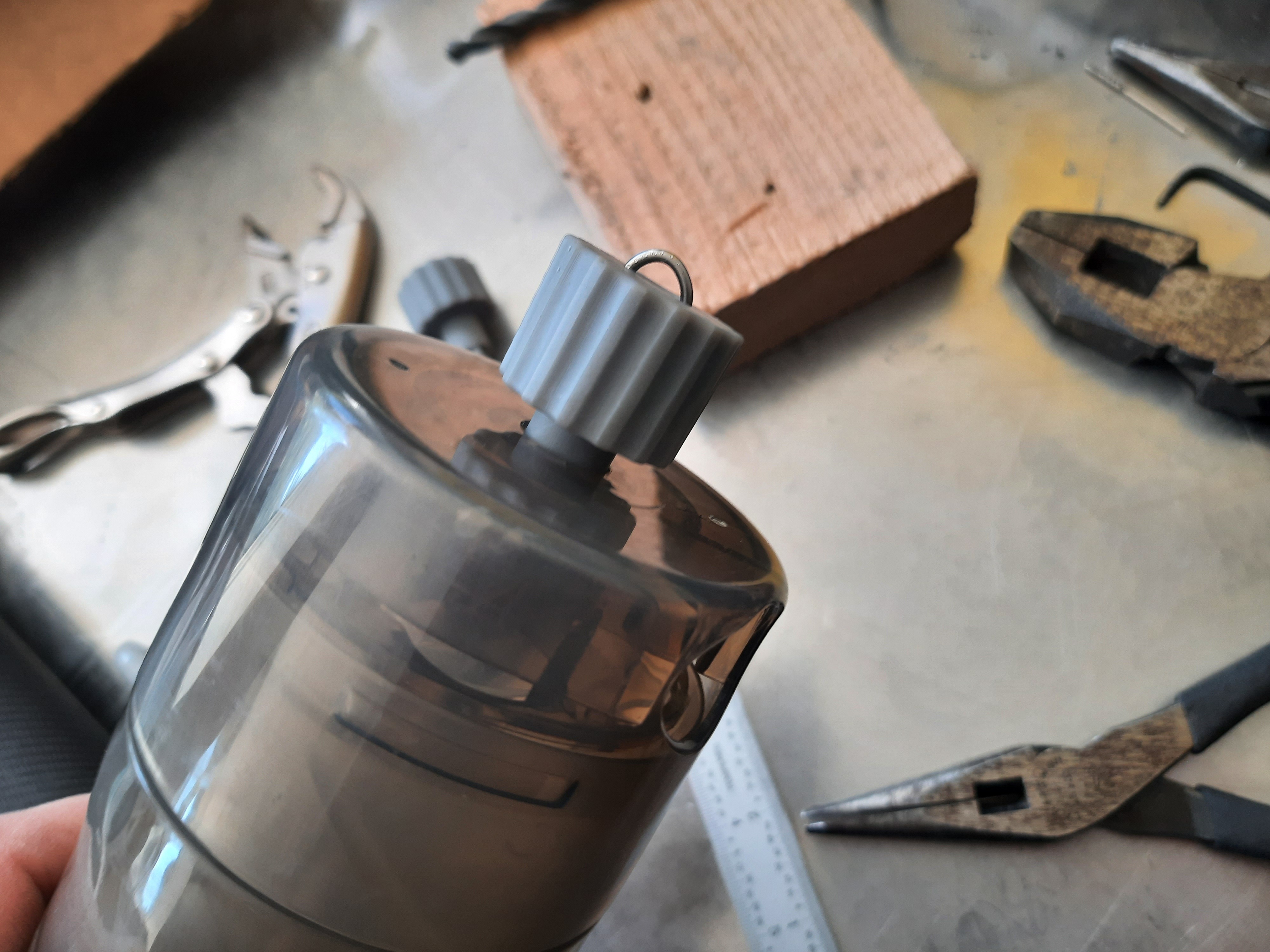

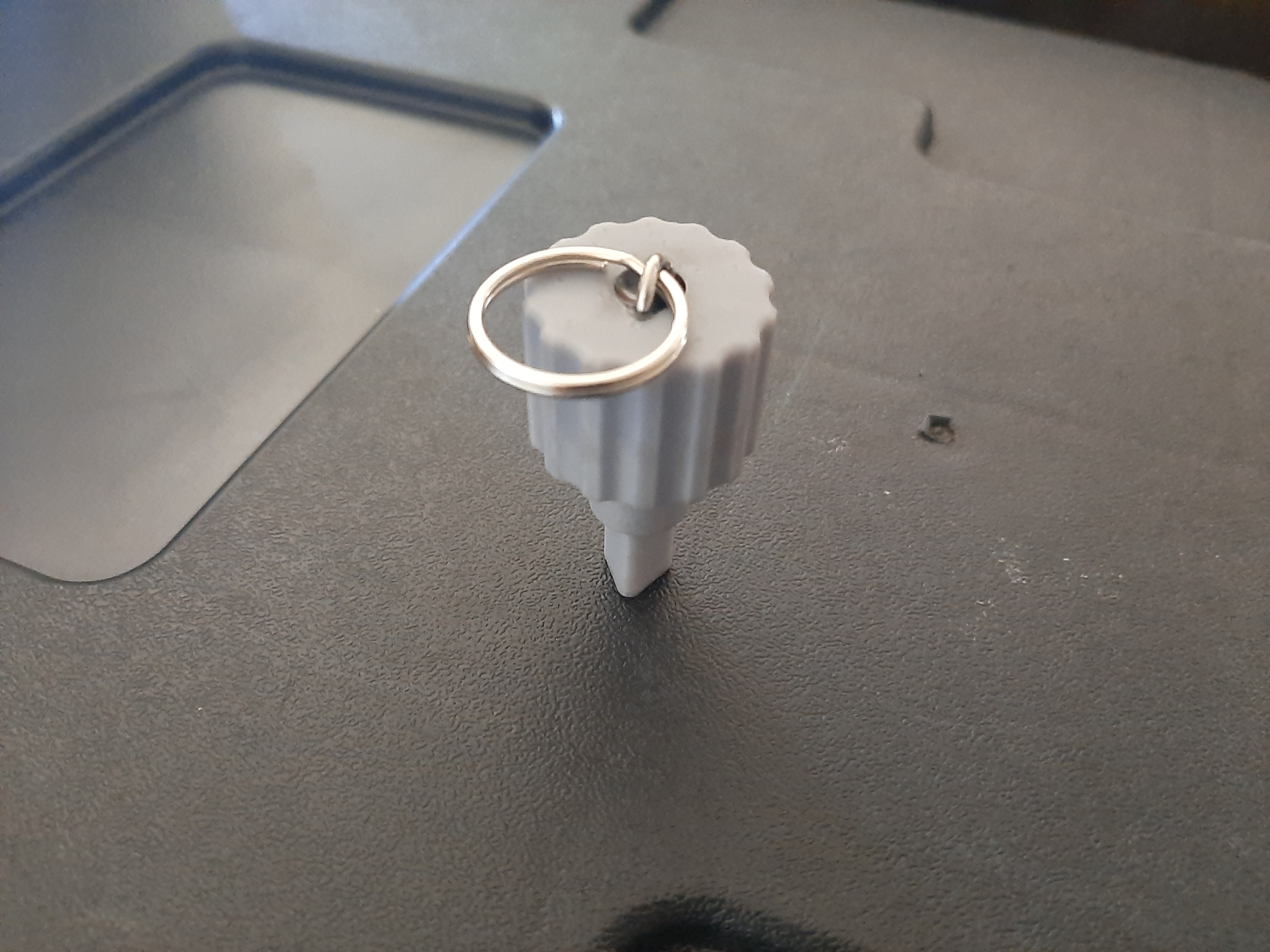

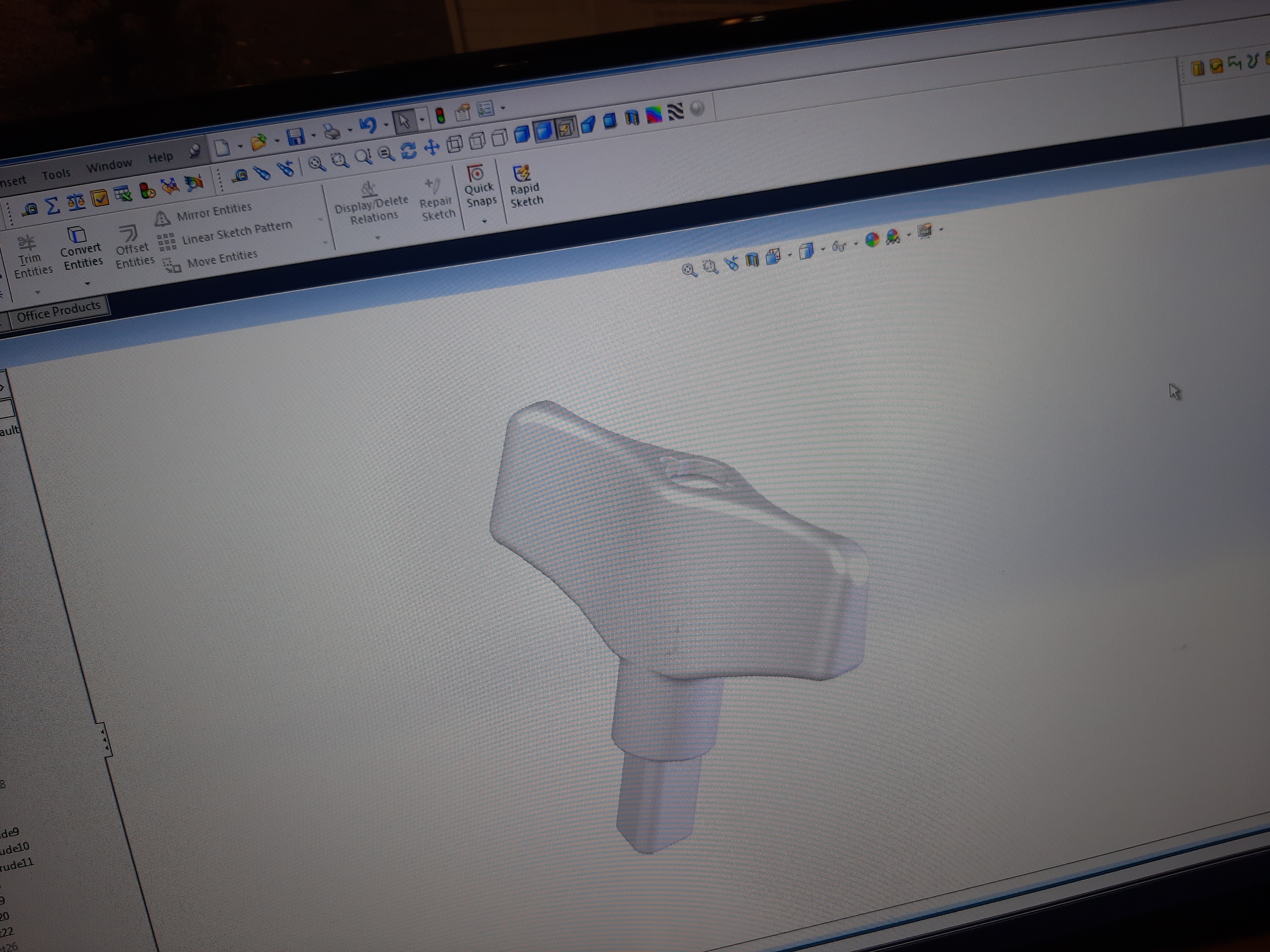

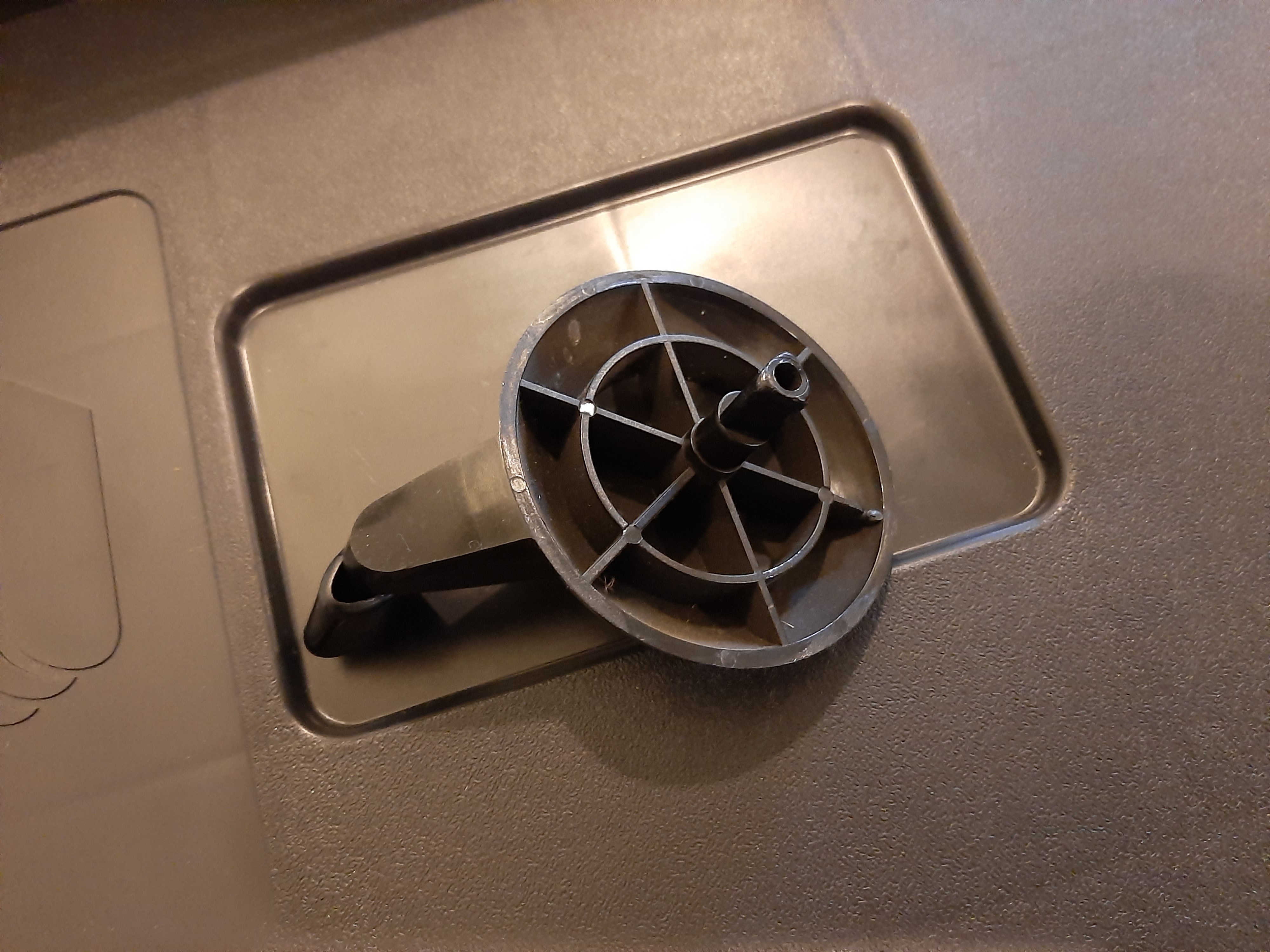

                  Here's another tip that makes things easier... Having a spare loading socket crank to manipulate the pods is handy.
                  Back when I bought my first Qloader I emailed the company and asked to buy a spare crank. Not sure if they ever replied to my email, but a week later one showed up no-charge. They were notoriously hard to get in touch with, but pretty liberal about just sending out parts & pieces for free. This works great in the staging areas for unloading pods, topping off, or backing out the top few if you have paint splattered into the opening. At Supergame I was really wishing I had it out on the field with me a couple times. Unfortunately it's too bulky & weirdly shaped to carry around comfortably. So I made a more compact version.
                  I remember fumbling a full pod a couple times during reloads on the field. Dropped it on the end and the hub disengaged causing about 15 paintballs to come flying out. If I had this at the time I could have wound those balls back into the pod right there in the bunker. Also remember one pod having a leaker only a few balls down in the stack, I could have carefully extracted it on the field and used the remainder of the pod.
                  It has a hole through the center & I epoxied in a 6-32 screw for reinforcement. The lanyard loop is a piece of 1/16" stainless TIG filler rod with the ends bent around so they are captured under the head of the screw. The whole works is then epoxied in with some black potting epoxy I have on hand.
                  Also making another version. This is the "key" style... being mostly flat it should ride comfortably in a pants pocket. The printer is working on this right now.

                    #28
                    I think I like the key style better. Much slimmer and easy to just shove it in a pocket.

                      Very cool. If you don't plan on selling them, it would great if you could add these to the STL repository here on MCB.
                      • Levi
                        Levi commented
                        I'll probably print a few extras in case anyone wants one. But I'll definitely make the stl's available too. Got a couple other styles I'm going to try before I post them up.
