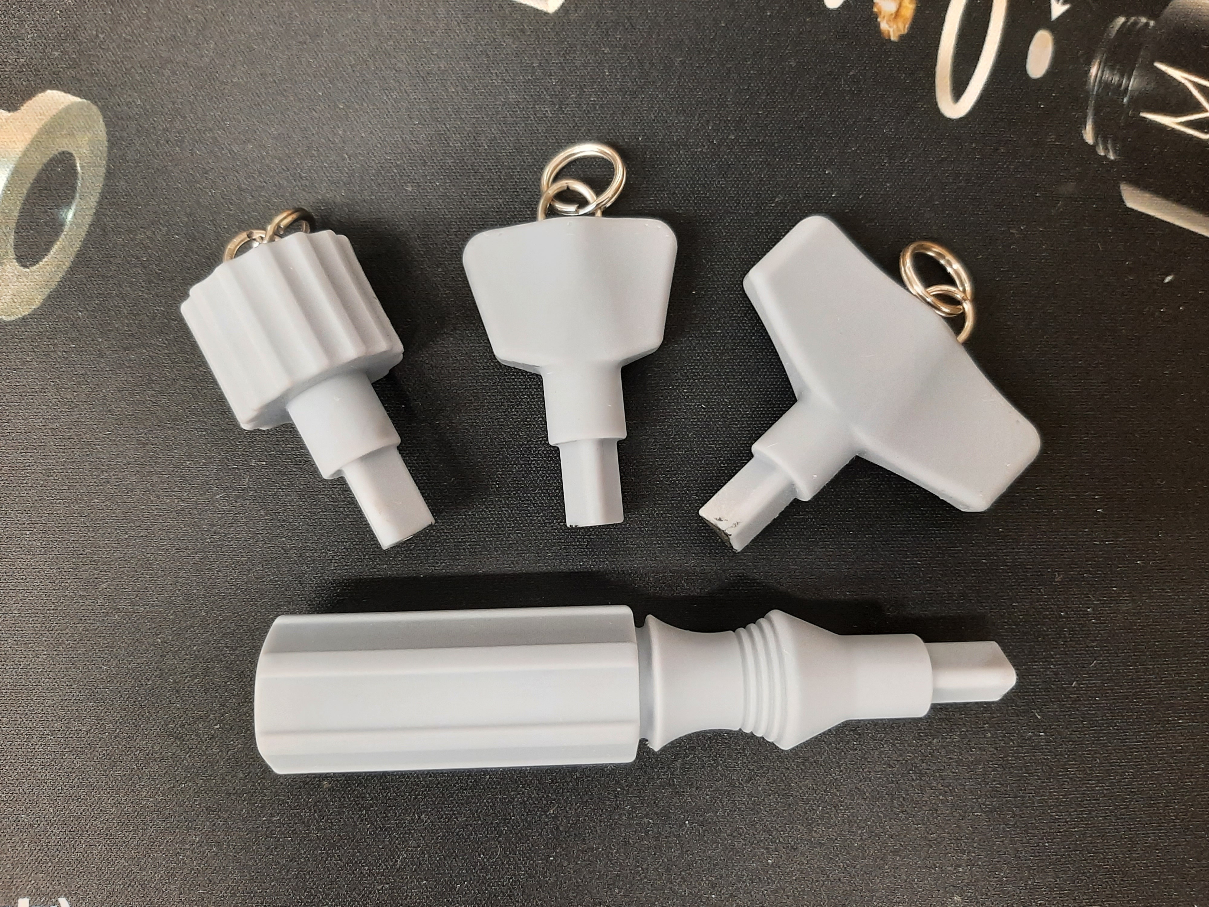

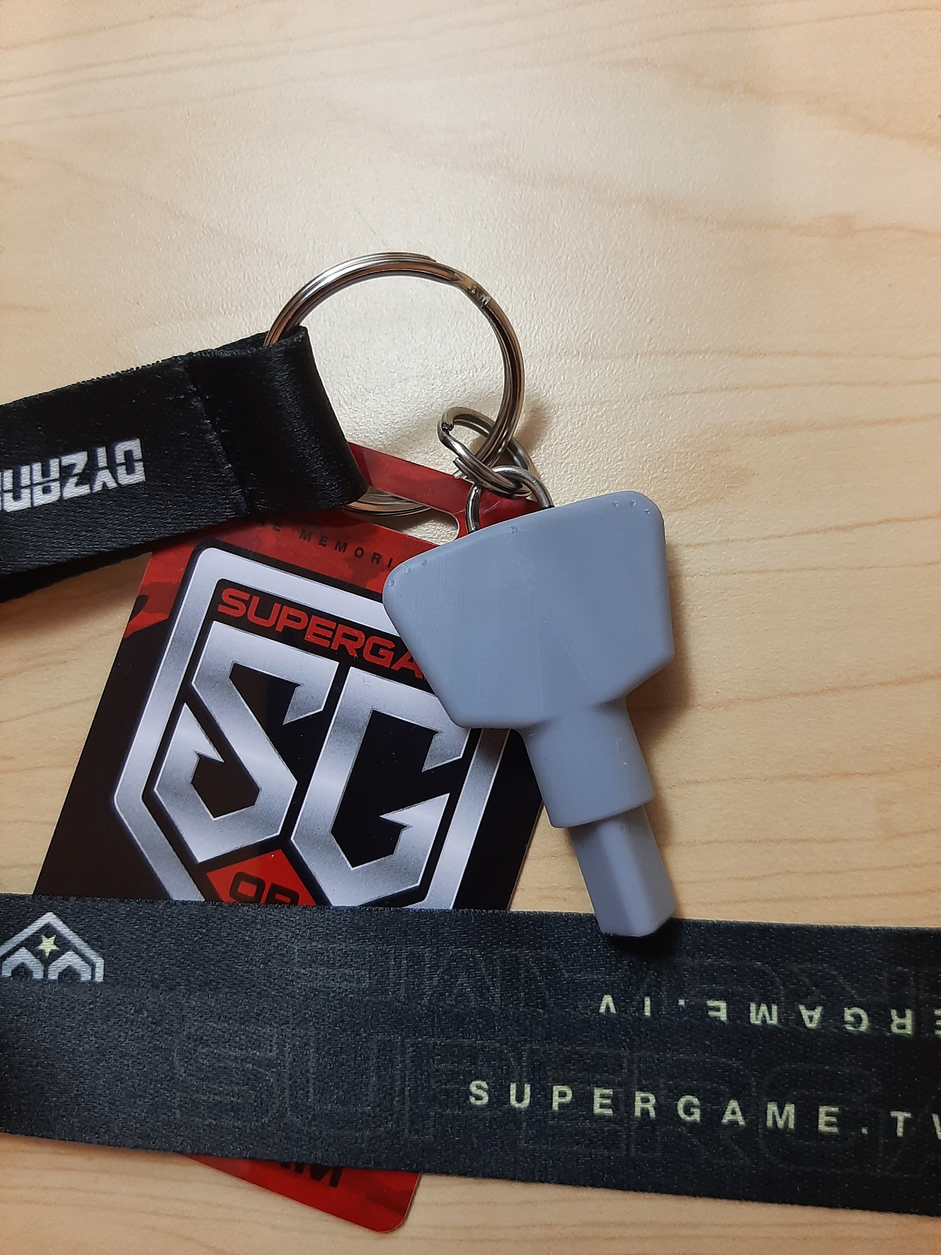

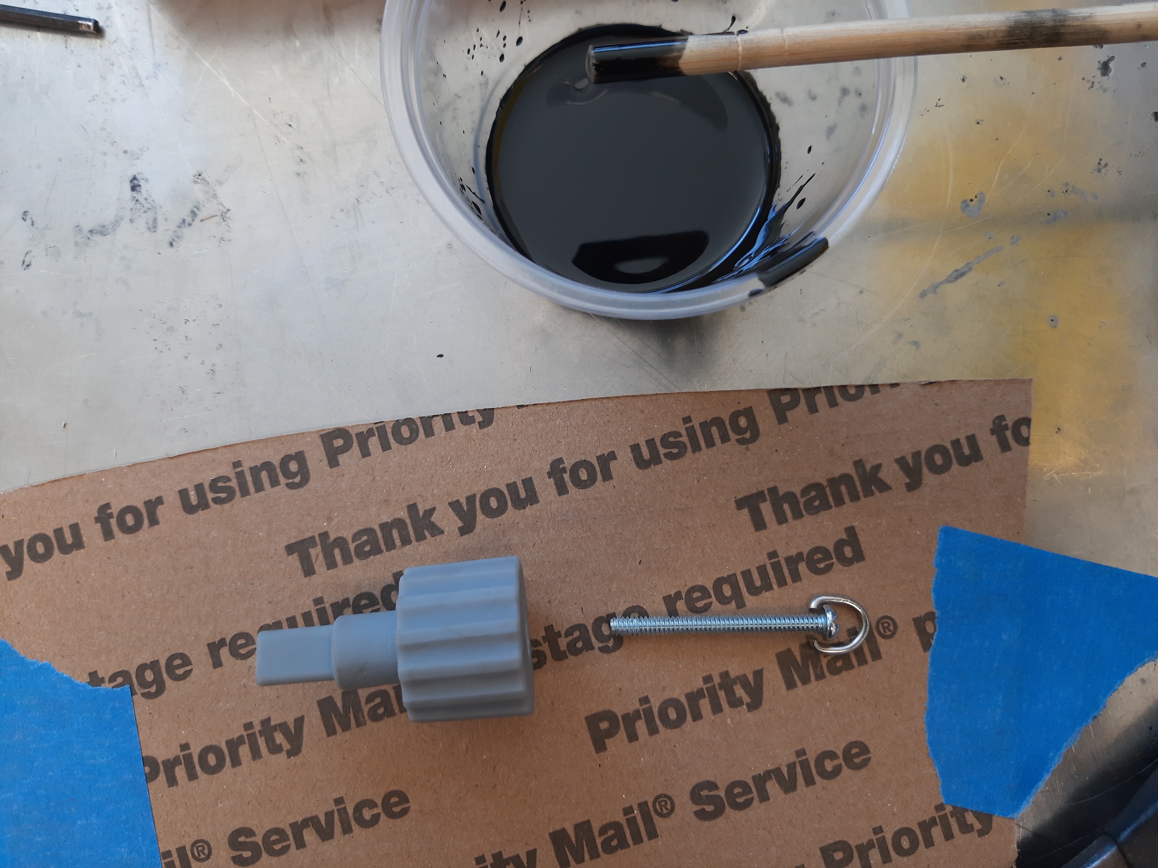

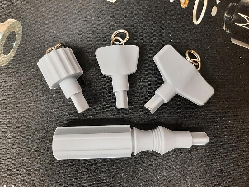

      Finished a couple more Q-Tools a while back. Because I can't make up my mind there are now 4 versions.
      Top row from left to right - Knob, Mini Key, and Key. At bottom is the "Driver" which is modeled on an old Craftsman screwdriver I use frequently. The Key style is proving particularly nice for pre-winding pods because it's easy to hang onto and count the turns. The Mini Key is nice and compact for bringing on the field.
      STL's for anyone who wants to print their own:
      Q-POD TOOLS.zip

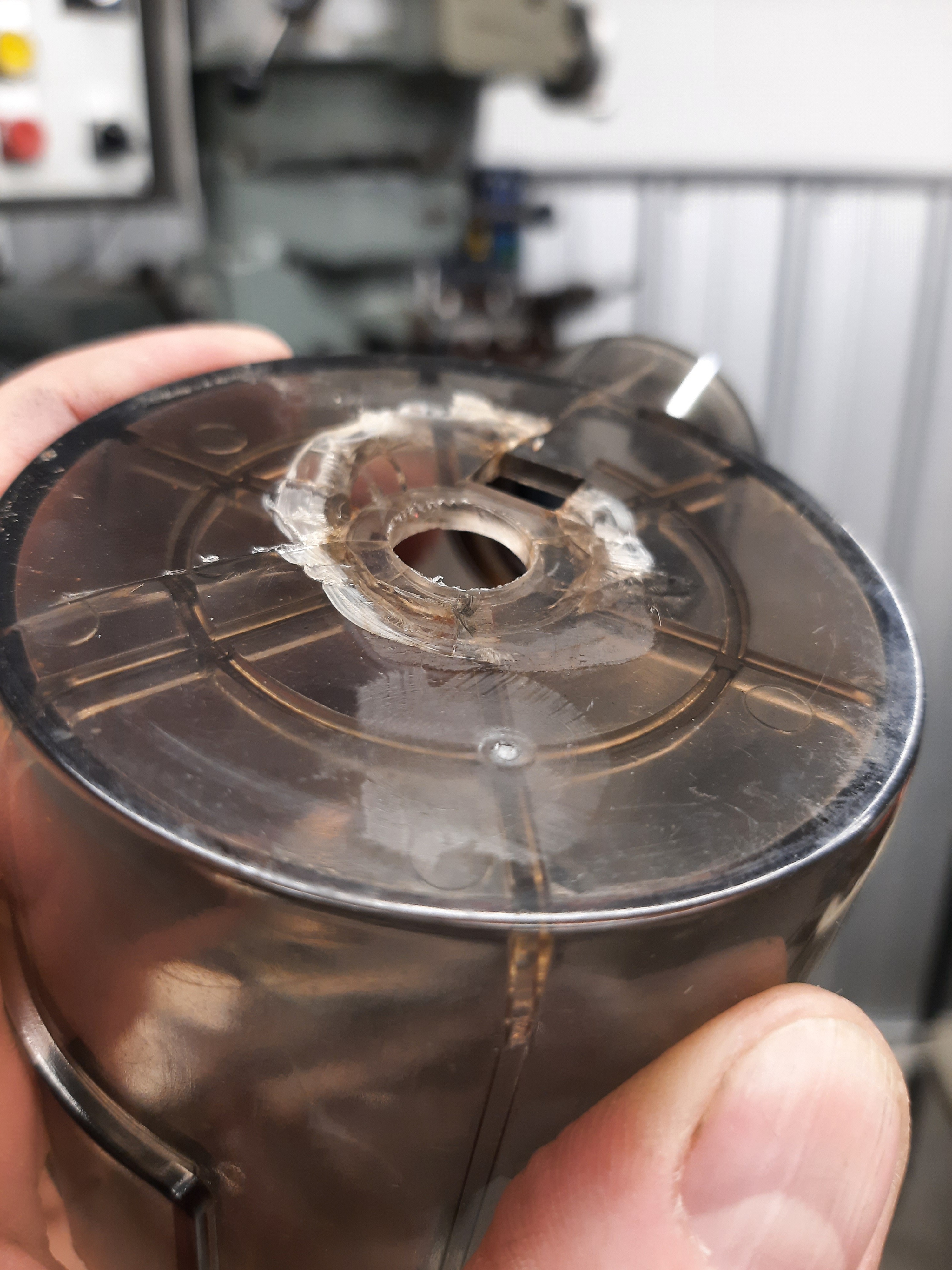

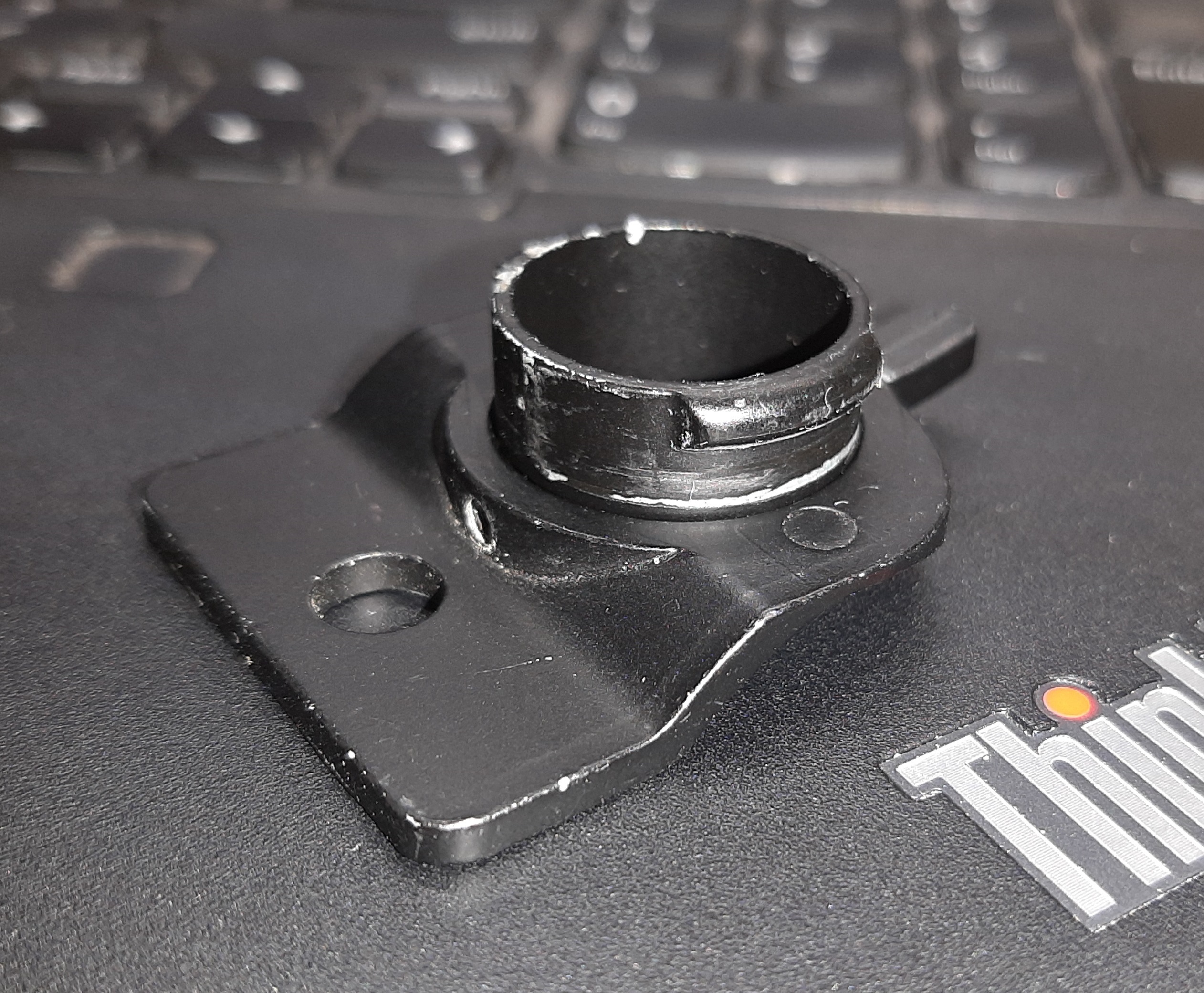

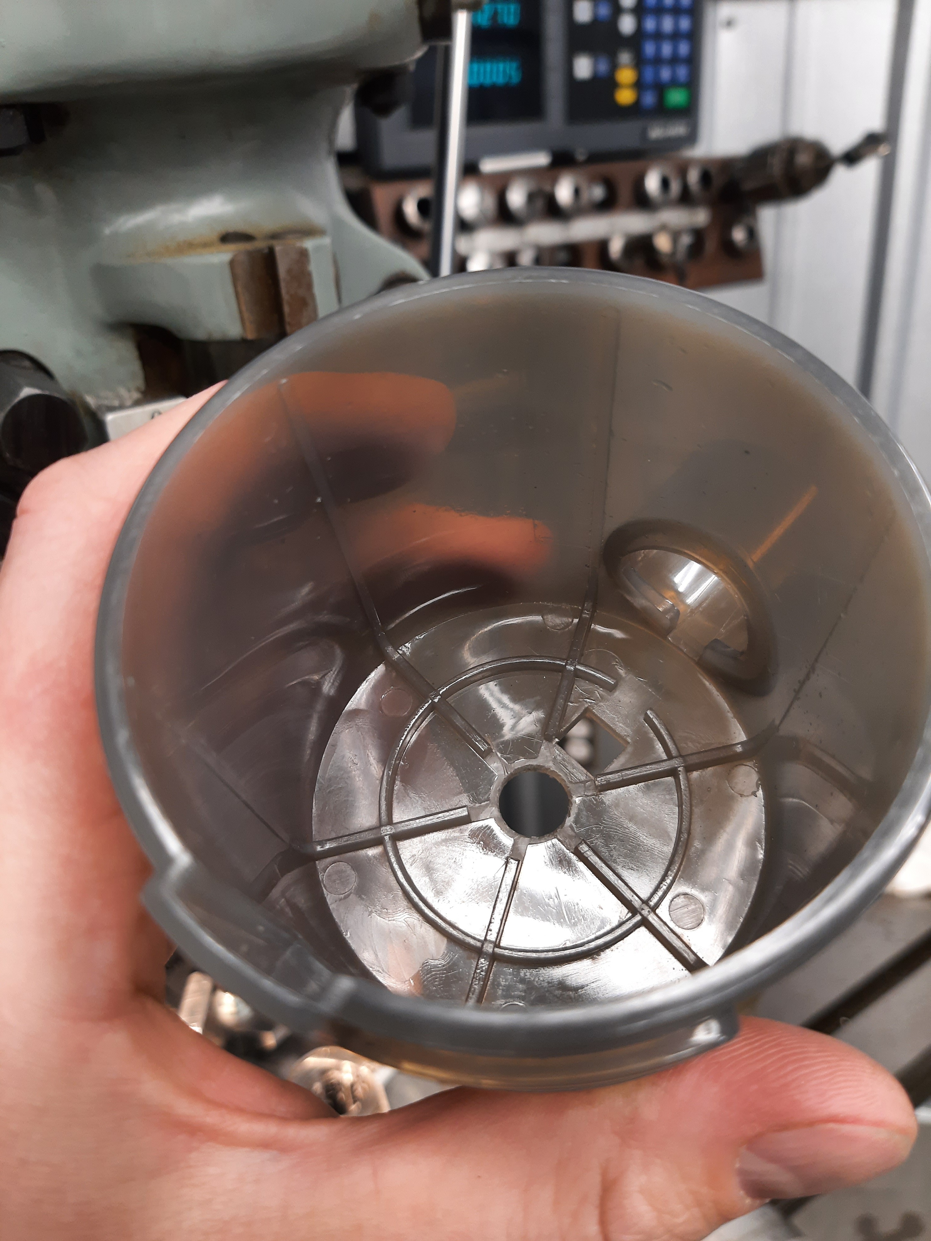

      Ok, this is cool...
      The Custom Mounting Sockets (CMS) are the preferred choice because you can clock the feed port to whatever angle you need. Way better than the standard socket. The downfall of the CMS is the way they are designed causes them to be prone to cracking. The root of the problem is that the body of the CMS is held to the mounting bracket by the metal center pin and this places all the stress at the center of the back wall of the socket body. This is where the cracks start and work out from there.
      A few months ago I was really looking closely at these and the other sockets in my stash when I realized something. The body of the CMS and the body of the loading sockets came out of the same mold. All the molded features were exactly the same, even the parting lines left from the mold matched exactly. The only difference between the two is the boss that holds the crank handle has been machined away to create the CMS body.
      Shown below: CMS left - loading socket right

        #36

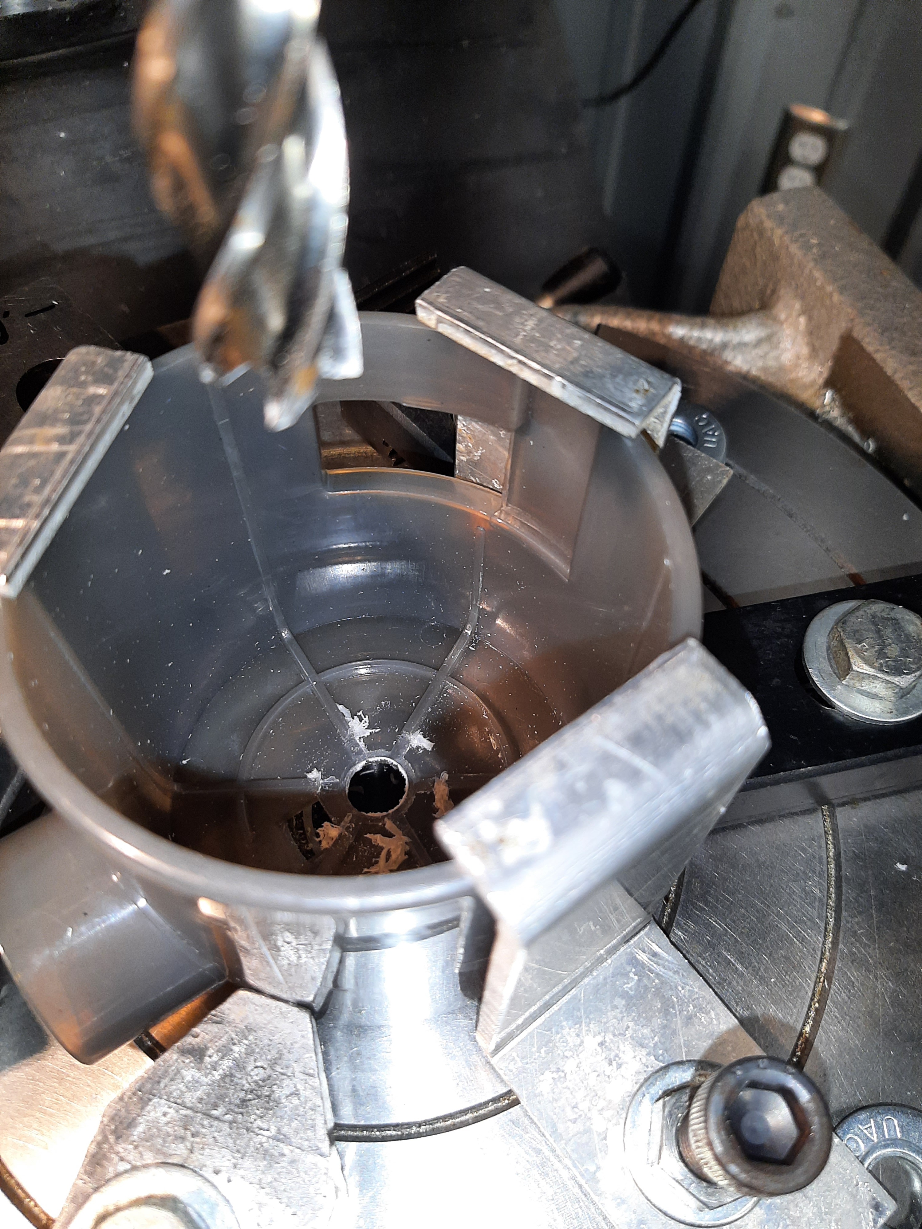

        I got to test this idea out today.
        That's about as close as it gets to a "like new" CMS these days. I would wager that there are more crack free loading sockets out there than the custom mounting sockets at this point. This could be a viable solution to keep the die-hard Qloader fans going. I'm really happy with how this turned out.
        FEEDBACK
        • JeeperCreeper
          JeeperCreeper commented
          I'd say you're right, as I have a good loading socket and a busted CMS
        • Levi
          Levi commented
          We just need to find some of those surviving loading sockets and we can bring the busted up CMS's back to life.

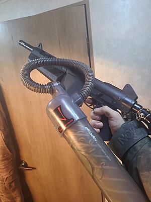

        Back 15 years ago I had qloader pushing 32 bps on a spyder shutter with spyder rocking e trigger with a custom board it came with eyes but I the acs antichop bolt did its job after 30 bps it would just uncock instead of chop paint. And I had a 40mm scepter grenade launcher. But fuck it blew valve Owings almost every time I shot it 🤣 ....then it all got stolen 😔
        • Levi
          Levi commented
          That's cooking! One of these days I'll slap one on the old RT Mag and see how quickly I can empty a pod.
        • JeeperCreeper
          I once used one on a virtue board Ion pushing about the same bps and man it sounded like a gattling gun

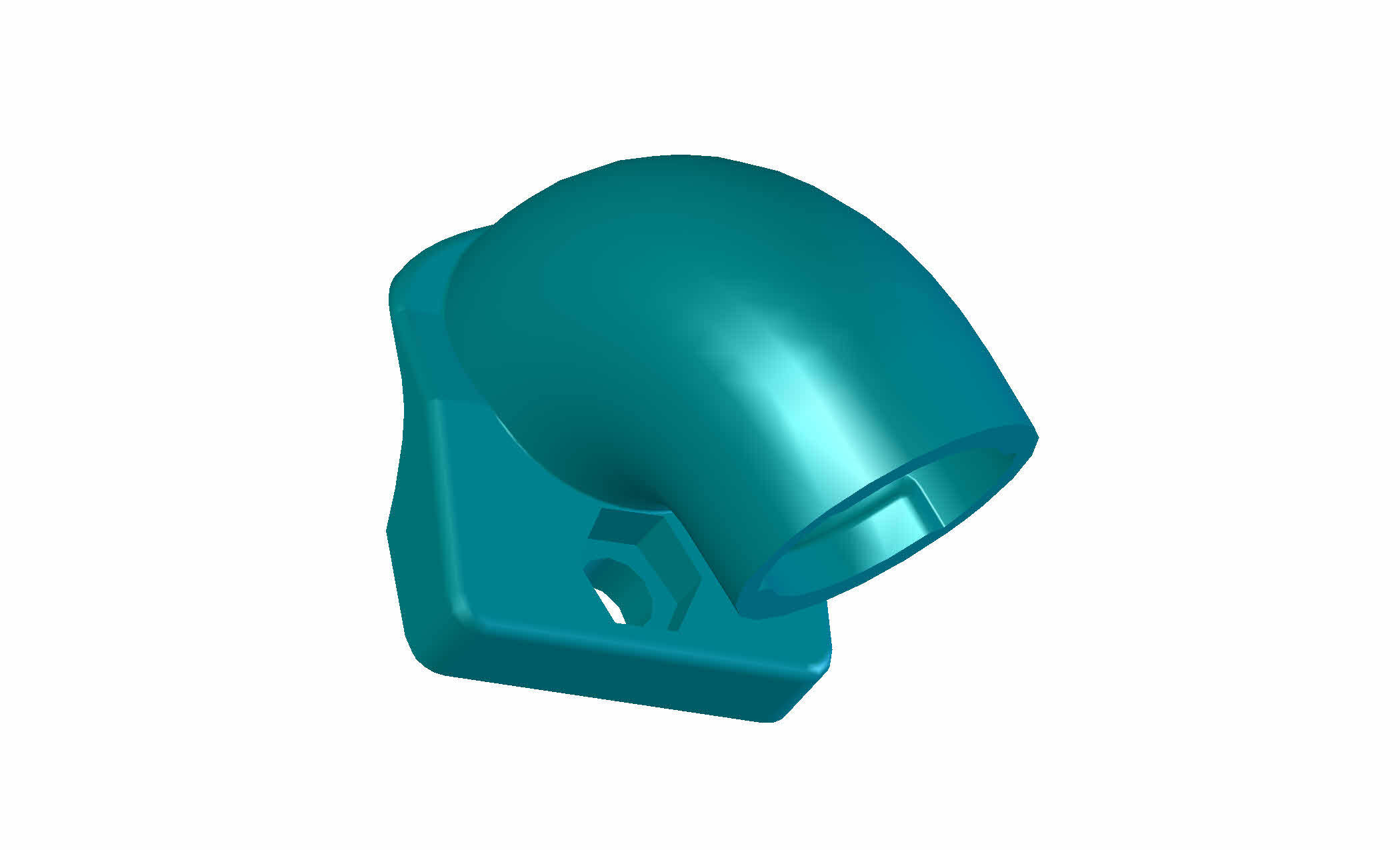

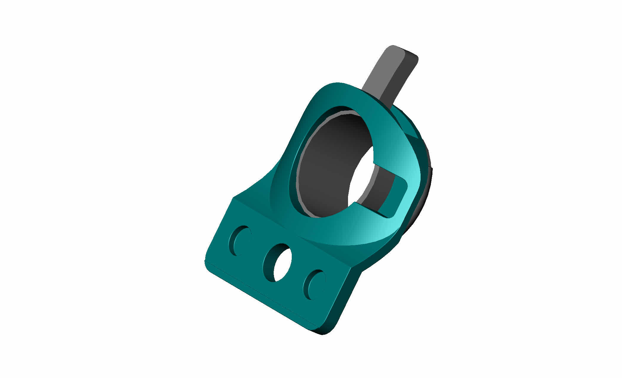

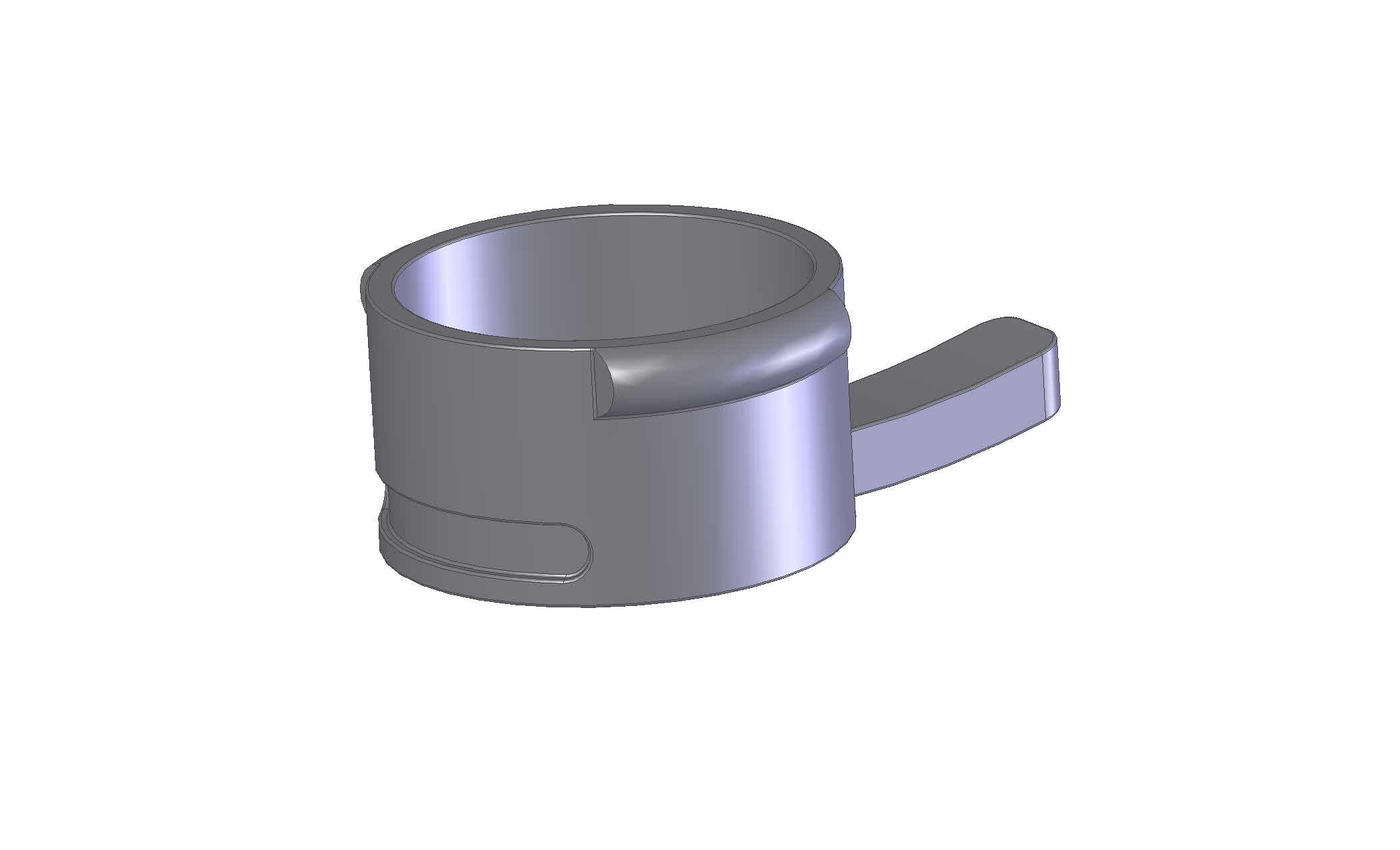

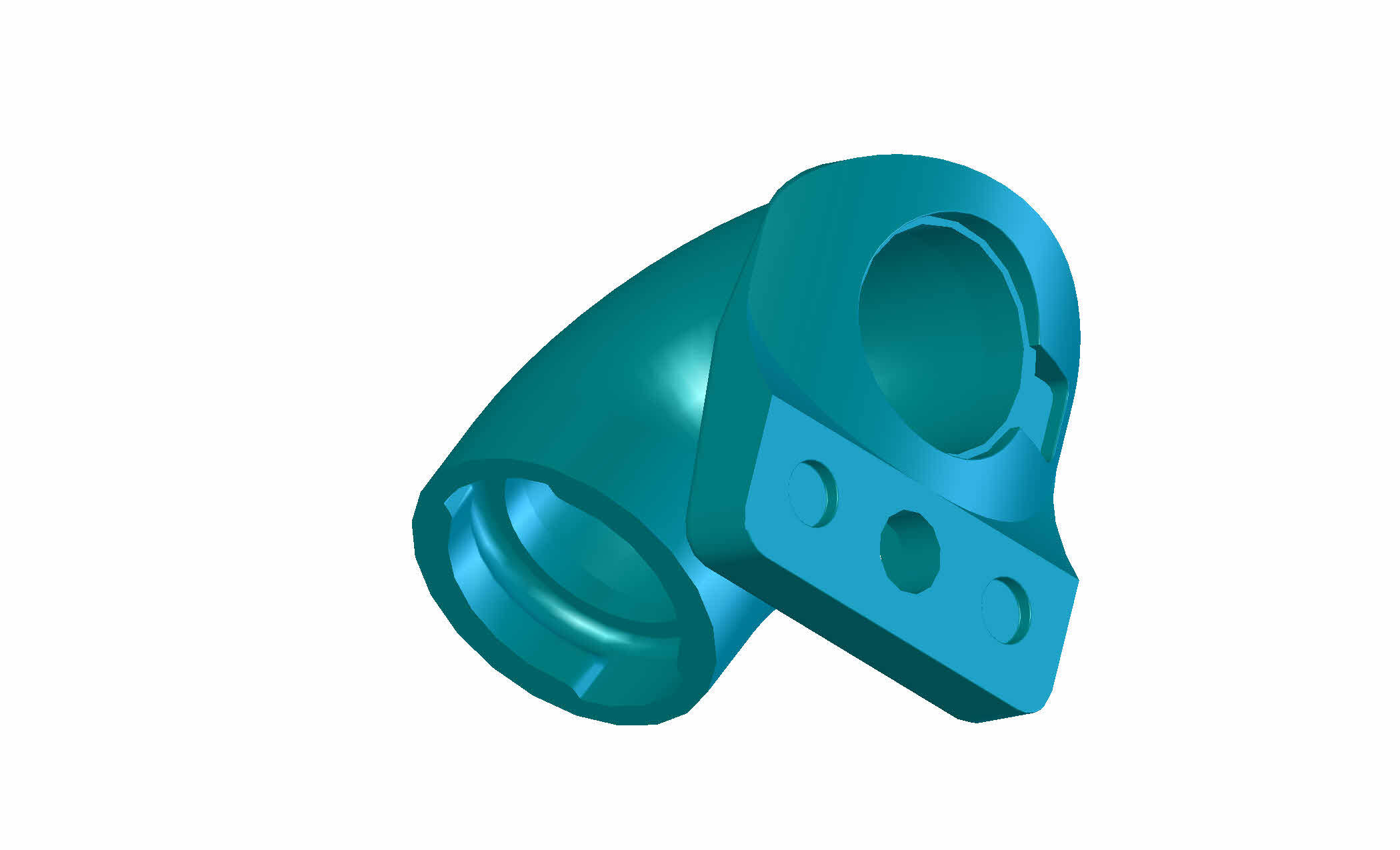

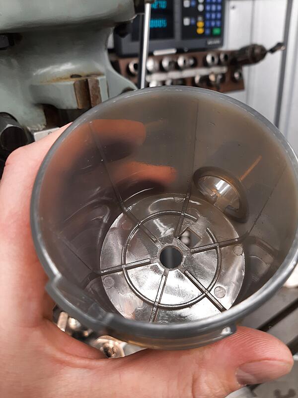

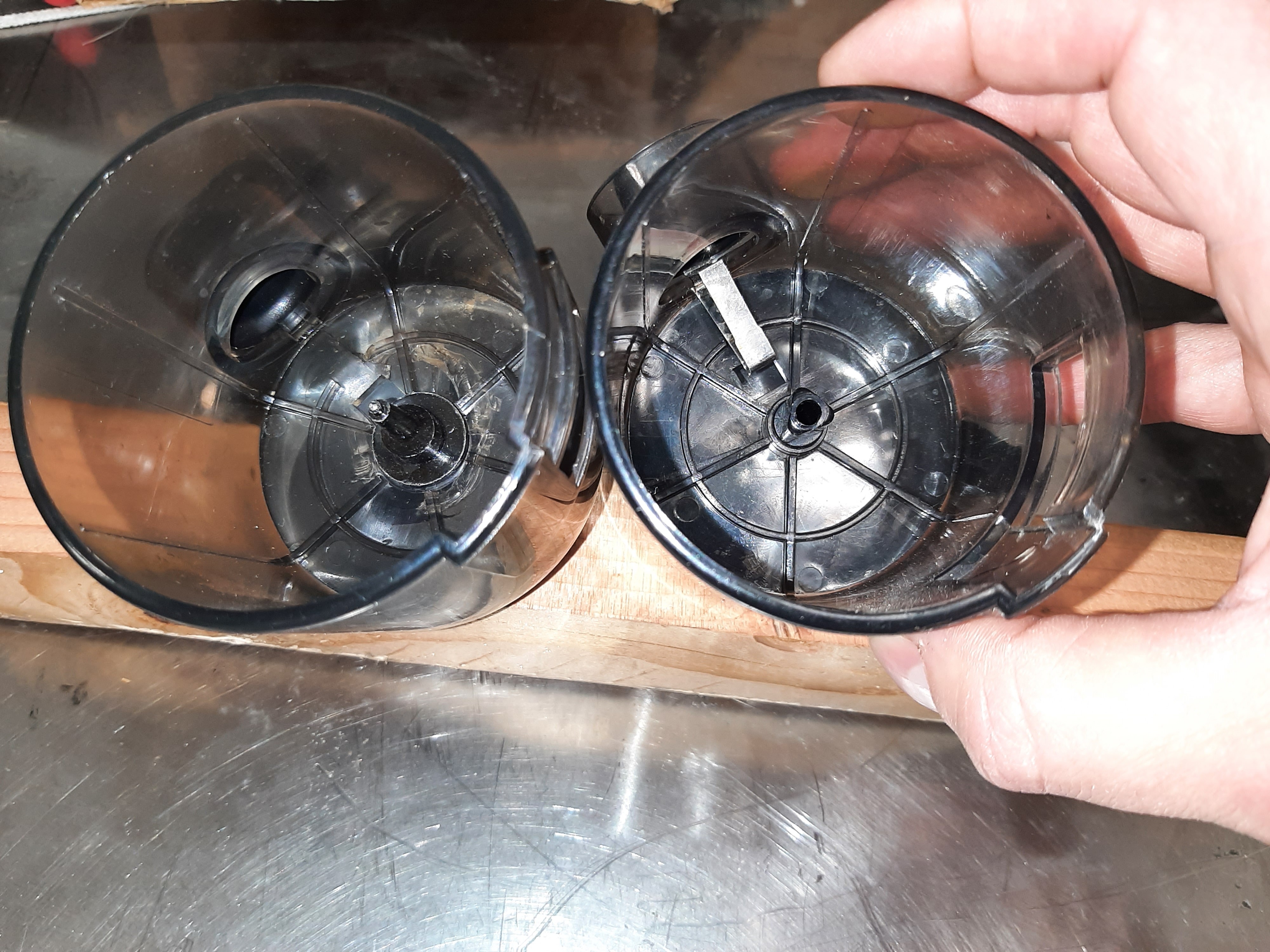

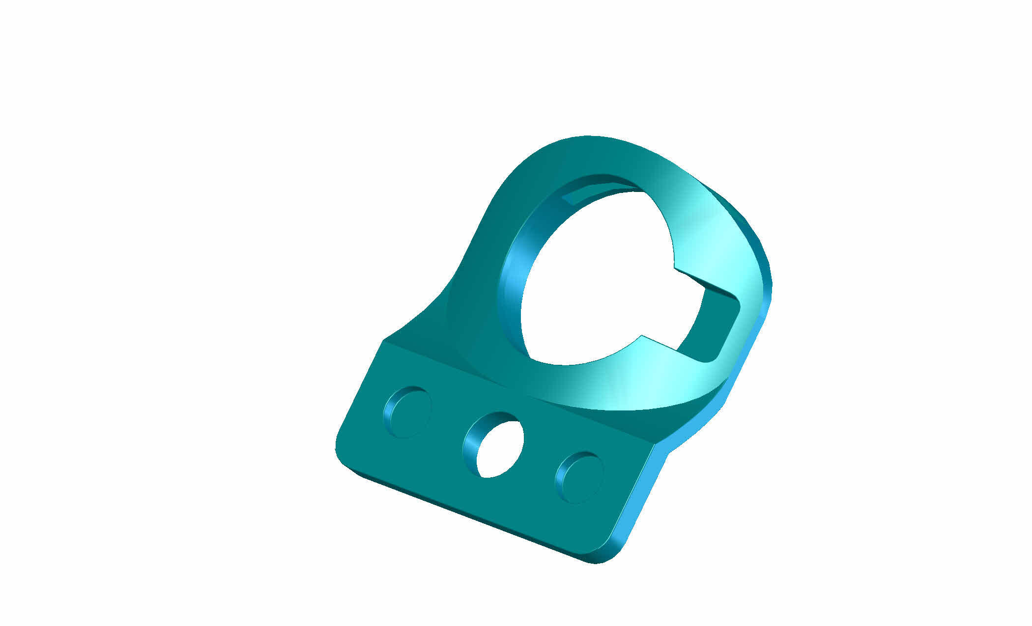

        Tippmann adapter!
        I got this in a box of stuff from a member here. It's going to be heading up the road to another member soon. But before I let it go, I wanted to create a 3D printable version to make available for all.
        Step one is to create a model of the parts as-is... I will modify from here to make it more friendly to being printed. The original parts look to be die-cast aluminum & the wall thickness is too thin to make a durable part when printed. I will probably integrate the elbow (not shown) into the "printer friendly" part so I can thicken it up in the appropriate areas.
        FEEDBACK
        • Levi
          • Feb 2023
          • 615

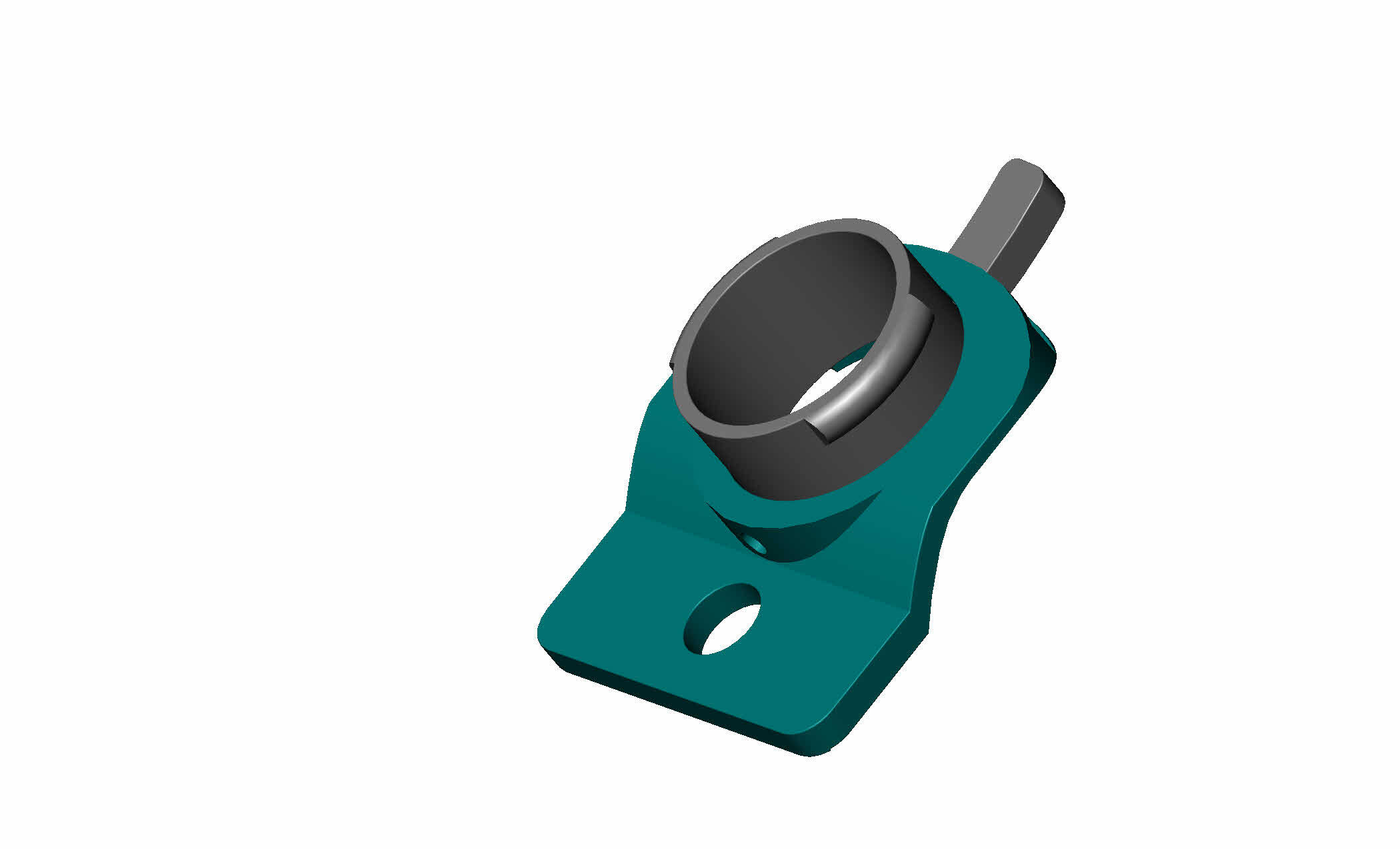

          #39
          I have a little cleanup to do still, but something about like this for a printable adapter might work.

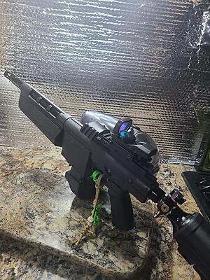

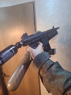

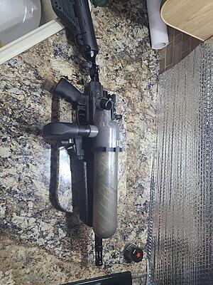

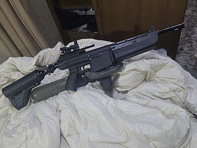

            #41
            I have tried 4 diffrent qloadsr set ups on my ats 85, one with it feeding into the hopper neck chain fed mag which obviously works the best and dosnt give me any chops, then I have the one with warped touristfeed I 3d printed with a zeta mag in it, but I see you said you do 10 winds and you looks like you have 2 90dagree angles on your setup but my balls in my qpod get stuck is they are any thing below 14 winds I tried a setup with no hose and just mounted directly into thr warped tourist feeder and seems to work okay but I'm not getting 20 bps , still get chops on 10 bps.
            I tried with halo b hopper and it works really well
            This gallery has 7 photos.

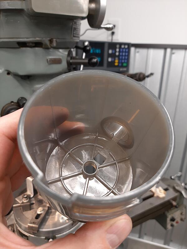

              Originally posted by _Boris_
              I'm really interested in getting a Qloader, posted WTB, but I don't have much hope seeing how these are pretty much unobtainium.
              I also checked patents ... two patents that hit on "qloader" or "q-loader" aren't relevant to the loader discussed here ... so I wander if this is in public domain now. BTW, unless you are making parts for sale, I don't believe that patent would prevent you from printing your own.
              I'm still fuzzy on how the extracted balls go from hopper into linear order (tube) I can see that rotary strips them, then the snail pattern in the receptacle makes them lined up into a line, but that doesn't make great sense when I am modeled a prototype.
              Would anyone be open to loan one to me for modeling? I can put up cash as assurance or meet you if you are close to Boston area?
              Hi Boris!
              If RAZRBAKK doesn't have one for you, I probably have enough extra stuff to set you up, or at least get really close. I have seen a couple pop up on eBay within the last year, so they're still out there but not common. I think every so often a former paintballer cleans out their closet and these pop up.
              Patent wise, anything that was there is most likely expired. These first hit the market 20+ years ago. Even if you did make and sell some parts I wouldn't expect any trouble.

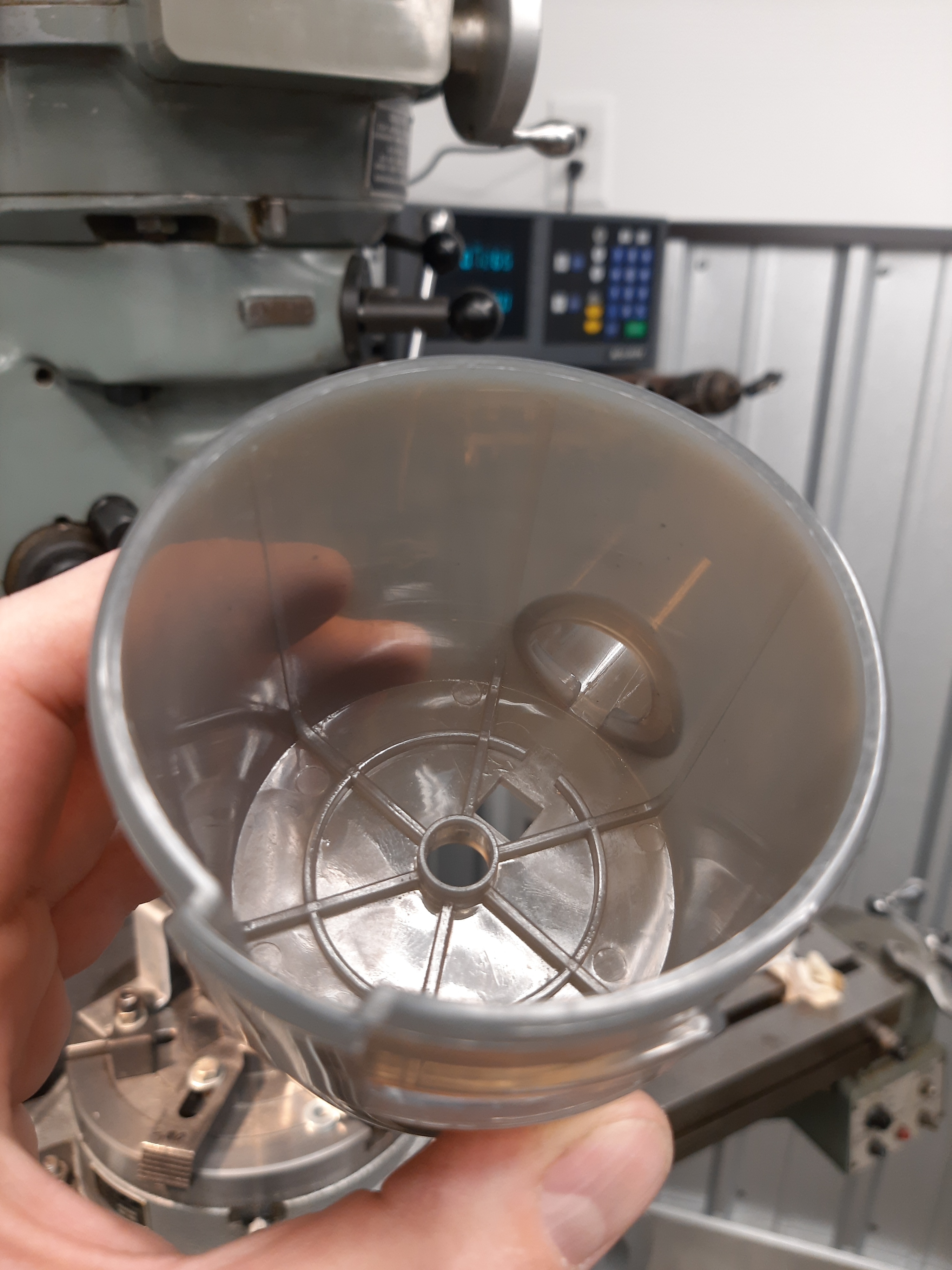

              The Q-Pods are a really ingenious design. The balls are not all in one line that is wrapped around into a coil. There are 6 "stacks" of balls in the pod that wrap around the center axis to form a helix. Picture the DNA double helix, but it's 6 instead of 2. Now look at the screw that runs down the center of the pods... this screw stays stationary and the six helically wrapped stacks rotate around the stationary screw and are driven toward the end of the pod. The stacks are timed so they present their next ball at the correct elevation by the time the stack comes around to the outlet port. So one complete revolution gives you six balls. The rotor piece rotates with the stacks of balls, so each stack has its own dedicated paddle on that rotor. This rotor strips the ball off the stack at the outlet port and imparts the driving force to the balls in your feed tube.
              Printing a functional and durable pod might be difficult, but the sockets and accessories are definitely doable. Would be cool to have another Q-Loader tinkerer in here. I look forward to seeing what you come up with. And welcome to MCB!
