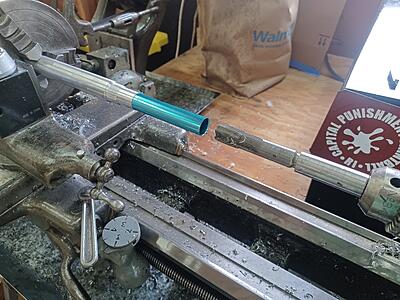

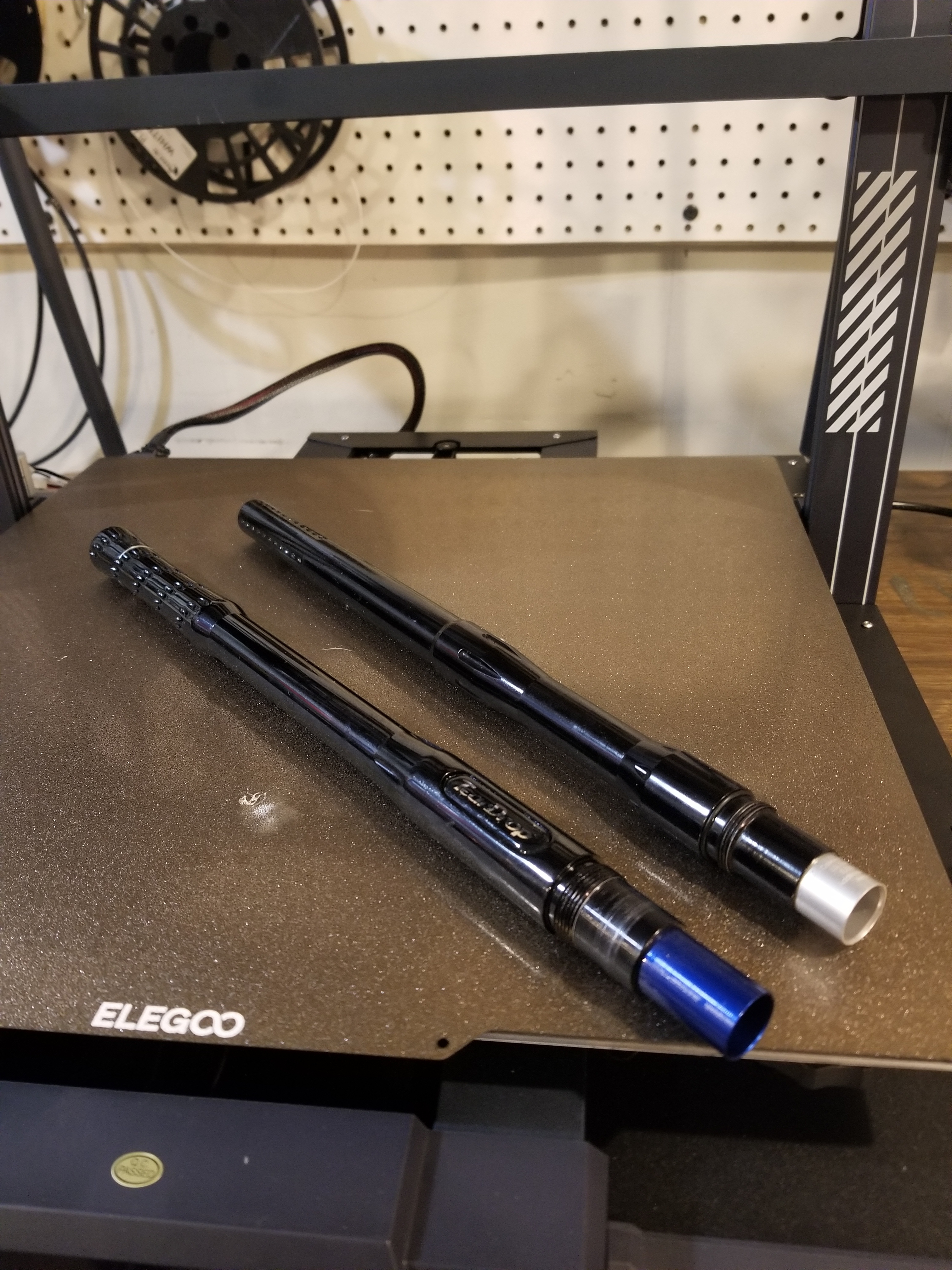

    This is game changing for my cheaper pumps that I dont want to buy a $100 freak barrel for! Click image for larger version

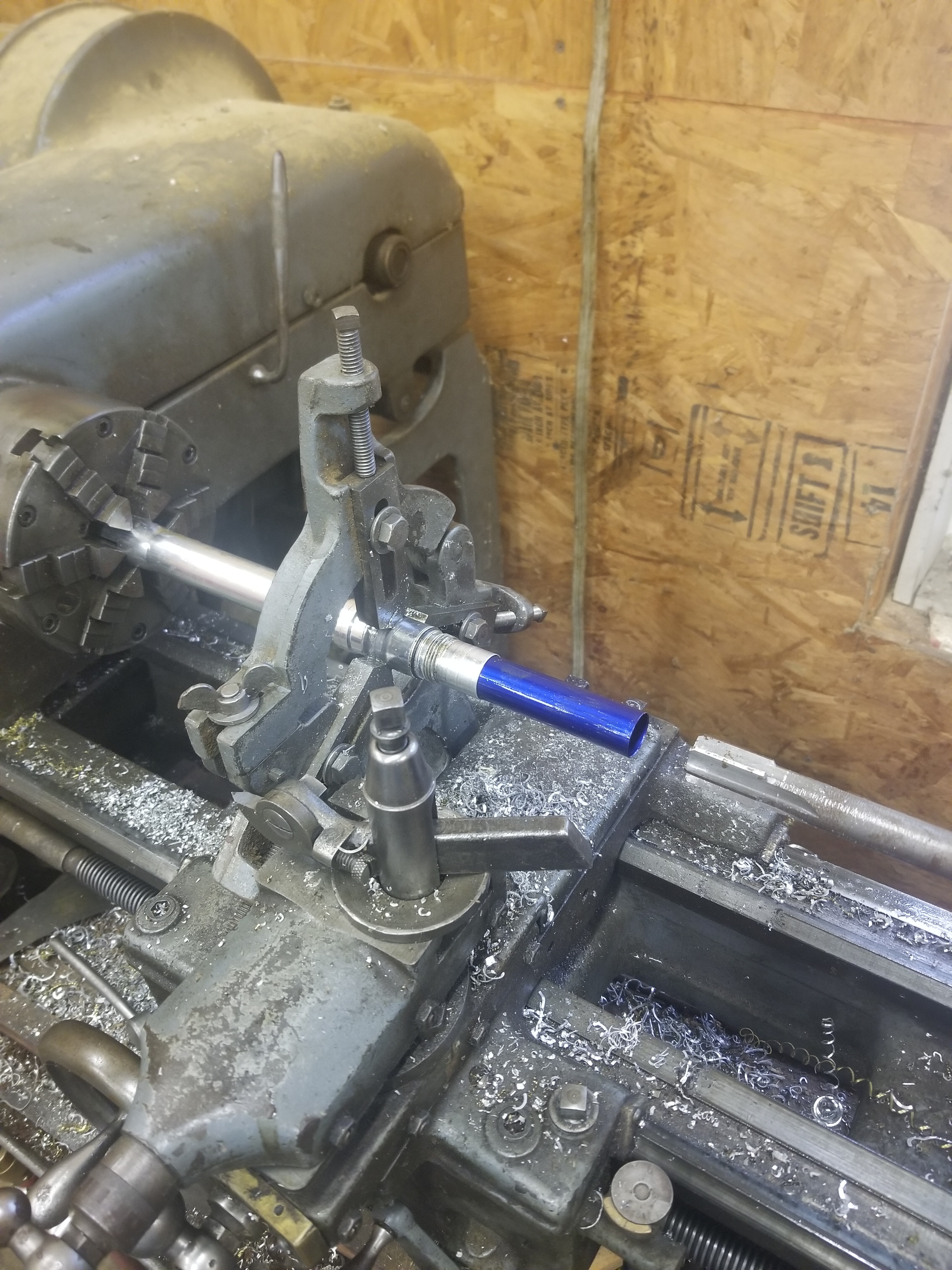

          If your spindle bore is big enough to slip the barrel through it'll be a cake walk. Mine is just barely too small, so I have to use a steady rest, kinda a pain.

              Dam, i didnt thought you could get away with a steady rest ...
              2questions 😁
              - How do you not scratch the crap out of the parts with the rest? Ive had really bad results every time i use mine ...
              - Did you make the reamer or did you bought it? what size are you using?

                Lathe dependent, you get get fingers for your stead rest that have bearings instead of solid bronze

              XEMON I screwed up one barrel buy melting it with friction where it touched the rest. Then I put thick gear lube on the fingers of the steady rest. Reapplied 3 times or so whenever it looked dry. That worked out great
              For the reamer I used an chinese 18.8 mm. Absolutely perfect fit. Here is the link on ebay.

              So i ordered the exact same reamer from the ebay link. There seems to be some variation in accuracy because my 18.8mm reamer is cutting a 0.738" hole. Just a tad too small for freaks which measure around 0.740". I had to finish up with my trusty old boring bar
              Not saying this technique doesnt work, just saying that you cant expect all that much accuracy from a $20 reamer. Your experience may be different
