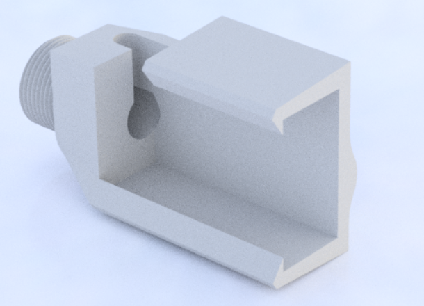

        Solenoid bracket, rough draft. Printing now...

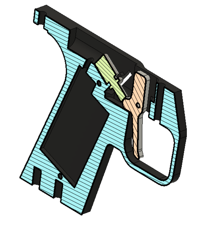

                Working on the grip frame:

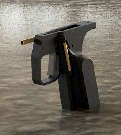

                  Well, let's go an ugly direction. It's supposed to be Poo after all.

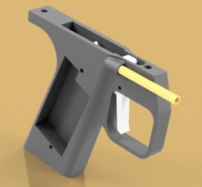

                  So the RM board just baaarely fits into the grip frame I made. There's not enough room in there for the 9v battery as well. So I thought of a couple options.
                  Mount a battery box on the sight rail
                  Make some kind of foregrip for the battery
                  Or just screw it, I'll make a fat chunky grip thing and stick it in there.
                  I went for the last option, and here it is. The top of the battery area is kinda doubling as a thumb rest, which is neat. But it's definitely not pretty. The brass tubes are going to be for routing wires.
                    XEMON
                    commented
                    I kinda like the look of the battery on the side of the frame ... Looks like a the rest ...
                  • RuleOfSines
                    RuleOfSines
                    commented
                    Really doesn't look bad, that battery hump doesn't seem any more aggressive than a set of match grips
