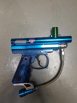

    This Spyder ("The Mouse") will be my entry for the POP contest. I plan on doing a spump where I will make a custom trigger frame and pump kit by hand and plan on half blocking and splash anno on the body. Thank you for the creation of the contest!

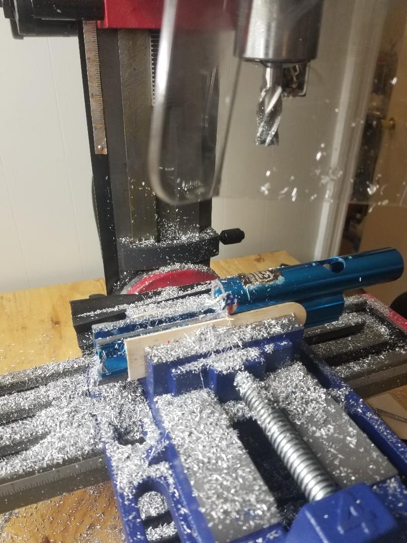

          Half blocked the body:

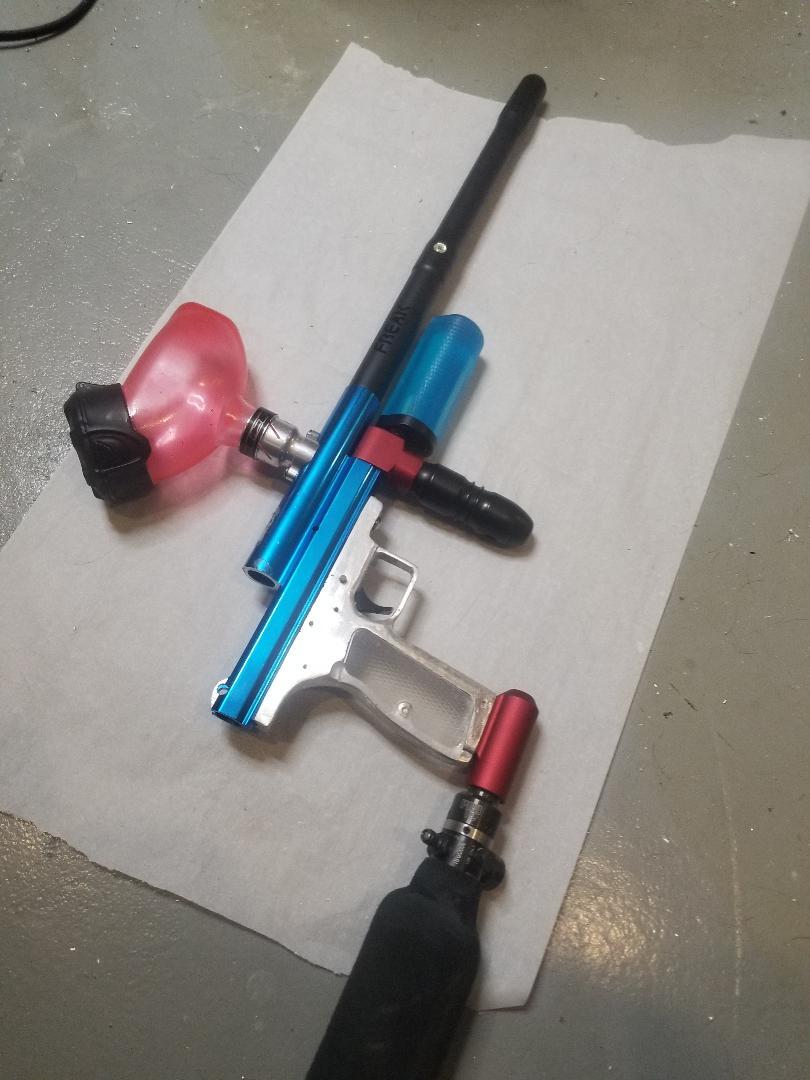

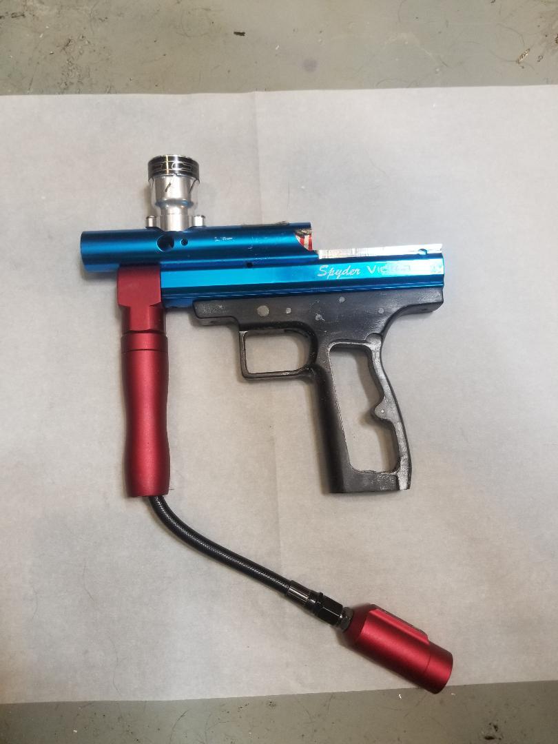

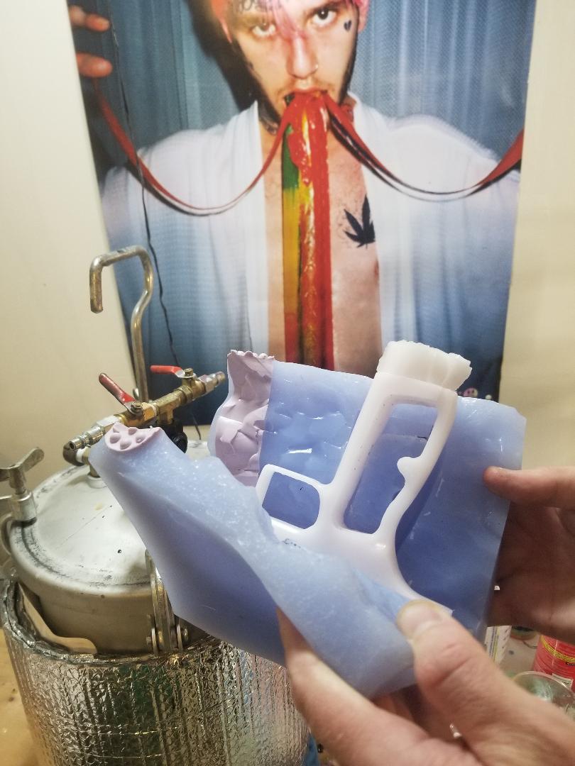

          Mock up of the build. Added a few parts into the mix, all of which I already had in my spyder parts box (ccm feedneck, vasa, forgrip, asa.) Frame I designed. it was kit bashed from a ccm 86 and standard spyder frame. I then made a mold of the frame pattern to which I pressure cast a homemade machinable wax mixture.
          Click image for larger version  Name:	pop spyder moc up.jpg Views:	0 Size:	69.8 KB ID:	51299

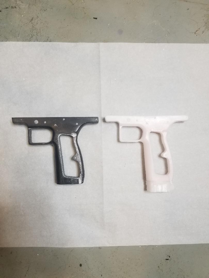

          Here is the Wax clone of the 86 spyder frame which I will do an investment casting of in aluminum or brass hopefully this week if I can find the time...
          Click image for larger version  Name:	pop frame.jpg Views:	0 Size:	57.4 KB ID:	51300
          Mold of frame and wax casting:
          Click image for larger version  Name:	pop frame mold.jpg Views:	0 Size:	97.7 KB ID:	51301

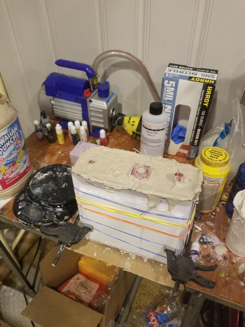

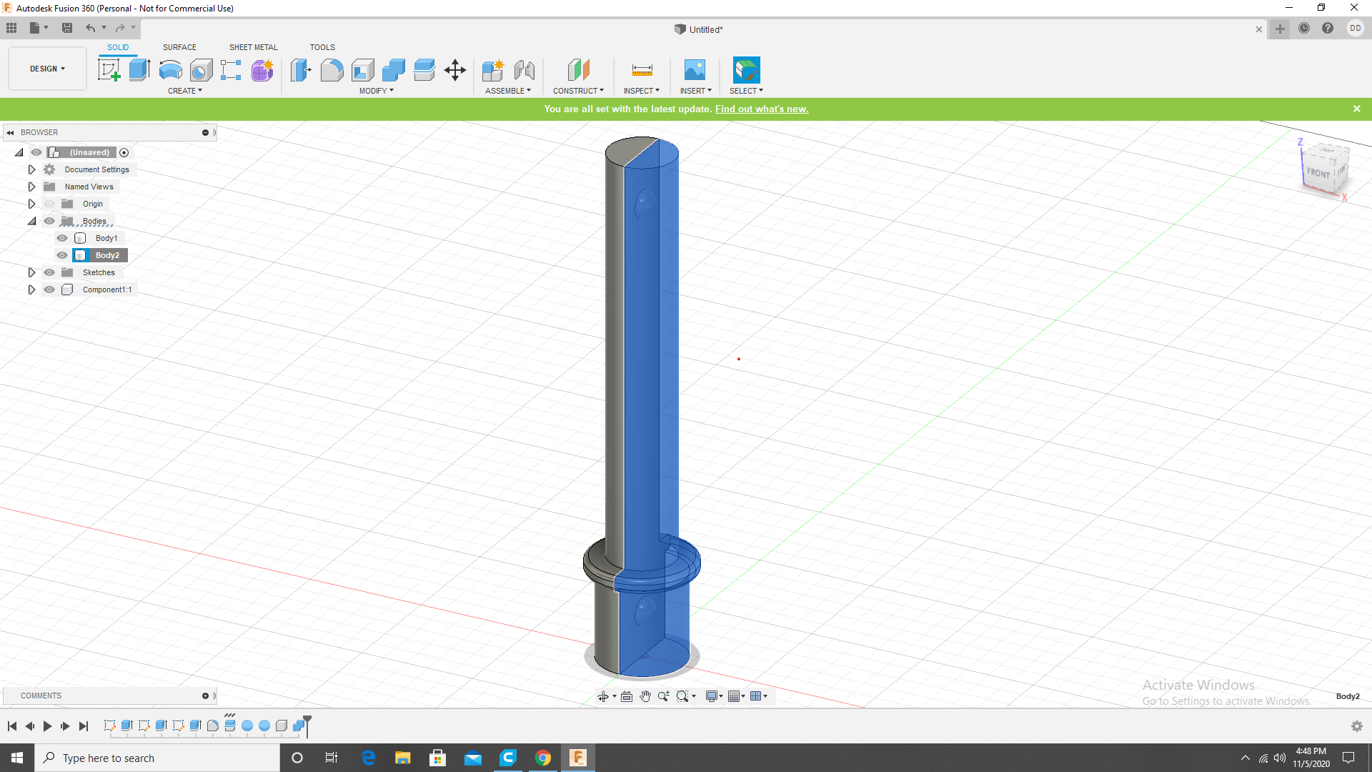

            Tonight I made a plaster silica investment mold of the frame, hoping to cast it this weekend. I also modeled a pump arm that I will sand cast the rough shape and then machine it down and add threading. I am currently printing the pump arm in two halfs with key locks in the middle to make casting easier. Today I also purchased a spyder threaded freak barrel on facebook which I plan on anodizing to match the rest of the build. Total spent ATM $30 (freak barrel)
