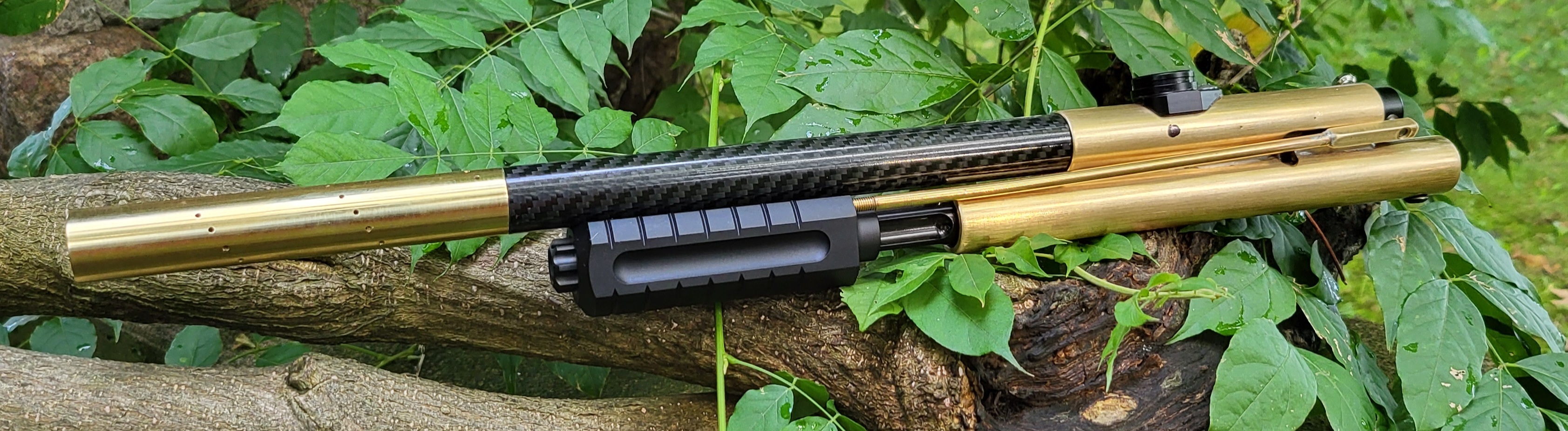

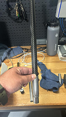

    Amazon 19mm ID 22mm OD cf tube, turned down carmatech nemesis epoxied inside, and made an aluminum back for it all to slip in nicely.. the back isn’t glued into place yet, need to get it anodized first. I made three more backs for more CF sleeved barrels.

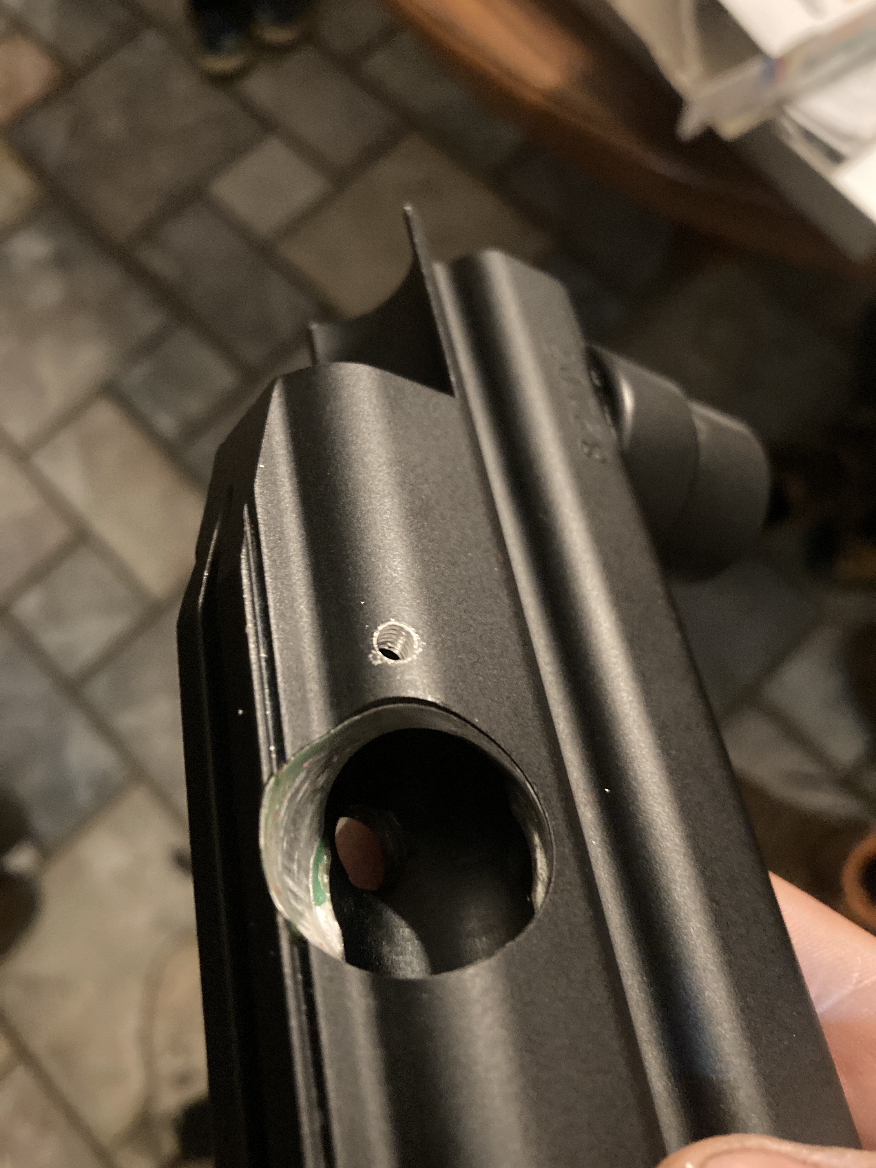

      Bored out a Milsig breech to so end user could use larger diameter barrels (like the nemesis), also faced off the end and chamfered so it isn’t sharp

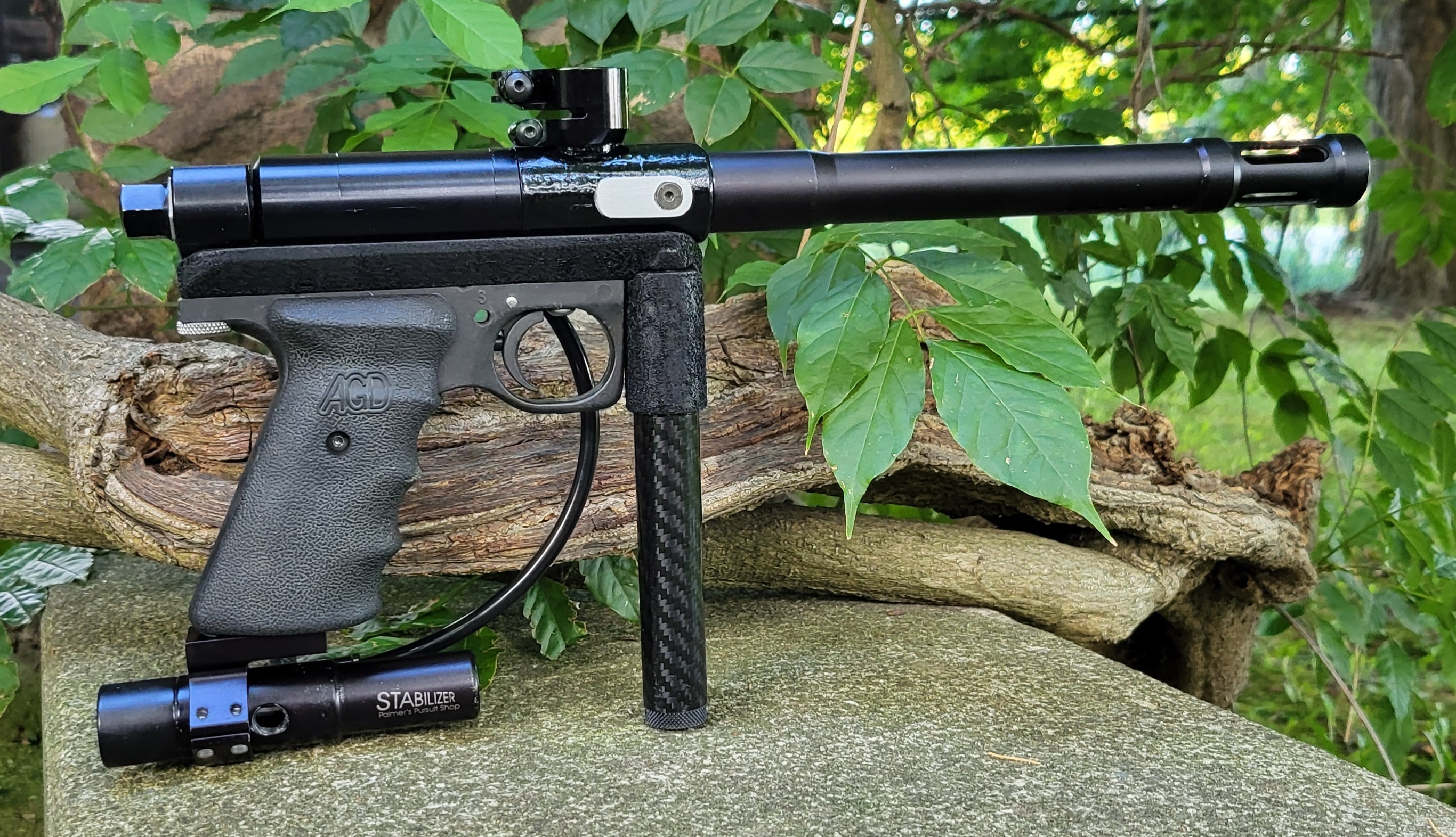

        Carbon fiber foregrip for my AutoIon... why should Mag guys get all the cool stuff?
        Click image for larger version  Name:	20240807_194644.jpg Views:	3 Size:	1.48 MB ID:	576232
        I need to re-spring the Stab for LP operation yet but I think I'm going to run it like this.
          Alexndl commented
          The ultimate evolution of the AutoIon!
          Jordan commented
          I figured I'd go for as light as possible.... it'll give me a break from all the brass stuff once in a while.

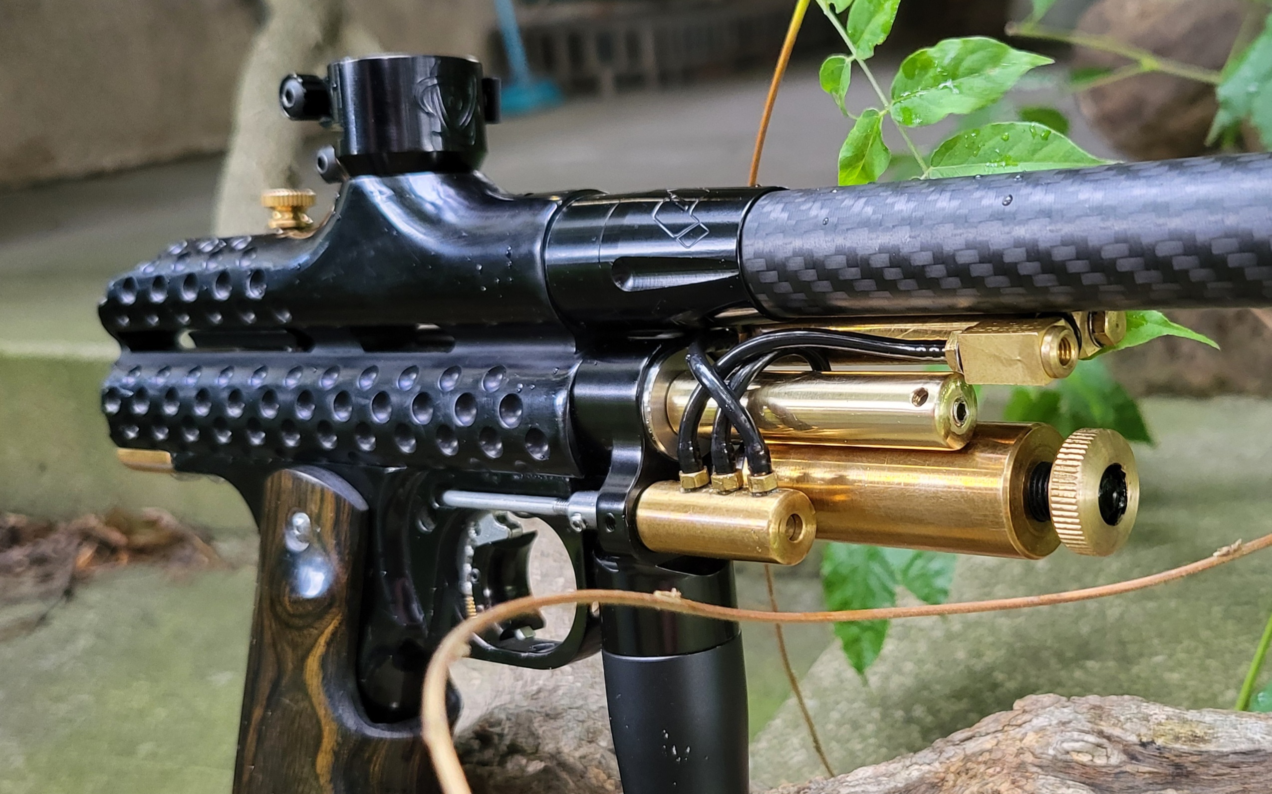

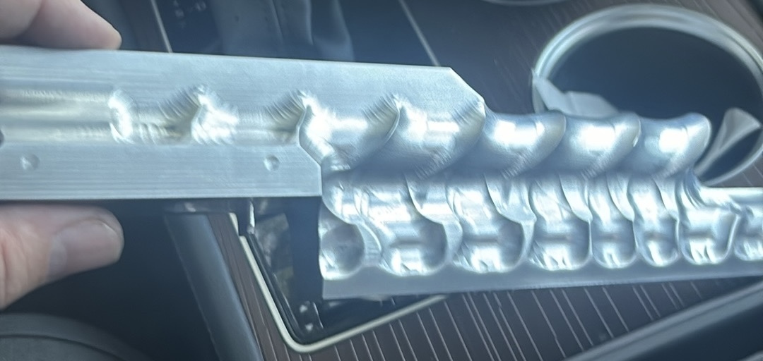

          Did some more work on my custom mongrel pump build... finished off the barrel, mounted the feedneck block, cut the feedhole.
          Still need to drill/tap for a detent, create a barrel retaining setup of some kind, and verify operation. I'm hoping to have it completed for a pump day in two weeks... I should have most of the parts I need next weekend and the rest will show up from PPS eventually.

          • Cal440
            Cal440 commented
            Really like the look of the cf and the brass,and that pump handle. Who makes that pump handle?
            Jordan commented
            Cal440 - it's a Meteor pump kit off their new pump.

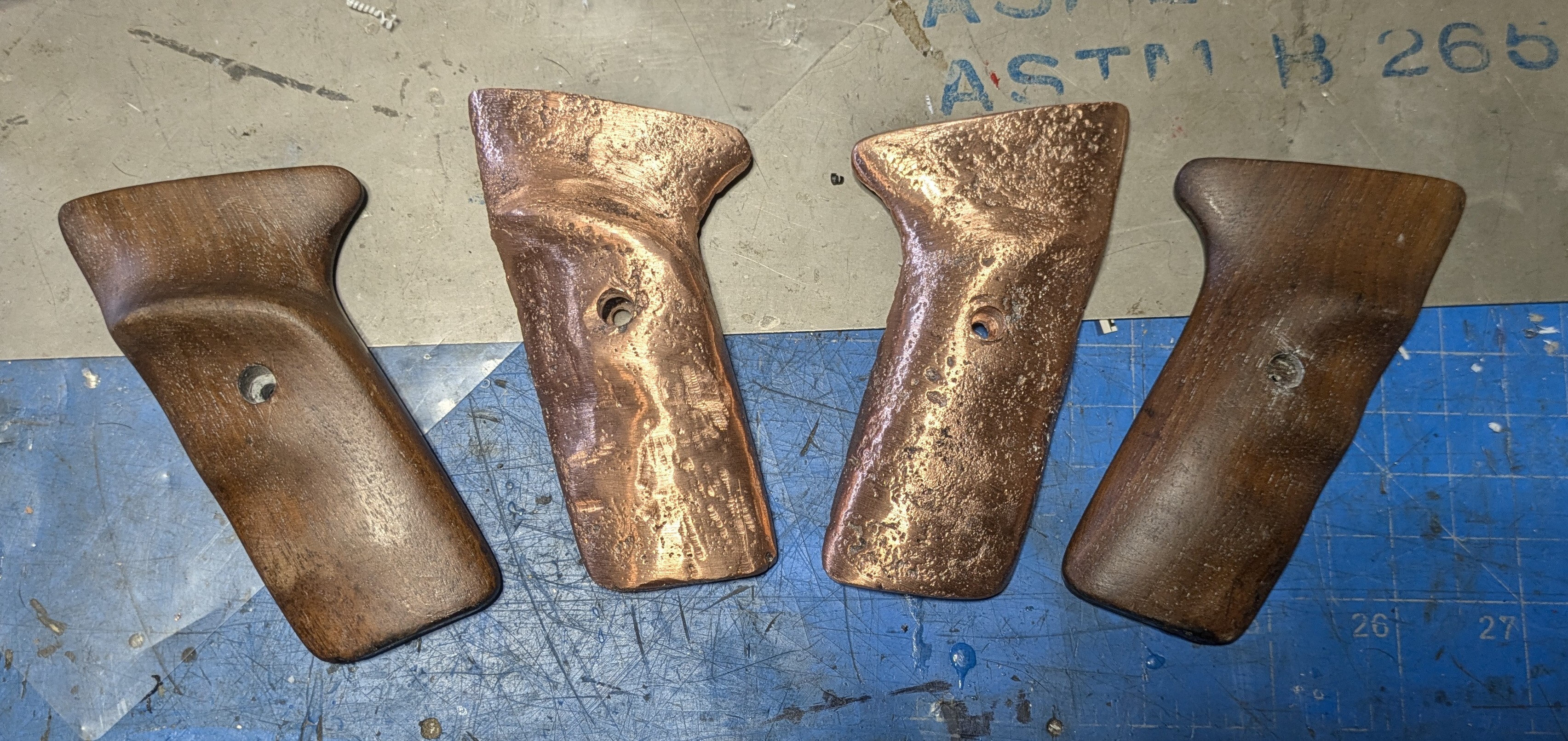

          Tested a new idea to locate the screw holes in the mold and it worked great. I need a few little clearance grind on the back side and they will be ready to find their permanent home 😁
          • JeeperCreeper
            JeeperCreeper commented
            Will you be making more of these in the future?
            XEMON commented
            Maybe, I could be convinced ... copper casting is pure gambling 😅

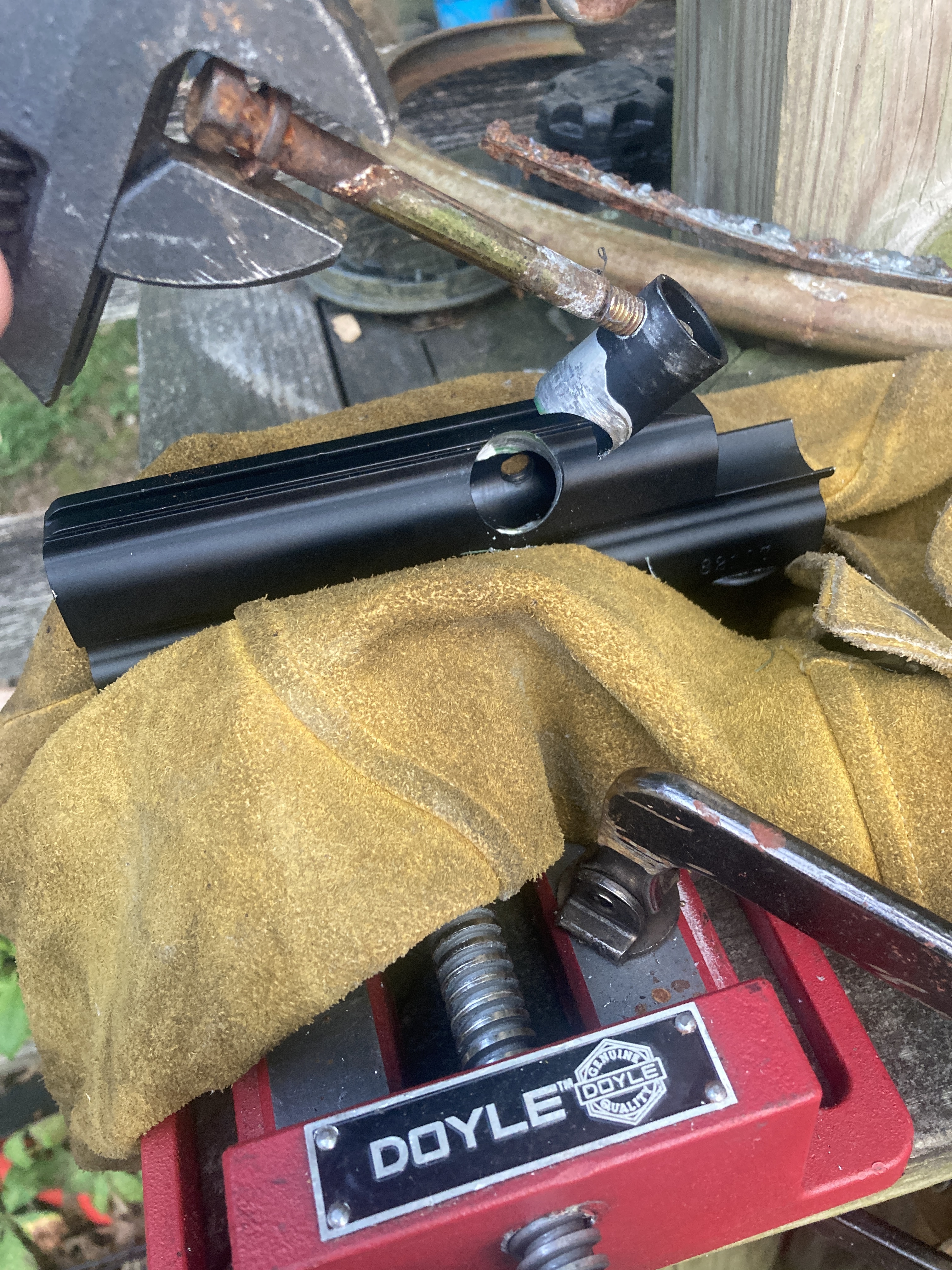

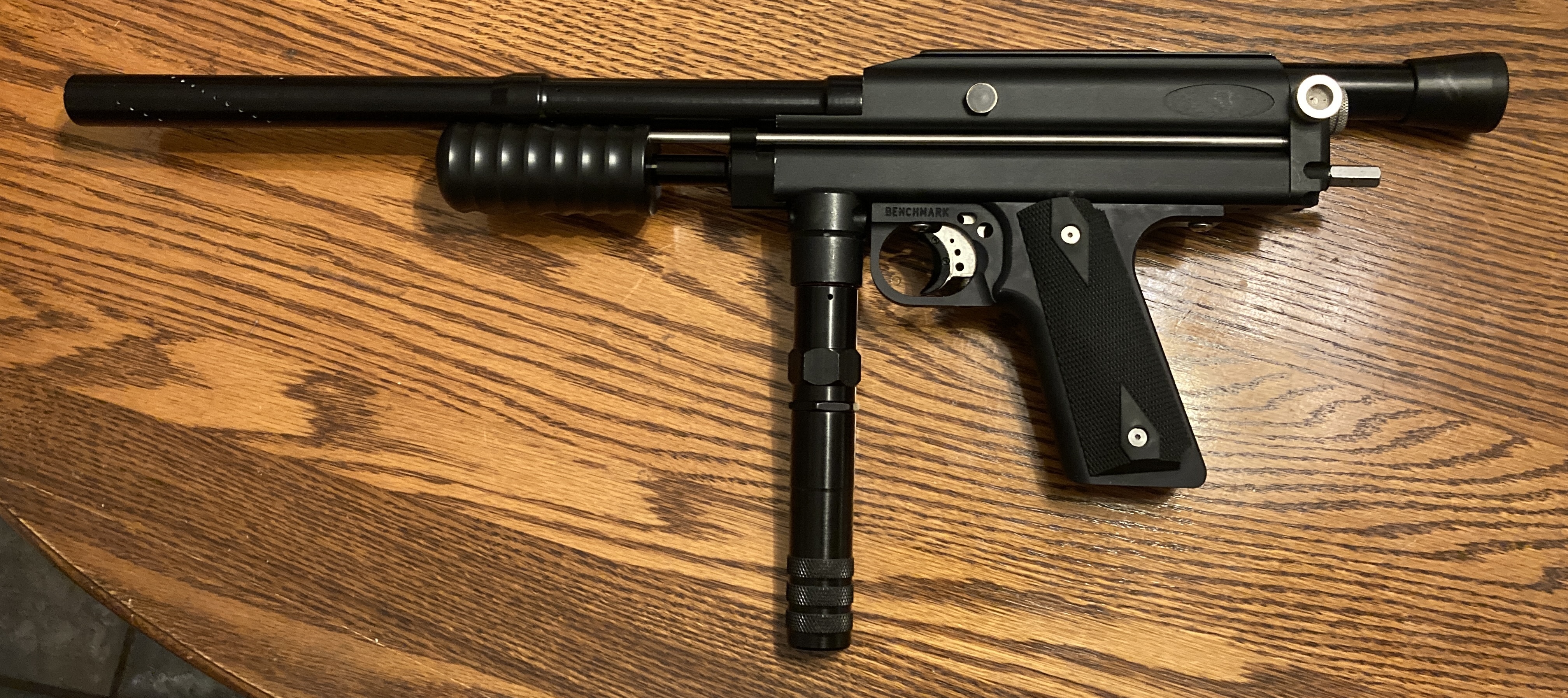

          Did my first Stock class sniper conversion.
          -Drilled thru the feedneck and twisted it off with a grade8 bolt.
          -lined up the feedblock and drilled and tapped the hole
          -chopped the feed down a bit
          whole process was maybe 20 minutes.
          surprised myself with how easy this was.
          did some light tuning earlier and shes getting 30 solid shots @ ~275.
          this set up feels so RIGHT
          very stoked to get this one out on the field.

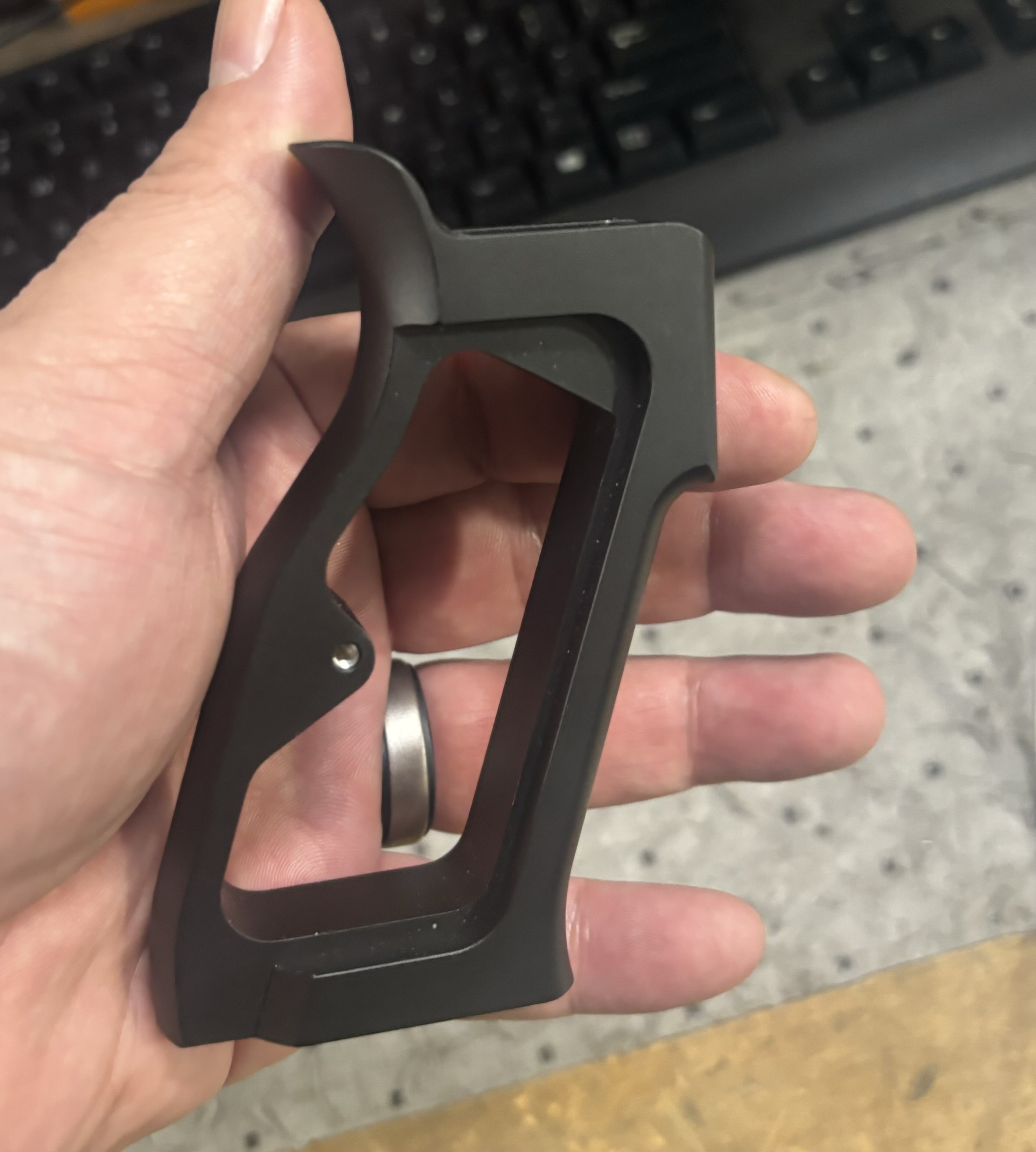

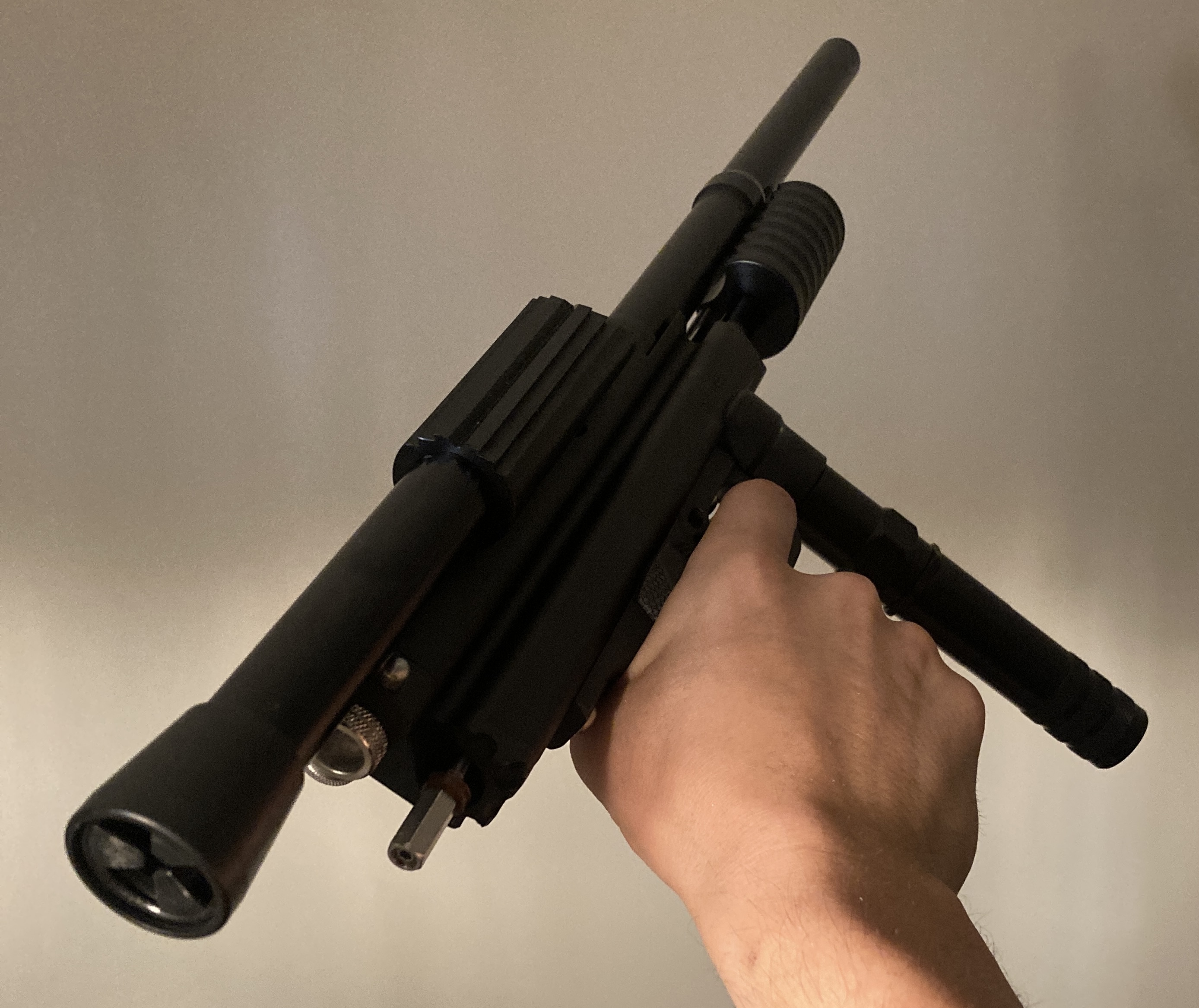

          The SL-68 II needed a new pump handle to fit over the freak adapter, and I finally got a chance to tinker in my old man's shop and kick one out!
          Super happy with how this turned out, still needs a bit of work to finish it in, but not much.

          • Myrkul
            Myrkul commented
            @J8c5150
            Slip fit on the back, cocker threads on the front, bored so that you can run a regular freak back and a freak XL Inserts. BMC got the spacing on it worked out so that the insert sits too far forward for the bolt to grab it and pull it back.

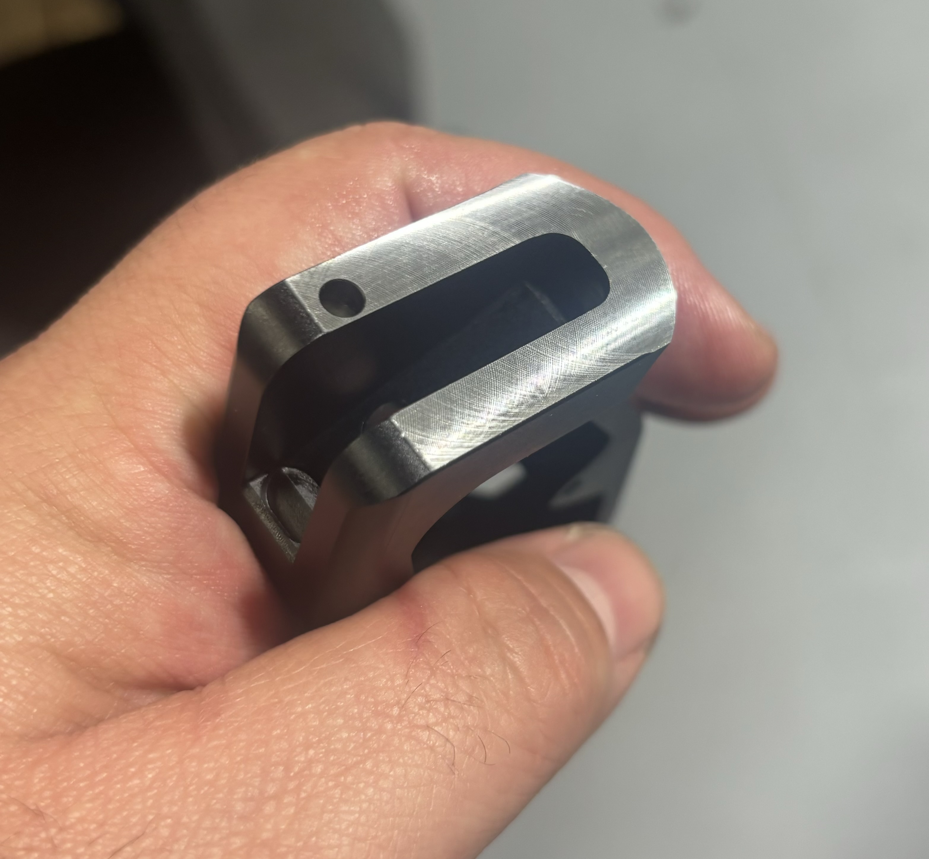

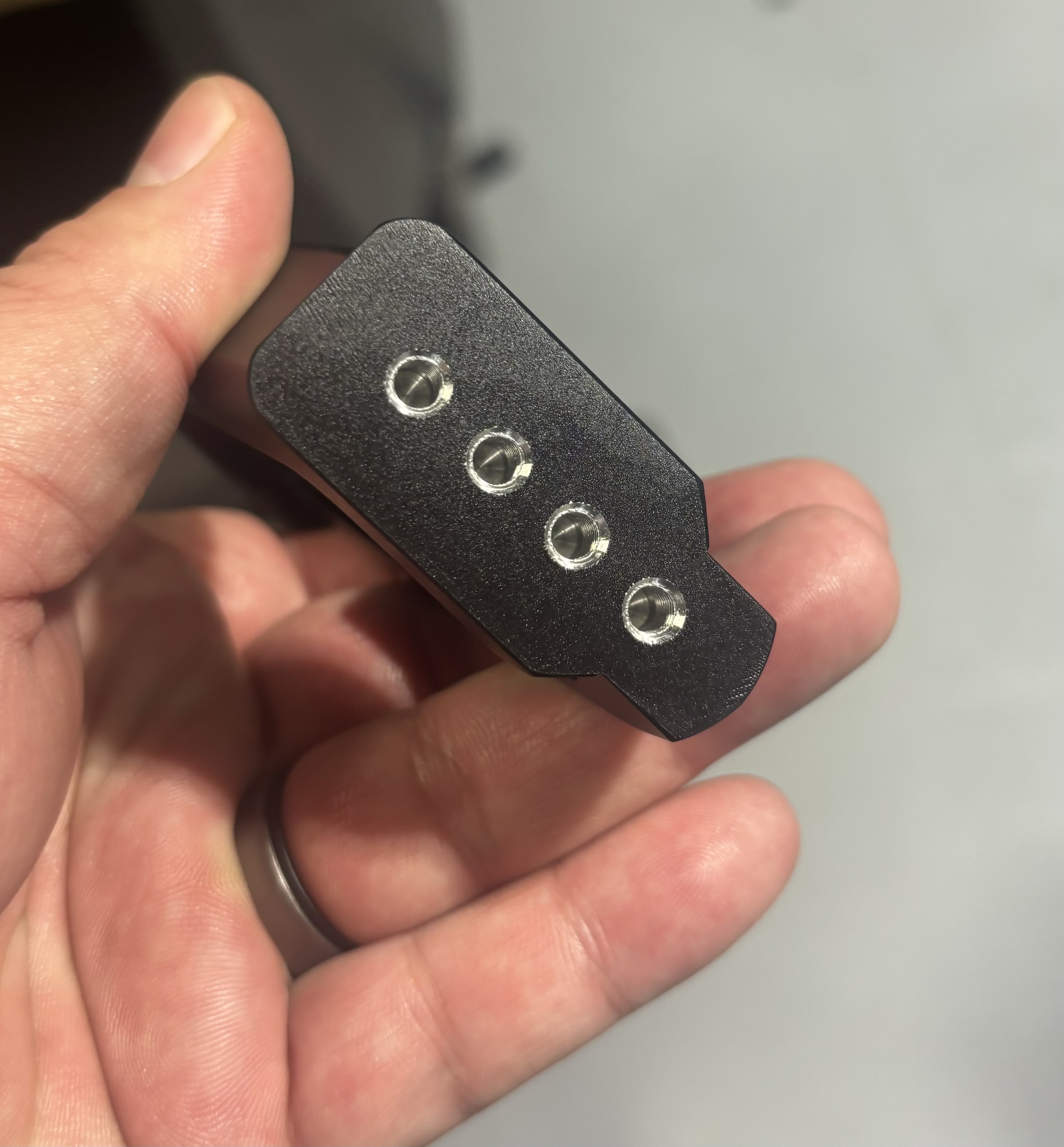

          Got this adapter for an AR.. had to modify it to fit my paintball stuff. Milled off the back and drilled/tapped for bottomline

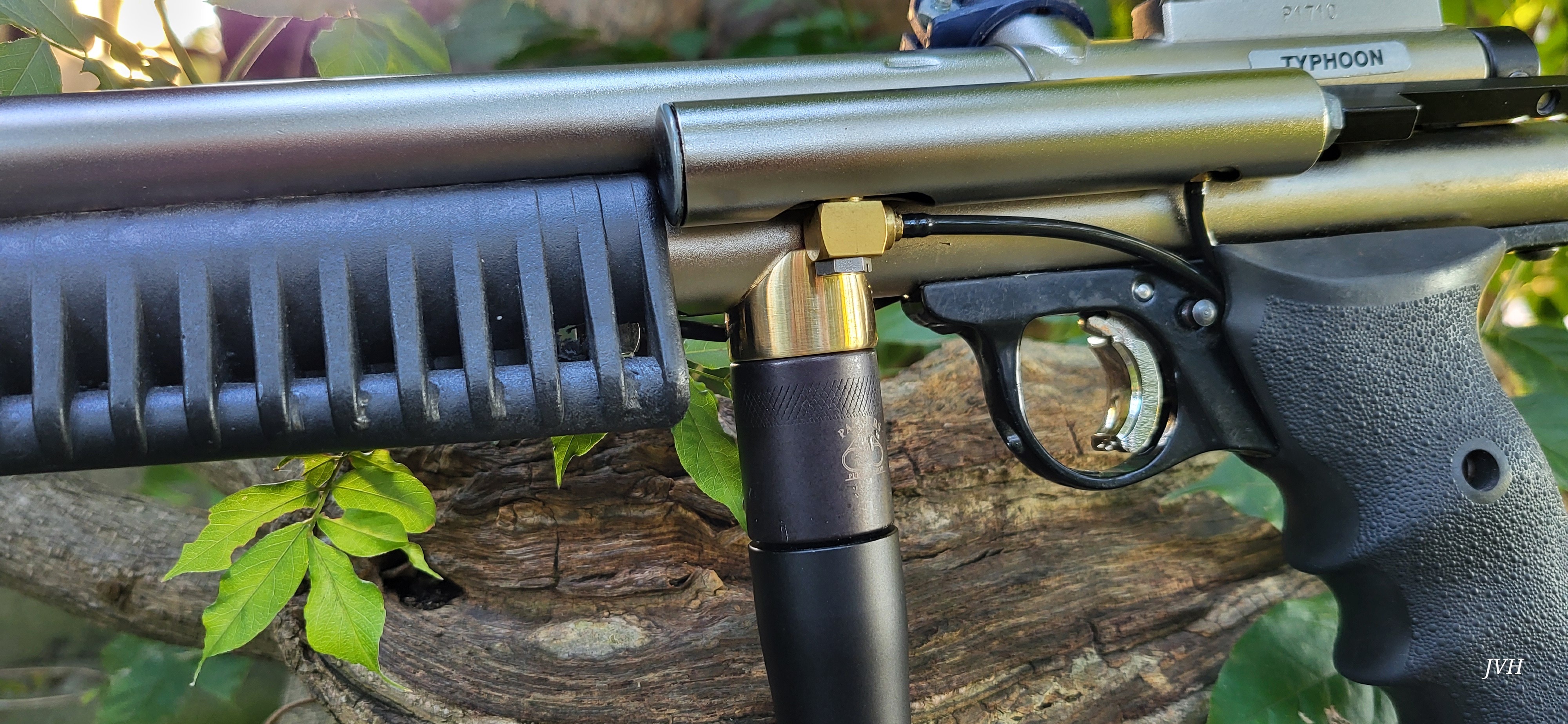

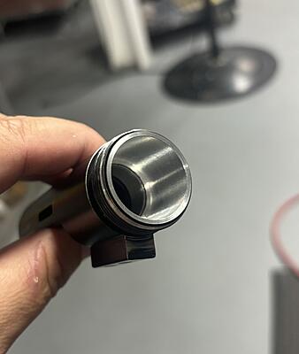

          Palmers is out of stock on their ASA collars and I needed one for my Typhoon after I converted it back from it's Hurricane format, so I finally got to it last night.
          Brass, of course - I don't have access to a lathe or mill so brass tubing is the easiest thing for me to work on with the tools at my disposal.
          • Cal440
            Cal440 commented
            Looks good as usual Jordan, does that collar support the regulator as well as fill in the gap between it and the lower tube?
            Jordan commented
            Cal440 yessir.

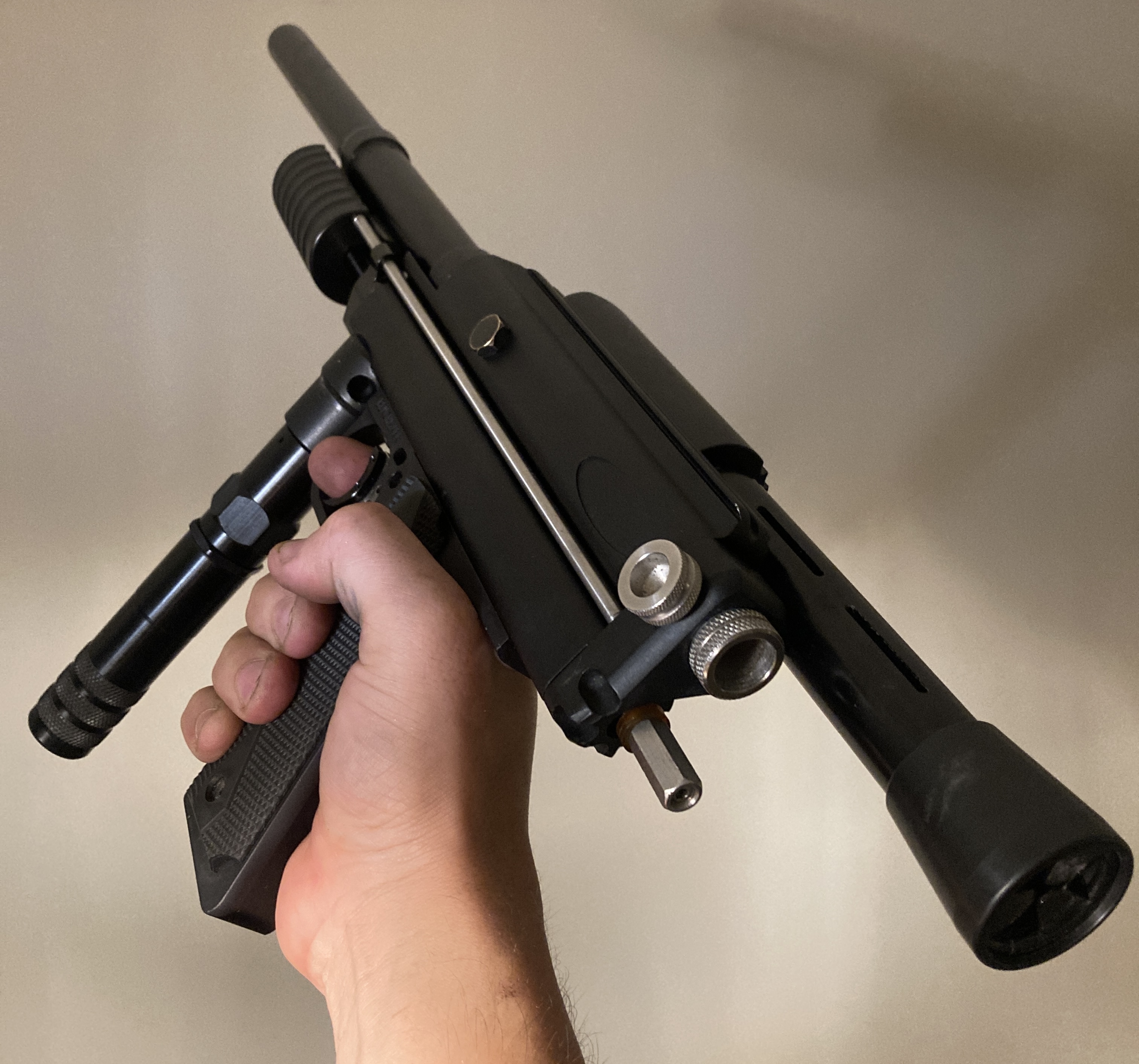

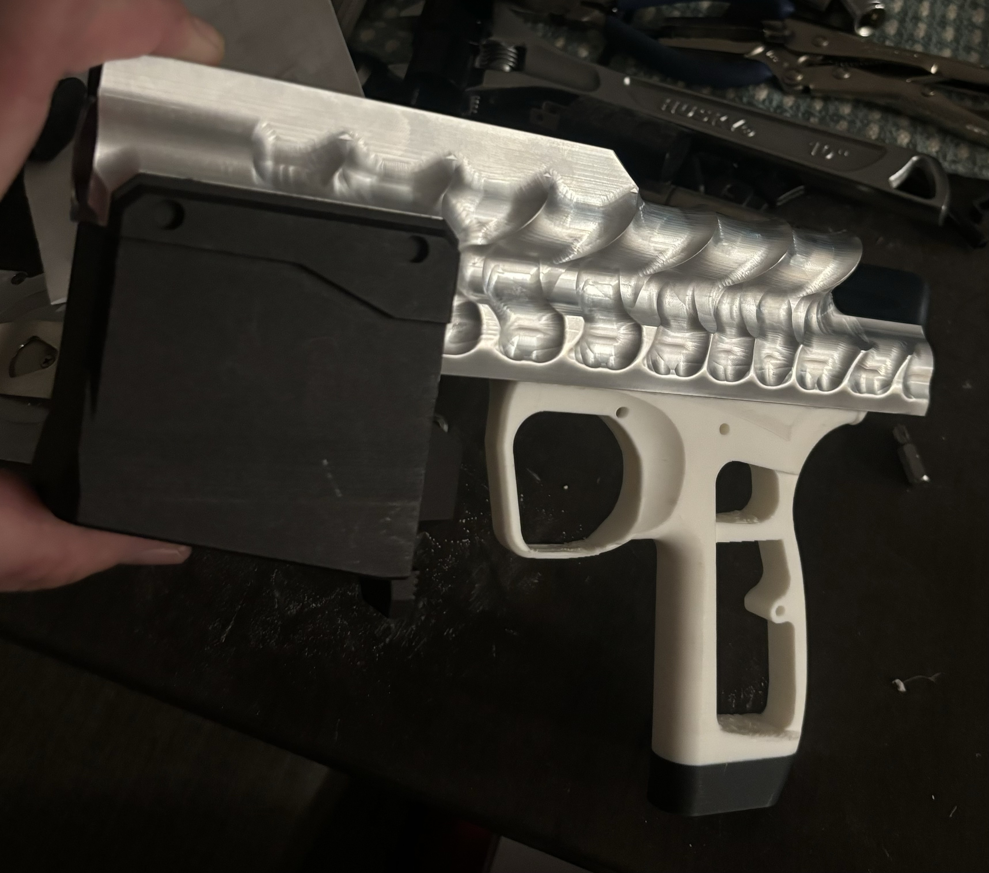

          It may not have been painfully obvious what I made last week but here’s a pic after I hacked off some more weight.

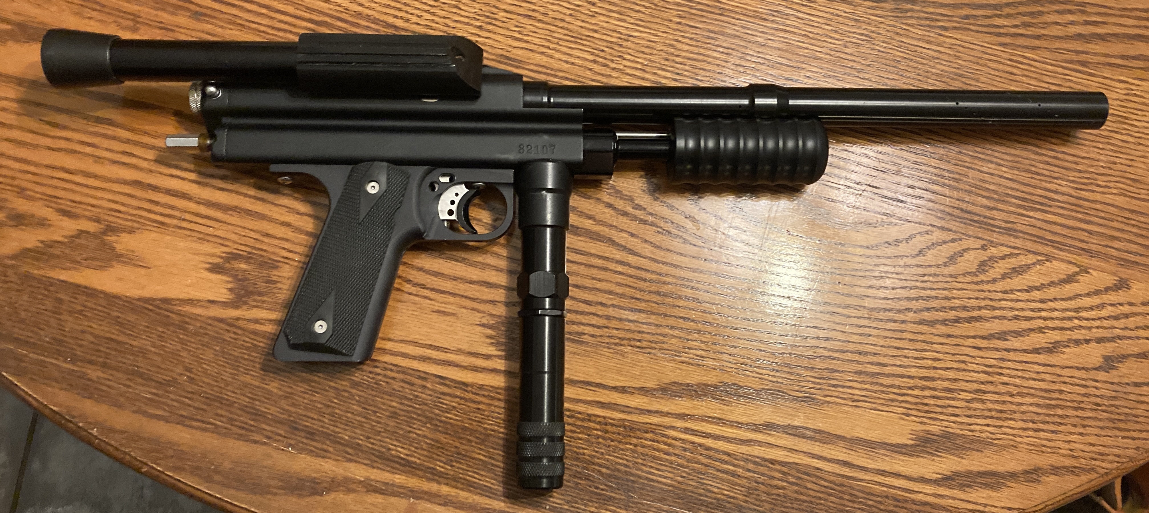

            Another mock up to make it even more obvious
