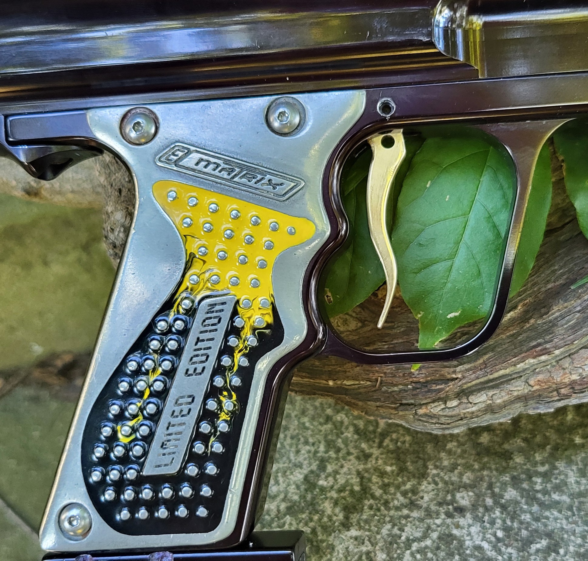

    I really like the Aardvark Tentacle trigger but I don't want to pay $140 for one on Ebay (pesky exchange rate and all that) - so I figured I'd make my own version of it. In brass, of course.
    I picked up some 2.5mm brass sheet for another project and had some leftovers, so I soldered two pieces together, traced a stock trigger to get the basic geometry correct, and free-hand drew the "tentacle" portion, which is really just an S-curve.
    I spent more time cutting and shaping than I did anything else, but with basically $5 in materials and a few hours of my time, I got this:
    I also drilled and tapped the frame for setscrews - I hate having a pin I need to drive in and out every time I want to tweak the trigger or pull the board. I made sure to put a generous taper on the end of the setscrews so they also center the trigger as well as retain it - there's virtually zero side to side play in the trigger now, and it's very smooth.
    The only other tweak I thought I might do is to drill some dimples into the trigger to dress it up a bit... haven't decided yet.

    Looks good! And I dig the drilling and tapping of frames. I do that to all my old school markers as well. Every since I saw the Luxe do it, I’ve copied it, just makes sense

      nice work and i love the use of brass.

        Clever use of brass on an oldschool marker and awesome craftmanship!

          Love that. Always a fan of classy hand cut parts.

            Damn, I should send you my frame and florypb board and get you to fab a trigger for me. The microswitch is set back just a little bit compared to the tadao. I would much rather have something clean like this vs jb weld on the back of my trigger.

              Sweet. And whats the story behind those grips? is that epoxy? Theyre fire
                Jordan commented
                Not sure, I got the Matrix with them already like that.
              pewter and epoxy infill... those came on the oooooold airtech matrix before diablo (actually may be some carryover with Diablo), before TMC, before dye
              • the_matrix_guy
                the_matrix_guy commented
                Theyre not custom? Wow. Never saw them before.
